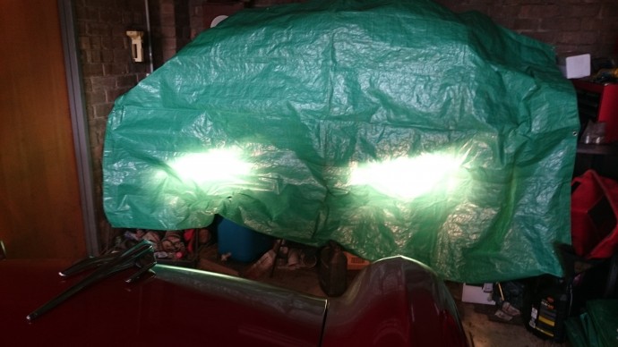

While driving Scoobbs FB home i noticed that there seemed to be a lot of light up high to the right when close to walls, trucks etc. Looks like both, not look like, they do, are mounted about 10mm rotation too far to the left, so they both throw a beam from down left to higher on the right. Yesterday had the headlight buckets out to see if they had been mounted wrong, nope. Screwed into the right holes, if i remove screws and rotate buckets can just get corrct alignment before the adjust screws hit there cut out. While writing this, starting to think the locator lugs on the H4 headlights might be in the wrong posi. Couldn't see a brand, only H4 marking on the front of the glass. Anyone had any similar experience or suggestions, will find an original headlight and compare i guess.

They aren't American are they ? designed for a LHD car ???? I would buy a cheap one and try it to see if it is the setup or the light .....

Hi Blacky, as you can see the beams are straight just tilted,, yeah more playing around required. Have just replaced the w/screen washer motor, (was leaking between the two halves). Cleared the jets and now have water pissing into the car from behind the dash, even more playing around, trying to get ready for a roadworhty on Wednesday.

Turns out, they are crap headlights, locating lugs in the wrong place, have some projector lamps with White Halogen 55/60W globes coming, should be interesting. :wtf:

Yeah i know, i had the same thought, i pondered over lights for a while and thought i would give them a go, :erm: wouldn't recommend them. After looking at the photo above, the ascew h/lights had a better definition, and the high beam on the "projectors" just makes the low beam pattern a little brighter, can hardly see any further. Live and learn i guess.

On further investigation, turns out Blacky was right, LHD headlights.
