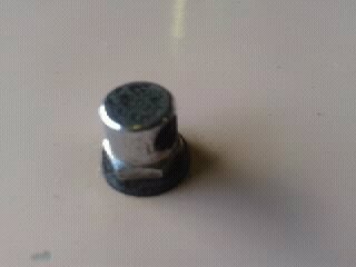

Thanks for the reply Harv, Sunny Tim,
I have just come from a blokes place in Newcastle, he tells me they are off a MGB or Austin Healy 1800 Mark 2.
I don,t know what you think, or how put them thier
