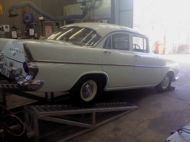

i everyone, i am a little stuck as my ek wont start. I reversed it up some car ramps to check the diff oil and after i rolled off and tried to start her, she backfired a few times and the battery went flat. I have spark at the plugs and fuel at the carby but she wont fire ??? I was thinking maybe the fuels not getting past the carby for some reason, any ideas anyone thanks, Mark Danton.

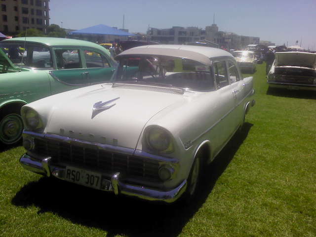

that was All Holden Day at glenelg, 3hr drive and she drove really well.
