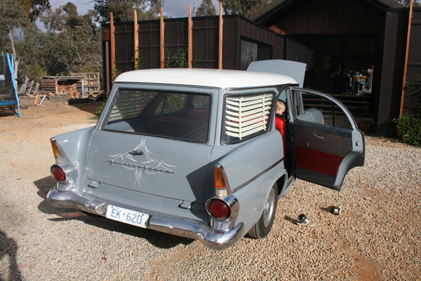

She's a good old girl from what we can tell. it was adverstised on eBay last week and we subsequently purchased her from a wholesaler in Melbourne yesterday. Looking at the the rego plates and unusual (and first thing to go) paint details im sure someone on this forum may know the history of this car? The wholesaler had no information for us so we have taken a leap of faith!!!!

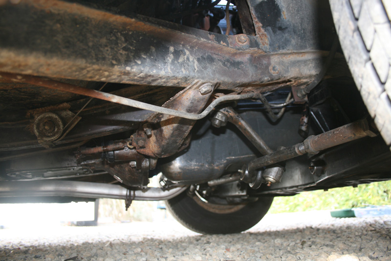

Is this a HR front end conversion?
How can we find out if its original paint or at least what it used to be?

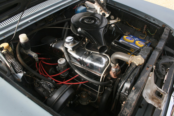

We assume this is a grey motor? not sure on size though?

First things first - that is indeed a fine example of the mighty grey motor.
It's pretty standard under the bonnet, but does have an aftermarket brake booster, and what looks like hoses going to a heater, which must be one of the under-dash heaters (commonly called a poor-man's heater).
If you post photo's of the ID tag and chassis number (stamped into the driver's side inner guard), then we can tell you a lot more about the car (where/when it was made, colour, trim etc.).

Can't see enough of the front end, has it got disc brakes?

Engine number will tell you the size, No letter before the number or L before number will be a 132, B or J before numbers is a 138.

It has disc brakes, I will take some more pics to allow for more responses, and yes I can't even tell where the heat comes out in car no vents?

I'm 99% certain this is the same car that was for sale in Sydney a couple of years back. The pinstriping is what I remember from the car back then.

Disc brakes = HR front end = score :thumbsup:

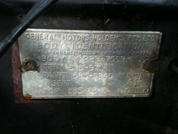

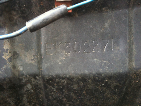

Hi Guys,
Here is the ID Tag and the numbers on the frame. Does this shed any light on the car? Is Steve Jackson the man to speak to?

P.P.S. Your car was built in Melbourne..that's why the "M' at the end of your chassis number..

Hey guys,
Steve is definitely the go-to man in terms of codes however from what is on your ID plate the Paint is Garrison Grey with a Snowcrest Roof and the Trim is Grenadier Red & Athens Grey. These can be obtained under the "Body, Paint & Panel" category in the "Technical" section (thread is titled Factory Paint & Colours).
