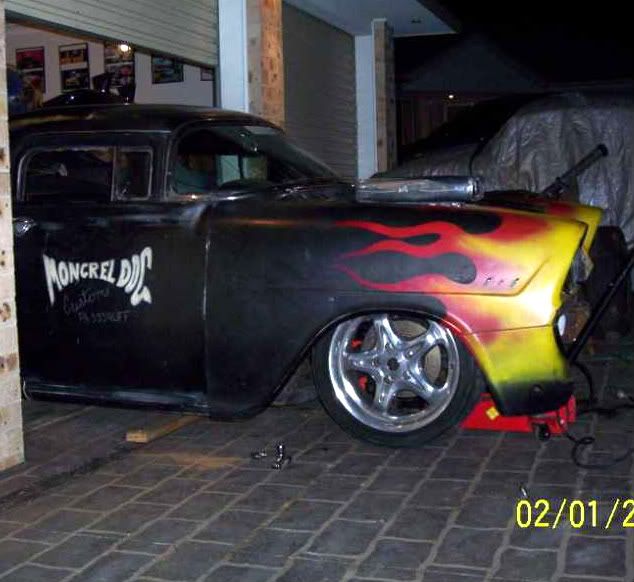

i know theres no guard on there but this is my fb ute when i tried my 17 x8's from the vz ute
it fits on alright but the problem is when you put it on full lock the inner rim his on the swaybar mounts on the hr crossmember, my guess is an 18 would be atleast a 7 or 8 inch wide so youd probably have the same problem.
having said that, if you can get a 18 in another stud pattern it might have a different offset and might work alright. I also have hq stub axles on that car for the brakes so that may play into it aswell.

I was told when I got my front end modified by Rods Racks that there is a problem with the rims / tyres hitting the sway bar mount when using the late model rims as they have no outside dish.
The 17 x 7's I tried on mine had a 4.5inch back space and they only just touched the sway bar mount, but that is able to be rectified by adjusting the lock stops. I was also contemplating 17's on the front and 18's on the back.

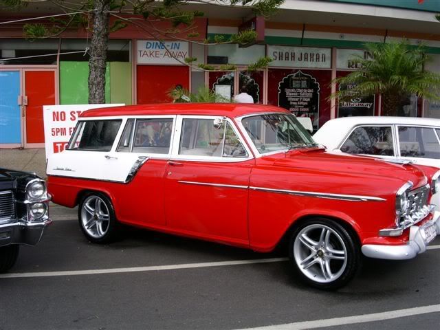

Did anyone notice Lynchpins wagon runs low profile tyres on the rear only
proportions look right on

I know its my car and I agree but have a look at the height its sitting at , It needs airbags for sure to sit it right , If you can visualise har far the guard has to lift to give steering it like 4 or 5 inches , It would look totally stupid driving down the street .
17s are too large on the front if I can have my say , and Ive got 16s on the rear of the FC nomad which have the guard extended 1 inch , they look tough (
to me ) .
So in my opinion the max diameter would be 15 front 16 rear
I just believe these cars were made with rubber so they do need some .
