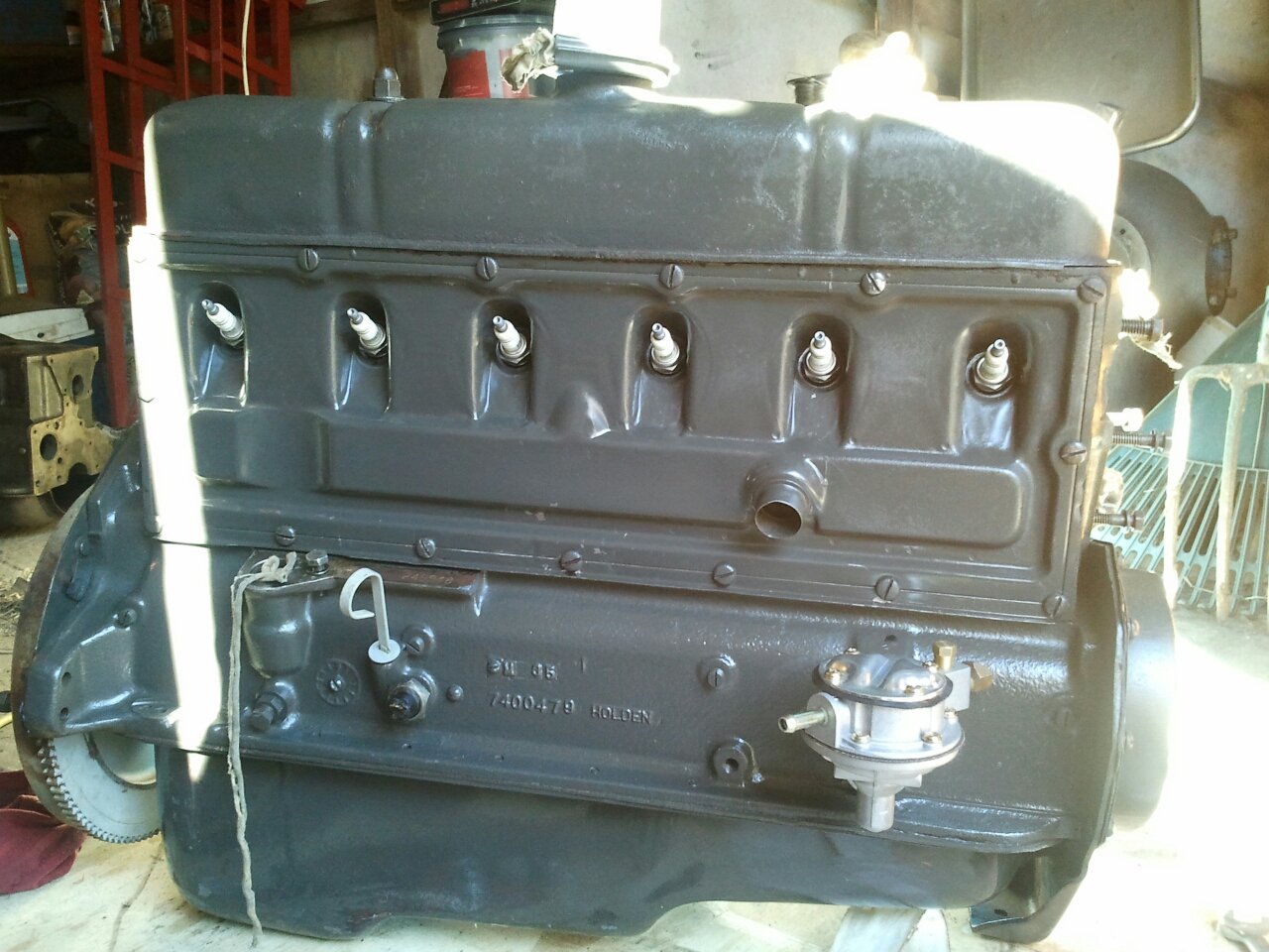

Well, its almost ready to go in!
Ill swap some ancillaries off my 138 this weekend and fit the new motor the following - should be awesome.
The motor was fully redone in 2004 and has not been run, im going to be stoked to fire it up for the first time. 8)
Thanks to Graham for the deal, legend.
