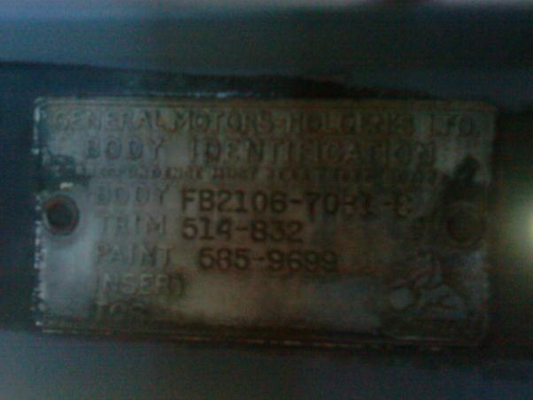

i reckon our ute was a standard morning grey ute with a flash kit
fb plate.jpg (22.77 KiB) Viewed 1500 times

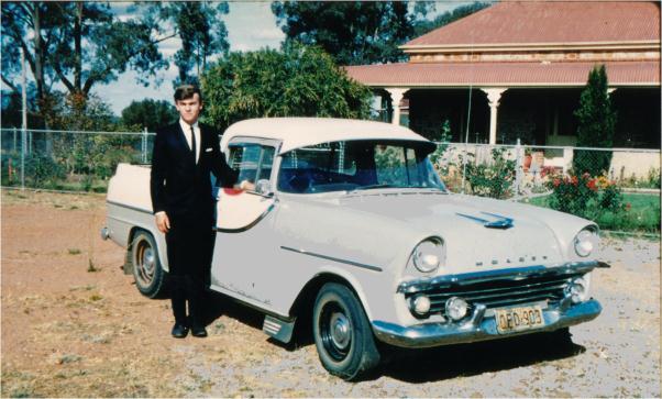

fb ute.jpg (48.97 KiB) Viewed 1500 times

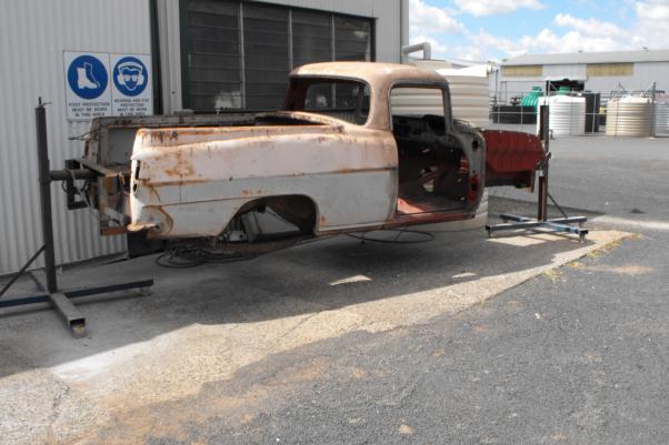

ute ready for sand blasting.jpg (39.74 KiB) Viewed 1500 times
