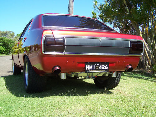

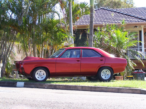

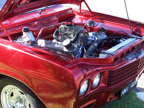

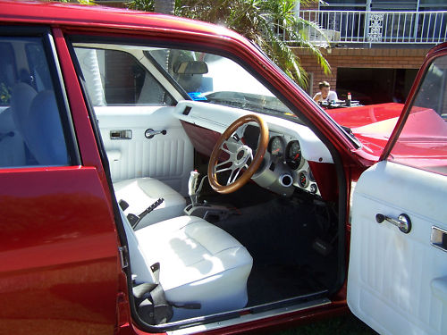

this is my 440cu big block centura 727 reverse pattern manual
mopar m1 manifold 830hp holley 252@50 110lob
custom headers dual 3 inch exhaust
fuel cell tubbed 295/50/15 rear
car weights 1320kg as it sits
rego'd enginered in nsw!

I think your choice not to put a grey in it may be wise Steve!
Only advantage of a grey change would be fuel economy :lol:
Nice Power to weight ratio. That thing would get up and boogie I'm sure

Nice car...
Used to own a Centura, though it was only a six. Still hauled though. Had no trouble blowing off a lot of V8's
Surprised this one is so light, coz one thing that stopped me putting a V8 in mine was that it weighed almost 1300kg with the six

hey cal thanx. not sure why ur one was so heavy. not much metal came out of the rear end
the convo pro's are light im guessing a 440cu has to be at least 40kg heavier than a 265

Like father, NOT like son. Looks like a total weapon SJ-jnr. 252 @ 50 thou? I guess all those cubes help that monster cam to be streetable. 8)

drives fine with 252@50. in a 355 holden i have a 276in 278ex @50 that was hard to drive with a 5 speed although now that car has a t350 with a 4500converter drives great on the street :evil:
