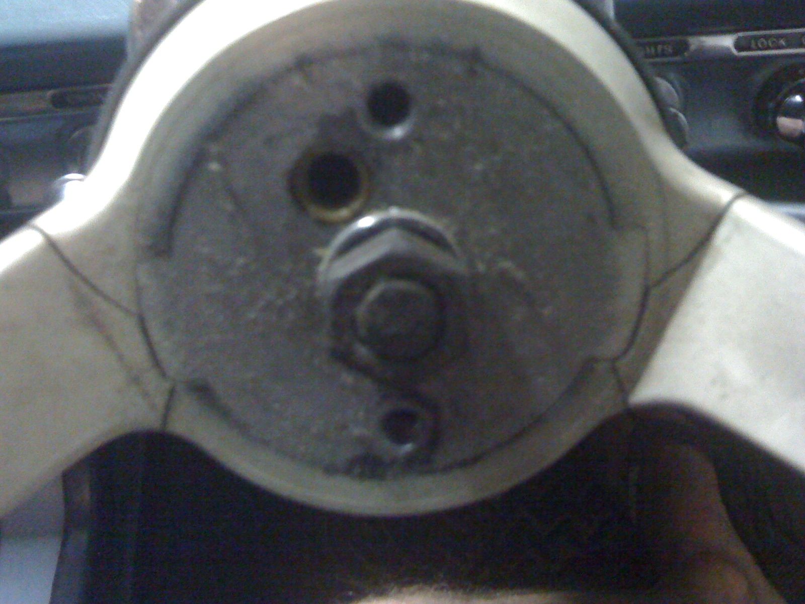

As u can c in pix, the wire just slid out of hole, should this be attached to something? in the manual, its the only thing thats not covered? if it should be attached & to what/where & how???

Sam - pop the wheel off and short out from the brass ring to the steering shaft - if the horn works then you have a problem at the wheel end.
If it doesnt work then start looking at your wiring. There should be power at the horn and the wire that runs to the brass ring is the earth wire.

Great, thanks a million blacky.. appreciate the response.
but??? what do u mean by "short out from the brass ring to the steering shaft" is that just a matter of earthing it to metal???
that wire that runs from the horn contacts, how does it attached to ring? it just slid out, is it supposed to clip into???

yep , just stick a screwdriver on the brass ring and touch it to the steering shaft , the pin that slid out of your wheel is meant to be like that , it makes contact with the brass ring behind it .

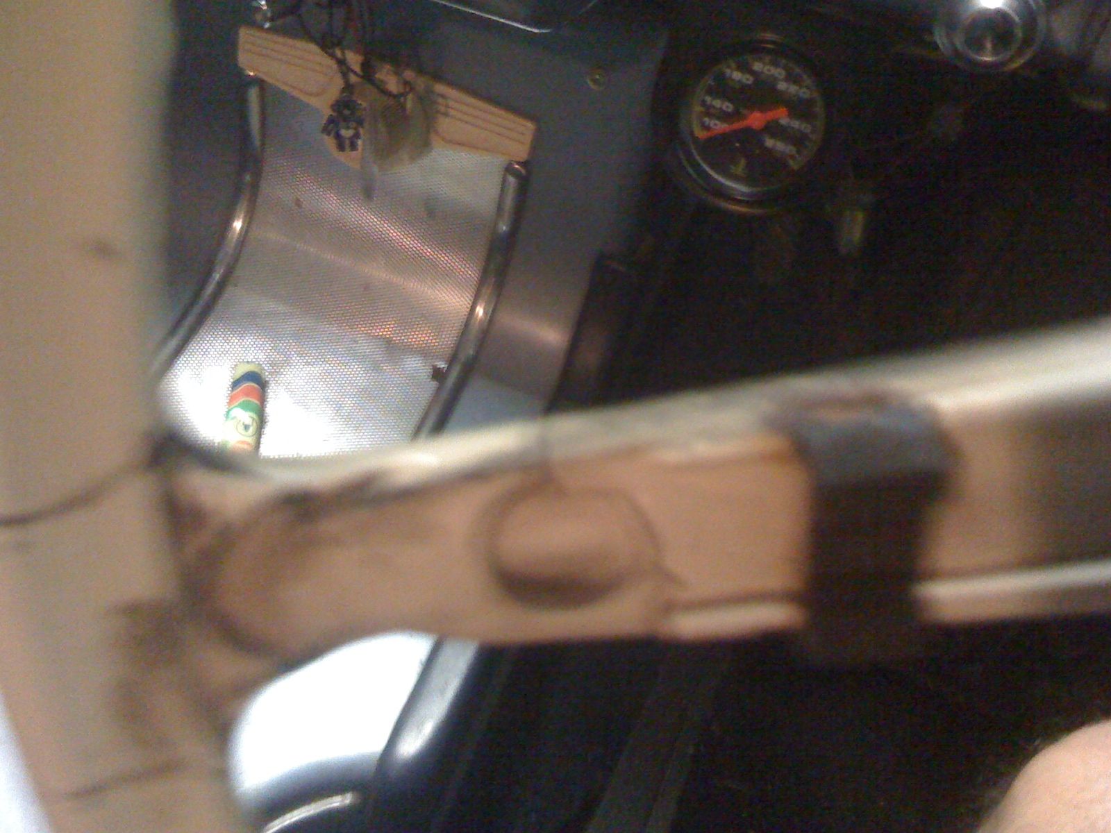

So is there any little tricks??? to make things worse, On close inspection (see pix) steering wheel had a lot of crack, if Im pushing & pulling to with force from my hands, whats the chance of breaking the steering wheel????? & if u break it is it still possible to remove????

Steering wheel wont break Sam, they have are based on a steel frame.
