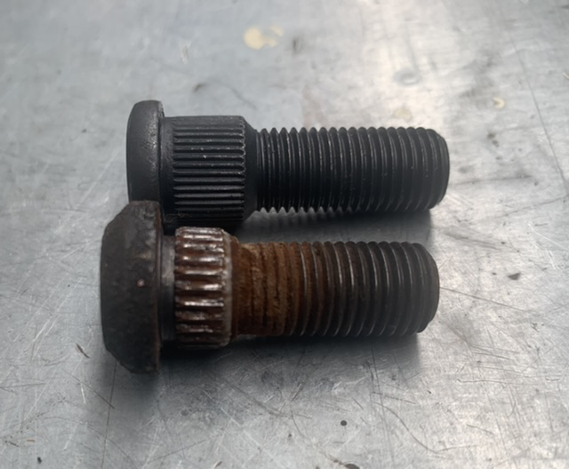

I thought it is appropriate for this thread so I’ll share my findings here.
I rang around for replacement whee studs for the FB and the common part number is NS146 so I bought 10 for the 2 rear axles and bought them home to fit.
It seems to me there are obvious differences like a fine knurl vs a course original knurl, the length of the knurl on the NS146 is longer so it will protrude past the rim mating face on the axle and lastly the head diameter is a touch smaller… but that I can live with.
The stud lengths are different too from base of head to end of thread… original is 31mm and the NS146 is 36mm
Repco and Car Parts plus both quoted this number for the stud catalogue.
Is this truely the correct replacement part because I’m not convinced they are correct!
- FBAF0EA8-E218-4DED-8B40-32BC154D555B.jpeg (59.45 KiB) Viewed 9032 times
- 378087B5-CB76-43D6-AD7F-2B6D8DA77F96.jpeg (100.89 KiB) Viewed 9033 times

I just looked up rare spares website and pulled this pick.
The knurls certainly look more like the original…
