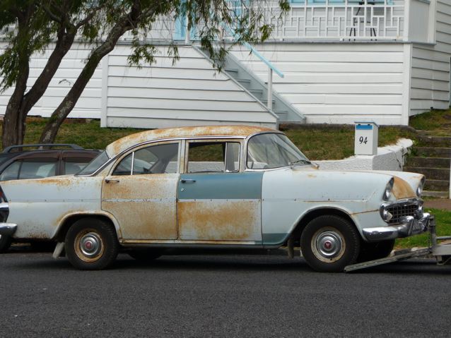

I have a manual Ek sedan and I have bought a complete disc braked 3 speed manual 186 HR sedan , what are the hurdles to overcome in changing the whole lot over excluding the front end instalation which is a whole other story. Is it a reasonable idea or am I better off using some bits and flogging off the rest . I have been through the forums but there is a lot of different ideas . Thanks in advance ,any help would be appreciated.
