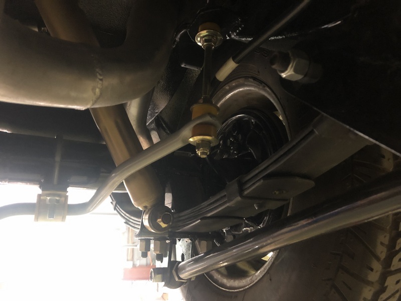

Comparison photo to UC Torana bar which fouls on the shocker bottoms. Image
Posts: 11650
Looks like it will fit fine, although the diff pumpkin must be offset on the xp. The eye to eye clearance is spot on with 15mm clearance either side to chassis rails.

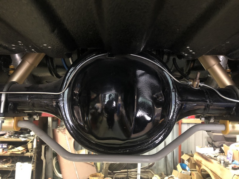

So the XP fraud sway bar does fit ok, there is however an offset to the passenger side because the fraud tail shaft tunnel is actually in the middle of the floor so the diff is manufactured offset toward the passenger side. The FB EK tunnel is not in the true centre at the diff, in actual fact its toward the drivers side.
When I first had a diff shortened to suit my car I assumed the tail shaft was centred, it is not so I had to do it again !!!! Hard lesson that one !!!
You can see here that the diff is to the right, the sway bar still fits even with the big black 9 inch but only just !
I welded an angle bracket in the inside rail, all fits pretty good.
