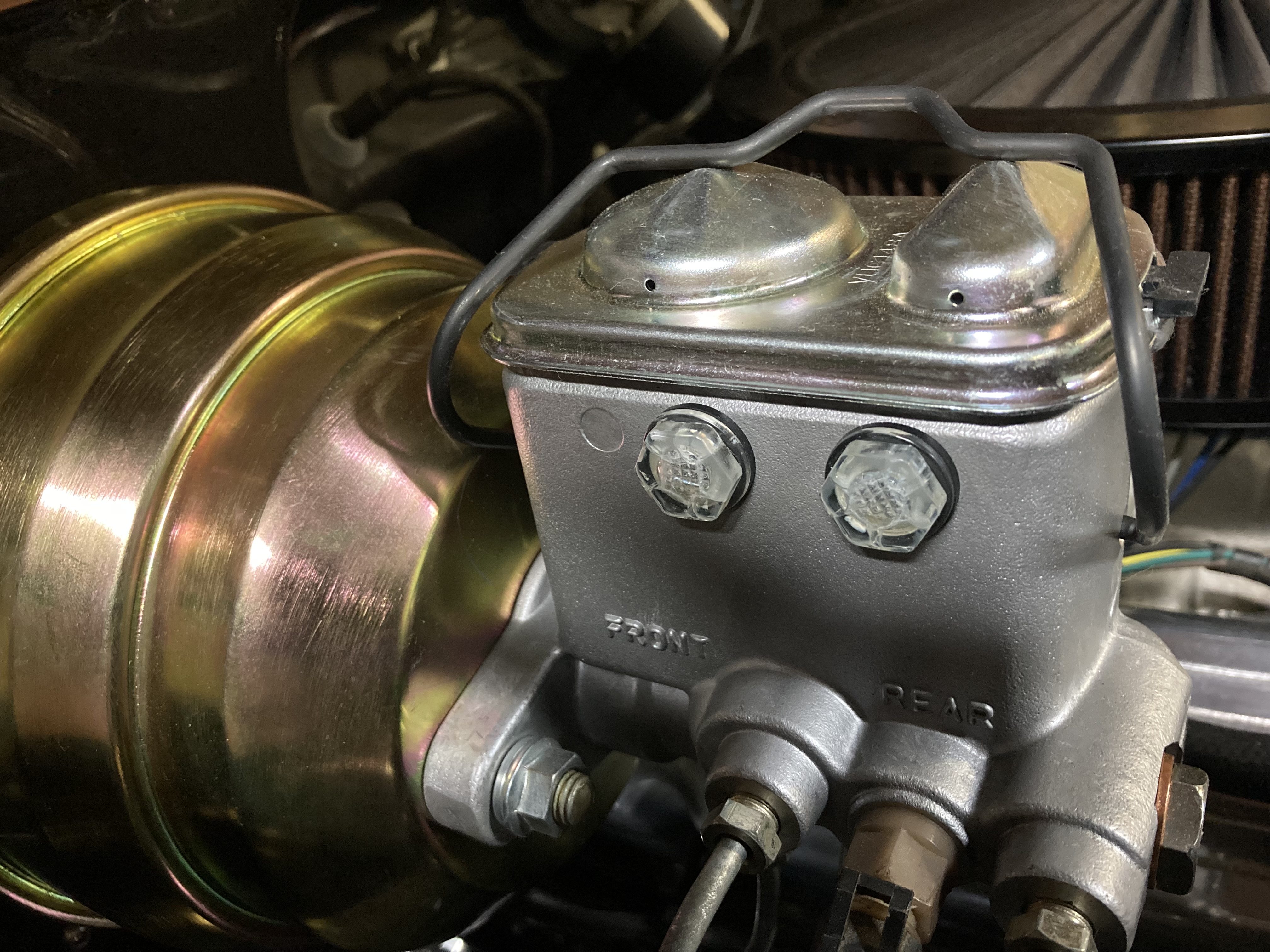

Update,
Everything has been done for the engineer and i'm trying to finish all the little bits and pieces that you find when you think you're finished !!
Brake sight glass plastic is a fail, they have developed cracks and are starting to go milky. I have ordered new ones that are glass and waiting patiently for those to arrive.
I was hoping I could be lucky with the plastic but no, the only other concern is the rubber gasket with the new glass but at least that will take a while to break down until I can source the correct type.

Bummer on the sight glass. Give that injunear a clip behind the ear.

............or get it signed off quick and replace master cylinder with one that doesnt have those stupid sight glasses in it :thumbsup:

Blacky wrote: Wed Apr 13, 2022 10:12 am ............or get it signed off quick and replace master cylinder with one that doesnt have those stupid sight glasses in it :thumbsup:
Blacky,
That would be immoral as well as illegal, I'm flabbergasted that you would even suggest such a thing !!!!!!
I'll work it out don't you worry :evilll: :evilll: :evilll:

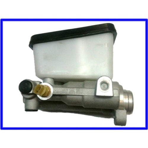

Greg is this type of master cylinder not an option?
