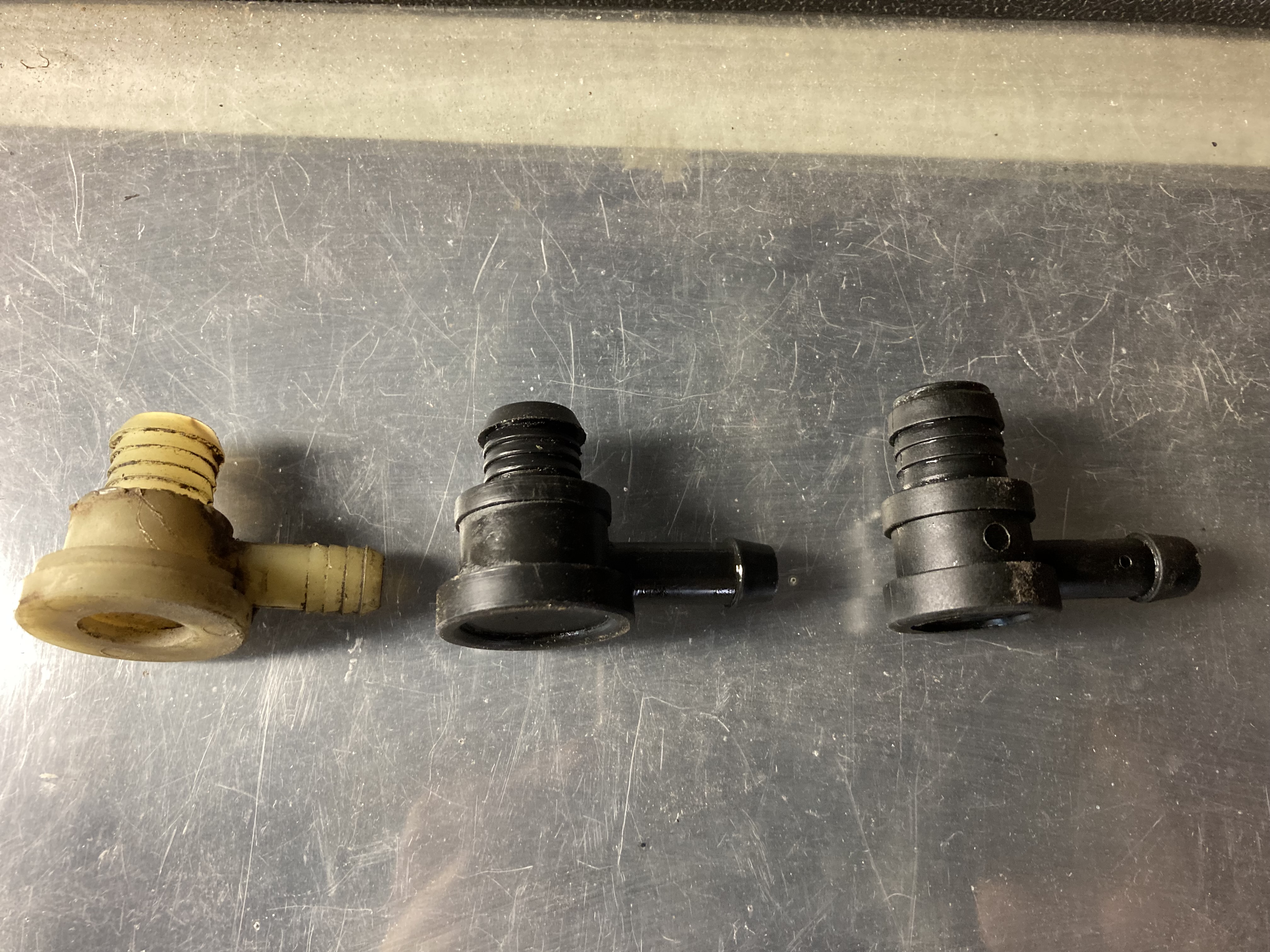

Now this is funny or sad depends on which way you take it, but i was mucking around with some fuel lines today because my engineer asked where my return goes from the fuel injection, i said back to the tank not realising that it is not allowed to go to the boot area without detailed testing. This is so if a fuel hose lets go the boot wont fill up and kaboom !!!

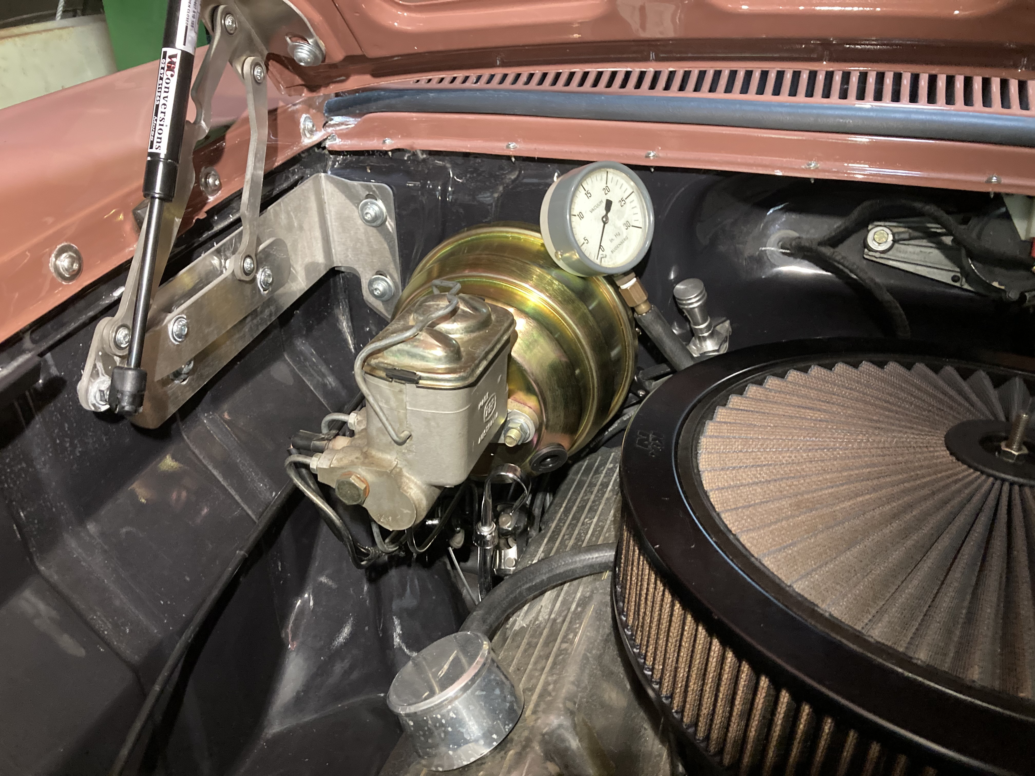

Anyway that job done and i started the car up to test for leaks, all good ! Then i thought I should do another vacuum test properly throughout the rev range etc. So armed with my gauge i pulled the vacuum line with the check valve off whilst the engine was running and nothing, no engine rev change WTF ??????
So i stare and wonder and yes its true the bloody chinkanese check valve has so much resistance on it it wont let the vacuum suck on the booster until it it is high enough to do so.
Scratching my head I check the gemini valve and its clear as a bell, another in my spares Fraud and its the same !!!!! I have a chuckle and wonder why this valve is so hard to suck through, Its Chinese what should i expect but as usual I am greatly disappointed !!!
From left to right Fraud no resistance, Gemini no resistance, Chinkanese cheek sucking in resistance !!!
8 inch Booster still fits ok with about an inch clearance to the rocker cover.
So I am going to do another road test before I lash out for a pump but at this stage my idle is 15HG, 1000rpm 18HG and deacceleration is 20HG. This should be ok for a booster but we will see, now that i'm getting full vacuum to the diaphragms i have some confidence !!!!!

Hey Greg I also found that the check valve on my Chinese booster was stuffed it gave no resistance at all didn't mater if you sucked or blew made no difference I had one in an old commodore booster so swapped that in :roll: :roll:

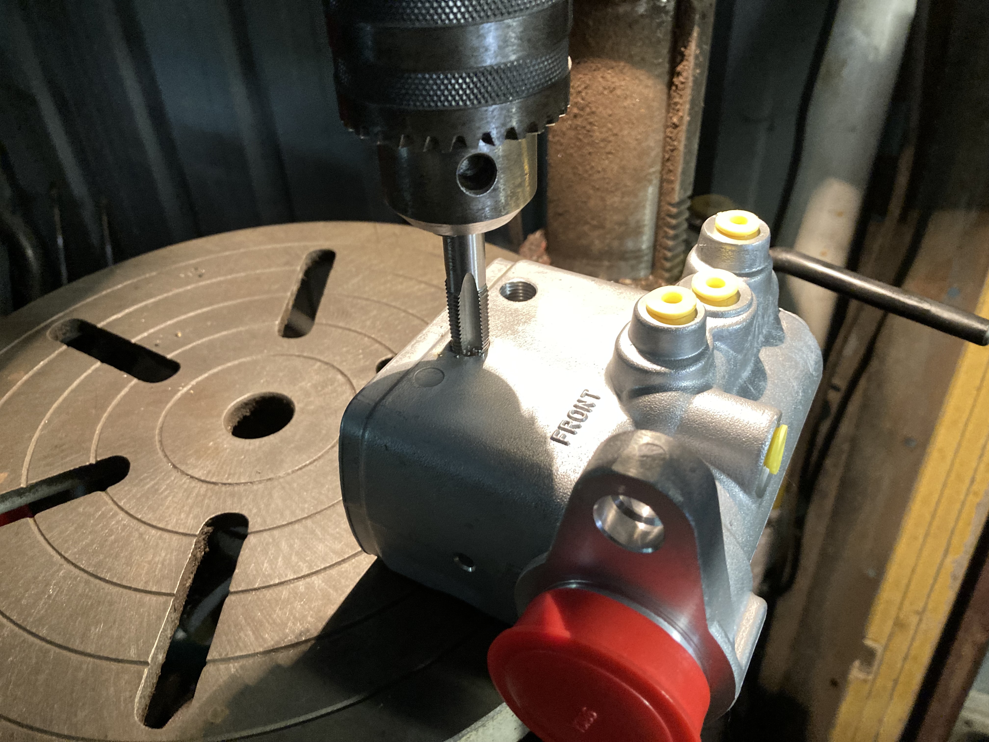

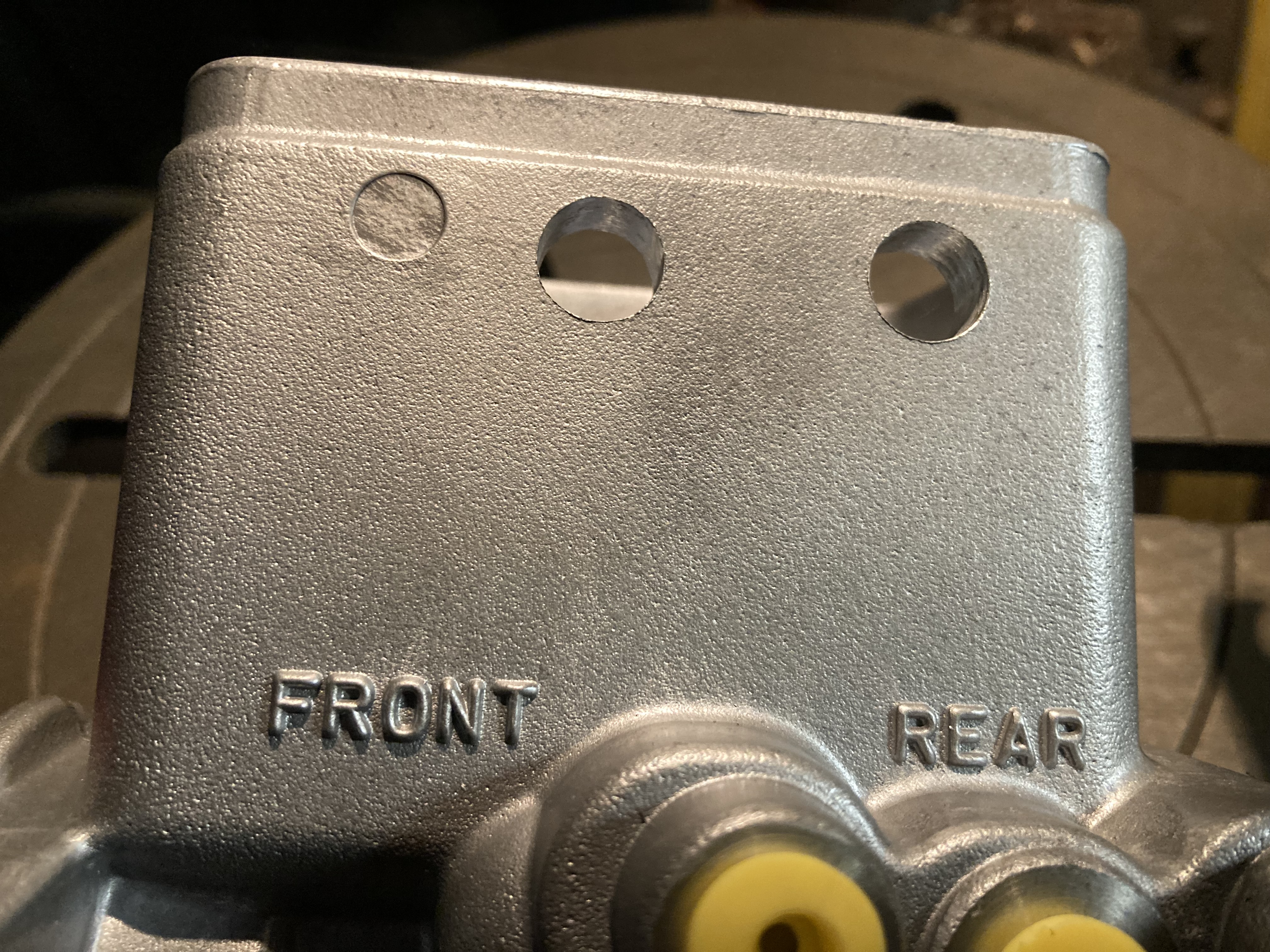

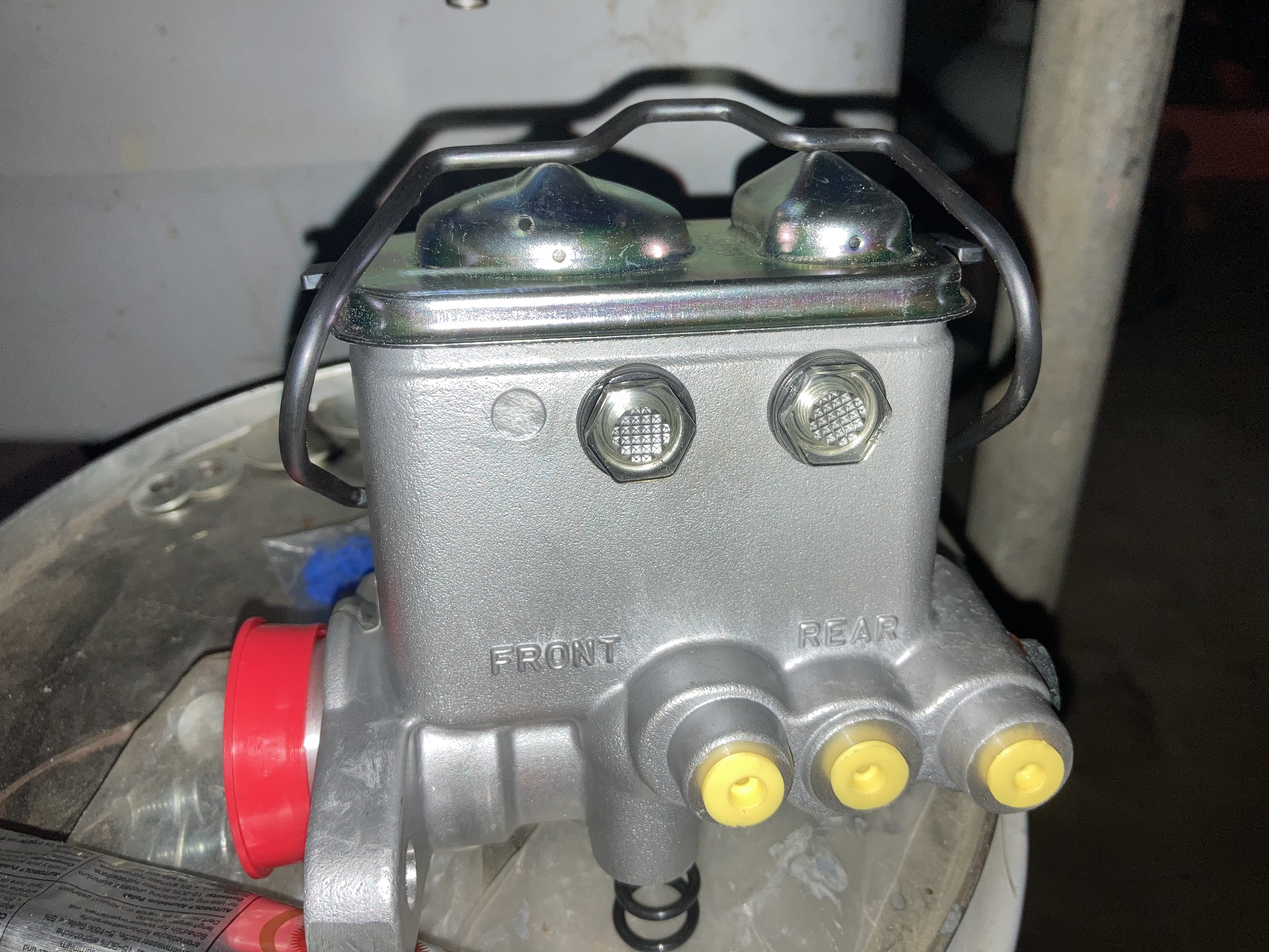

Bought a new master because the one I have is an original PBR and I didn't want to ruin it and also I now have a spare :wink34: :wink34:
Bought some sight glass, screw in and a tap, $40 all together.
Drilled, tapped and inserted.
Hey I've just realised I have a rare NASCO double diamond dot Brake Master !!!!
Install today and re bleed the brakes then engineer again.
