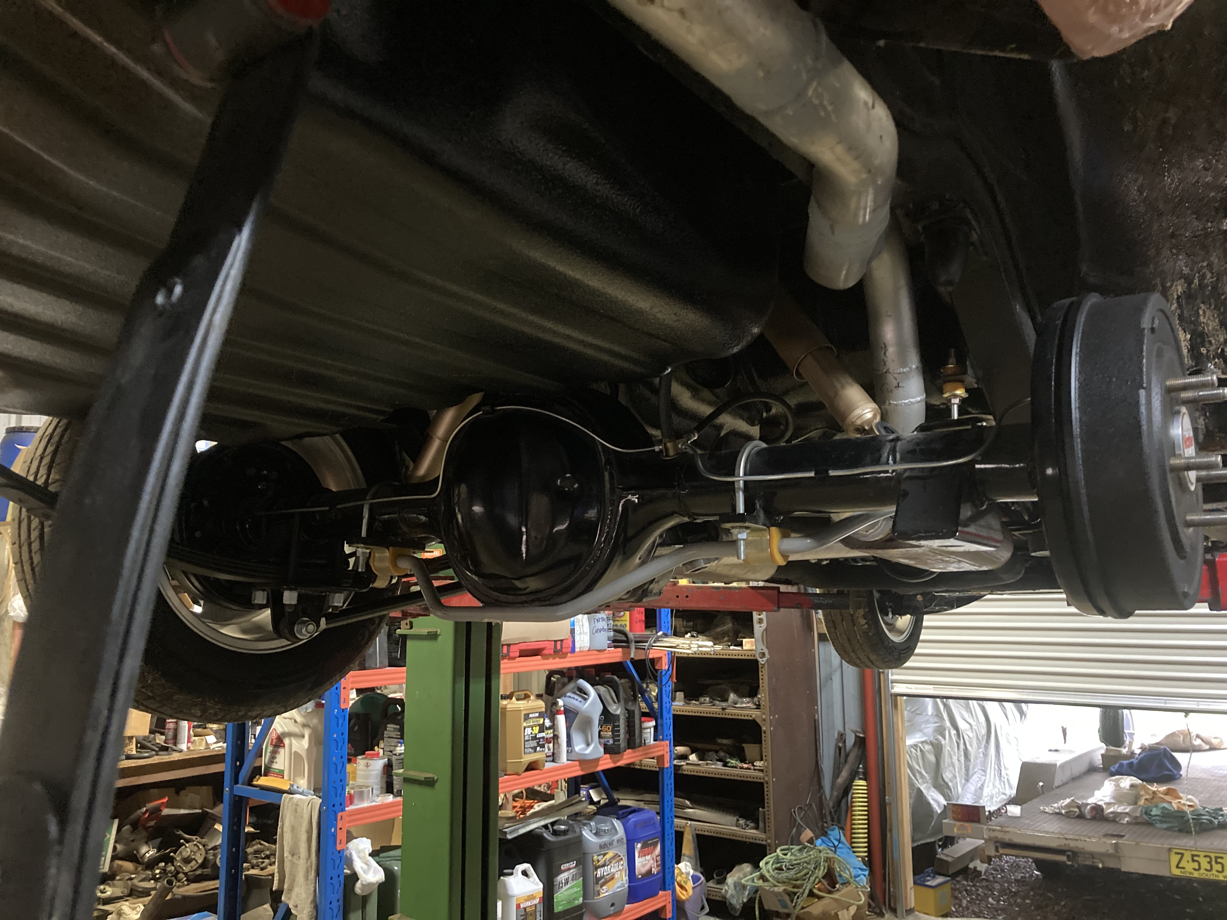

I have already done the rear springs with an original main leaf so it sits 25mm higher, solves another issue I had with the Caltracs and adjustment with ground clearance.
Now for some good mufflers but its difficult getting info on loudness, there are ball park figures but I don't want to shell out 500 bucks for a new set for it to fail again !!!!!

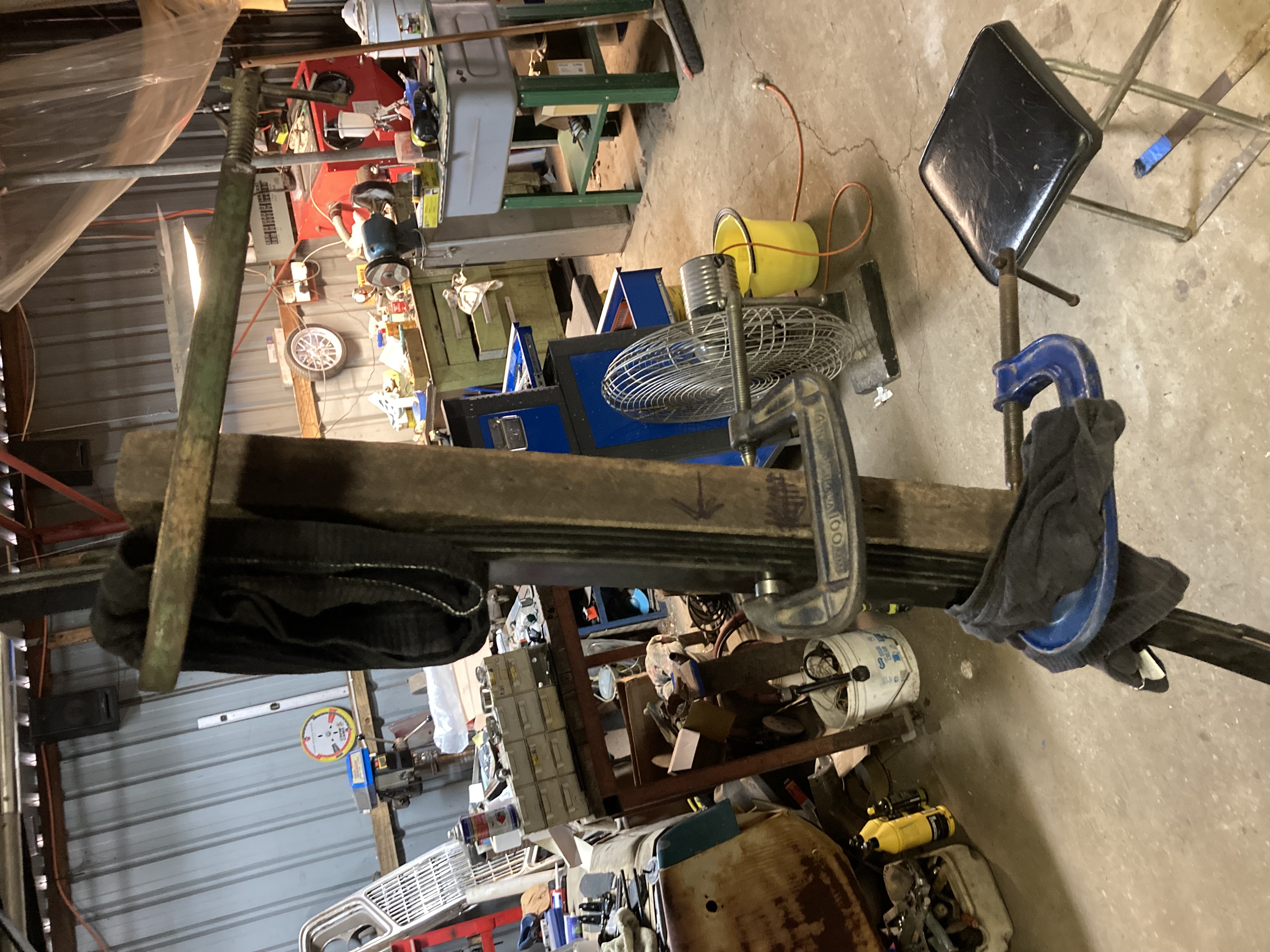

At least i know my sway bar works and a trick for getting the spring back into its position (make sure its hardwood if your going to do it !).

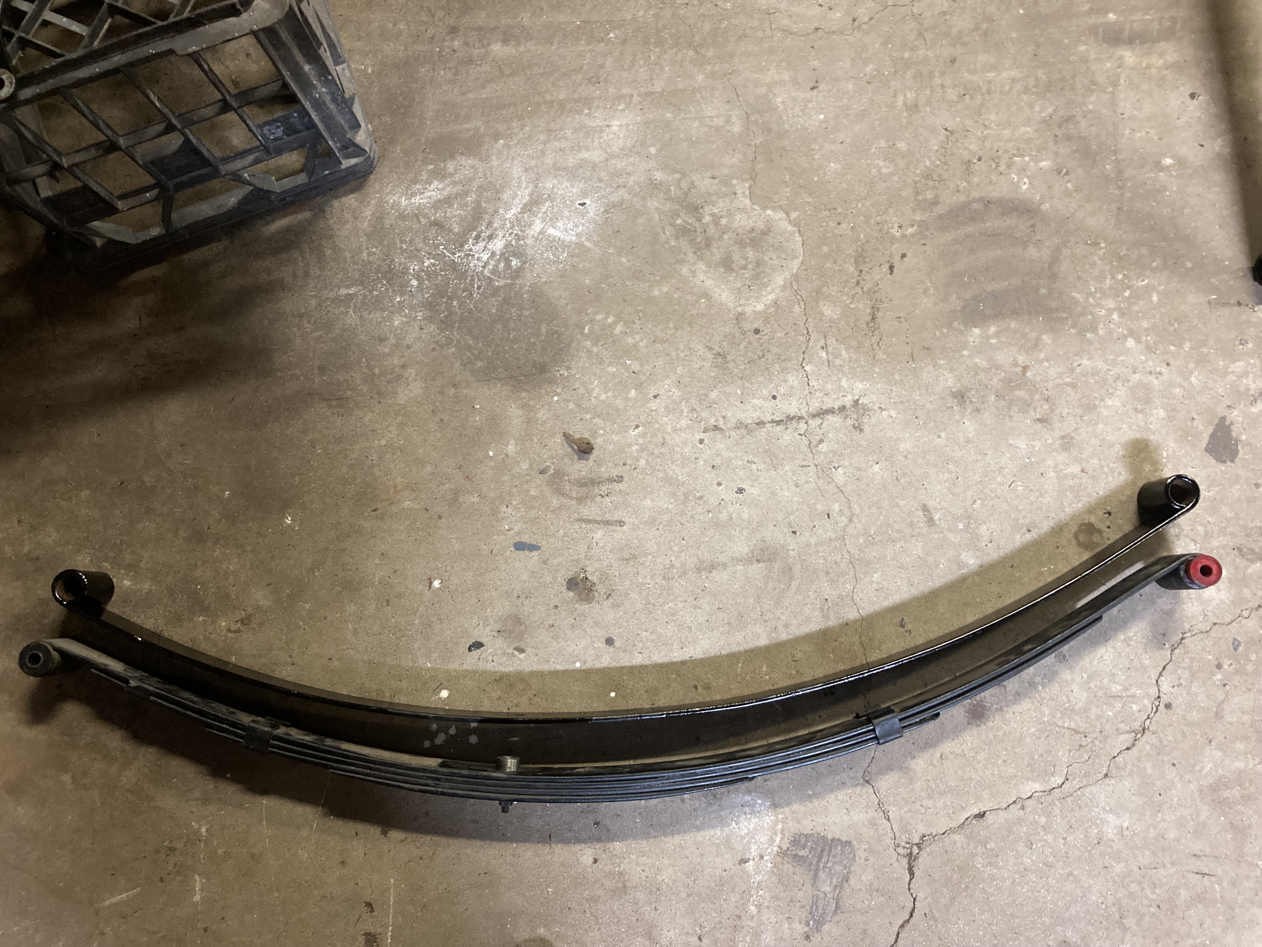

So I have a pair of hot rolled reversed eye main leaves, they lower the car 25mm without loosing any suspension travel or using lowering blocks. I can no longer use them but am willing to swap for a pair of standard main leaves should anyone be interested.

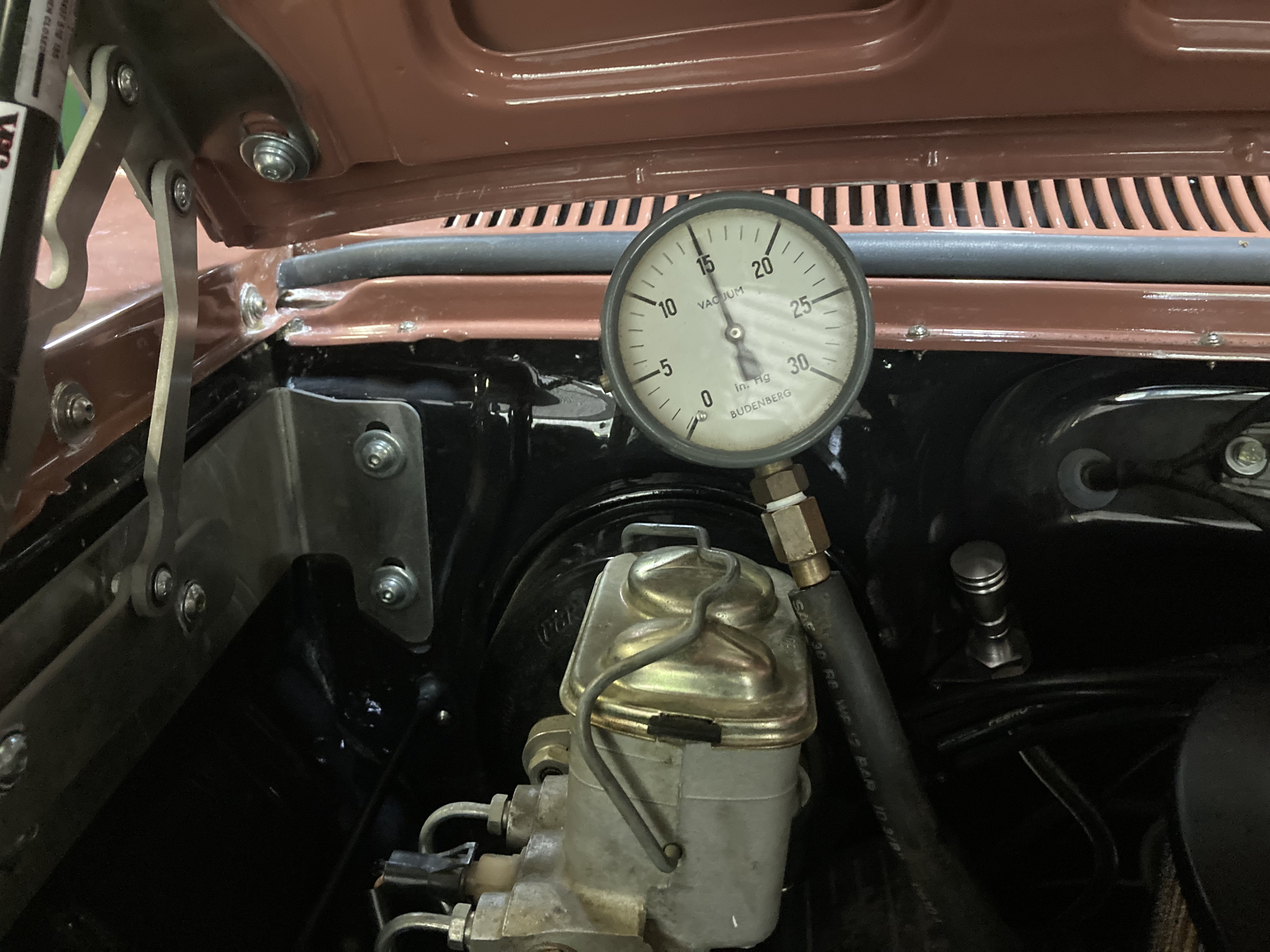

Pedal length is ok so I tested the vacuum. I have a gauge for this but i am not sure why ?? I have never used it before nor do i remember where it came from ( must be loosing my mind ).
Anyway at 1000rpm I have 15 in hg so this should be enough to get the booster working.

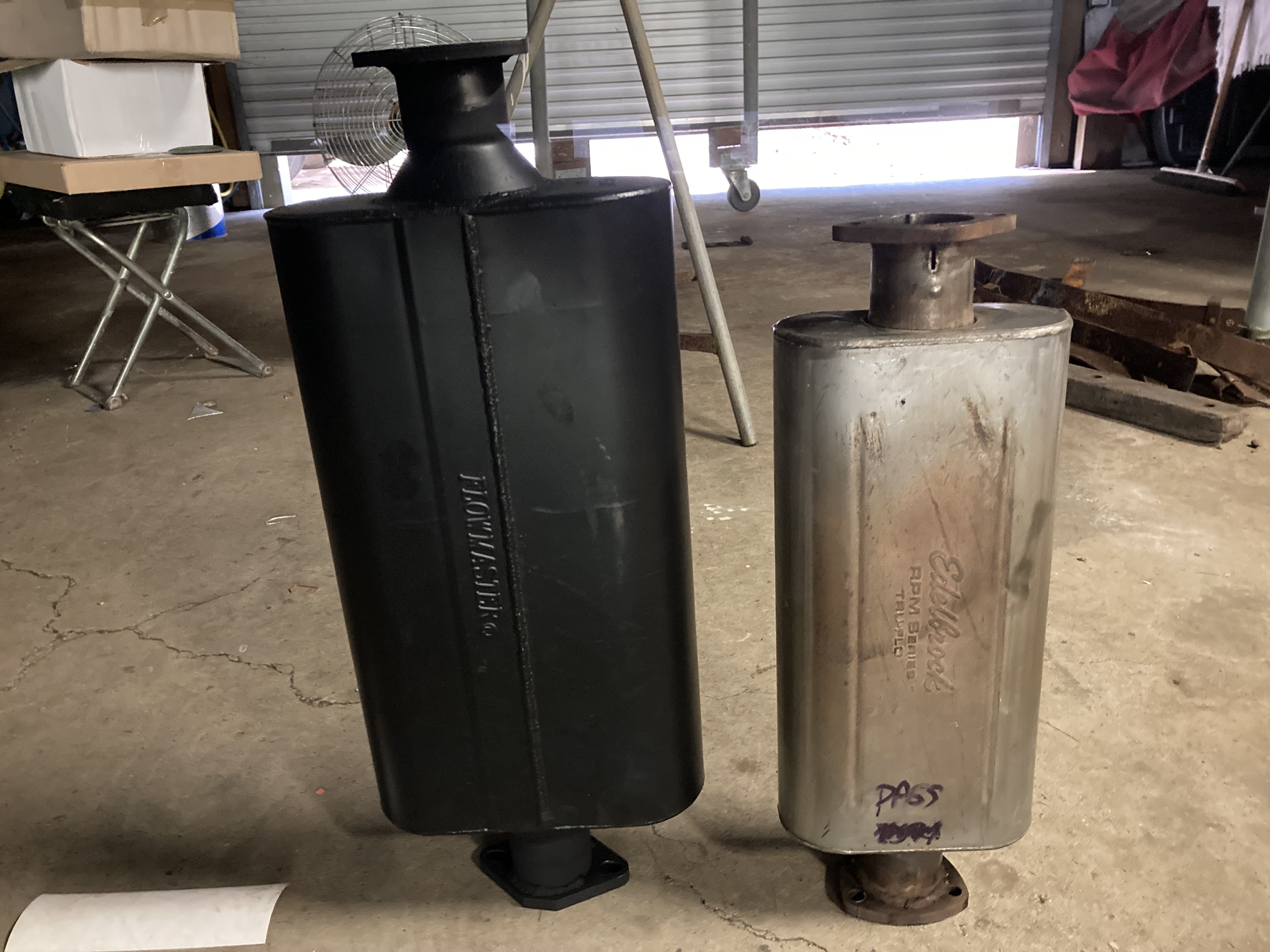

I lashed out and bought some big mufflers, finished them yesterday and did a quick test with a phone noise meter (not sure how accurate).
I ended up with readings of 86DB at 3.5 meters away and 91DB at 1m away and that was in the shed as well ! Fingers crossed.
The mufflers are Flowmaster chambered 50 series, they are quite big but still give the car the V8 rumble only much quieter.

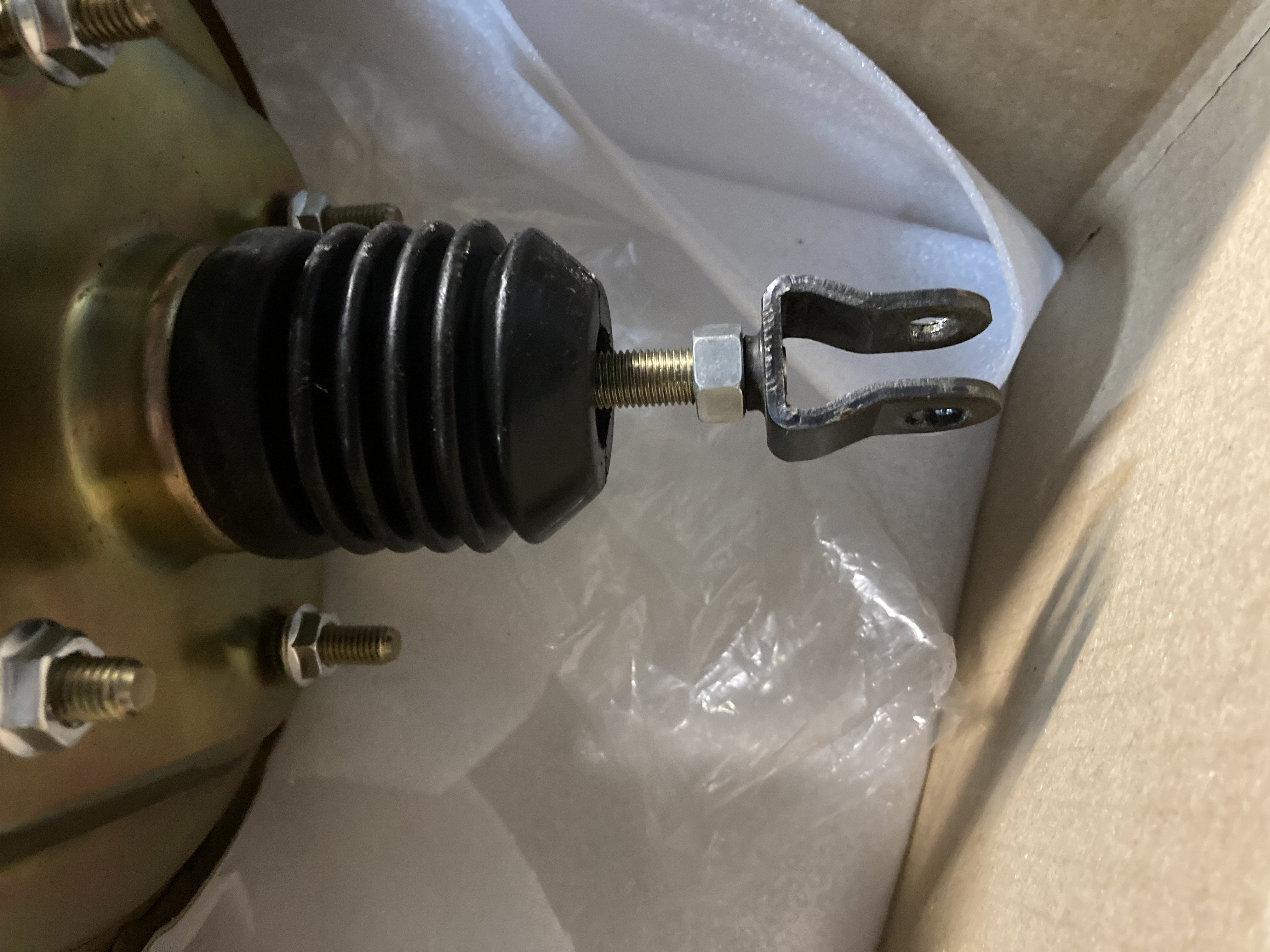

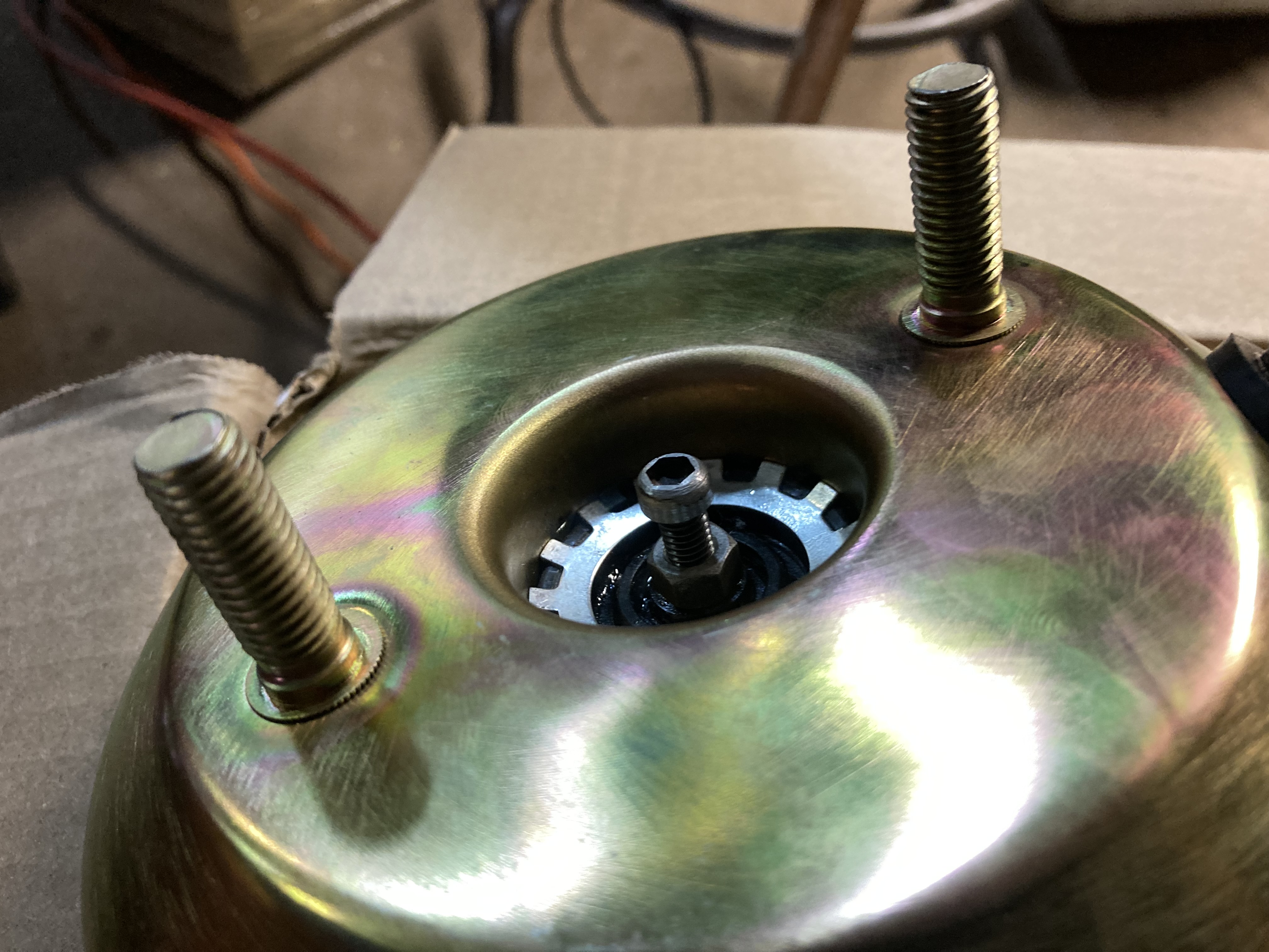

I thought i would start the booster today, looks shit and I dare say Chinese crap but there isn't any real choice without spending days measuring and trilling.

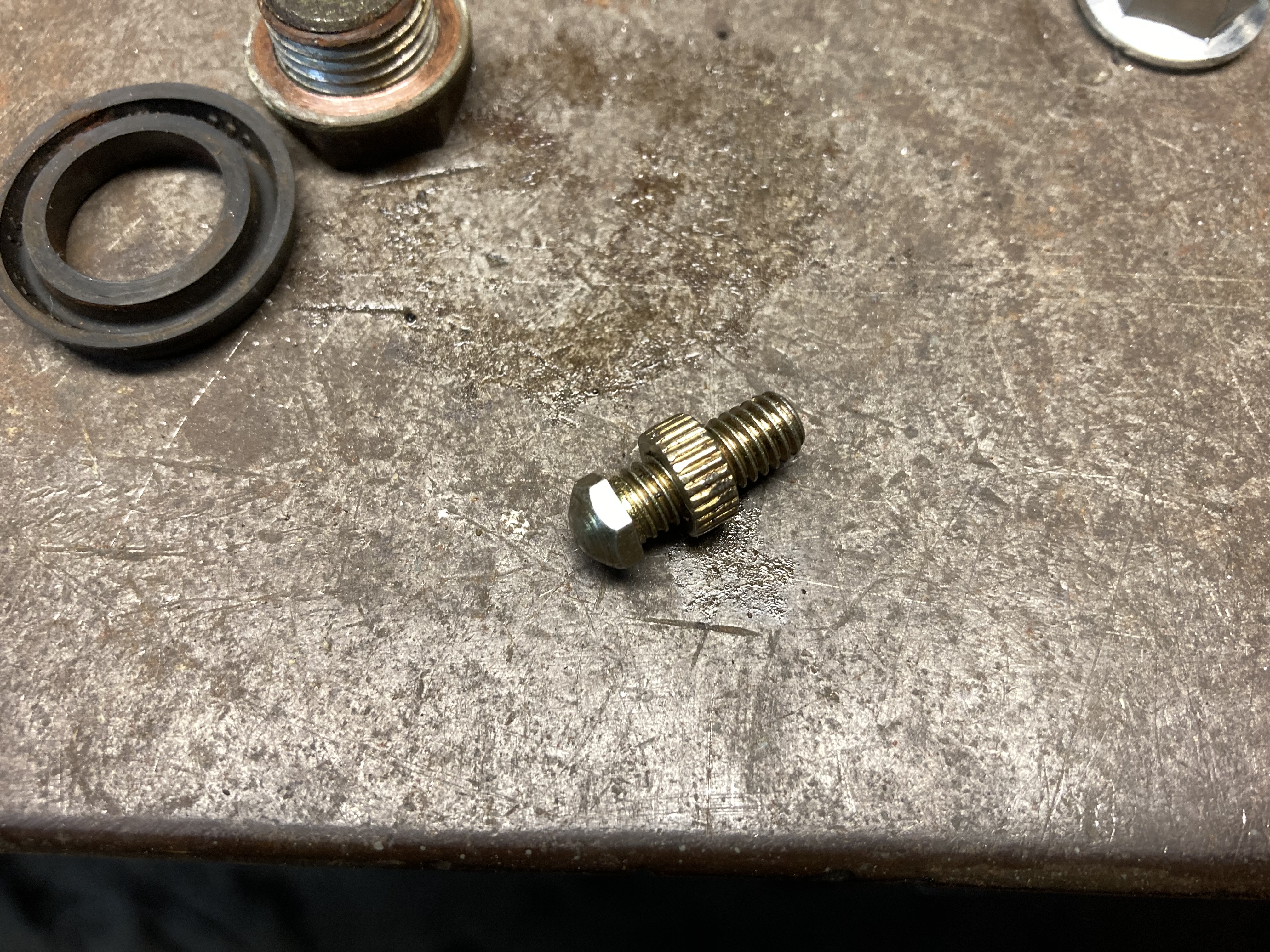

Firstly I had to make up a longer pin for the pushrod to suit the XB master, the chinkanese pin has a small knurled lock nut and I wonder how you would lock it in without destroying it, it was loose when i took it out.
I made a new one with a high tensile cap bolt, rounded to suit the master and enough allen to tighten with a proper lock nut. The allen head can hold some grease which is a bonus.

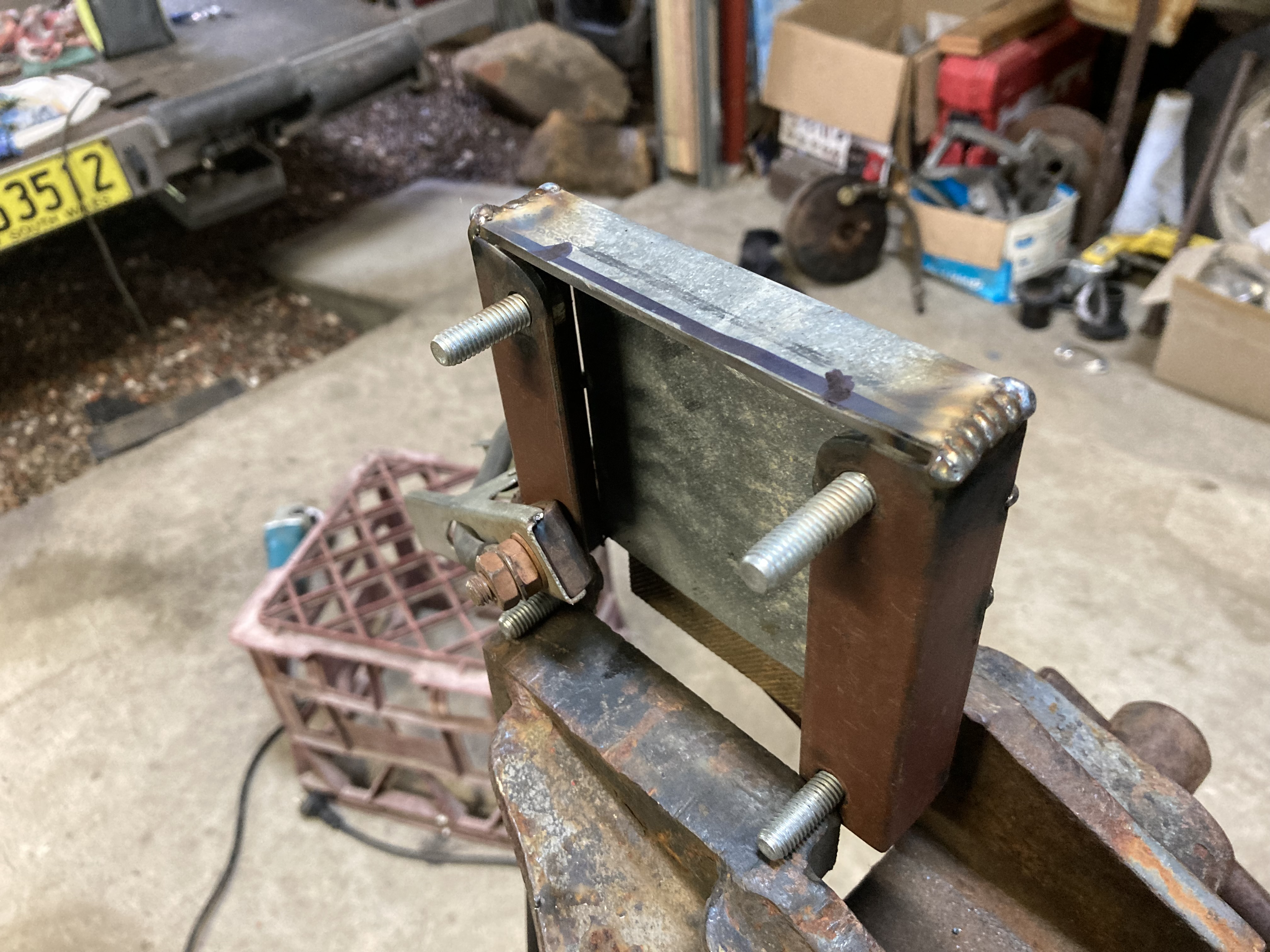

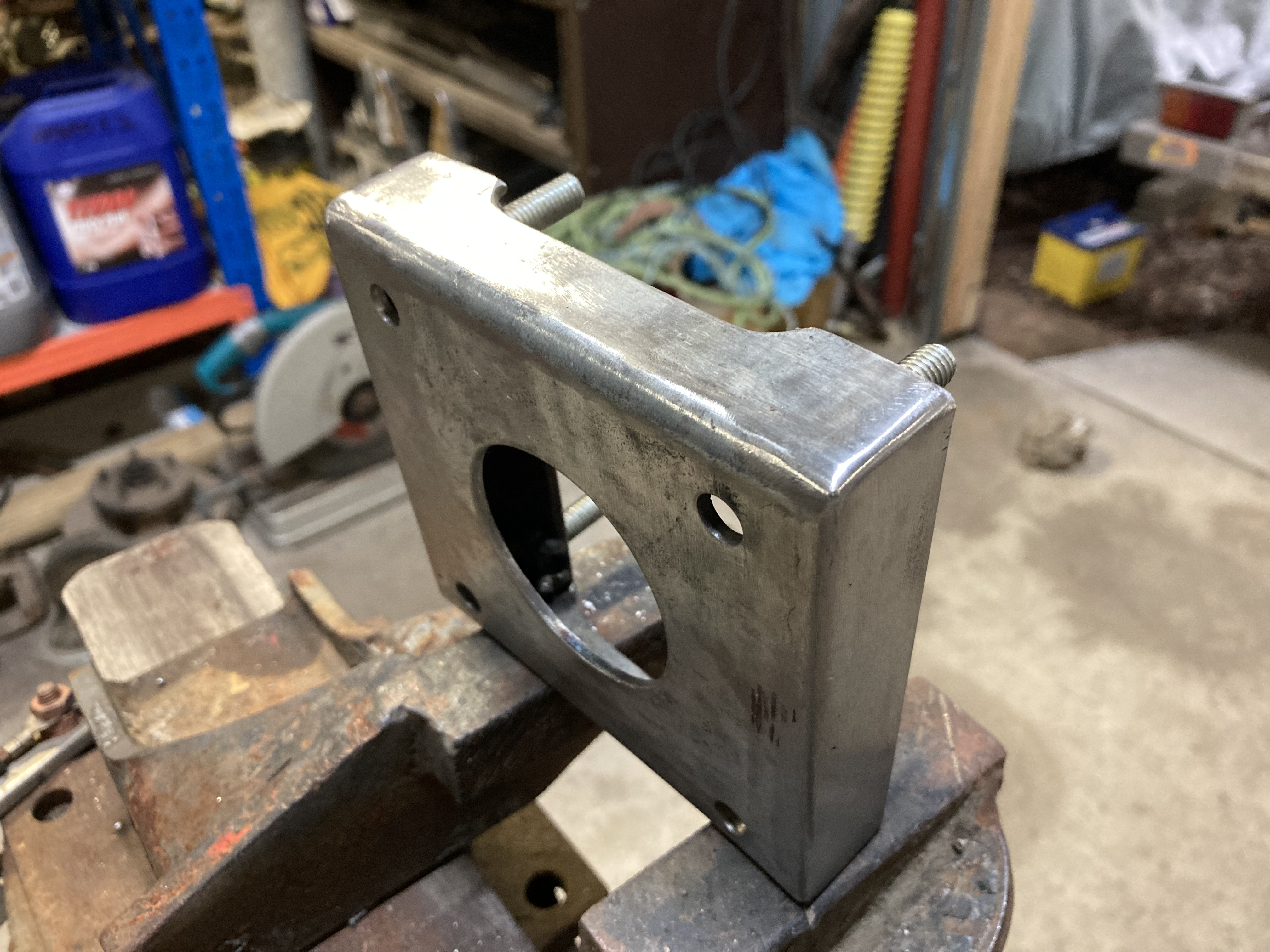

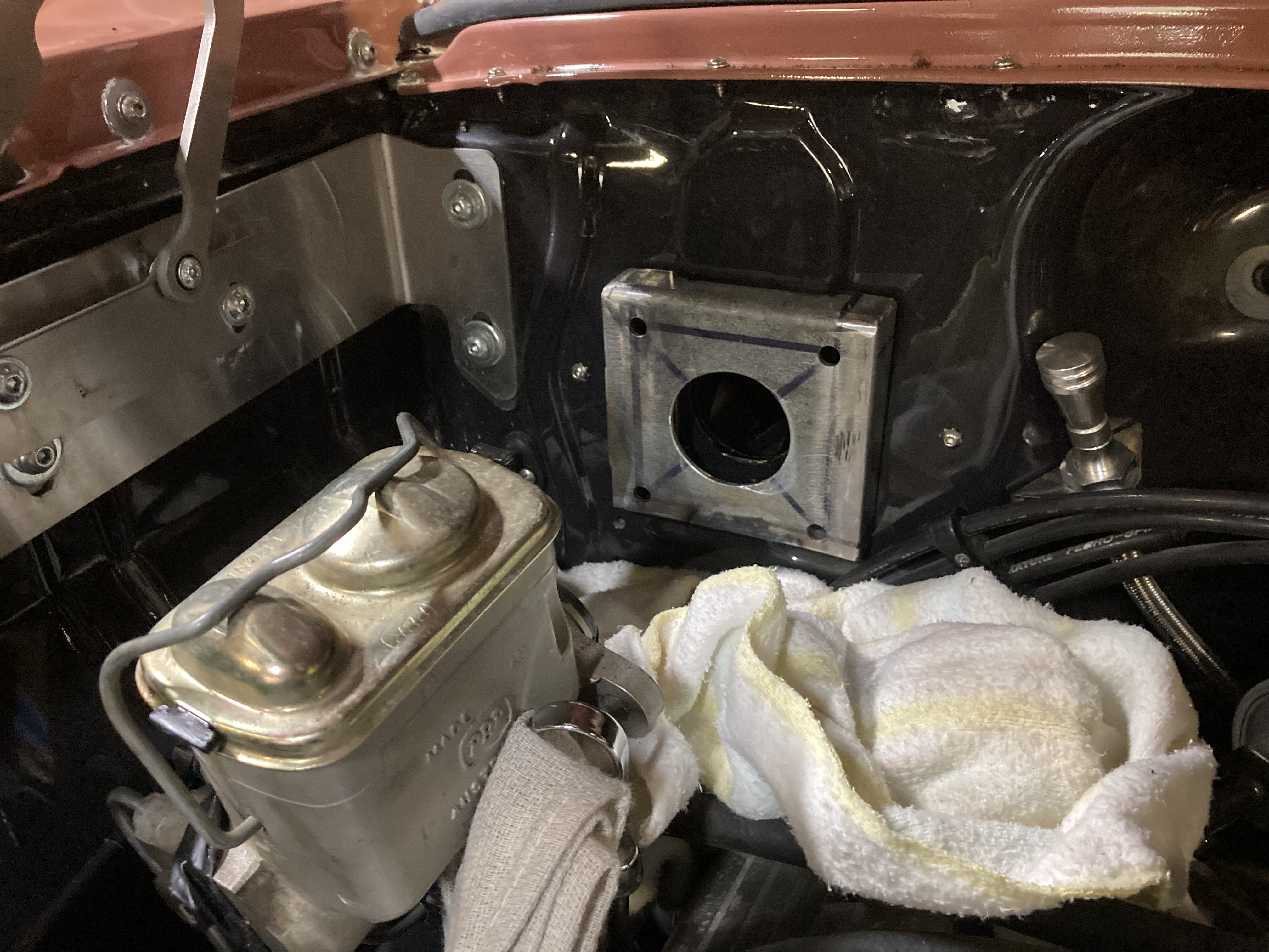

Unfortunately the bolt hole spacings are 86mm as apposed to 90mm the gemini booster has so I had to fab a bracket to change the attachment sizes.
File finished of course !!!!!!
The only good part so far is the clevis fits and i have enough pushrod length to have the bracket in place so there you go !!
Waiting for the bracket to dry and install tomorrow, if all this fails I am going to use an original fraud 9 inch dual booster, the bonnet hinges give me enough room to do so, I just don't have any faith in the Chinese made stuff but we shall see !!!!

Tidy work on the fabrication Greg, but then I’d expect nothing less.
