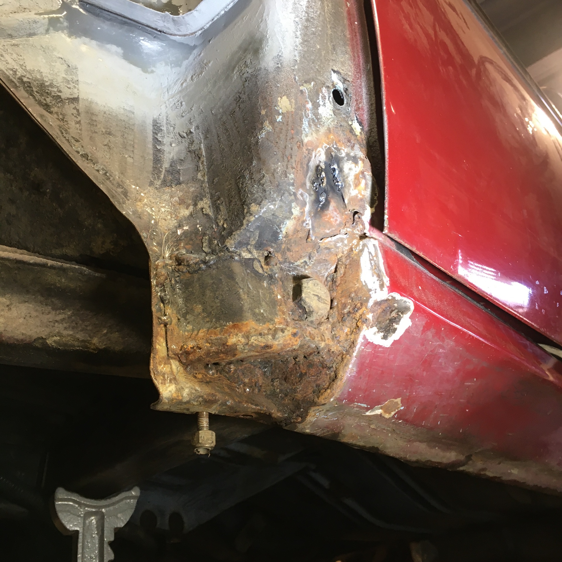

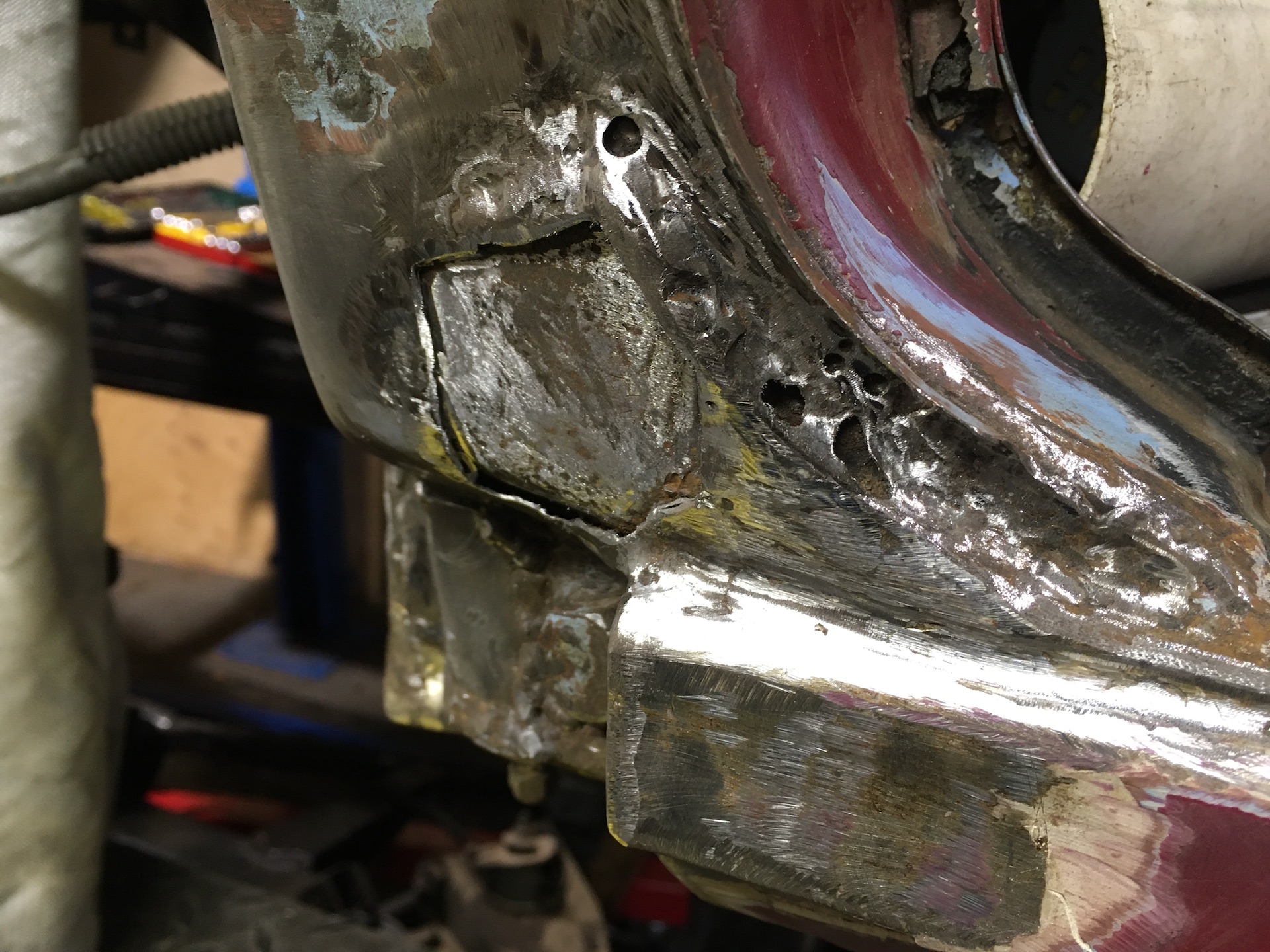

So next job which I started a couple weeks back. Passenger A Pillar
Lower A Pillar.JPG (915.19 KiB) Viewed 1056 times
Had a bit of repair work done at some point. Hit it with the wire brush to reveal a bit more. Part of the patch just came off in my hand.

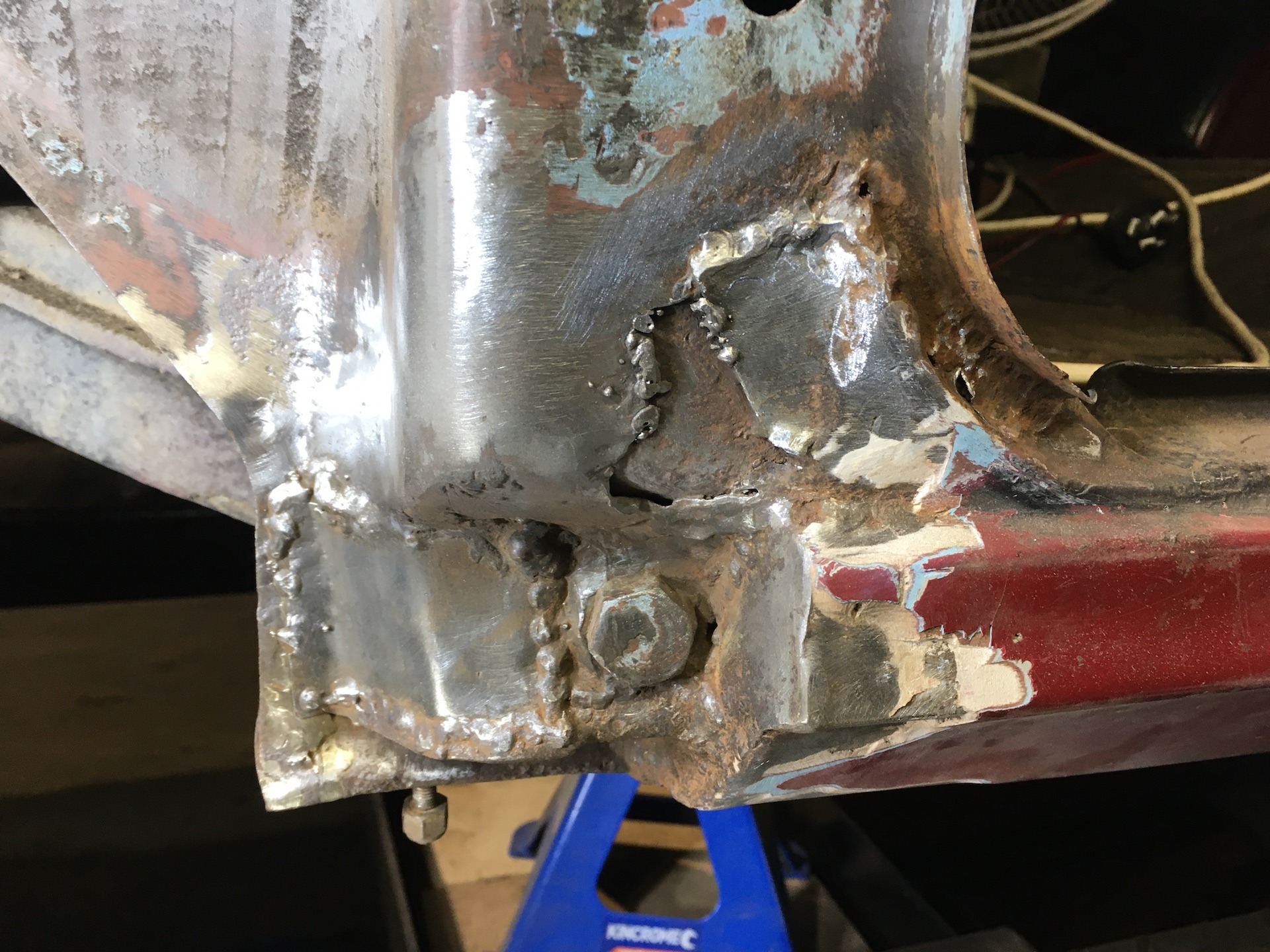

Cut and dremel out the rust. Going to try and fill in the lip with weld to avoid making a replacement section
LAP 3.JPG (757.9 KiB) Viewed 1056 times
Much welding and grinding later I have this. Possibly should have not been so lazy and cut more metal out. Was worried my skills with metal fabrication would be worse than those with the welder!
LAP 4.JPG (879.96 KiB) Viewed 1056 times
In the end I have this. Not awesome, still a bit of work to do.

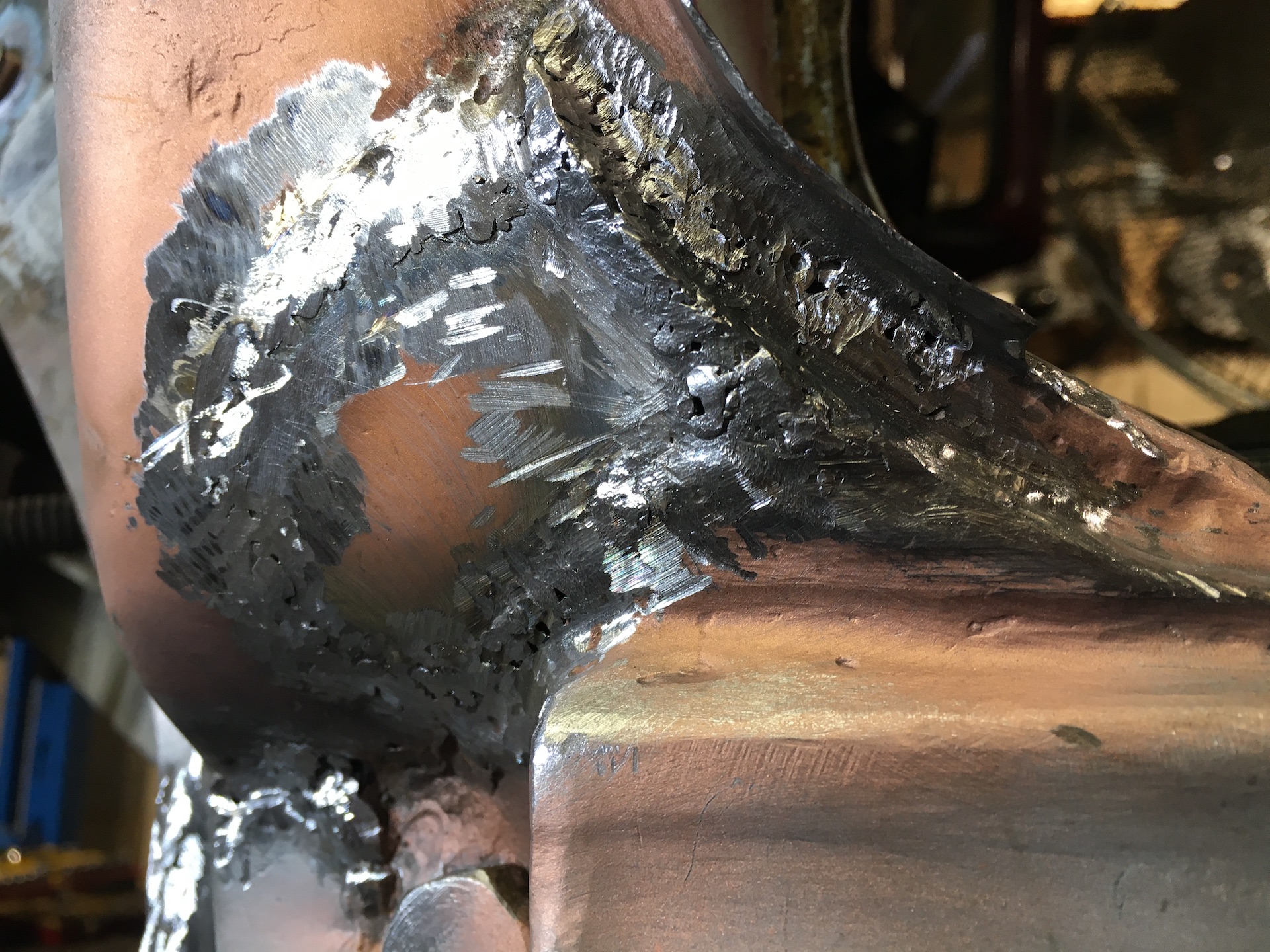

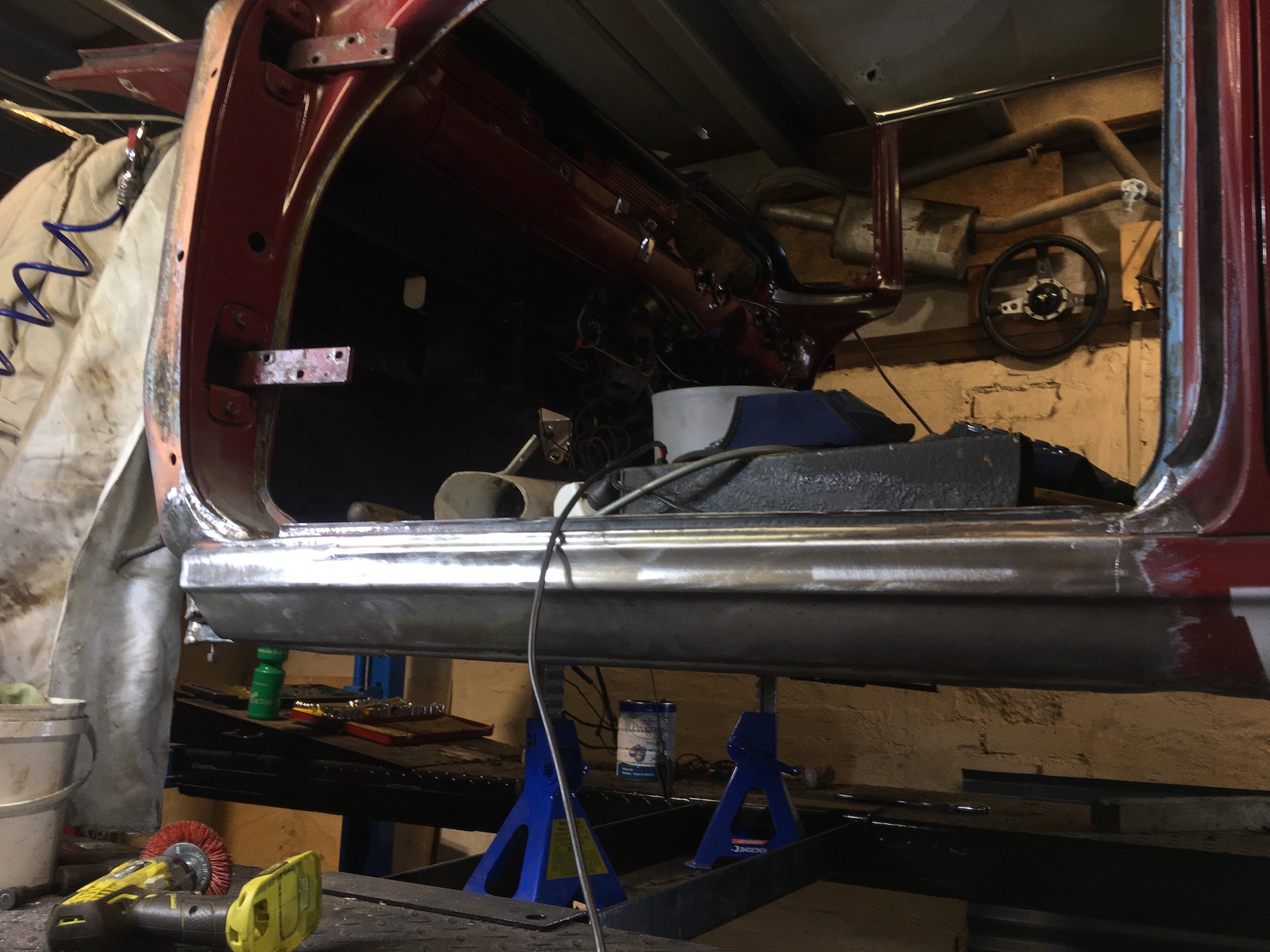

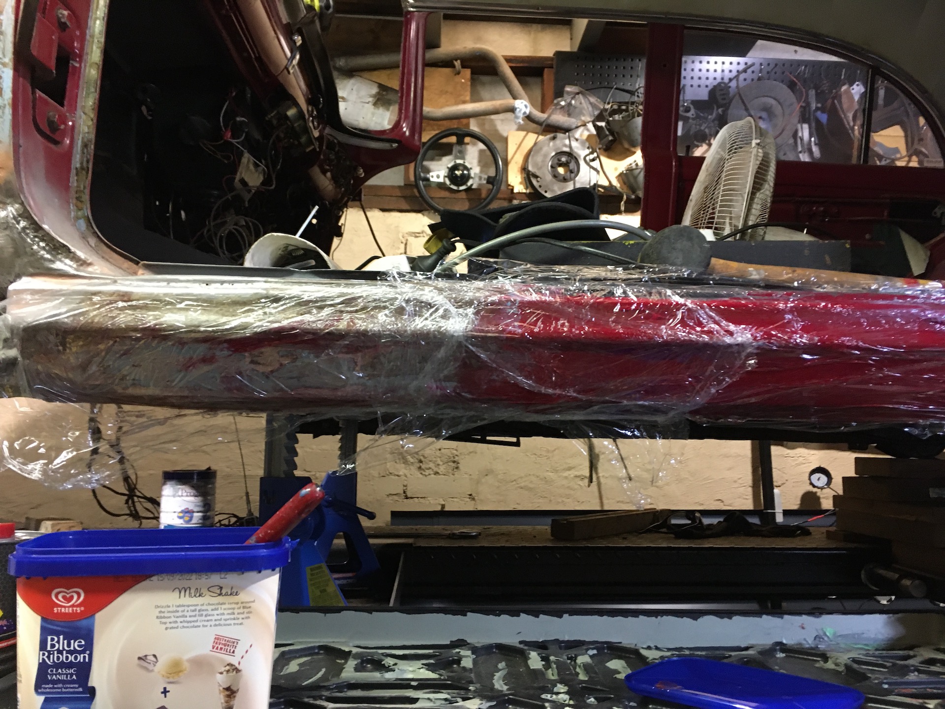

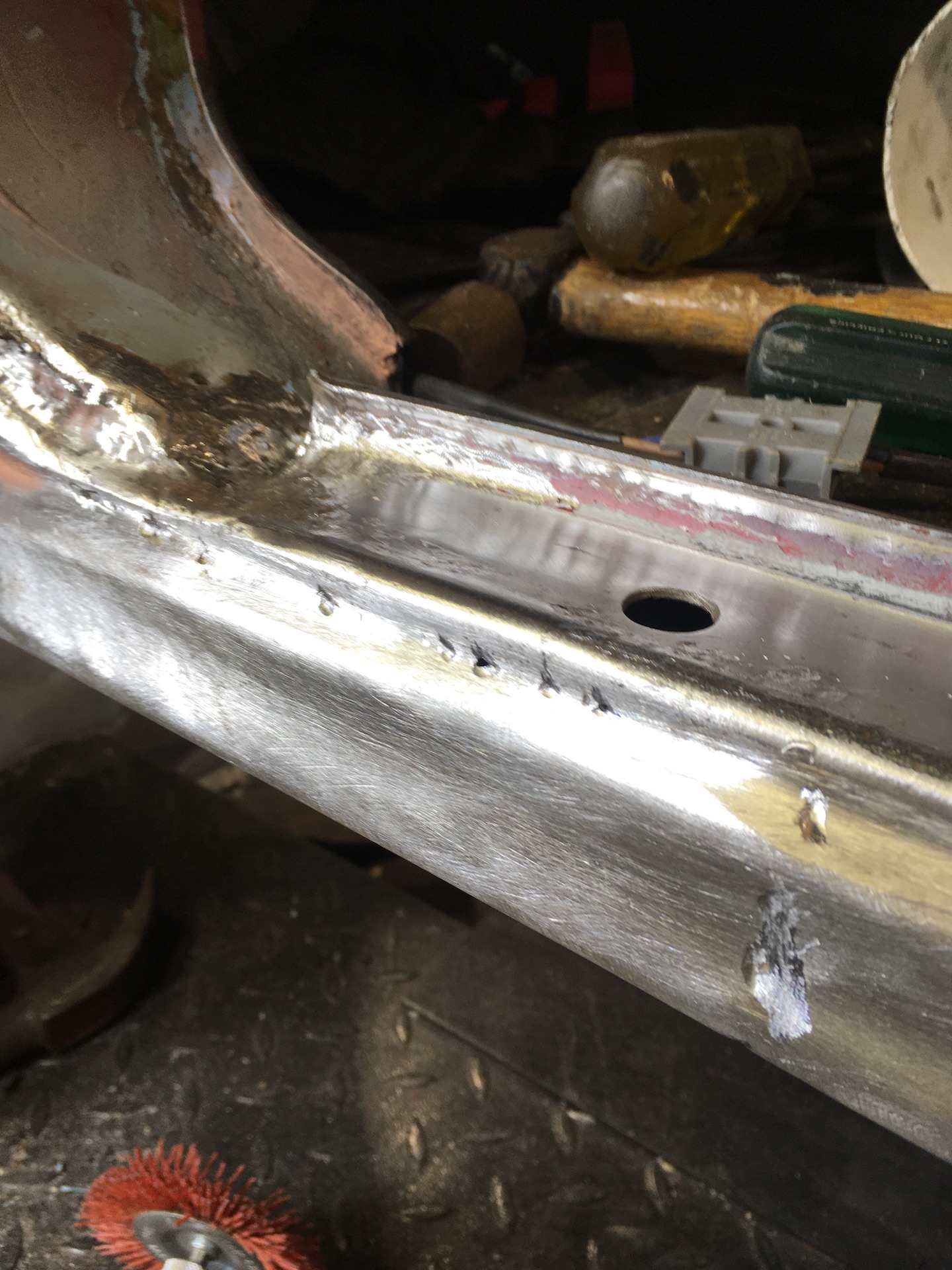

Next - work my way down the sill. First to the B Pillar. Hoping to not find any surprises like the other side. Paint stripper, wrapped in plastic to try and stop it evaporating.
Scrape and repeat 3 times to get all the bog out. Would have used a disk in the grinder but trying to keep the dust to a minimum. Final go over with a wire wheel and the dremel in the tight spots reveals this.
Sill has been joined - you can see it on the RHS and running along the top. Attacked it with my sharpened screw driver revealing a couple spots of rust under the sill and a couple small holes along the top. Filled as much as I could with weld. Grind welds and flap disk got me this. I've got at least half a sill.

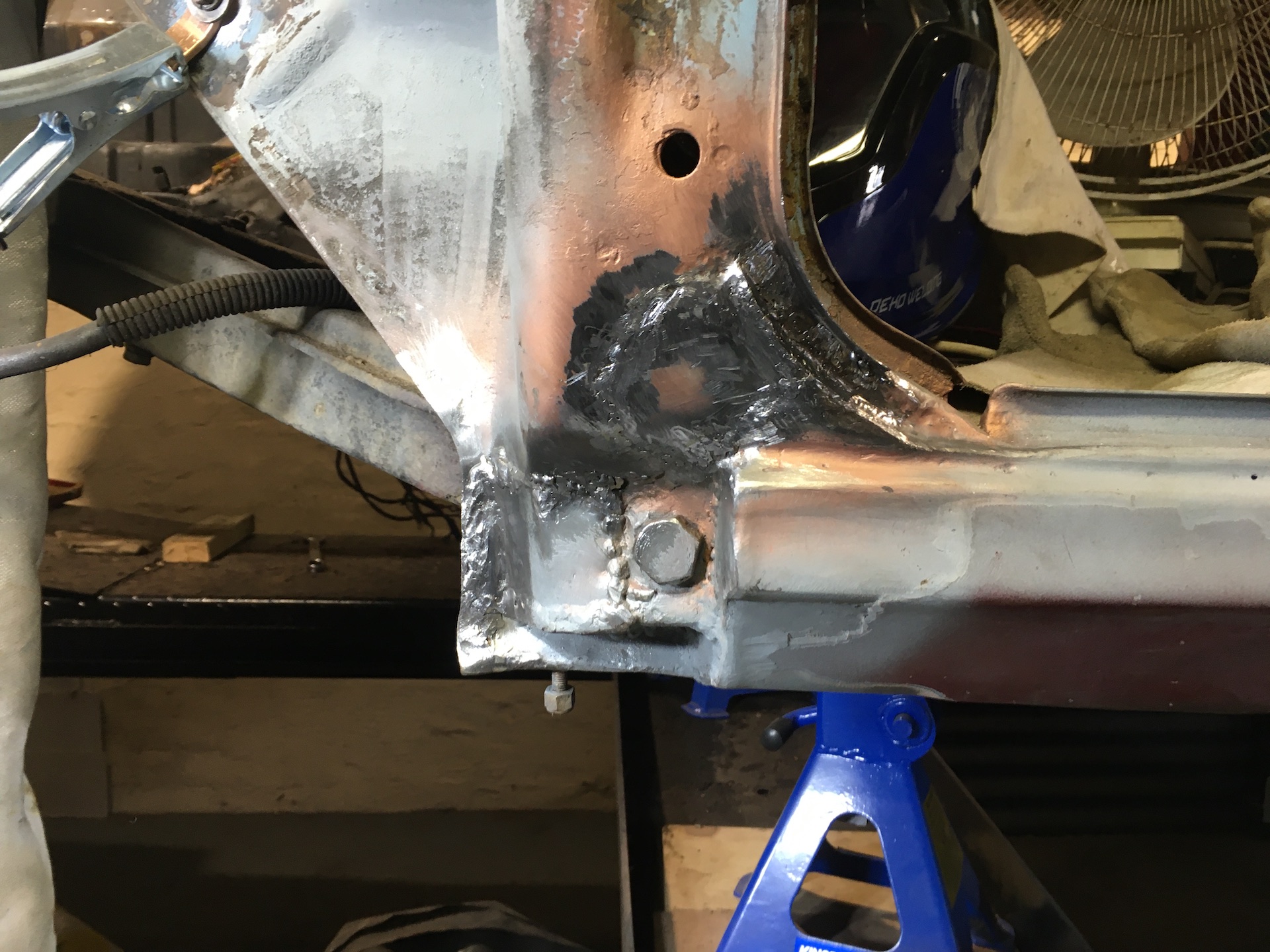

Did a bit more welding on that A Pillar. Thought I did ok. Then I looked at the photo. Still got a couple small holes at the top. Be out the again tomorrow. Should have made a patch!

You're going well Scott. I'm interested in that circular hole cut in the top of the sill. Metal seems to be thicker than normal or is it an illusion?
Re: Ol' Rusty - FB/EK Sedan
Posted: Thu Nov 26, 2020 8:55 pm
by funkyscooter
It’s one of the 4 holes in the top of the sill. 2 each side of the B pillar Illusion maybe? Although I’ve never looked at another sill so really not sure.

funkyscooter wrote: Thu Nov 26, 2020 8:55 pm It’s one of the 4 holes in the top of the sill. 2 each side of the B pillar
Most likely used for rustproofing the sills back in the day.
