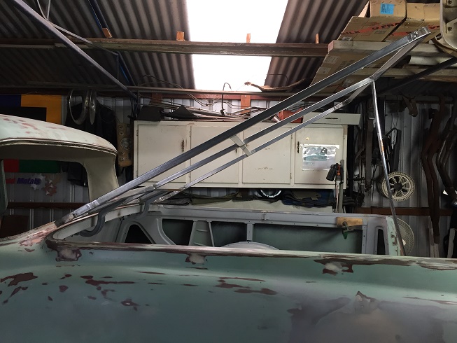

I have parked the hidden tailgate hinges for now so moved on the hard lid.

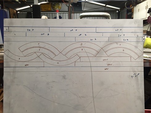

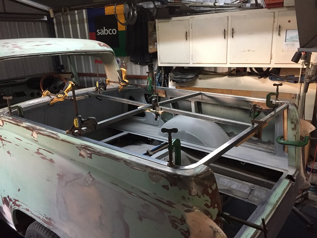

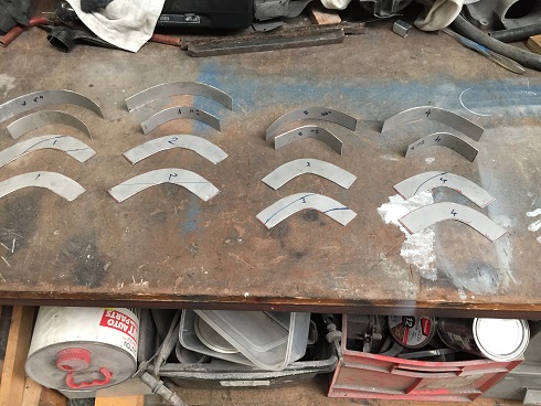

Thought this would a couple of days work but under estimated the complexity of the curves in the tub.
Due lack of tube bender, I decided to make the corner pieces.
I used a couple of suitable tins in the shed then made cardboard templates. Transfer these to 1.2mm sheet and cut out via cutting disc. Cleaned up the curves and place these in the corners to confirm I had it correct.
The corners are not regular simple curves so binned the lot and started again. This time marking the cardboard against the tub. Cut out each piece and welded together, sorry no photos.
Checked the back ones and happy with each but then I had to modify the front ones to follow the downward curve behind the rear window.
I should have just made a rectangular frame and not tried to be smart and tuck it in neat on the tub.
Too late now so pressed ahead.
Bend the front tube to follow the curve by using my small hand bench press.
I have it held together with every clamp that I have and will weld up tomorrow.

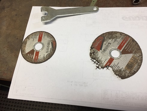

Safety tip - wear a face shield when using thin cutting disc.
This one of 2 that I smashed today. The other I could not find but it is in the shed somewhere.
Also the other disc grinder is fighting back after I knocked it off the bench a couple of time. It jumped and bit the back of my hand when I was holding a piece in my hand.
I did seek comfort and medical attention from Anne-Marie, my wife but got none, when asked if I was wearing gloves. I should have fibbed and said yes.

You got there mate and tube frame looks like a very good start. Clever idea to fabricate the corners, hadn’t thought of that. Reckon you could mount a wing on the back for some downforce.
Would need some serious struts but what about mount tailgate to hard lid and turn into a hatchback ute??

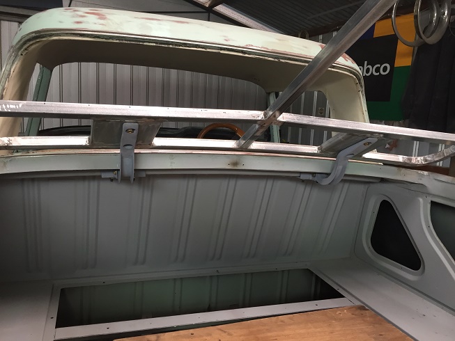

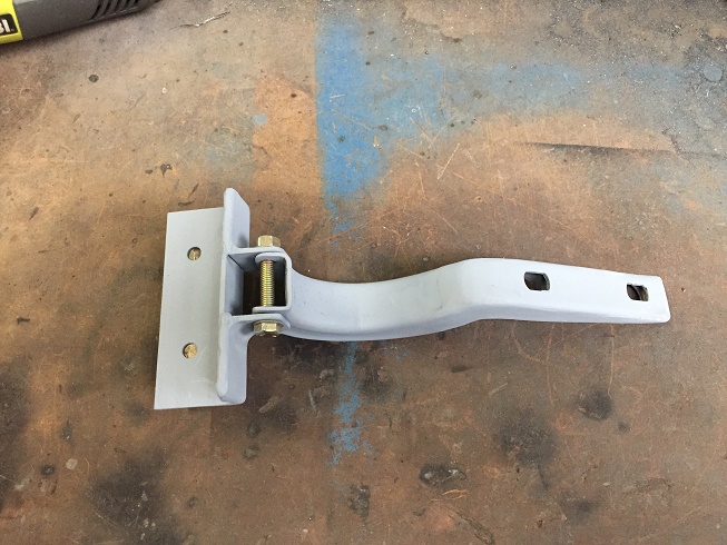

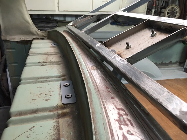

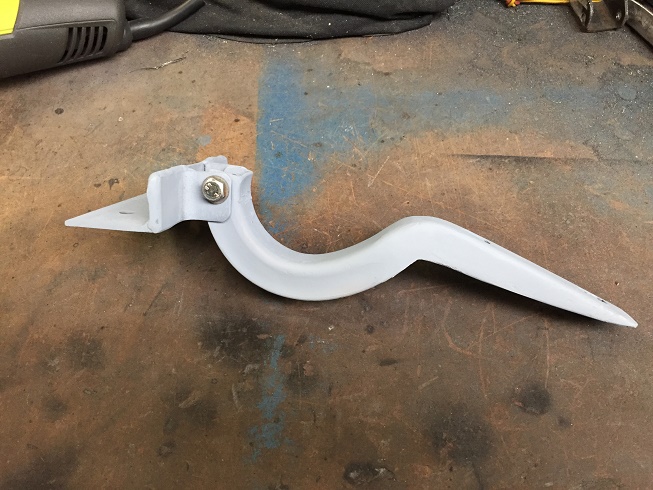

I have completed the hinges from the hard lid at last.
Thank you to Chopped for your advice and photos.
Thanks to Neil for the lead to FE-FC forum to see what one of the guys did to his ute.

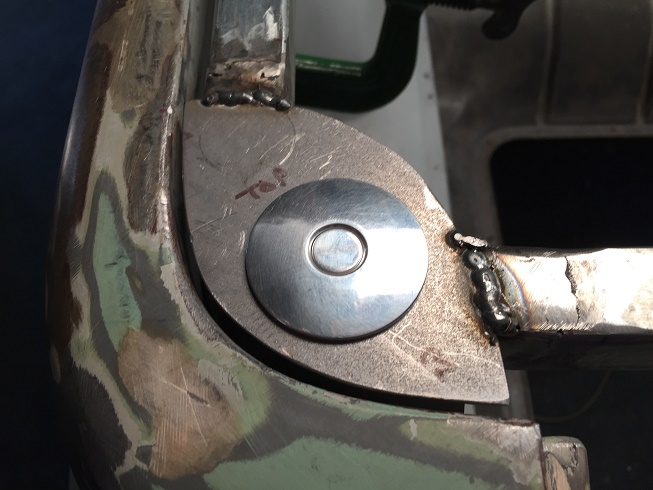

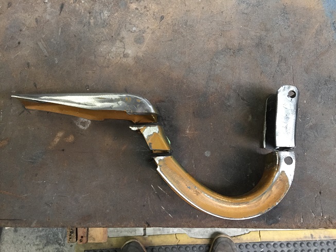

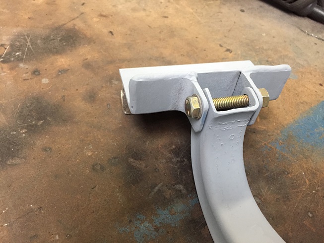

Started with these off of a HJ sedan After a number of cuts and weld finished with these. As you can see a lot different to what I started with. No decision yet on the material for the hard cover but may go the way of aluminium composite but now thinking of a thin edge so the flow of the rear quarter is maintained. This will be covered in black vinyl and possibly padded.
The hinge mounts are 50 x 3 angle and cut sit under the parcel shelf. Added 40 x 3 brace to spread the load on the parcel shelf. I purchased the quick release pins but could not get black ones so now will anodise the silver ones to black.
Looks like I need to modify the rear corners to fit in these quick release pins. Rain coming so will pickup my tinkering on the tail gate hinges again.

You've nailed it rog. Be sure hinge mounts are braced to the frame.

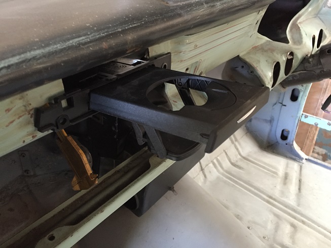

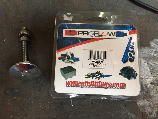

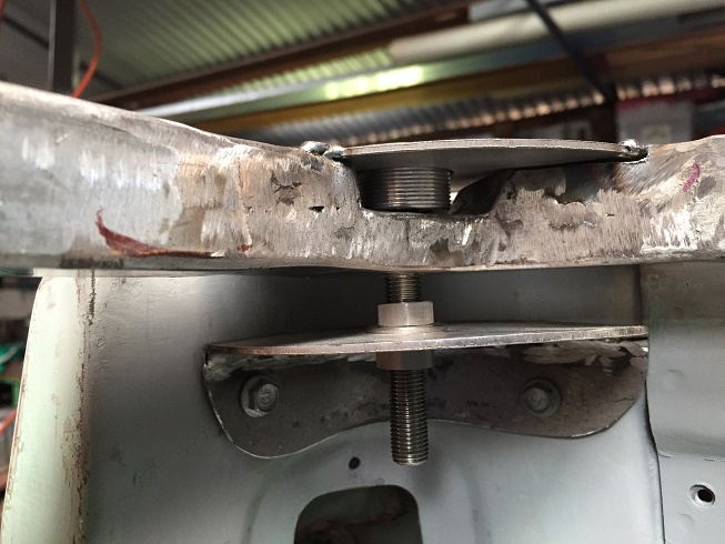

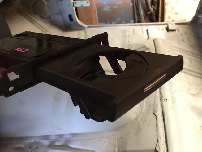

Completed the hold down and need a grind and clean up. The essential cup holders have been an interesting challenge, from centre consol to swing out under dash mounted but I think I may have a neat solution. Ex BMW, in-dash pop out. Actual mounting in the dash is undecided as yet. There is space above the ashtray but it is fairly close to the heater core and no room under the ashtray as the heater box to wide.
