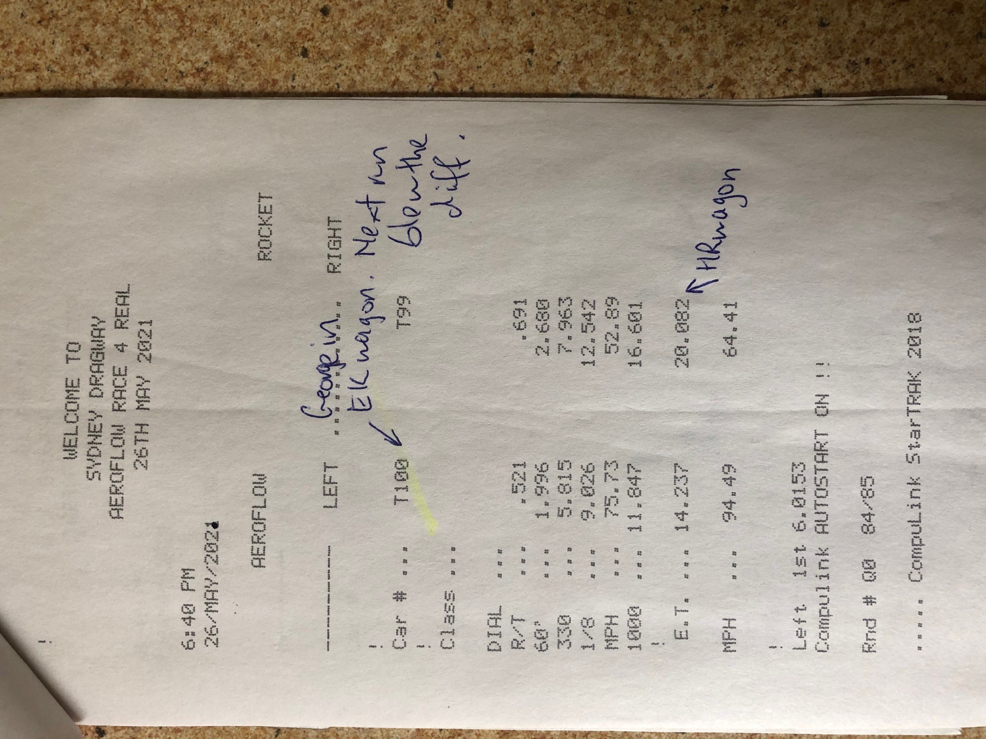

Each motor runs differently, from launch through to the traps. The table here though is not a bad guide to analysing the incrementals:
https://www.musclecardiy.com/performanc ... -traction/
Brian's incrementals are pretty close to the mark. The bottom end of the chart is a little quick for your times (for now 8) ), but you can probably graph them out and extend backwards to a 15.7 quarter.
For shits-and-giggles, this is the last pass down the quarter in my EK wagon (with the HR alongside :D ) before Number One Son grenaded the diff:
EK wagon timeslip.jpg (682.97 KiB) Viewed 7051 times
I'm a little sluggish in the 60', but then come charging home at the end. Traction is OK, but I'm runny a slightly slow torque convertor, and 3.08 rear end. A bigger stall or a set of 3.55s would help me.
