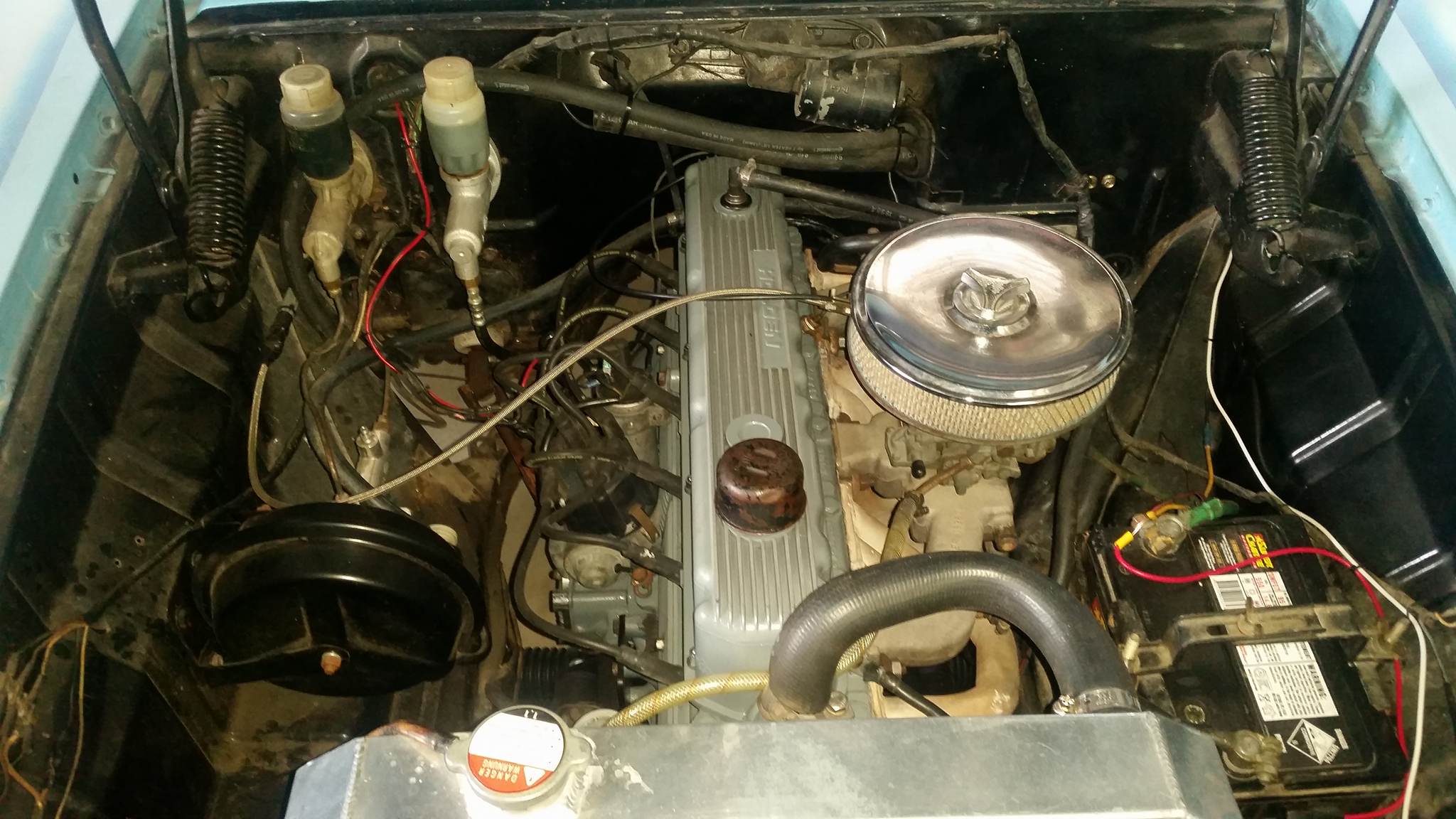

Blacky wrote: Thu Oct 03, 2019 10:30 am What rack setup did you go with Mick ????
bought an FB with it in it but it's a VC commodore manual steer rack rear mounted on a HR front, terrible turn ratio what would have taken 1/4 turn of the wheel with the original steering now takes half a turn of the wheel (these are approximates) (i know a bloke with an FJ that said his is the same and another bloke that did one for someone as a job that said the same thing) it still seems an improvement over the heavy wondery not direct steering that came out but the front mounts i've had have all had a good steering ratio
Posts: 4372
Re: It's baack
still gotta get around to some cleaning and tidying, but then again it's just the engine bay, but all done great improvement probably next job and one of the main reasons i took the grey out and went red will be an auto and more than likely 4 speed auto

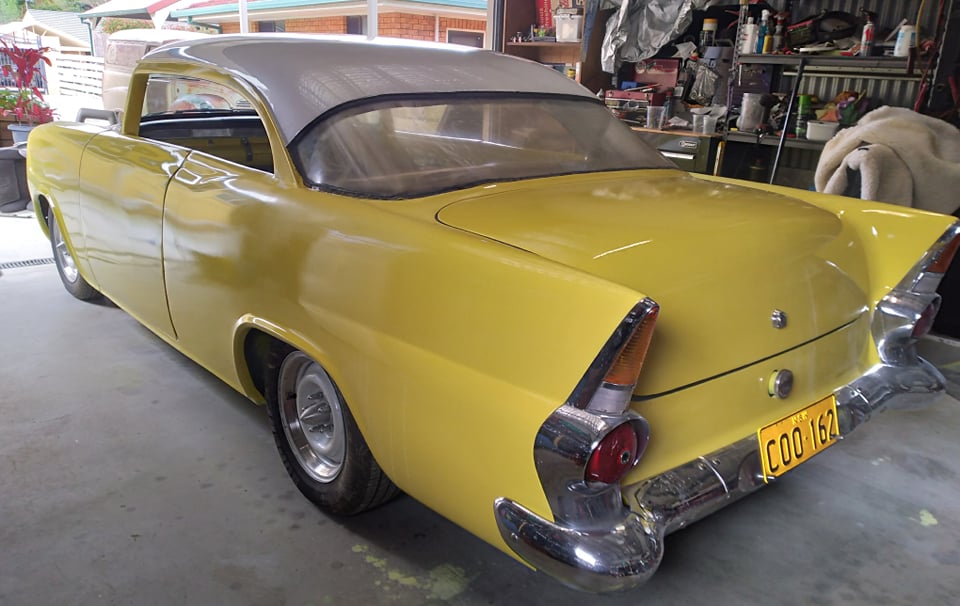

just went to Yamba for the weekend this thing now takes bumps better than my VY SS ute, steers great even though it still needs a proper wheel align steering is super light and direct though not a great steering lock (no great concern i don't spend to much time in car parks or doing U turns) and you need to turn the steering wheel more turns for same result, at slow speeds can effortlessly steer one handed
formula for a nice steering and ride while still having a low car
2" drop stubs on HR front end 2" lowered springs rear mounted rack and pinion (though the front mounts i've had have had better steering)
3.5" reset rear leaves, EH diff housing with LC/LJ torana bump stops (remove the factory EK/FB ones)

Mick, are the Torana bumps better than eh?
Probably just as well you don’t have much lock with 4” lowered front.
I don’t suppose the Pacific Hwy has got smoother since l drove my EK 215 through Coffs in ‘89.

torana bump stops are just much shorter maybe only an inch or so high
nah had full lock with stock steering though i had to cut some of the lip out of the front guards
Pacific HWY is now brilliant 2 lanes 100/110kmh (not fantastic through coffs as it's the only city/town they are still only talking about by passing all besides Coolongolook which is still 2 lanes and 80kmh from Heatherbrae) and past Coffs is brilliant 2 lanes 110kmh till about 15ks out of Grafton, but they are well on their way with the highway past there aswell
