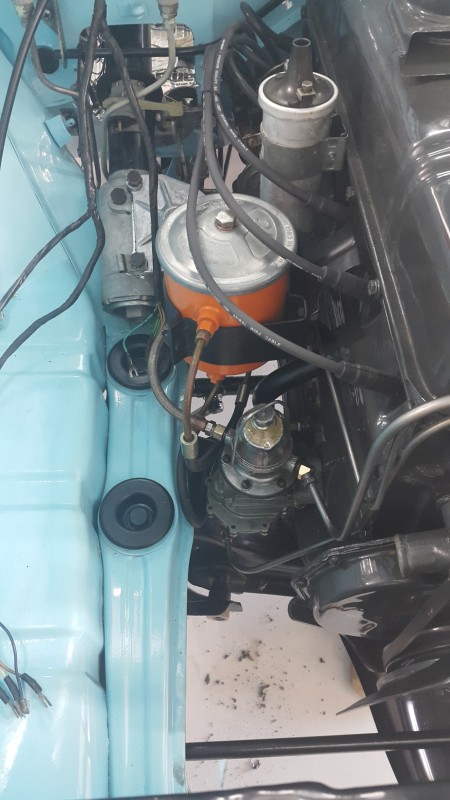

Yesterday was a few little jobs, because I had ran out of paint too finish the rear spring, and I could not be bothered going down to the shops for a can of paint, its funny, I go to the shops and buy some thing that I am after eg: a can of paint and as soon as I am home I remember I needed some gasket material and some sealant.
any way I knocked out the drive shaft, flaps under the bonnet and the battery tray.

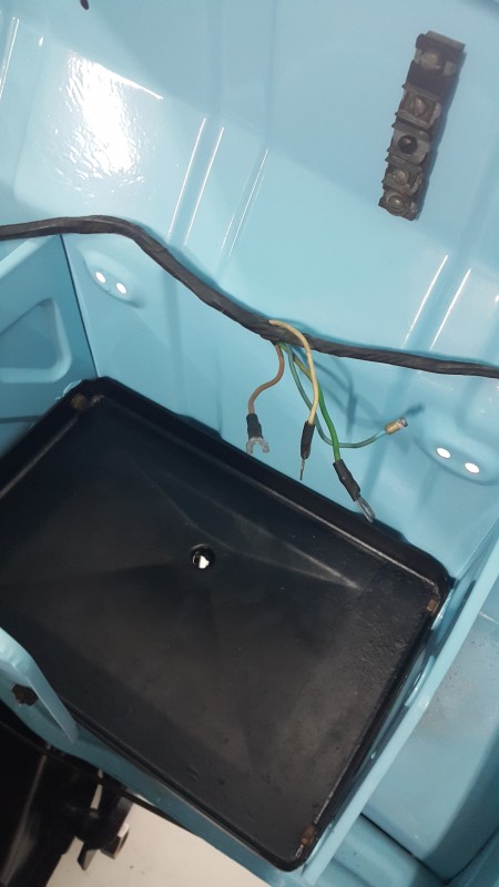

question: can you buy the rubber which fits into the sub frame (inner guard) holes which prevents the battery from rattling around?

does the rares kit have them?
You can buy new terminal blocks off eBay for the wiring on each inner guard as in your pic if they are a bit corroded - they are near perfect replicas

here you go - rares sell them as a separate part
http://www.rarespares.net.au/rarespares ... duct=H1248

Cheers fj wally. Much appreciated

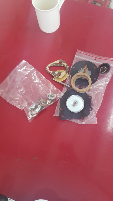

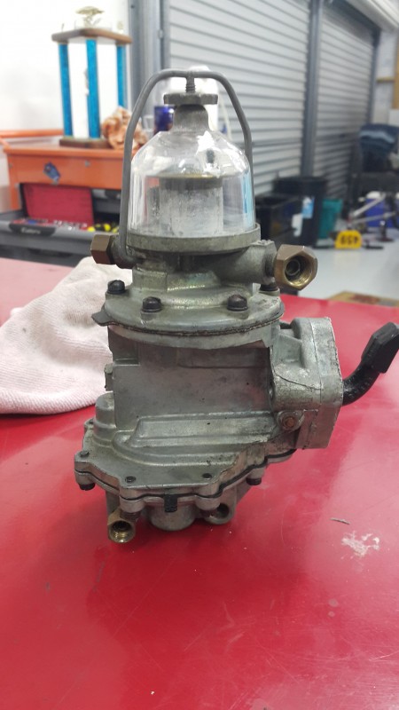

Removed the fuel pump for a rebuild kit.

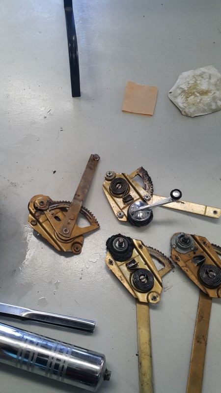

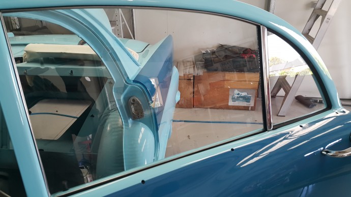

A couple of photos, I cleaned and greased up the regulators, I ended up doing all 4 as I installed the wrong one, found out i was the wrong one when the window would not wind all the way up, it stopped about an inch short so it came.

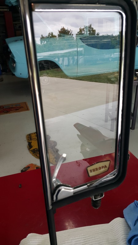

polished up the stainless on the window divider and a lick of paint, new quarter rubber, bailey channel, the glass got a good clean with the rest of the bits, and it all turned out good.

thomos60 wrote:Removed the fuel pump for a rebuild kit.
Thomo,
Curious as to who supplies the fuel pump rebuild kit?

Post by thomos60 »
G'day Stephen,
I got my kit from http://www.earlyholdenparts.com.au and the guys name is Roger. they guy seems a pretty decent fella, as I had to phone him up for a coupe of little dramas which I had and he was very helpfull. as for the kit I find it hard to fully recommend, as the kit is not a part for part kit, and a couple of the parts simply do not fit.
I had the kit sitting on my shelf for a while and if I knew what I do now and if I had the time I would do some research, a quick search found https://www.chevsofthe40s.com/detail/79 ... _Pump.html
The main reason for my rebuild was mostly due I want to run the vacuum wipers and would like to give them every chance they have, so fingers crossed

Re: Its Time to clean up the FB
Post by thomos60 »
Today was consumed with the dam fuel pump, I will write some lessons learned with photos within the forum under fuel when I get time, as it was a mission, my young bloke knocked off school and wanted a job to do, so Harry got to mount the indicators.

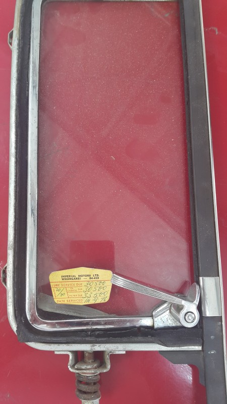

Quarter vent drivers side, will be getting cleaned today. has not been cleaned or serviced since 1976 and the rubbers are shot

Post by thomos60 »
Came up good

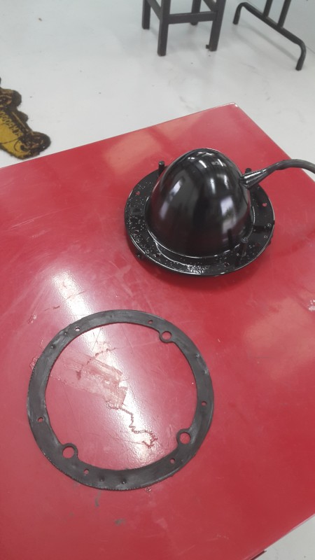

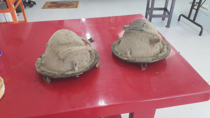

Started to rain as I gave the headlight bucket a coat of paint, must be beer o clock.
