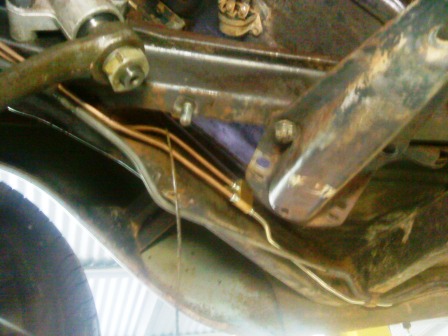

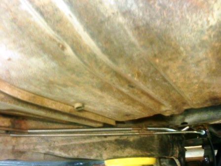

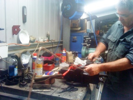

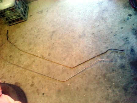

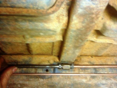

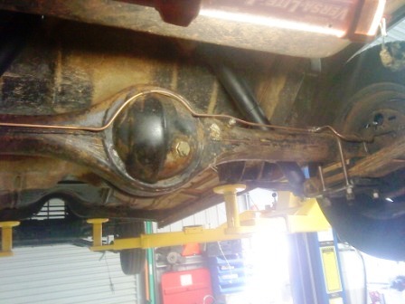

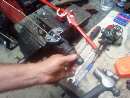

Finished all tube work yesterday bar what needs doing for the engine. Love to know how they did this stuff in the factory. I don't think my rate of one car per day or so would have cut it!
Now chasing some fuel and brake line clips for the inner sill.

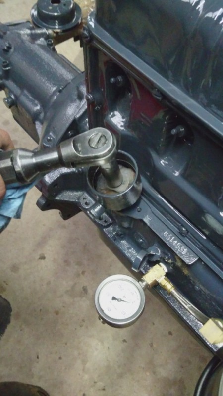

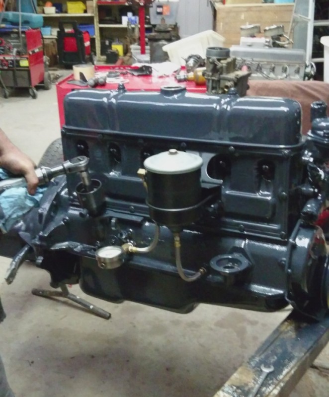

Anyway, still pushing along with the ute. Done the dissy and oil filter unit, slipped with some paint and got it on the engine (sorry Trev, I tried to wipe it off), fixed up all the worn gear linkages, and got a new handbrake cable in. This arvo finished with priming the engine oil system as well. I checked flow to the oil filter via the standard restrictor and was quite shocked at how much does actually flow to the filter. I think some would be surprised to now it took less than 10 seconds to flood the housing which to me is more than most ever thought that these things would filter over time.

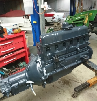

Re: Seagull Grey EK 2106
Underneath looks great with new lines and fittings and old surfaces with next to no paint and some dirt etc. You are making it sound and reliable but friendly and perfectly useable as well. It didnt hurt that you painted the engine because your not TRYING to make it look bad or run down. Your just keeping some of the nice "Oldness".

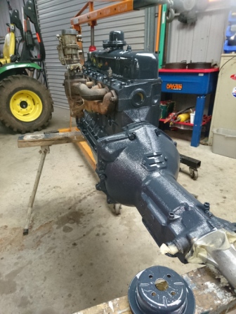

You just had to paint something on this build, all is balanced in the universe now Craig. Looks great.

Interesting... and a cool way to turn the oil pump. What size oil restrictor is in the line? How much pressure was the gauge reading?Craig Allardyce wrote:This arvo finished with priming the engine oil system as well. I checked flow to the oil filter via the standard restrictor and was quite shocked at how much does actually flow to the filter. I think some would be surprised to now it took less than 10 seconds to flood the housing which to me is more than most ever thought that these things would filter over time.

I'll let you know when I get home from work next week Harv. My restrictor is actually the tee in the block for the sender and line to the filter, not as most are at the inlet to the filter. I should also work out the RPM of the air ratchet as well.

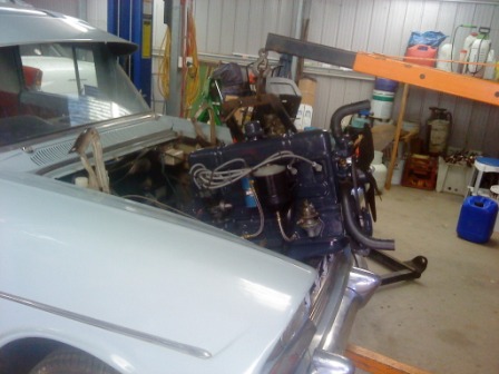

In she goes today.
