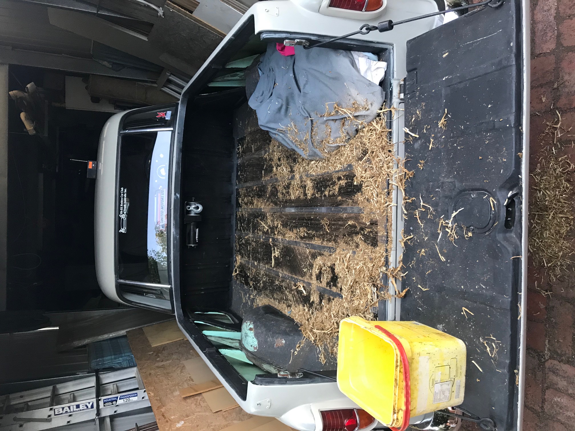

Time to tidy up the back of the Ute. I had picked up a load of compost a while ago and after it sat in the back for a week it started to damage my timber floor by taking the gloss off. So I have decided to repolish the floor and cargo strips. Before I do that I am going to repaint the panels and sides / tailgate. Have got the KBS paint to try.
The start
The start

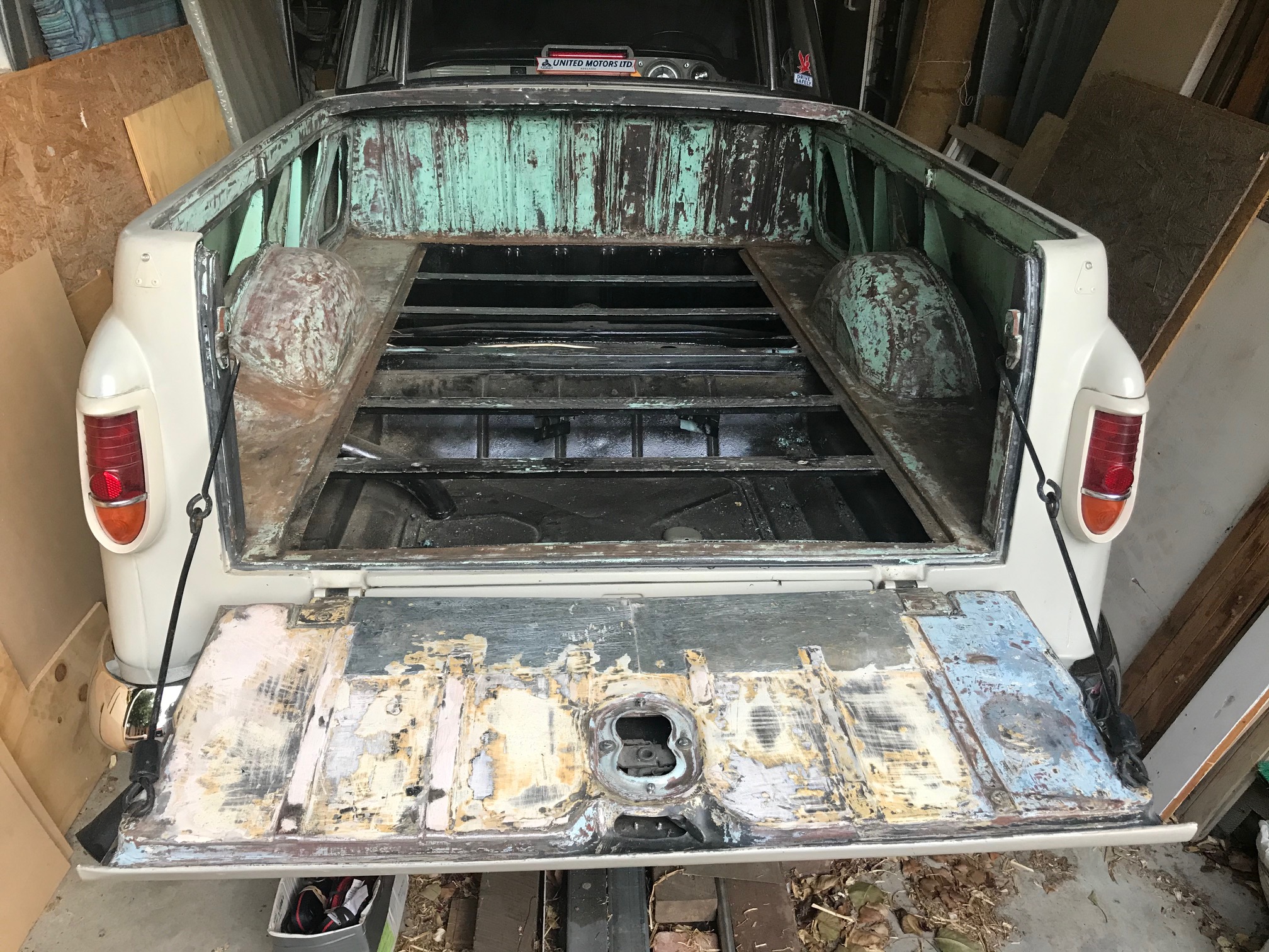

Stripping & scraping the crappy paint ....
Posts: 2289
Working my way cleaning off the old paint above the floor and below.

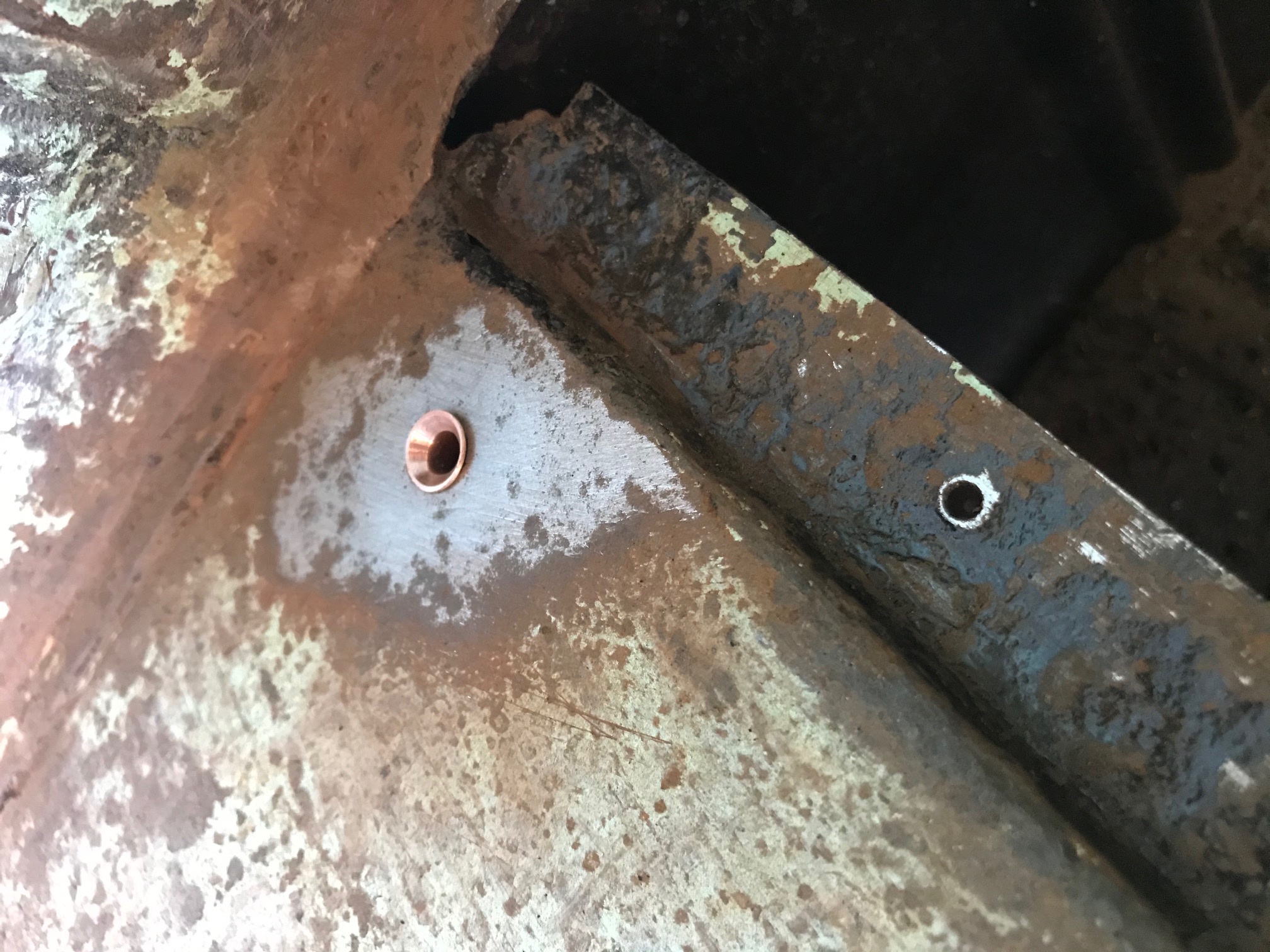

Found the drain tube was rusted off underneath so flared a piece of 5/16" copper and soldered it in with some silver solder. Should be all good now.
