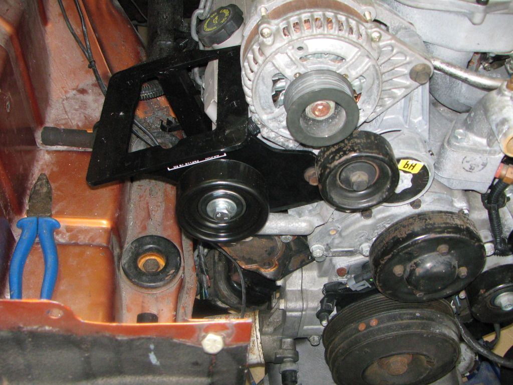

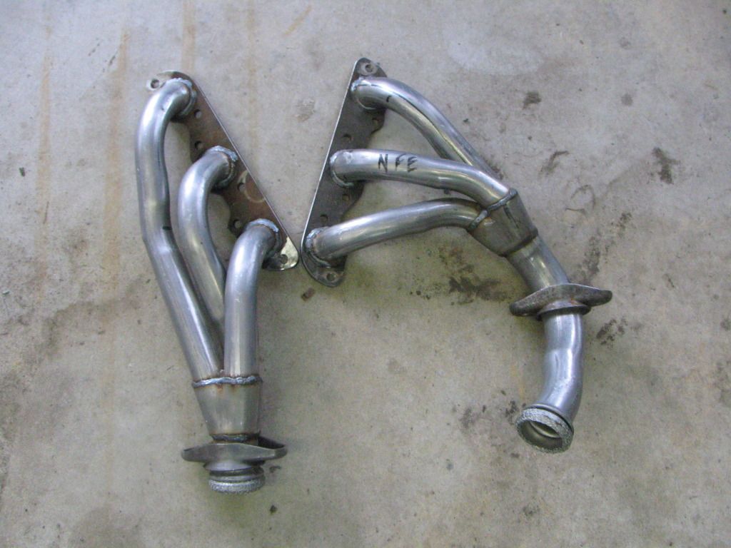

bought some stuff from v6 conversions Power booster mount
air con mount
and a set of headers
i got the long axel shortened and bought a new long axel got a new tail shaft too.
put it all in and it fits great
air con mount

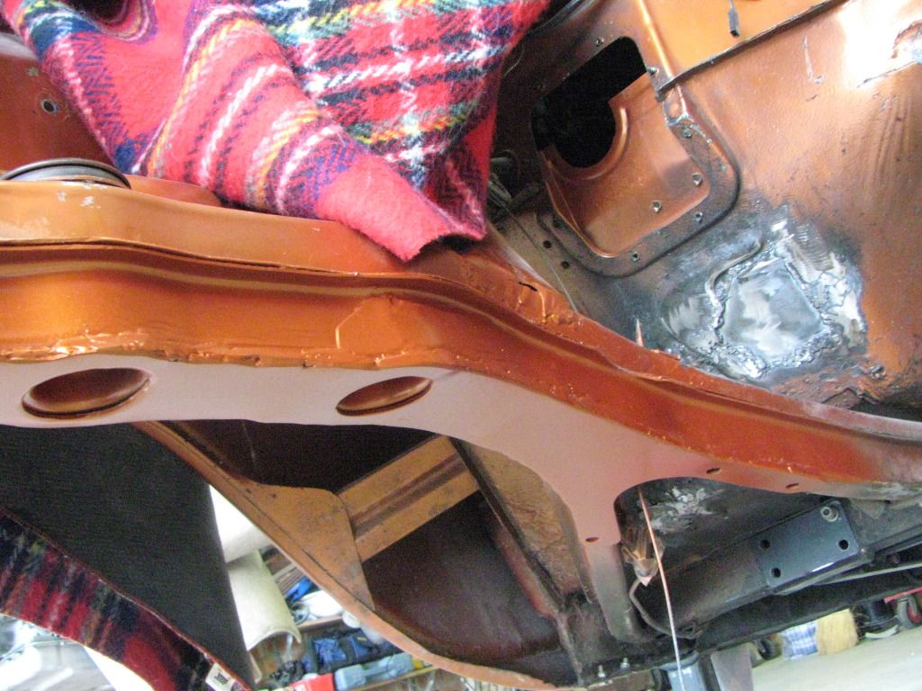

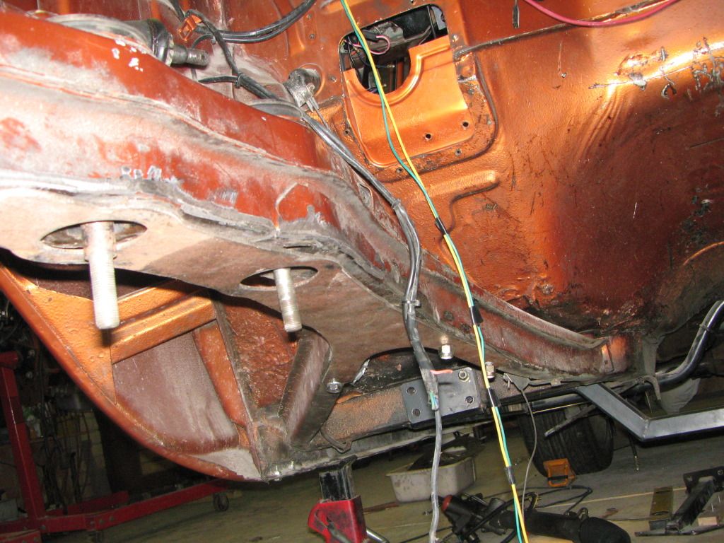

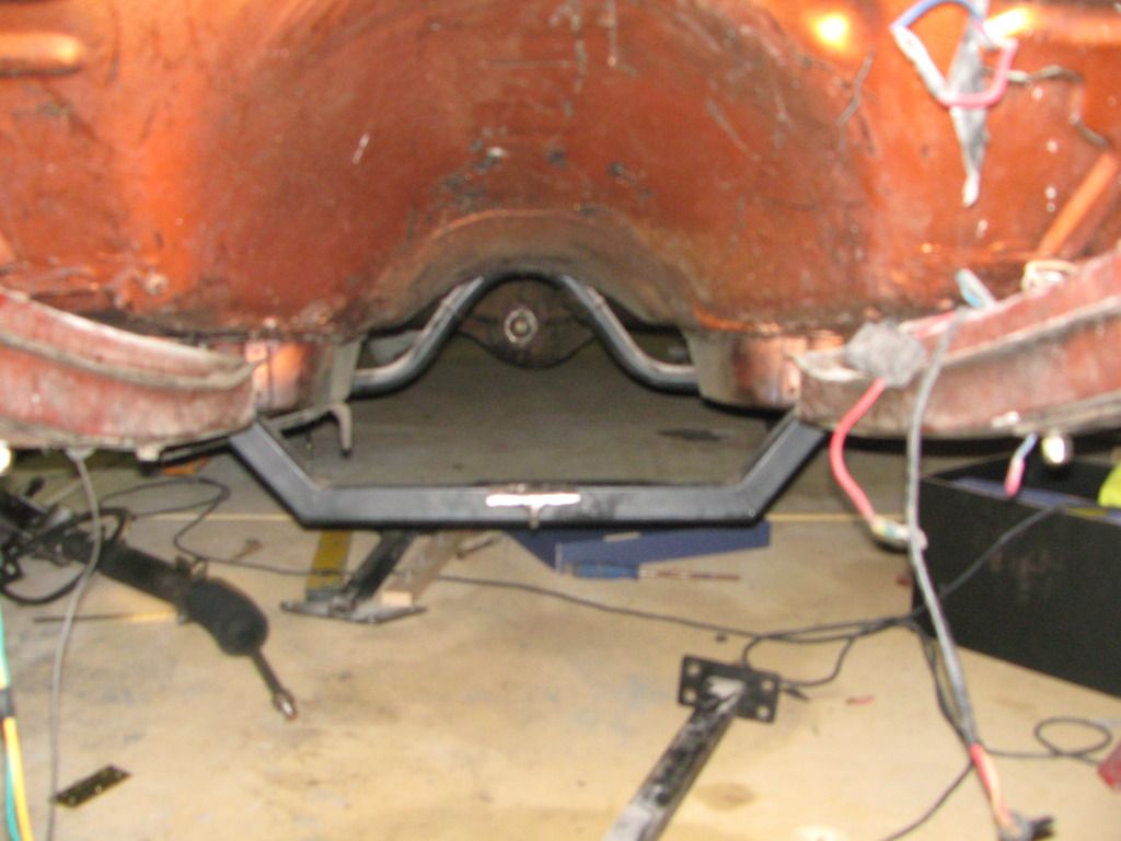

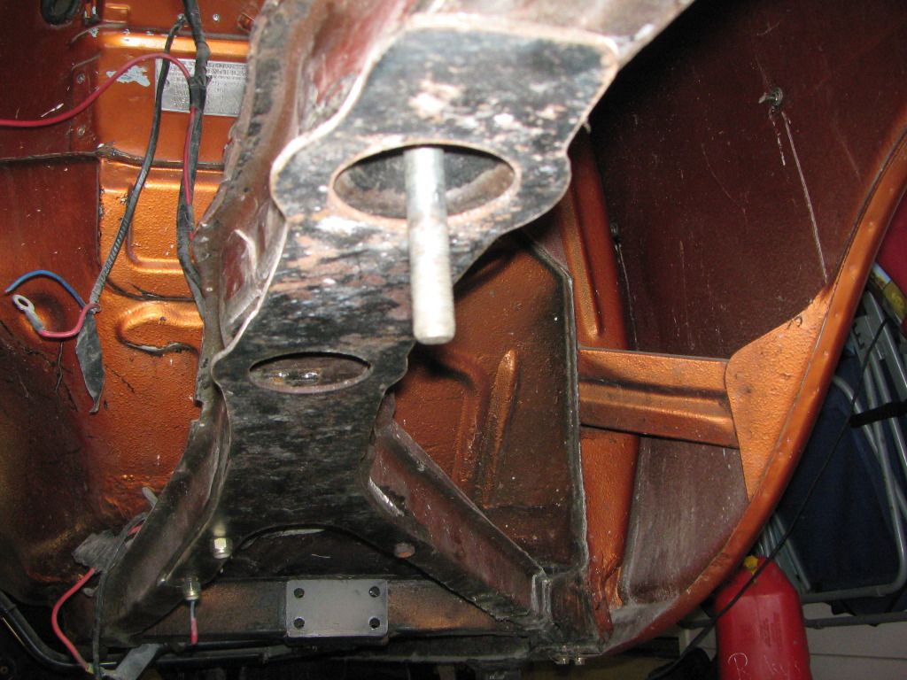

took the engine out, so i can do the brake & petrel lines and do the steering, so i welded these bits in and painted them up
and i pick up my new power steering rack on friday, so i can start working out the steering, as for now i'm using a vs column shift auto. so it's coming along fine

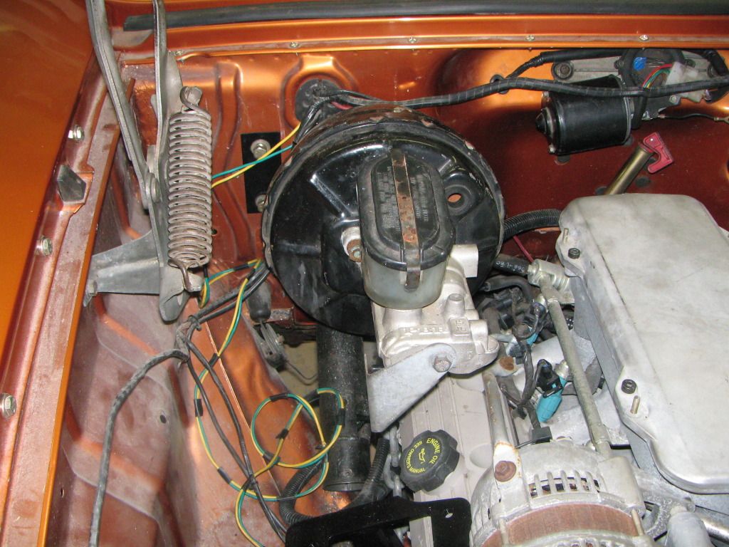

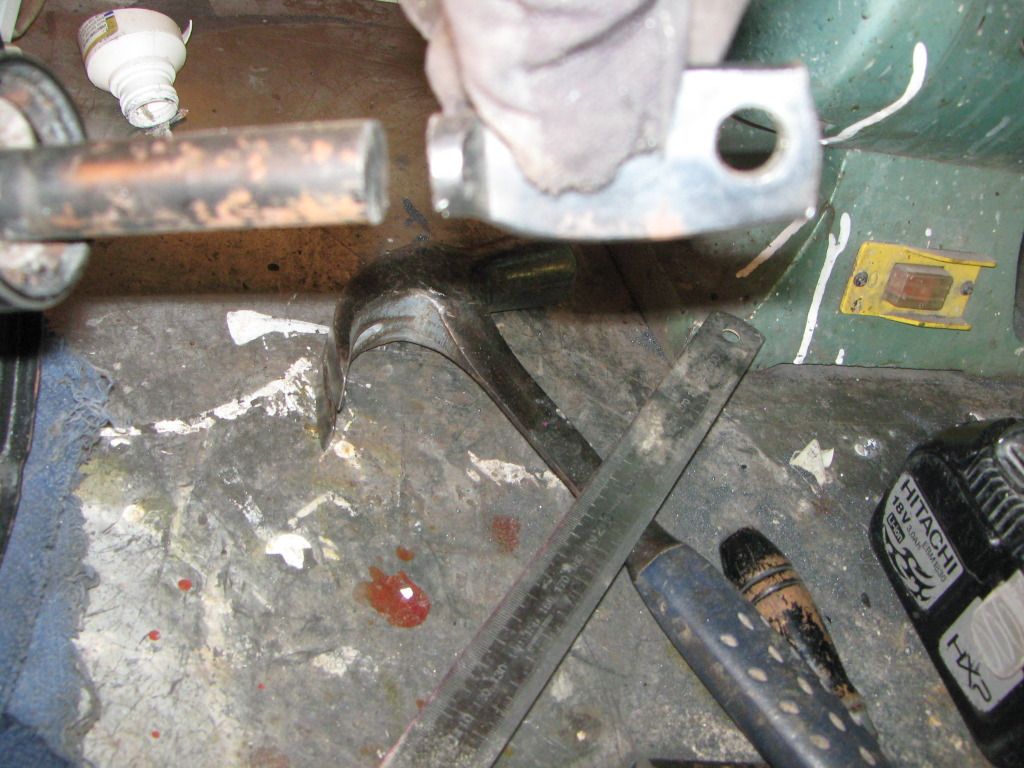

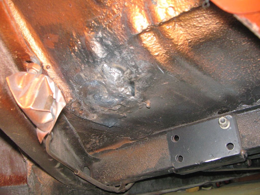

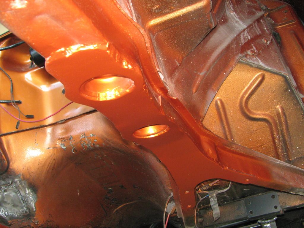

Painted up the things i welded in last week
and weld up a few pin holes

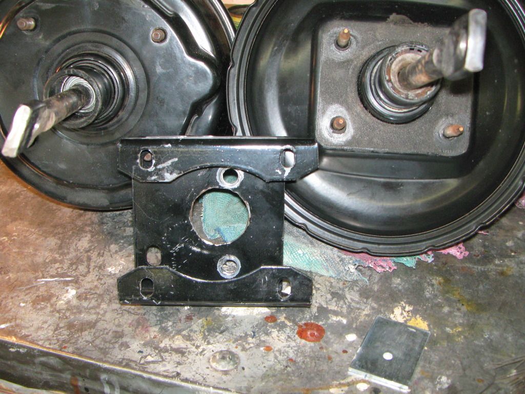

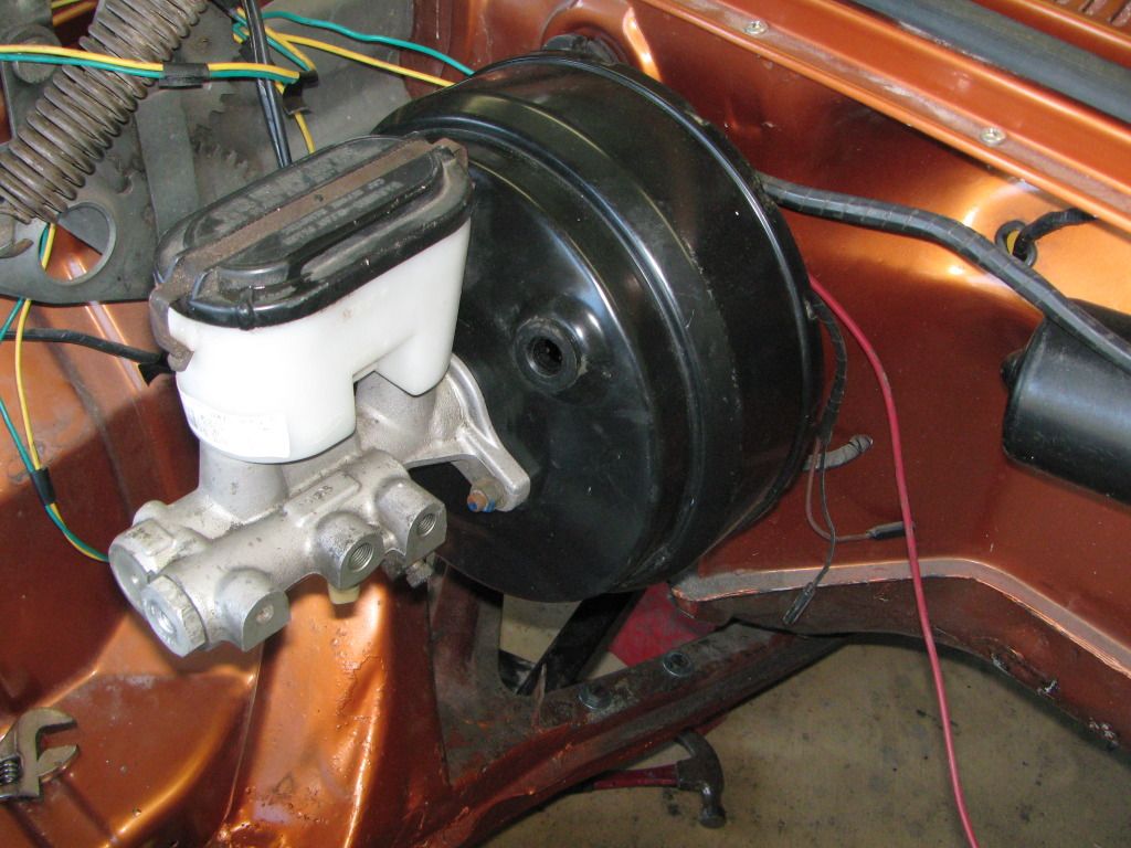

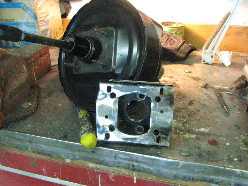

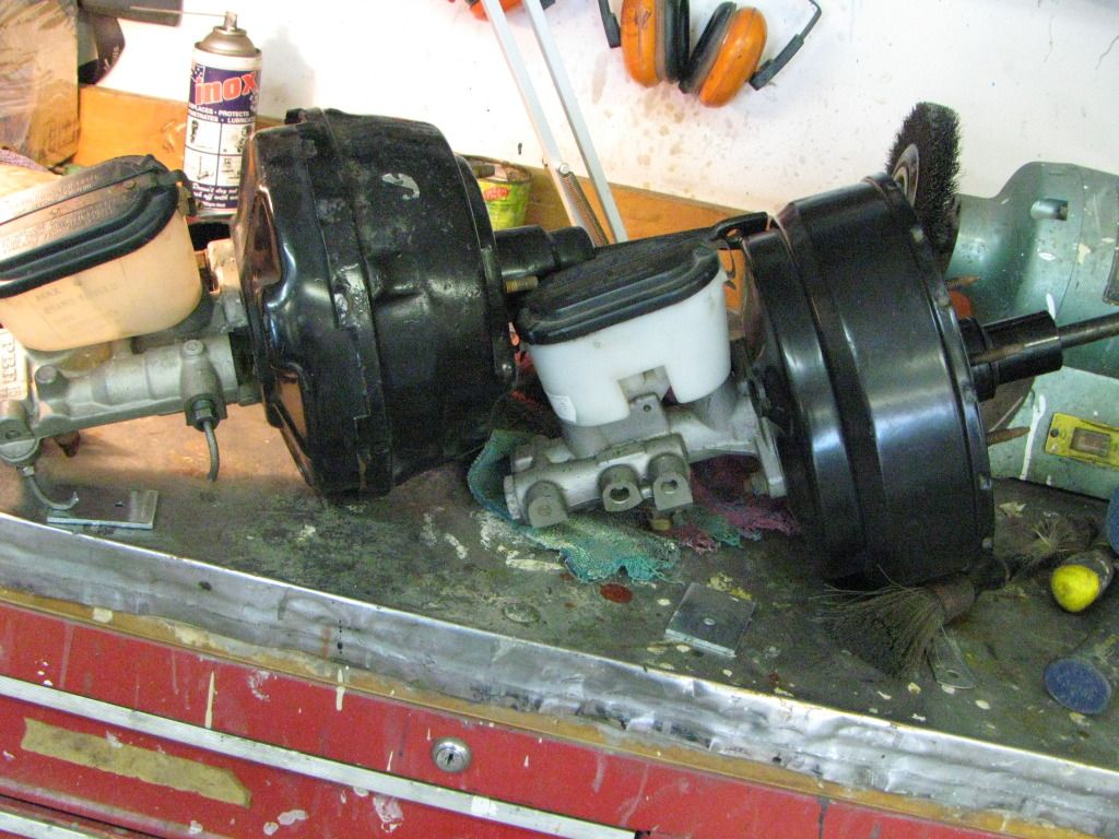

got a VT power booster on ebay for $10.50,much better then my VP booster
the bolts at the back of the boosters were different
so with a little welding and cutting

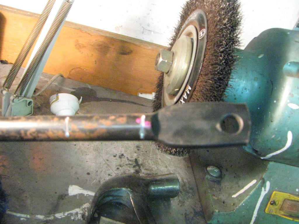

and the rod on the VT booster was much longer had to cut and shut
i got it in today
looks heaps better
so now i'm going VT brakeshttp://www.ebay.com.au/itm/140868483154?ssPage ... 1439.l2649

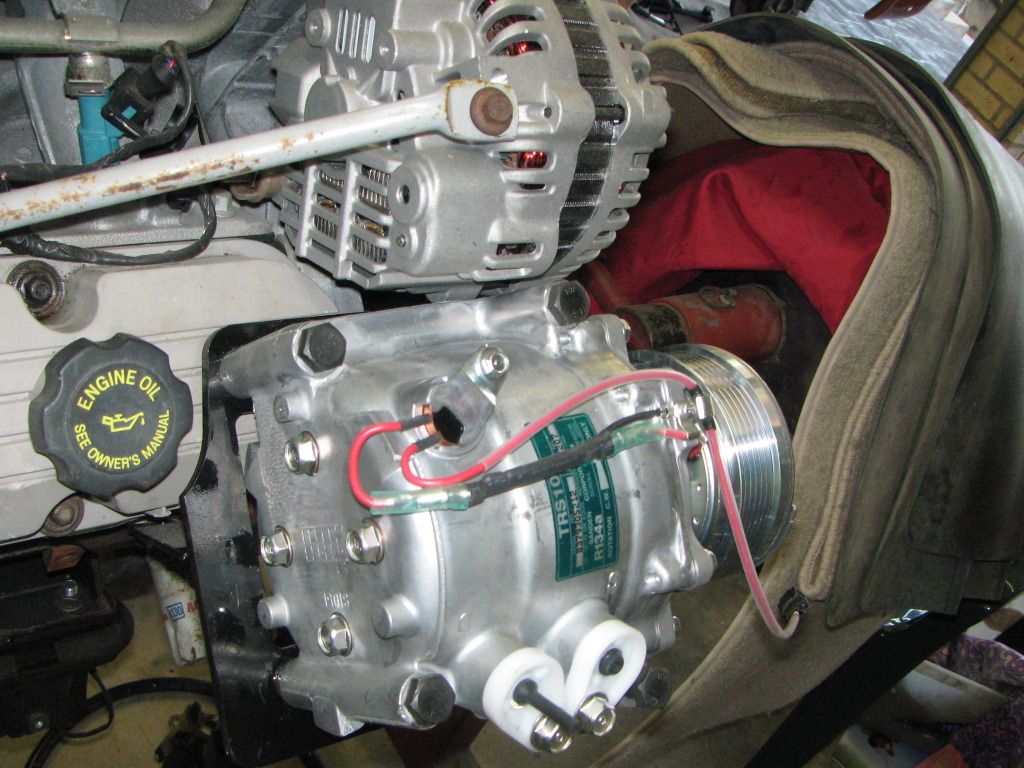

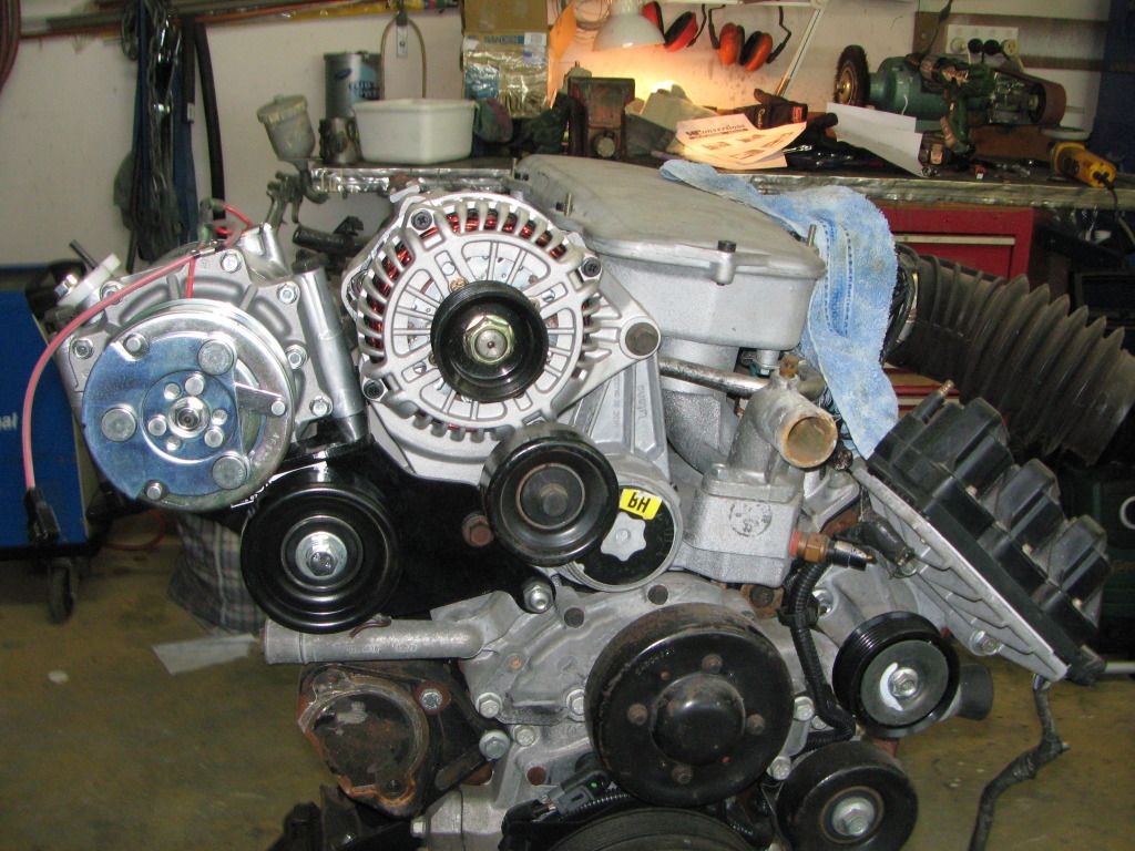

got the new air con compresser
and i'm looking at what radiator i can use (VS ??)so i can use a VS air con radiator, as the ek one is to small for the air con ??? once i work that out, i can order the rest of the air con

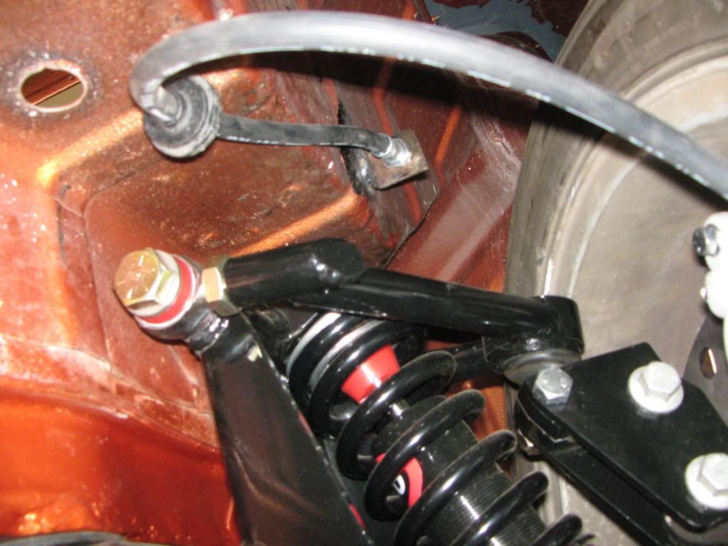

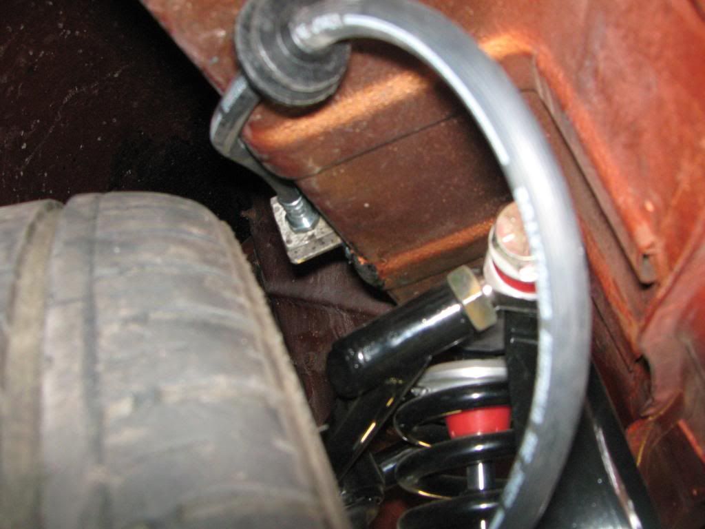

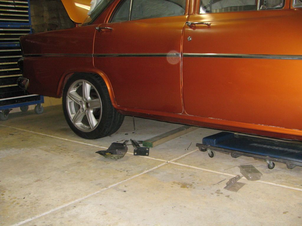

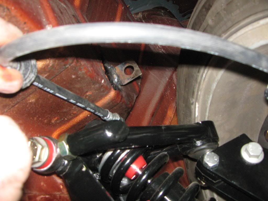

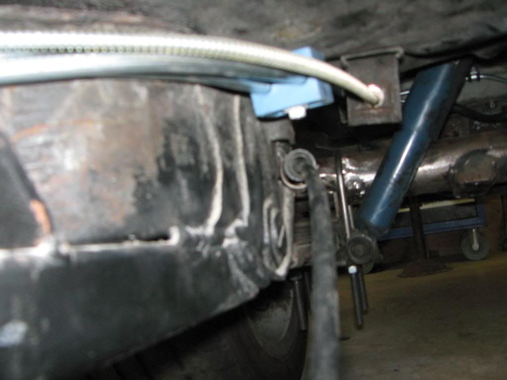

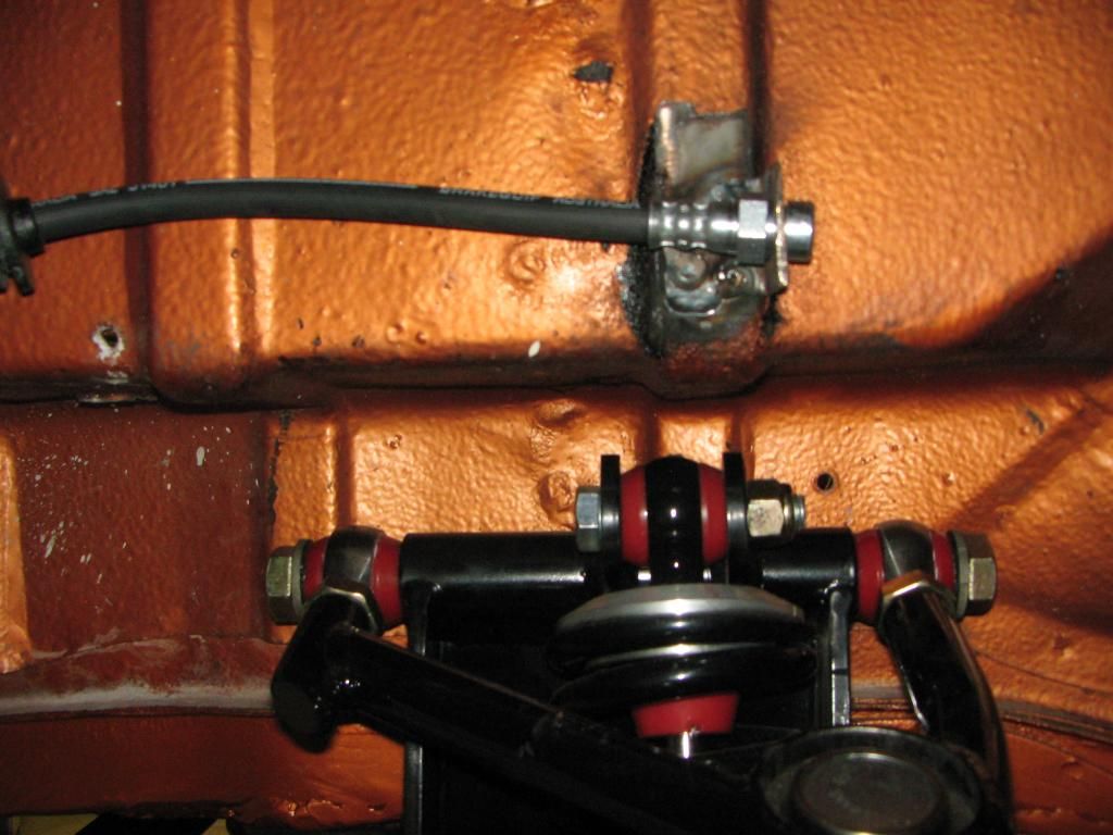

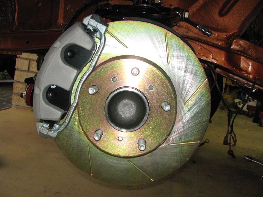

put the VT brakes on my, VS brakes were just to worn out
not happy with where i welded the rubber line ends that join the steel lines
just too close to the wheel (for getting it passed by the engineer) i think
thinking of putting it here (where else can i put it)

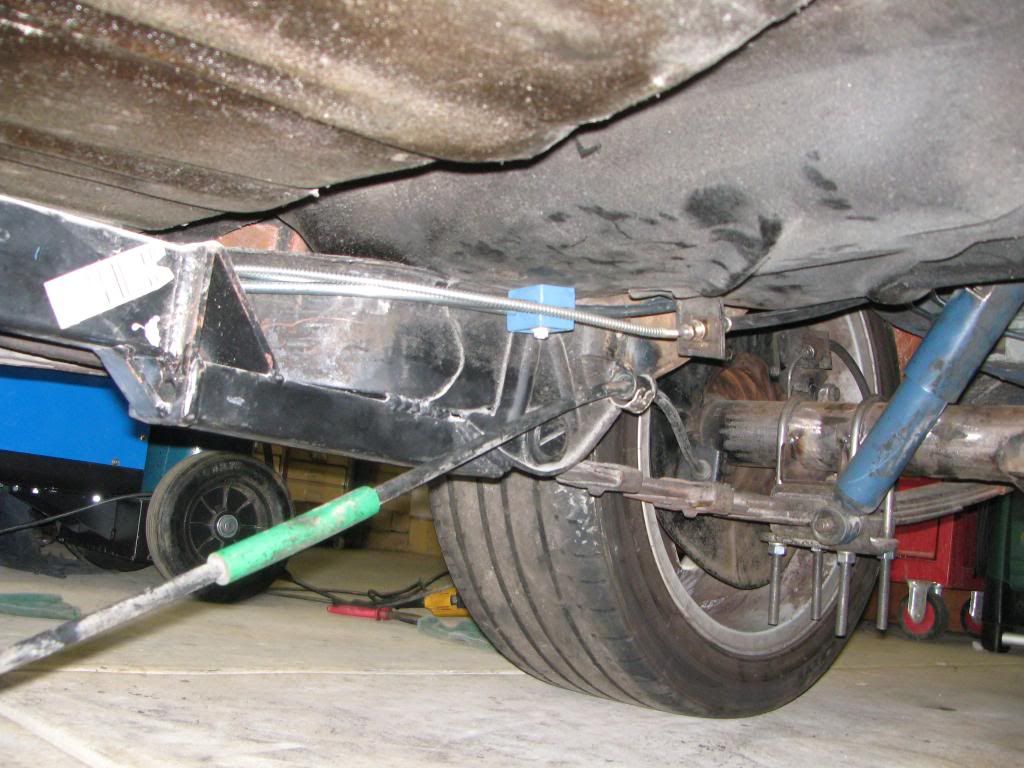

had the same problem with the hand brake cable, i think this is the best spot for it now (where else can i put it)
can't do the rest till i know were the exhaust is going to be

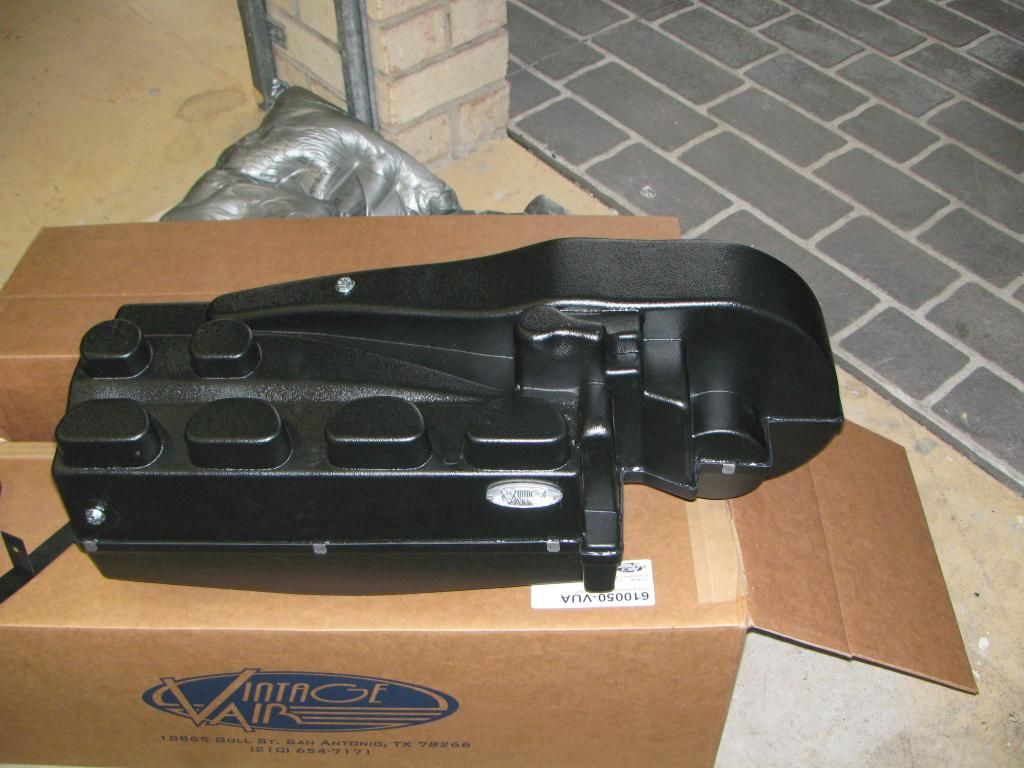

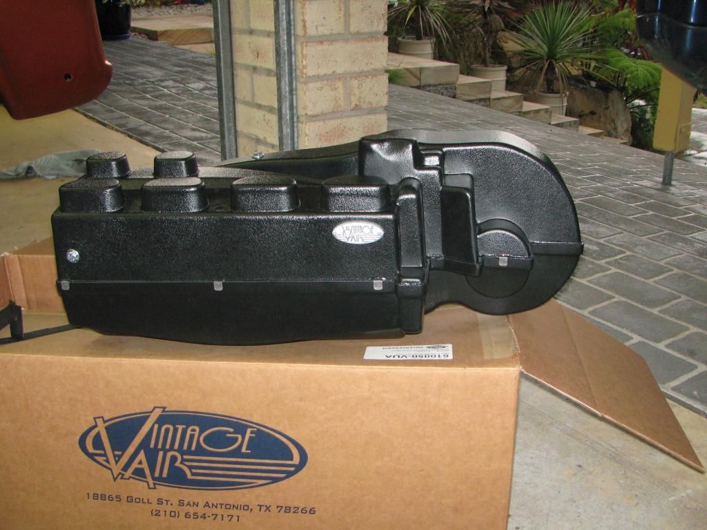

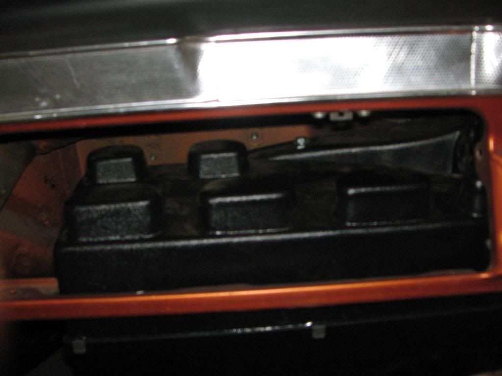

got the air con Gen II super cool one, as i don't think the compack one is right for a sedan
it's the mock up one
little bit of cutting and it fits nicely and they said it would'nt fit
not much glove box left tho

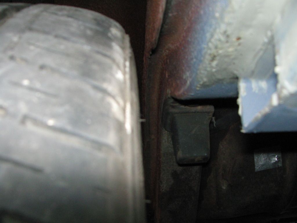

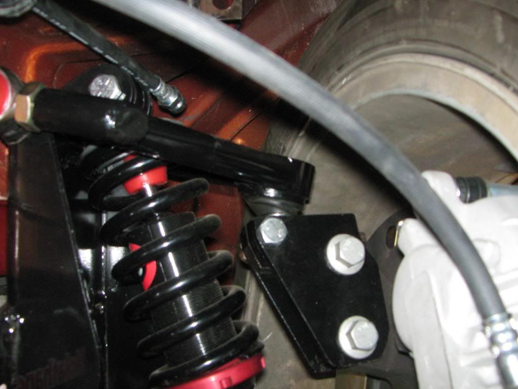

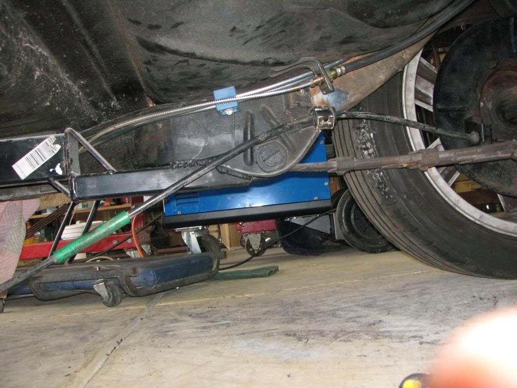

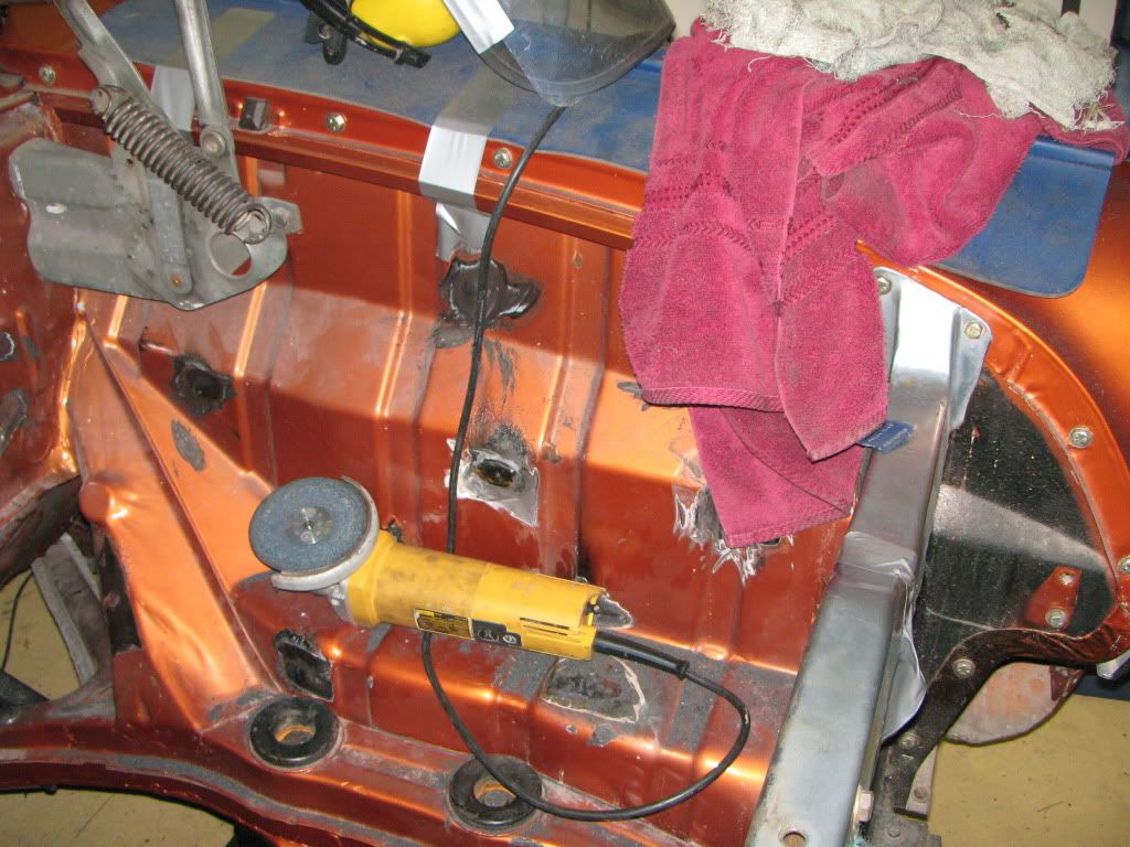

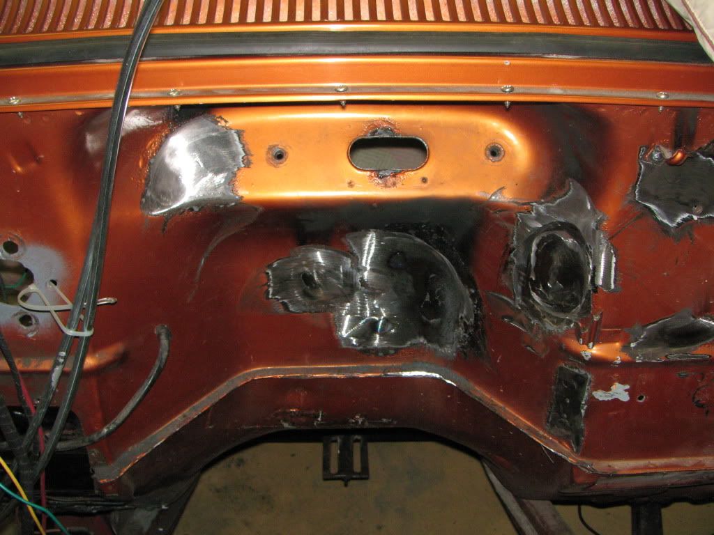

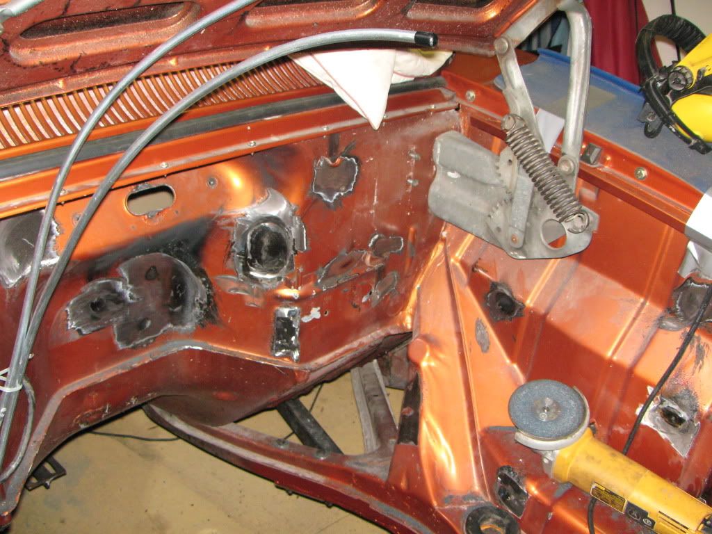

have'nt being doing to much as i've been waiting for parts, so i welded up the holes in the engine bay
did'nt realise how many holes
now i'll paint it in 2 pac when i work out the holes for the air con, etc.

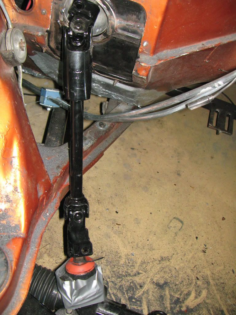

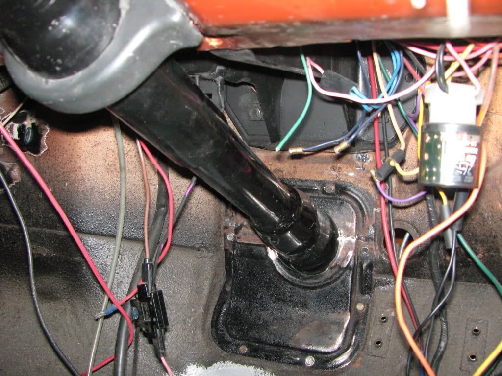

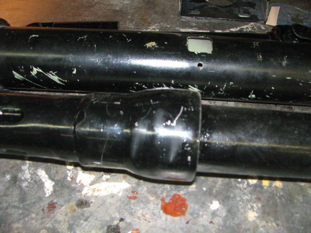

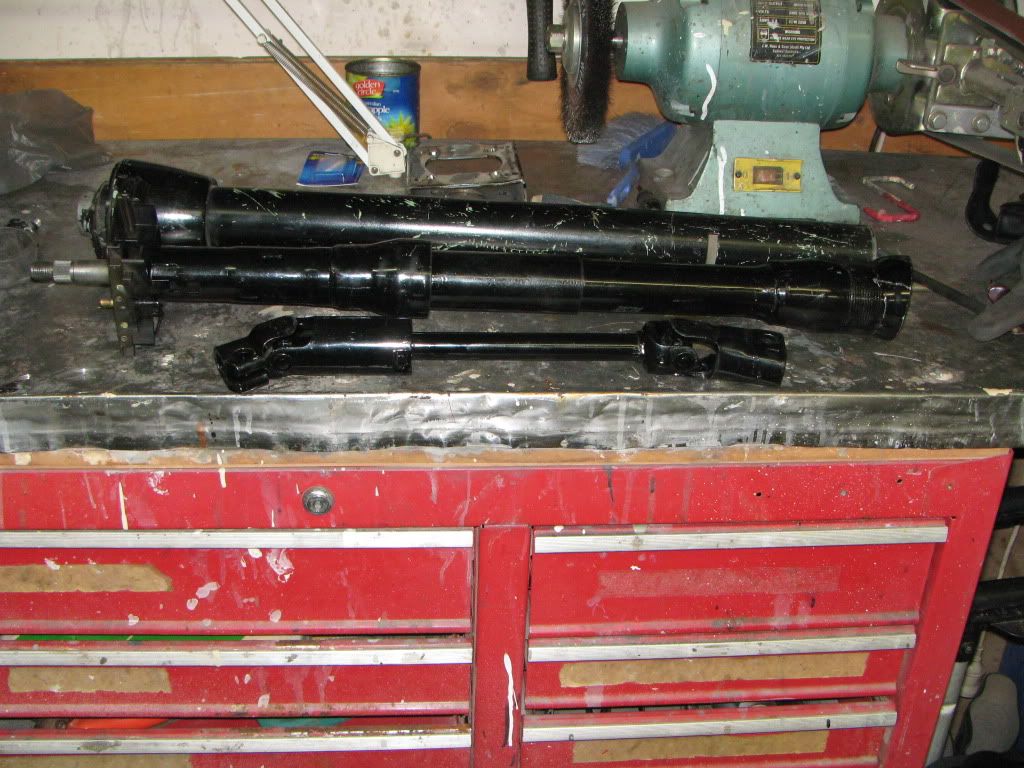

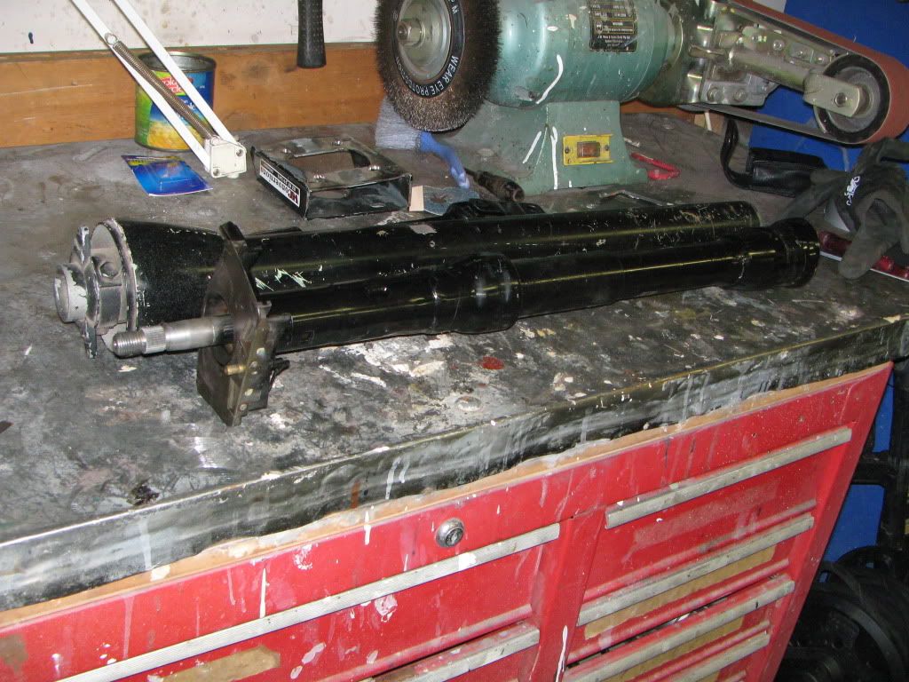

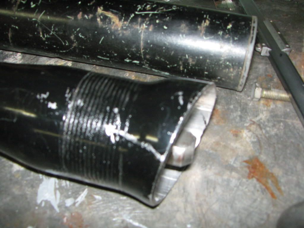

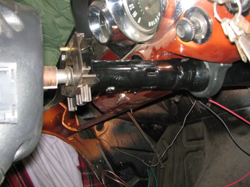

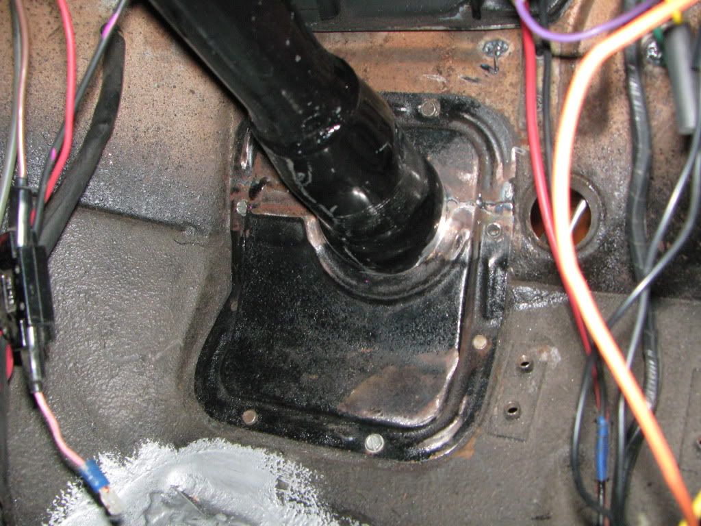

sent my vs column and shaft to v6 conversions to get modded as it was just too hard to do on my own
made one big mistake did'nt take every thing off the column (column auto shift) part is now missing and left the bolts in the shaft now missing
will be ring them on monday (parts you just can't buy)
seems to fit alright

Hi The ac unit looks good, is it a heater as well? Would you have the model number as I'm looking at doing ac as well.
Rick
