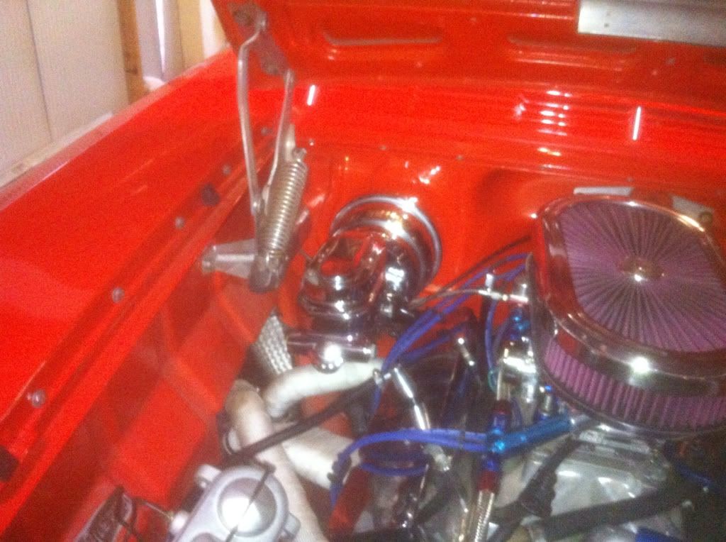

What a pain in the arse trying to get the master cylinder level
Lost count how many time I have pulled the pedal box out
Got to love the fun of it all

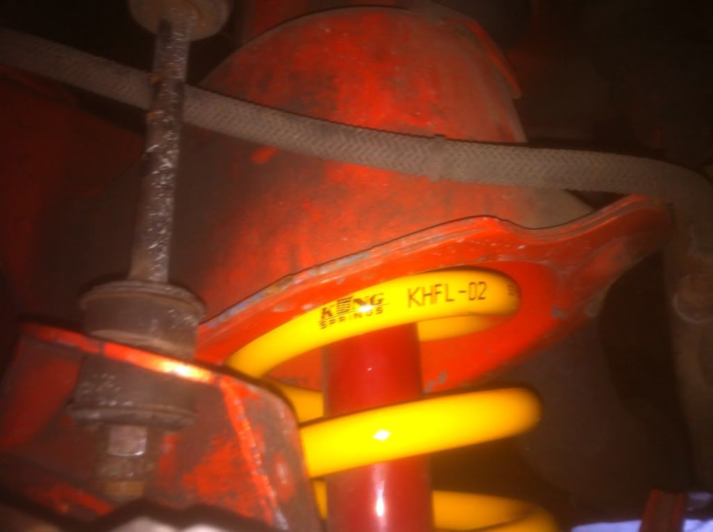

Okay so if u have a chev on a Crs front end and hq stubs and u want to lower it
I bought some king springs to suit hk v8 part number khfl - 02 and still have good suspension travel
The distance between centre hub and guard is 330mm hope that helps

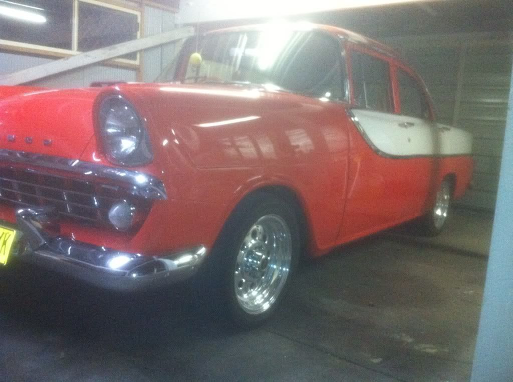

Pics
searsy
Posts: 629
Location: Lismore NSW
Re: testing
Post by searsy »
sorry about the grotty front end but the old girl is a genuine daily driver
shmeagain
Posts: 402
Location: lismore nsw
Re: testing
Post by shmeagain »
ITS SHMEAGAIN 5KS a day is not a daily driver that front end should be spotless :lol: :lol: :lol: :lol: :lol: :lol: :lol: :lol: :lol: go the greys
