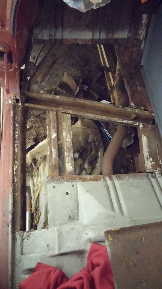

went into the garage and started to cut out the floor panels only to find the previous owner had done some quick patch jobs. under these patches were even more r :evil: st so we couldn't weld in the replacement panels. will have to work out how to fix up the previous work first
feels like one step forward two steps back

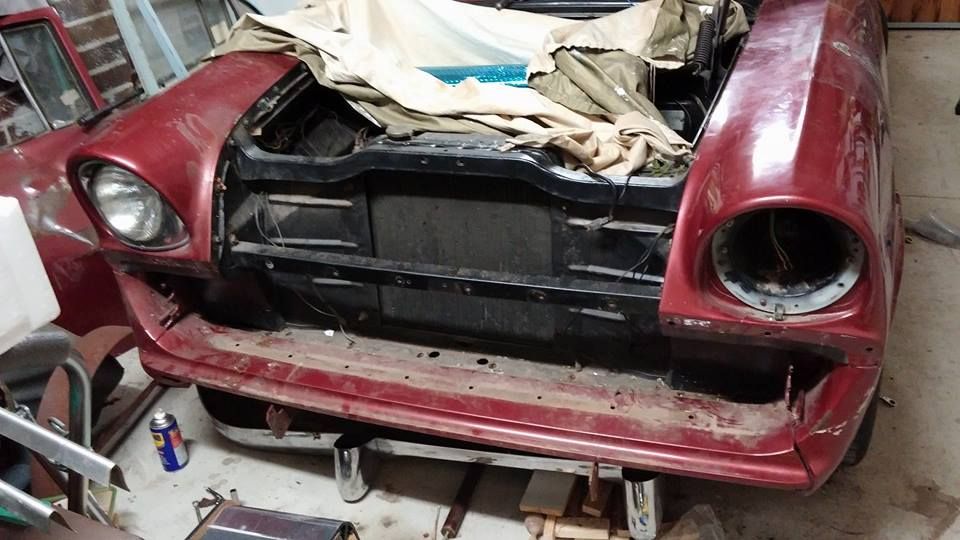

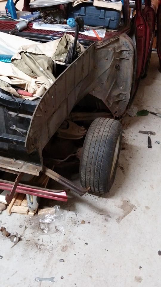

We decided to take the fenders off to get better access to the r#$t. Thought it would take half an hour to an hour... 4 hours later im still going. Have the bumper bar,off and only 2 more bolts and the stone tray is out. Hopefully i'll be able to get the fenders off in a couple of days

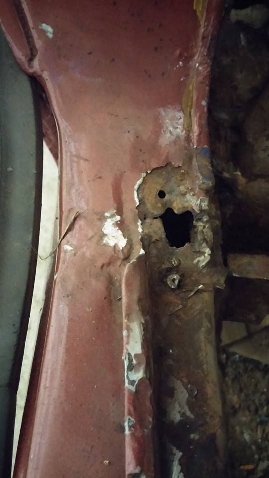

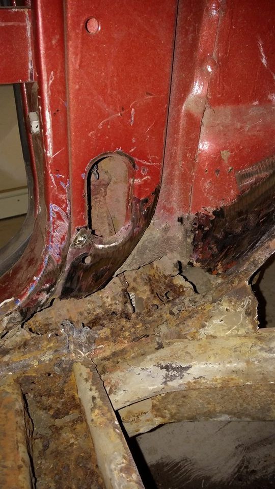

some pics of the dreaded r##t and i finally got one fender off

After long discussions with my dad and brother, we think its best to strip her down completely sandblast and them start again. No steps forward 10 steps back :(
yep... someday...
Craig Allardyce
Posts: 1565
Location: Stratford
Re: Bonnie
Post by Craig Allardyce »
As painful as it must be, its probably the best way to go. Once its blasted you'll know how much rust you'll have to deal with and there wont be any secrets bubbling up later on.
Hang in there. Yes there will always be steps backwards but just keep it in the back of your mind what your end result will be. Its a hard slog but well worth it in the end. You'll also find plenty of help and encouragement here on the forum.
Keep at it mate! :thumbsup: :thumbsup:
