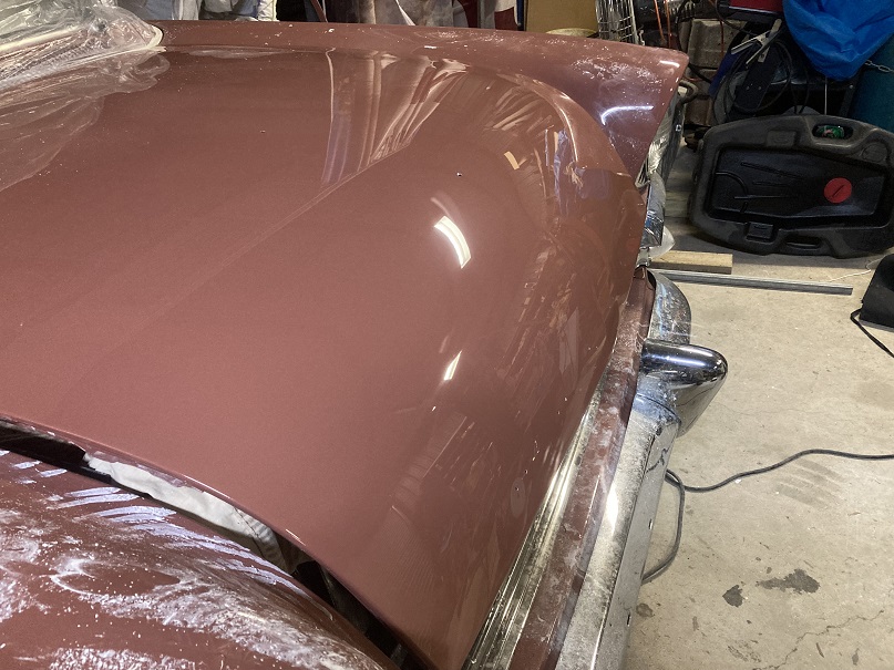

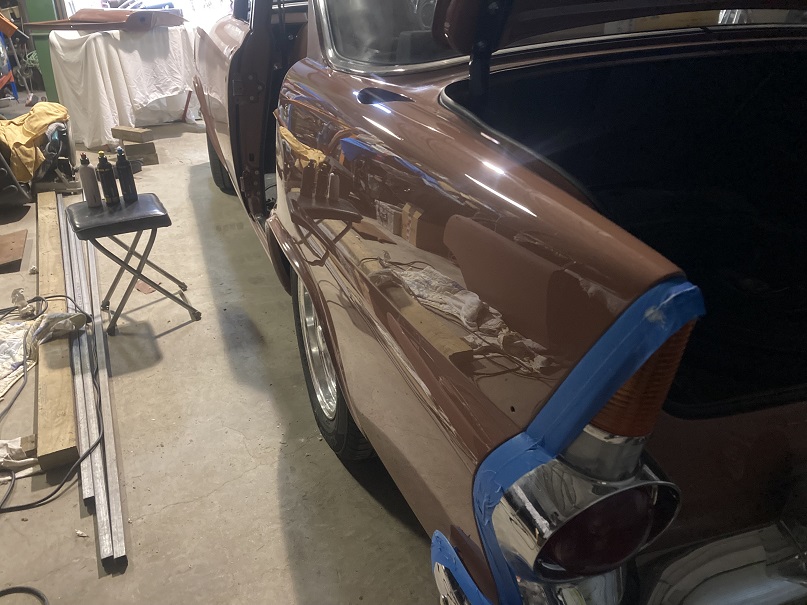

Well guys so close yet so far, I am looking at a change of career again so have been busy trying to finalise that.
Unfortunately that means no nationals again for this year, although I might do a day visit to the show and shine if time permits.
Anyway, rubbing like a 17 year old and being ultra careful not to buff through anywhere is taking a lot of time.
Going to have a real hard crack next week so one never knows if I can finish it by June.
Posts: 11669
Re: Chev EK
Teasing us Greg. That reflection is amazing.

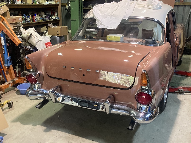

Posts: 2710
Re: Chev EK
So,
Two jobs later I'm still not happy !!
I just can't find what i like for the hours and money. SEEK .com again.
Anyway, I think I have lost it in my older life, just obsessive and worried about crap i can't control, its tough in your mid fifties !!!
Buffing is all i have had time to do and as usual I cant do it normally, no not me have to do do it 3 times !!!!!
Its turning out good but bloody hell it's time consuming. Two doors to go, a bit of trim and window hardware and its done, or is it ?
