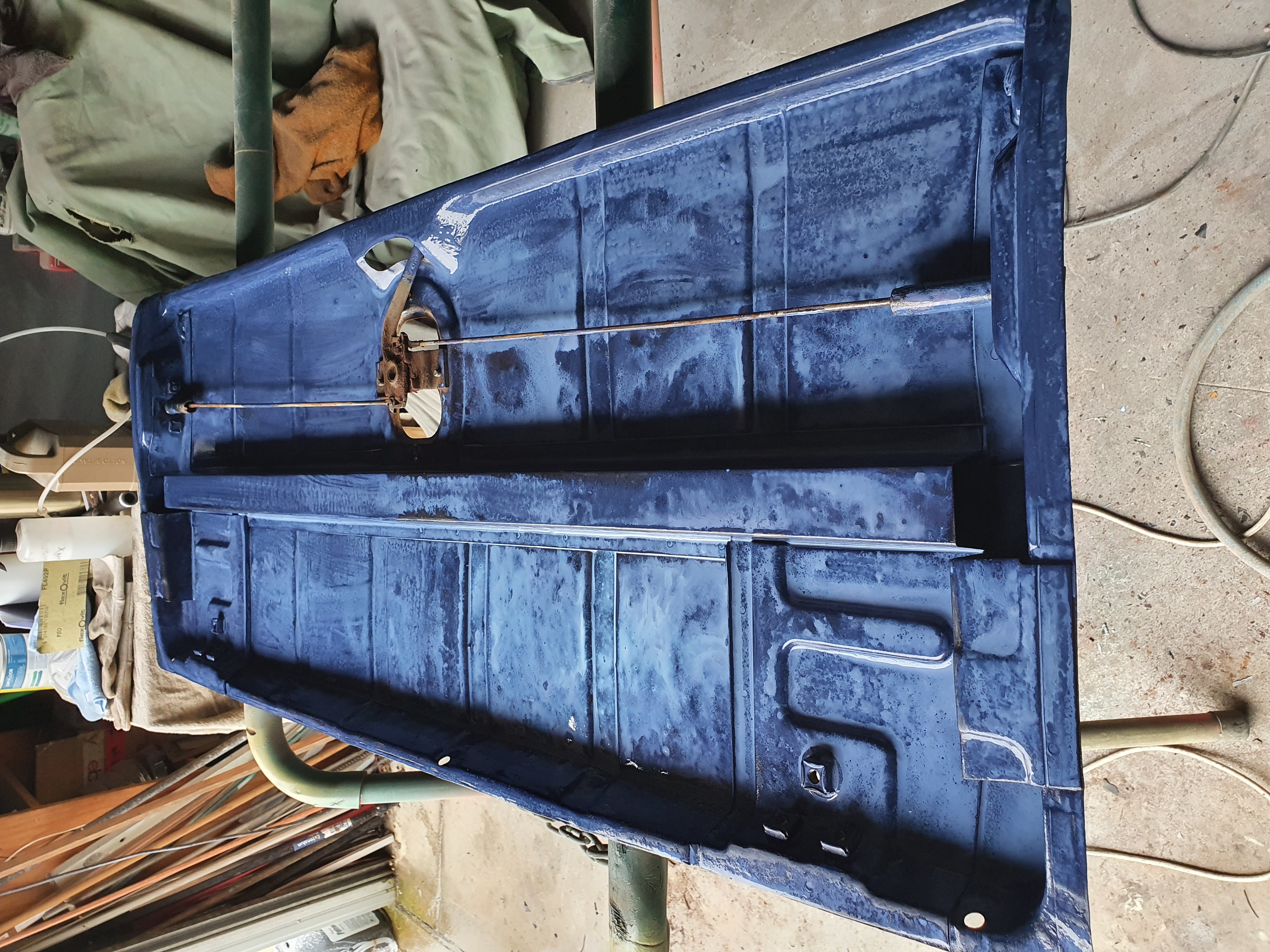

Working on paint preparation for doors and tailgate today (the 4,000th rainy day in a row
On inspection I decided to re-skin the tailgate which was not anticipated. I had hoped to grab what looked like a reasonable tailgate from the black ute and just paint it up. There was a poor repair, where something had whacked onto the top and they had just filled the dent but left the frame all out of alignment -a bit disappointing. Anyway, the only way to straighten it out was to rip off the skin.
No rust holes anywhere, so that's good. A lot of surface rust though, so used a wire wheel and then treated with rust converter. Tomorrow will paint with POR15.

The skin I used was pretty good; however, in order to retain the horizontal curve in the top edge, you will need to put a few pie cuts in the top surface. I thought I would be able to massage it in to a curve but no way.
