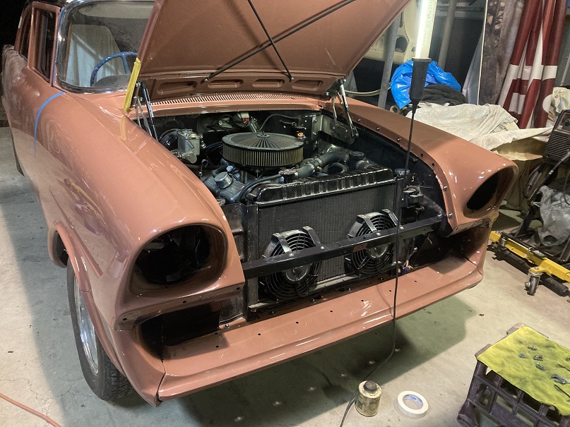

Not much happening,
Just a couple of bits before christmas.
Might have to take the guards off again as the sides are bending when I tighten the inside bolts and showing small waves in the paint !!! Arrgghhh.
More time off after chrismas so will make an effort.
Re: Chev EK
Posted: Tue Dec 22, 2020 5:25 pm
Damn, fiddly job with the rear edge bolts from inside the car. Wonder why they are bending. Either both guards or sides of the subframe must be bent. Inner guards should be a plane surface I reckon.

Errol62 wrote: Tue Dec 22, 2020 5:25 pm Damn, fiddly job with the rear edge bolts from inside the car. Wonder why they are bending. Either both guards or sides of the subframe must be bent. Inner guards should be a plane surface I reckon.
Its the bolts that do up from inside the pillar, when I mocked it all up I had no rubbers underneath, I'm thinking that's the issue, as when I get to the point where I like the shape along the door edge it twists and the guard edge then pulls in and creates a slight wave about 10mm from the edge itself.
Its ok walked away again !!!! After Chrissy I'll have a decent crack at finishing it off.

Got some rust proofing done and guards off again to sort out alignment,
New high quality chinesium rust proofing gun, worked once so far so good !
Weve all had to do this before !!!
