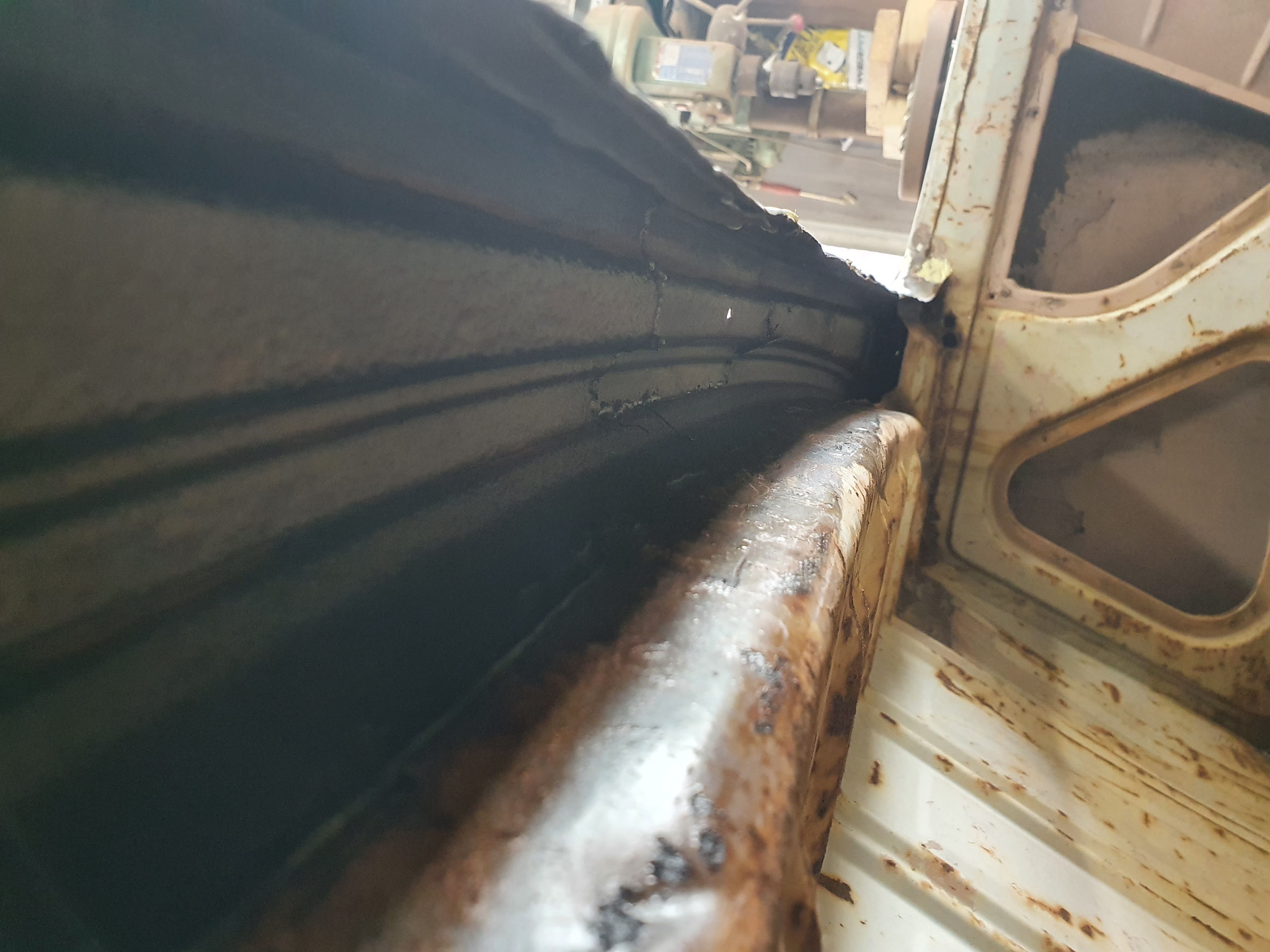

Last bit of major rust gone today. The folded section that runs along under the back window and under the section I was playing with yesterday had rusted away pretty much the full length.
I had been putting it off for months as it is a job to do lying underneath. Anyway today was the day and it all went ok. A slight modification to the original and open at the middle and each end to allow fish oil in and drainage out from now on. Made it in two section because my folder isnt long enough to do the whole piece.
A poor set of pictures but shows the gist.

Mate that looks tricky. Why didn’t you do it when it was on the roti?
Posts: 2519
Re: Project 2.
Because the access didn't improve when it was on its side and I couldn't get at it all when car was upside down.I made the two pieces so that it was mostly plug welds on the verticals so not too bad.
It's a big rust trap in there, as any water that leaks past any fasteners/ screws for the tonneau must just sit in there and its not painted internally. It is something worth checking because you can't see what state its in unless you crawl in the back. All of my donor options where stuffed.
Posts: 2800
Re: Project 2.
Mine was also shot there on Frankenstein Brett bastard of a place to try to repair.
Posts: 2519
Re: Project 2.
Not surprised Neil. I'd guess that every ute that's been in the weather will have rust in there. Agree, it's a daunting spot and sooo glad to have that repair behind me (literally and figuratively😀).
