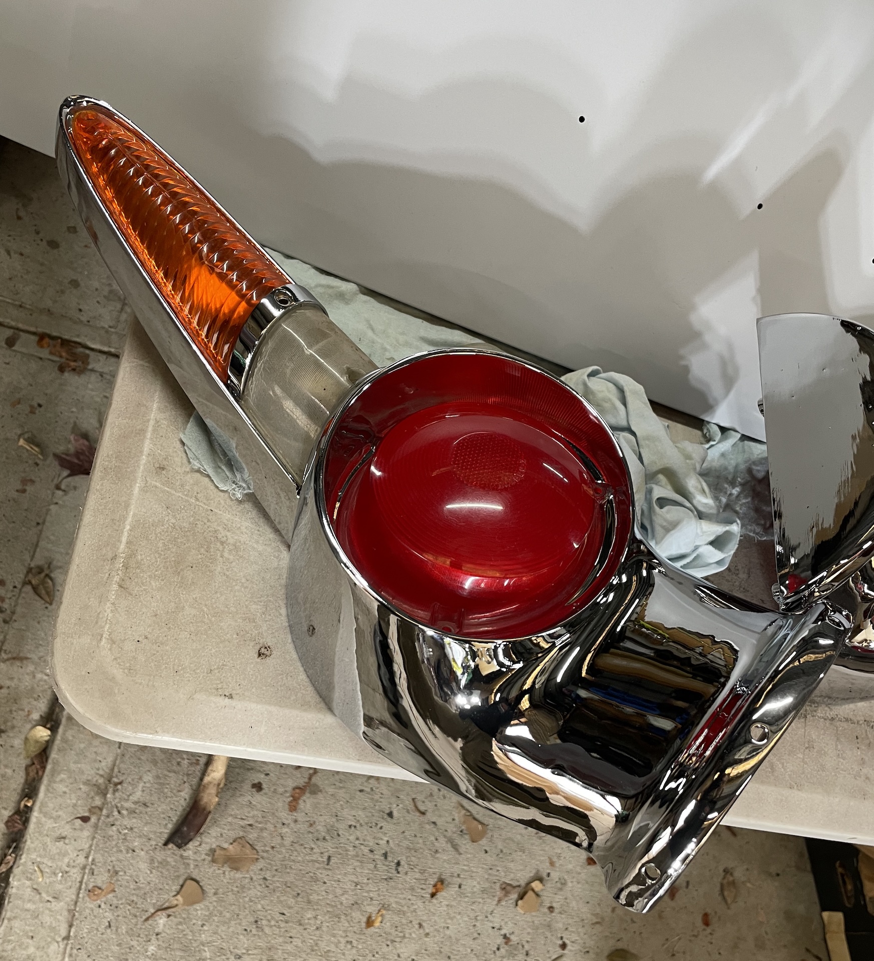

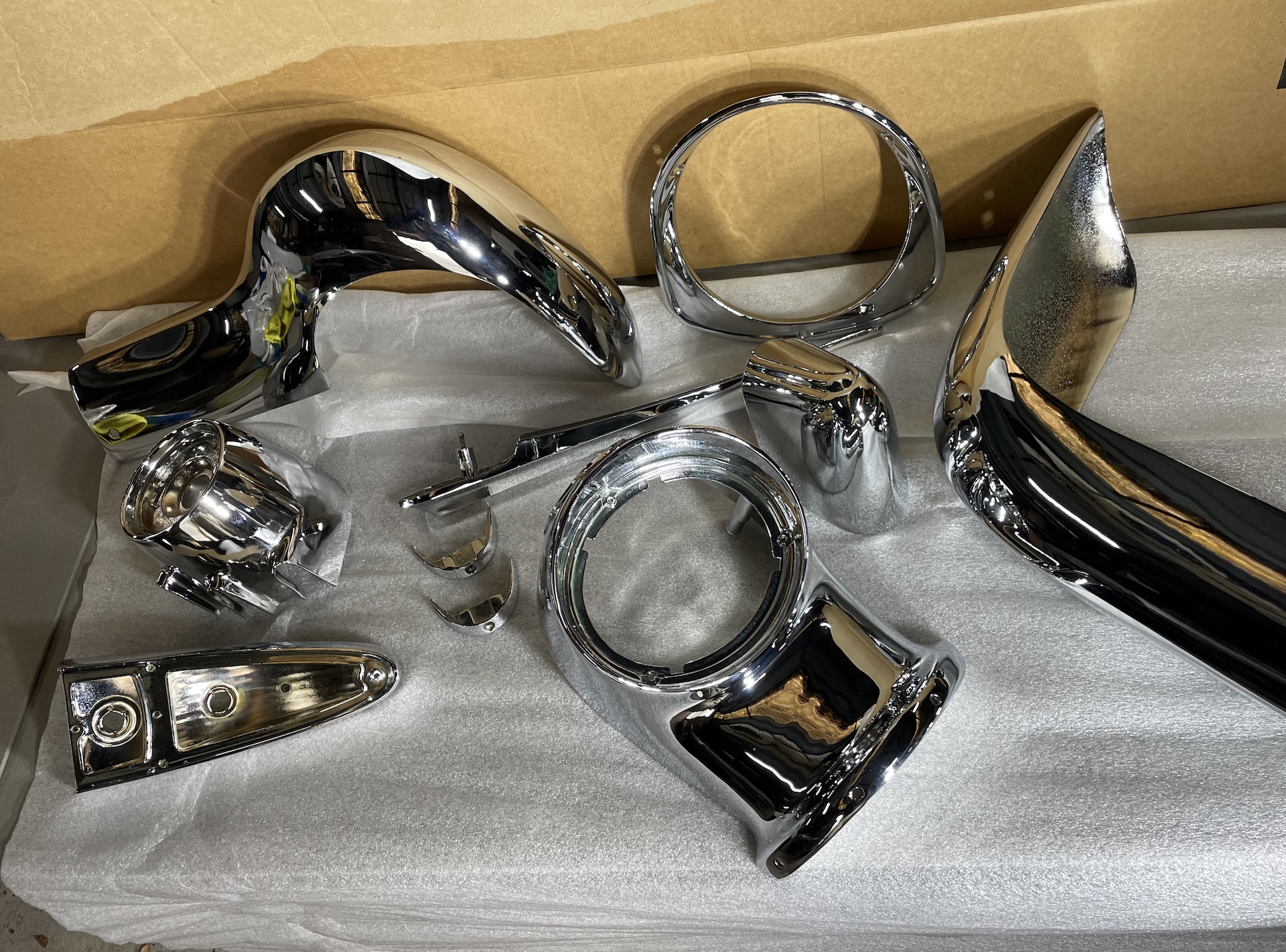

After just over 7 months I have finally got my all my diecast and steel back from the chrome plater. Overall happy with the result, especially the die cast. 29 pieces in total. Here are a few.
Took the opportunity to rebuild the tail lights. Instead of rivets, I just drilled the holes out to 4mm and fitted stainless steel bolts with a dab of thread lock.
Need to replace the reverse lenses and the stop lights have ill fitting bullet lenses that I have to deal with, so for now, keeping it original.

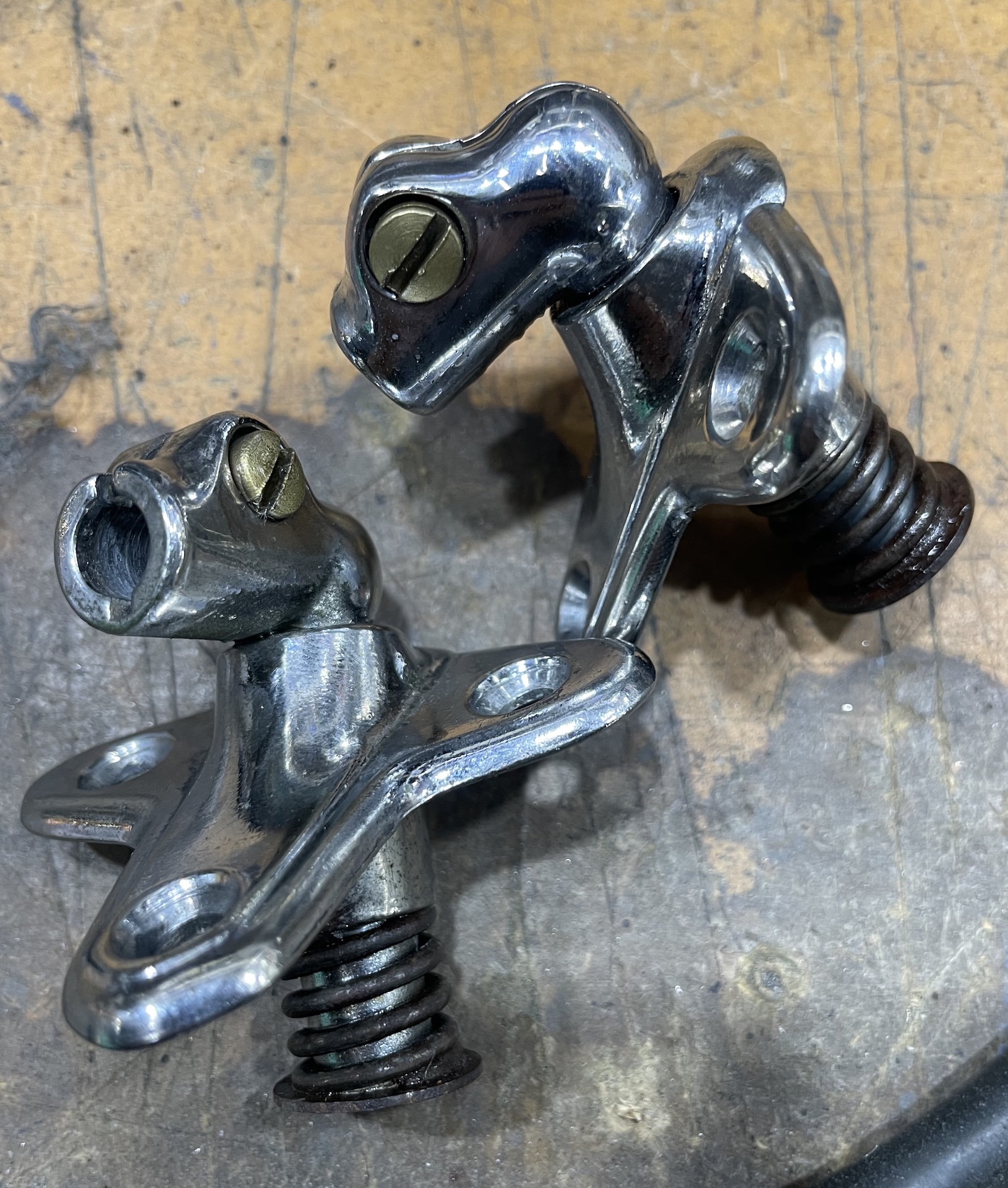

I found these which didn't get a new shiny coat of chrome. So I gave them a quick buff and brassed the nuts which were looking a little rusty and tired.

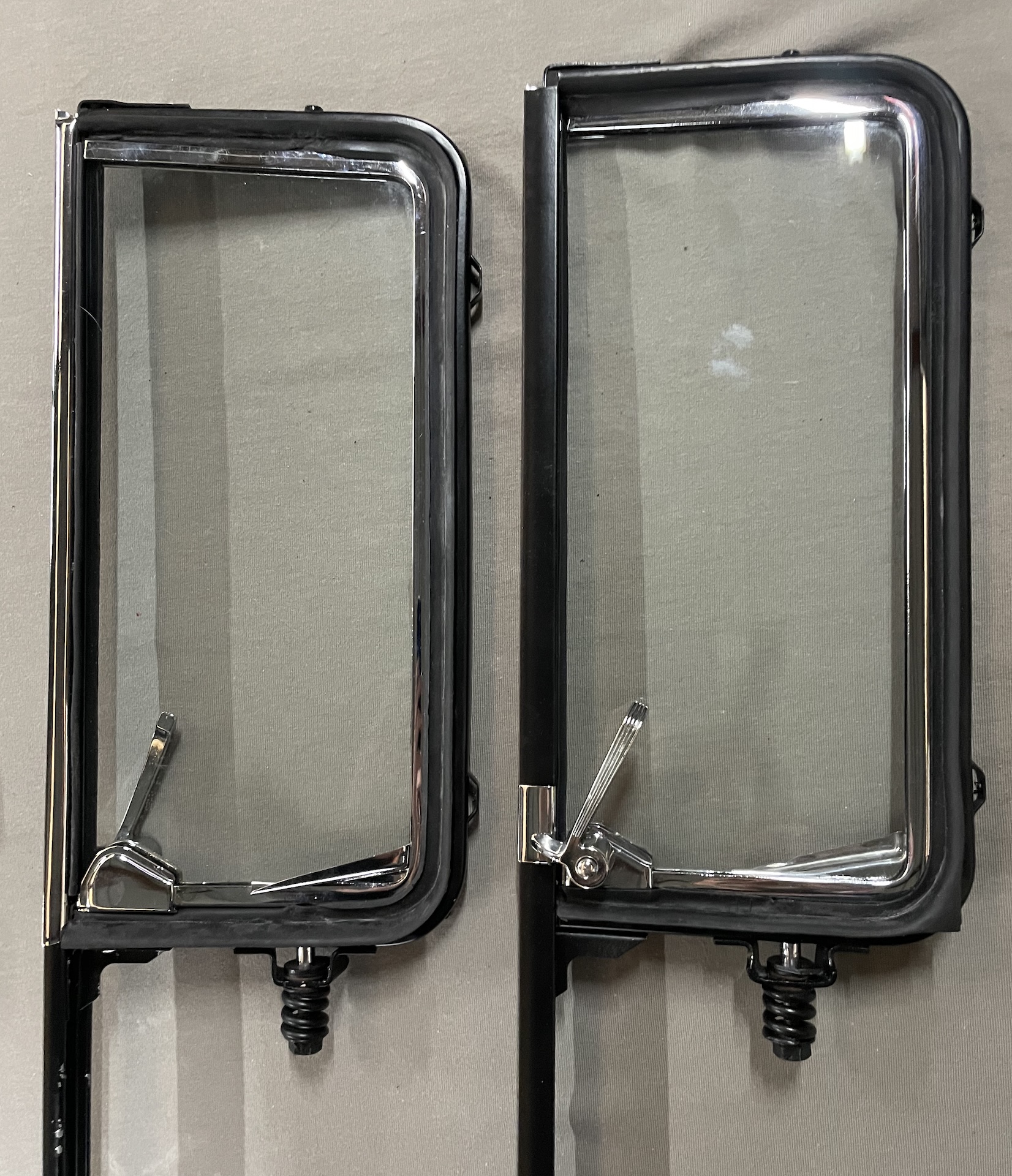

Time to start reassembling. First up - 1/4 vents. Spent probably half a day searching through the last 5 years of photos looking for images of how I disassembled them. Used the pictures as reference and rebuilt the drivers side. Then I rebuilt the passenger side, mirroring the drivers. And totally messed it up. Not only did I fit the end stop washer the wrong way round, I managed to have the glass swinging on the wrong side as well.

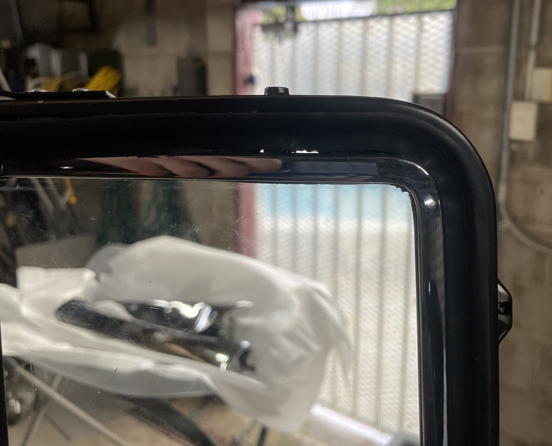

I also fitted these with Better Auto Rubber seals. Not happy with the quality of these, really thin and tore in a couple spots whenI cut to the holes to push the shafts through. In hind site, I should have just looked at the internet images to see that the quality is pretty average. And there is a gap at the top. Not blaming the rubbers for this, probably wear on the fibre washer which is holding the glass frame up.

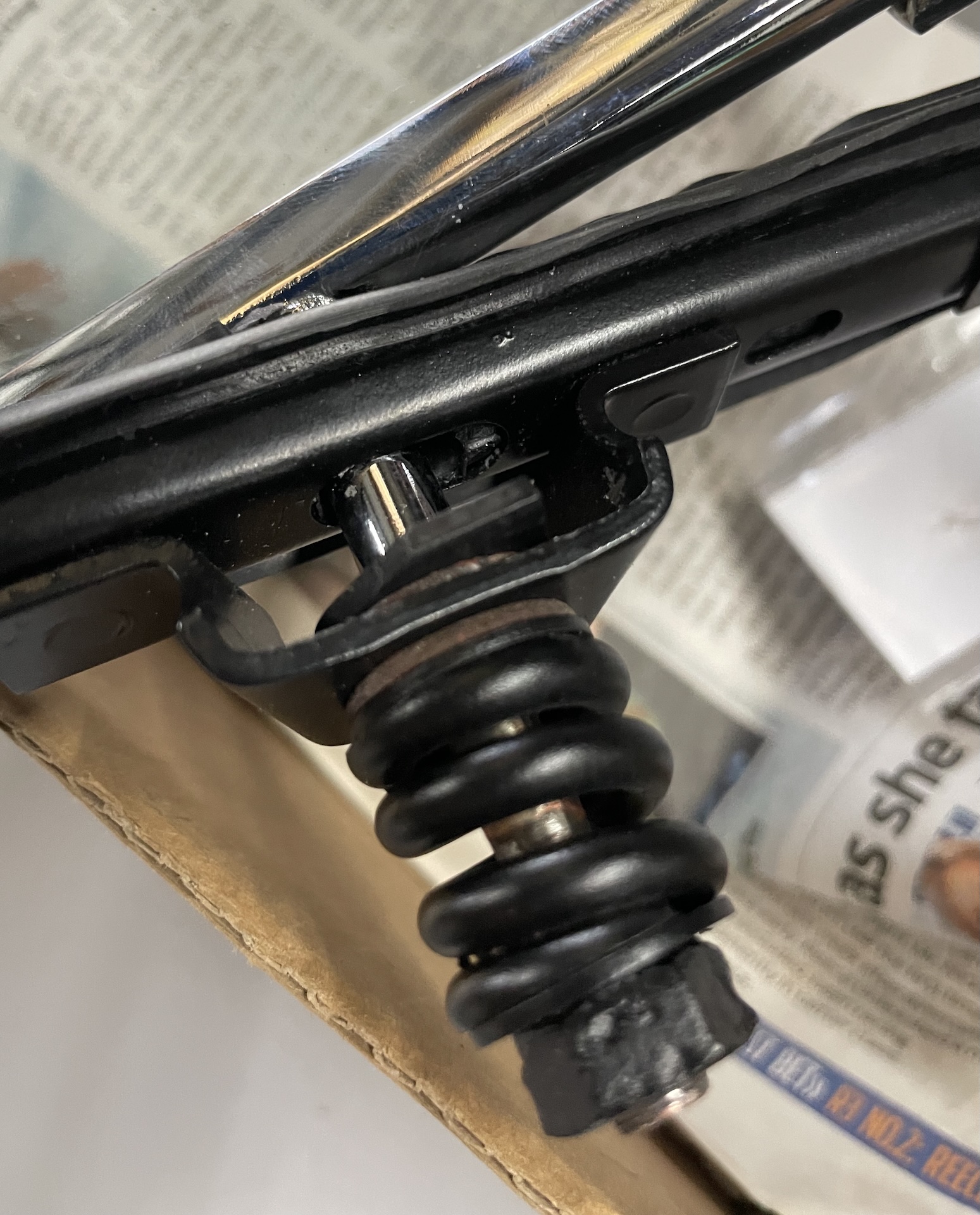

So bit the ($214) bullet and ordered Rares seals. These are much better. To get around the low frame issue I just added an extra washer as a spacer. Much better result, and (as much as I can expect these things to) these are now sealing all round.

Re: Ol' Rusty - FB/EK Sedan
Posted: Sun Jul 12, 2026 10:45 pm
by In the Shed
Good work Scott, you gotta love refurbished chrome pieces.
When I did my quarter windows (using Rare Spares seals) I also had a gap at the top, between window & seal. I ended up placing a small washer between frame and metal bracket to close the gap. They seal pretty good now.
Posted: Mon Jul 13, 2026 6:14 pm
by Brett027
Hi Scott. Exactly the same experiences with the quarter vent windows. I used Better Auto rubber kit on the ute and ended up ditching the vent rubbers and getting Rares. I also ditched the door window felt strip's as they just wouldn't snap in the door holes. Rares worked there as well.

The stupid thing is - those Better Auto Rubbers look awful in the internet pictures. They clearly aren't hiding the fact that they are sub par. Guess I must have been feeling a little gun shy after my last rares experience.
As for the chrome, quoted $8400 (+GST), and came in at that price in the timeframe. The job looks pretty good, but it's not show car. The plating is pretty thick to help reduce signs of ageing!
Was pretty hard to find anyone who would even quote the diecast, so I'll take it as a win.
The parts list was.....
3 piece front bumper
2 x front overriders
2 x custom overriders
3 piece rear bumper
2 x rear overriders
1 x bonnet bar
2 x brows
2 x headlight surrounds
2 piece bonnet bird
2 x front indicator housing
2 x 3 piece tail light housings
2 x 1/4 vent glass frames.
One major expense ticked off the list at least.
