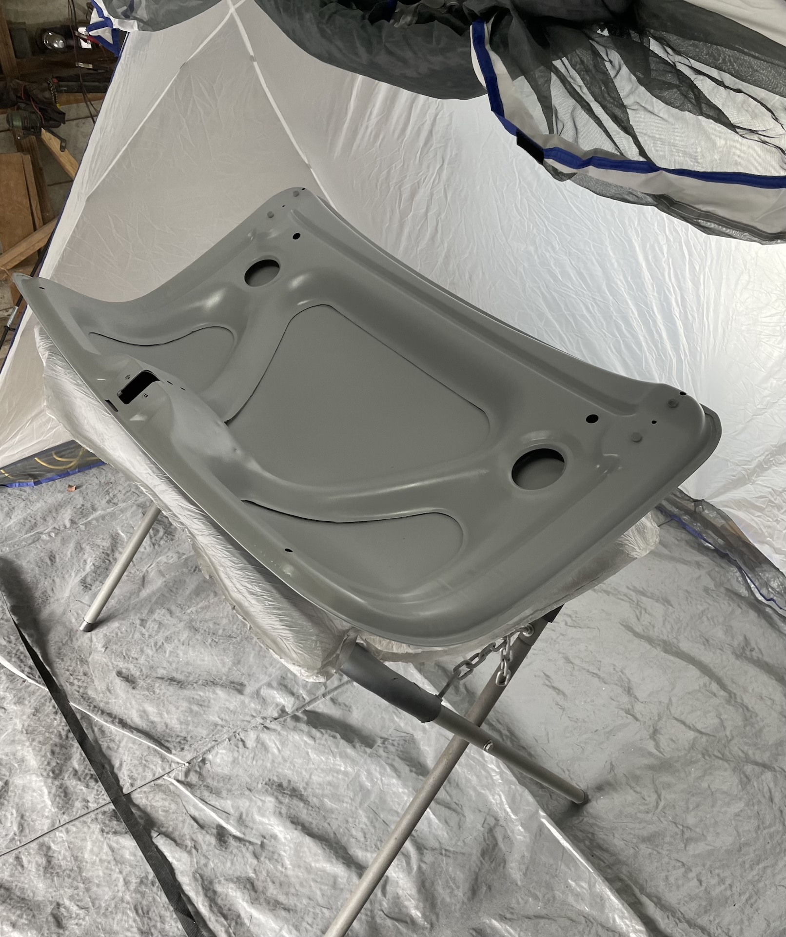

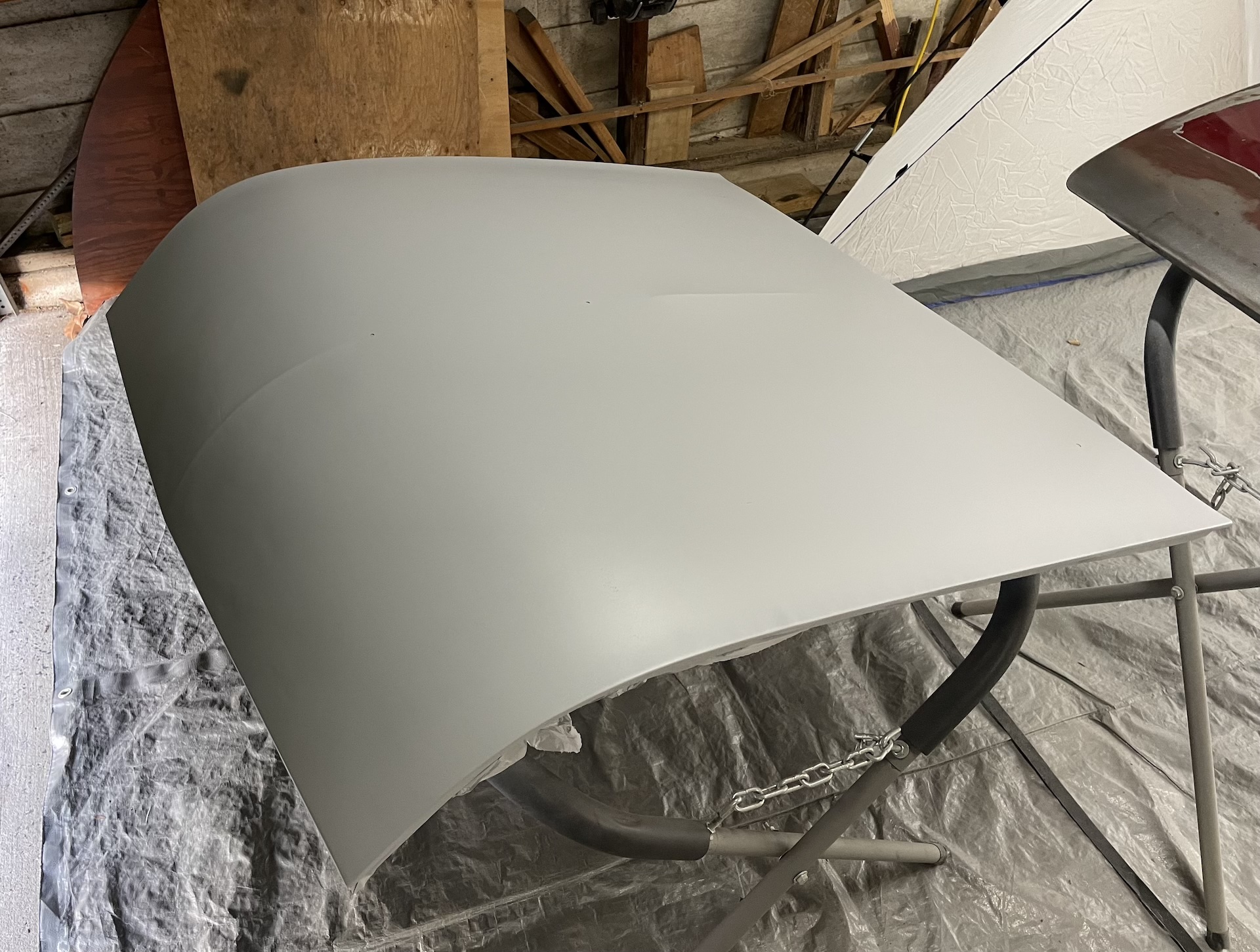

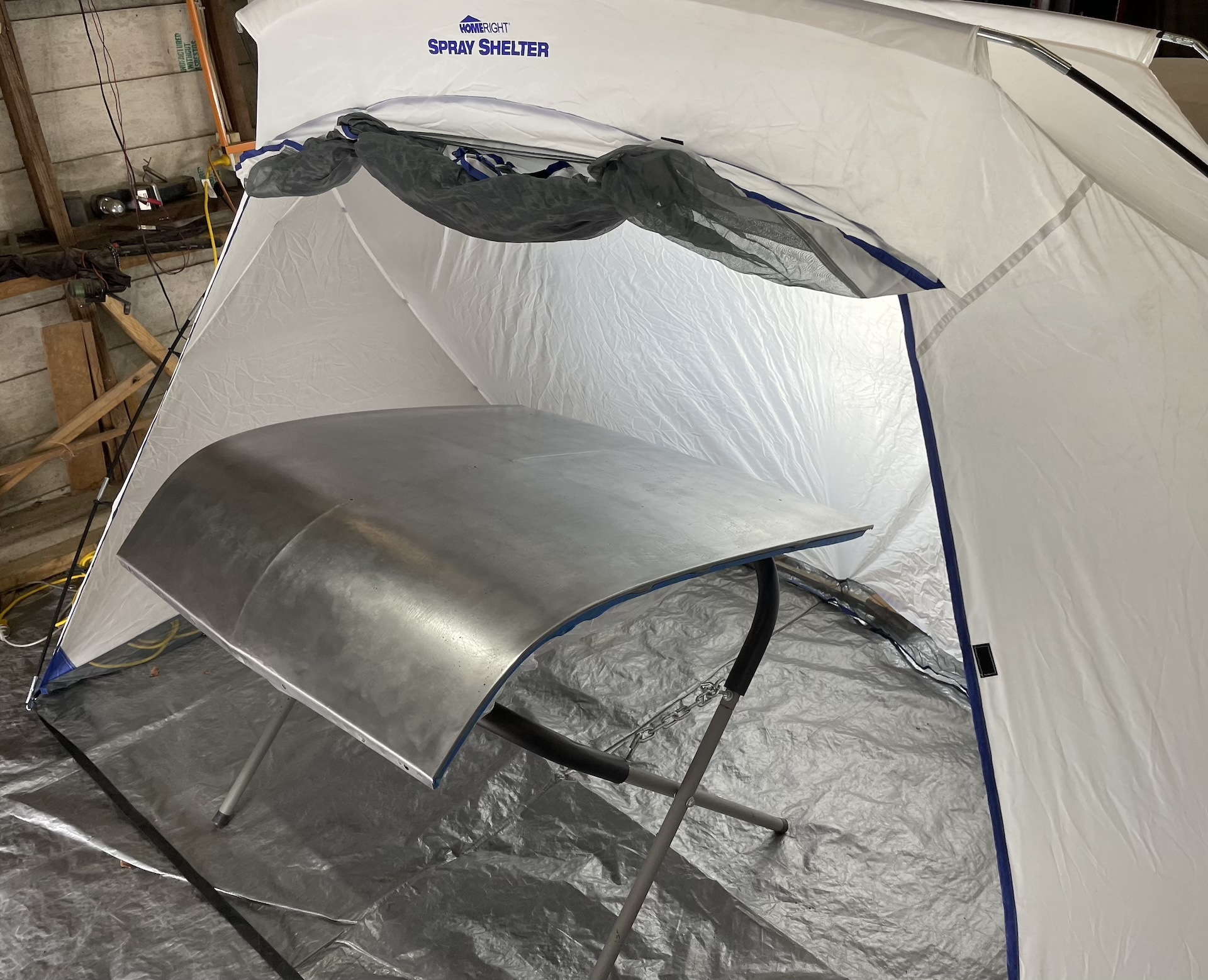

Took the bonnet camping yesterday as the weather was good. It has been sitting in the shed for a few weeks now in bare steel (with a coat of easyphos to temporarily stop it from rusting). I finally got around to ordering some rattle cans of 2K epoxy primer. These SprayMax cans are those 2 part ones where you pierce an inner chamber in the can to mix the paint and hardener. Pot life once mixed is 8 hours at 20C.
This took a can and a half of high fill just to paint the top (the underside is already coated in KBS black). So what to do with a half can - find more things I have stored and put some paint on them. This took a can. Then I did the front passenger door outer and the bottom and top frame of the drivers door that I just repaired. 4 cans in total. Last can stopped spraying paint with at least 50 mls in the can (I weighed it) which was annoying, but overall pretty happy with the results.

Look how good the finish is with a can !!
Epoxy paint is a great invention !

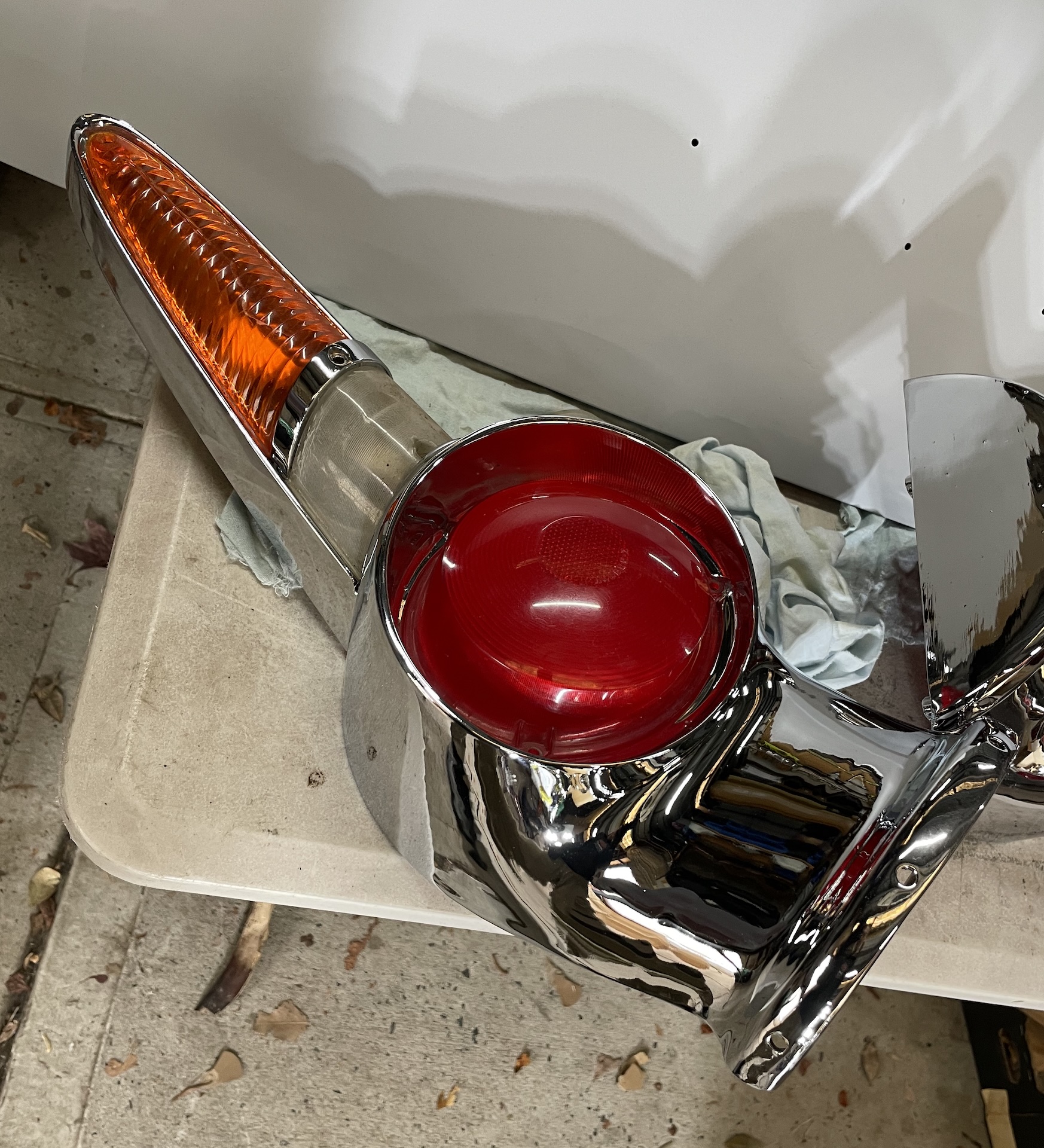

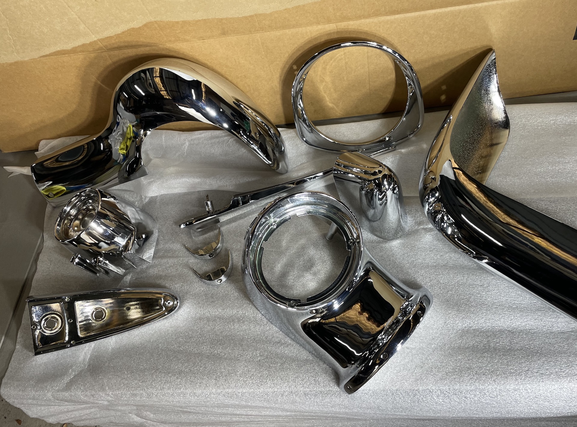

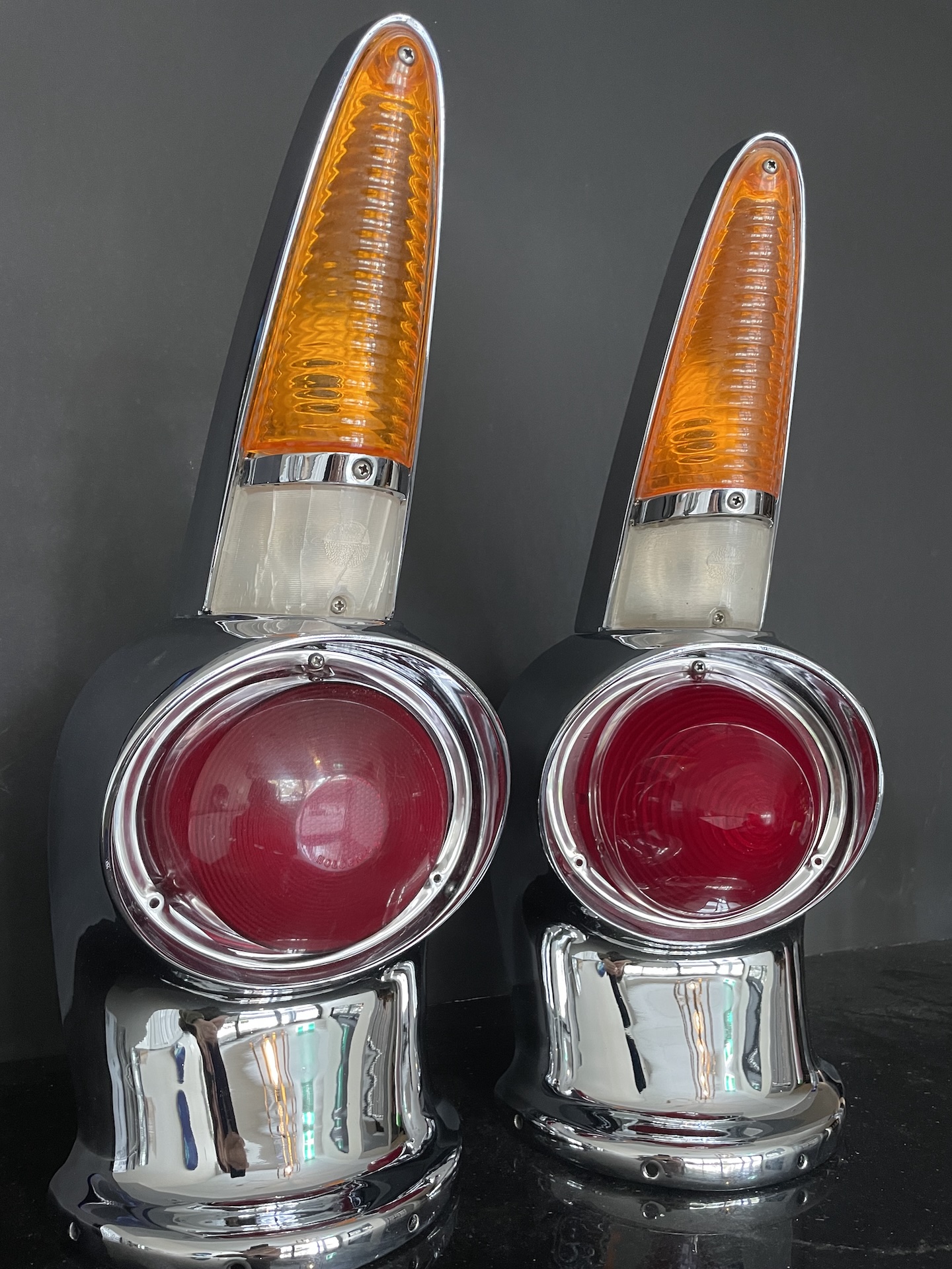

After just over 7 months I have finally got my all my diecast and steel back from the chrome plater. Overall happy with the result, especially the die cast. 29 pieces in total. Here are a few.
Took the opportunity to rebuild the tail lights. Instead of rivets, I just drilled the holes out to 4mm and fitted stainless steel bolts with a dab of thread lock.
Need to replace the reverse lenses and the stop lights have ill fitting bullet lenses that I have to deal with, so for now, keeping it original.
I found these which didn't get a new shiny coat of chrome. So I gave them a quick buff and brassed the nuts which were looking a little rusty and tired.

As for the chrome, quoted $8400 (+GST), and came in at that price in the timeframe. The job looks pretty good, but it's not show car. The plating is pretty thick to help reduce signs of ageing!
Was pretty hard to find anyone who would even quote the diecast, so I'll take it as a win.

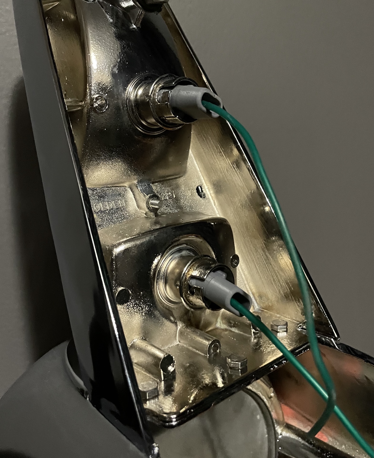

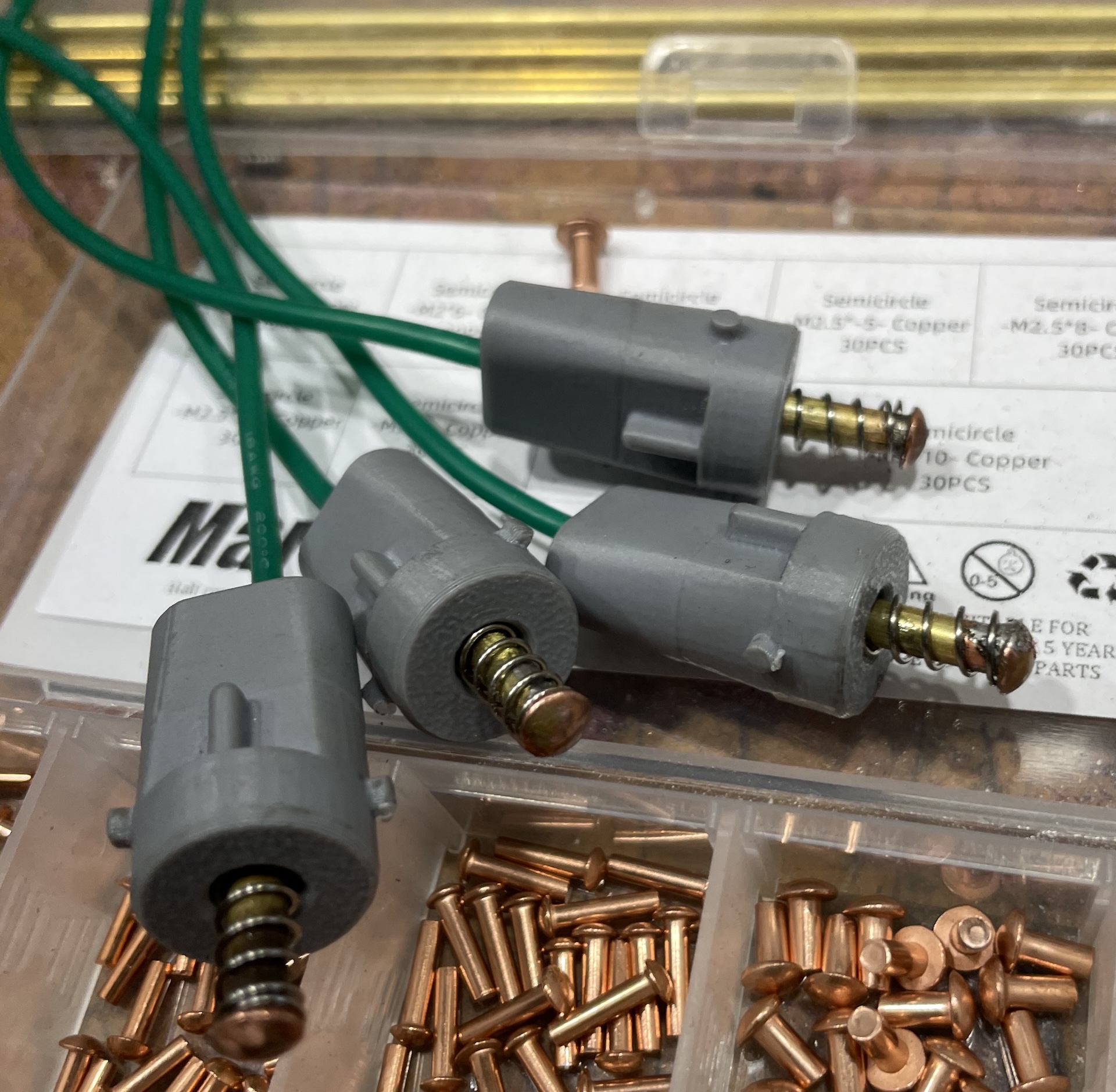

Pigtails for reverse lights
Posted more detail at https://www.fbekholden.com/forum/viewto ... 13#p278513

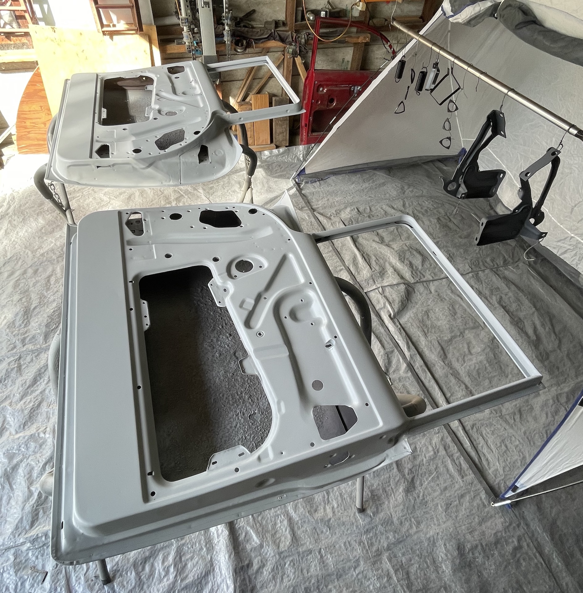

As the days have been cool but dry finally got around to getting some 2K on the insides of the front door, along with acrylic primer on a few of the never ending pile of things to be painted

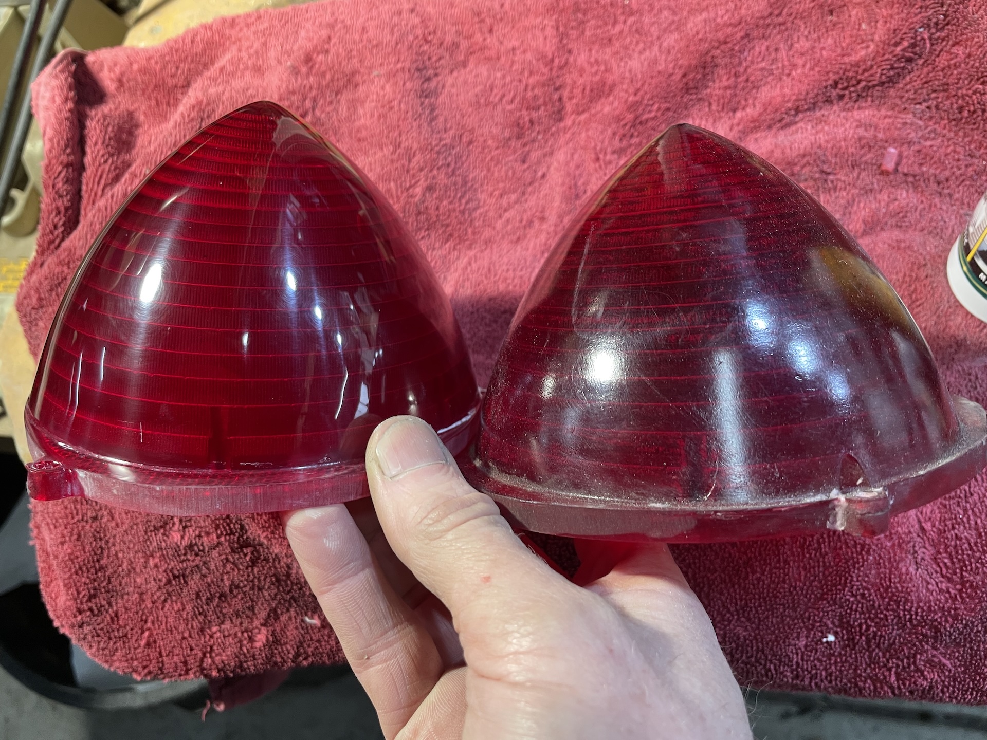

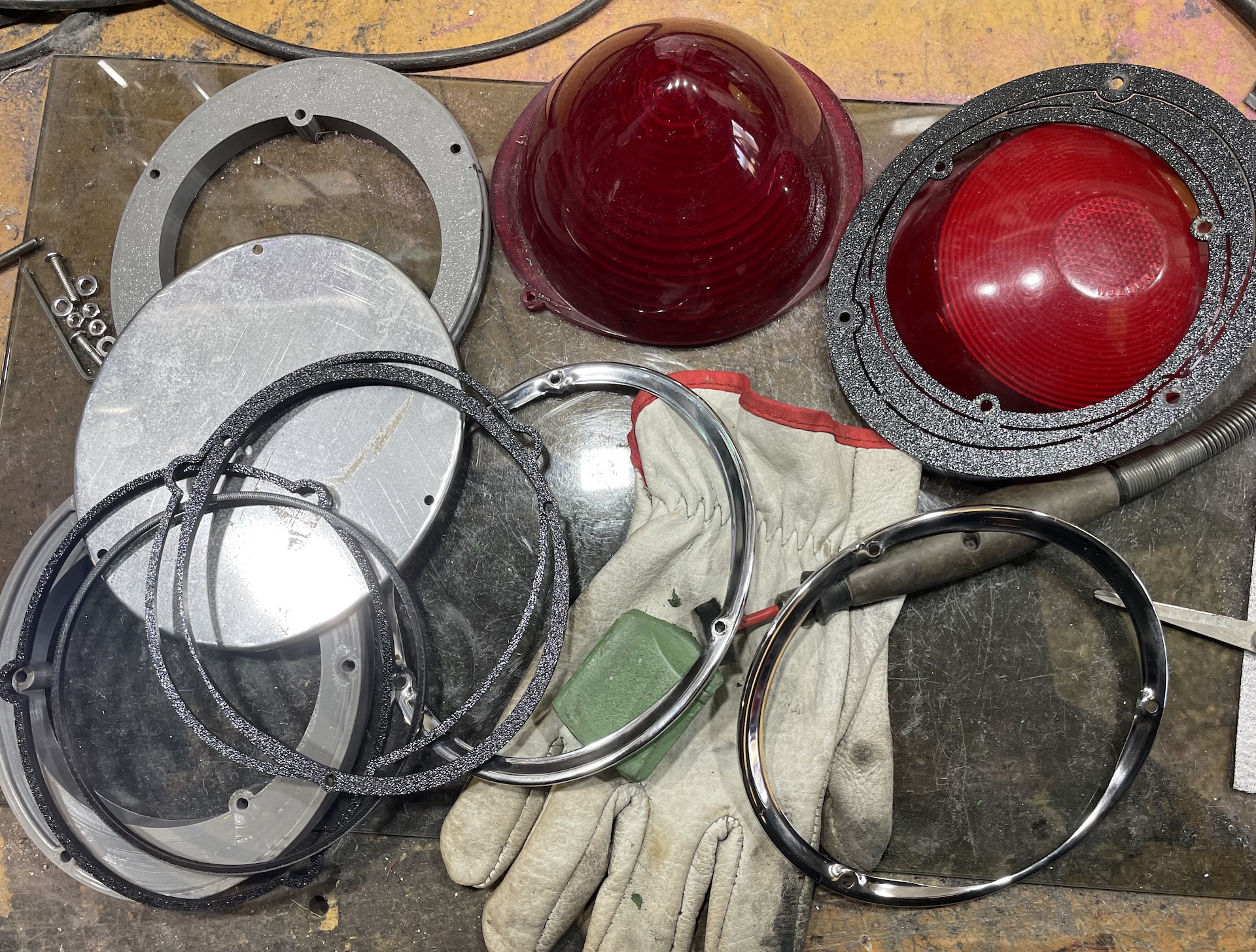

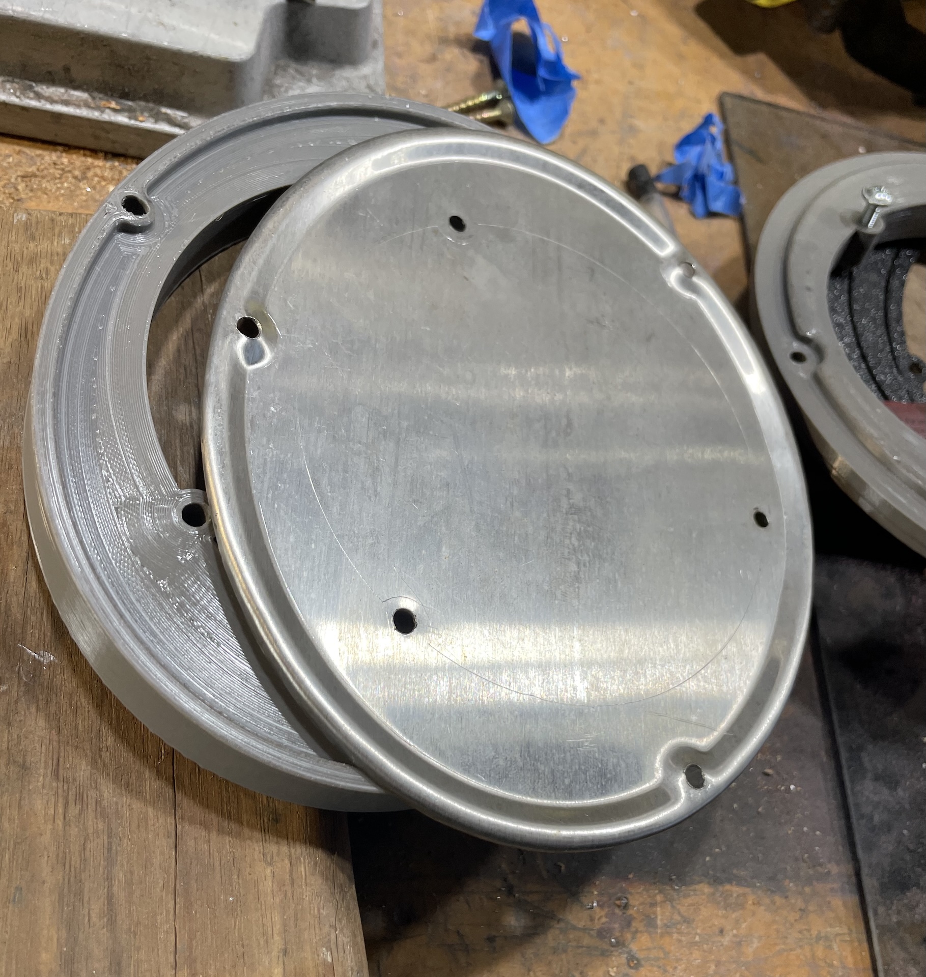

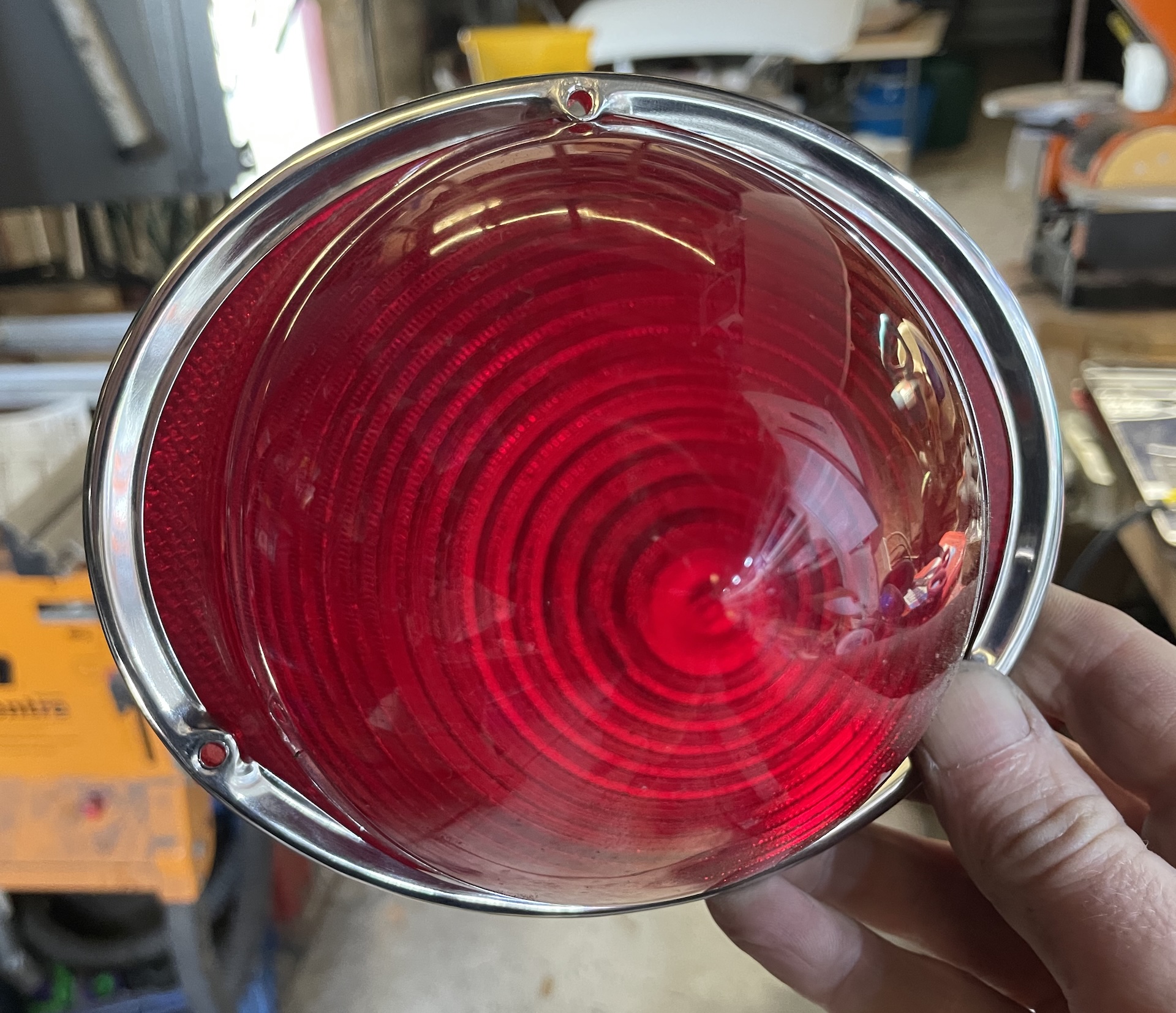

Then there has been the struggles of my bullet taillights - but the solution was worth the effort. Not sure who I got these off (Facebook/here?), but a bit of investigation and they are cast from a modified 1959 Buick Tail Light Lens (Glo-Brite 996. GM #5949897). The casting is okay but I needed to sand and polish them to get them nice and shiny (after is on the left!).
The fit is not great (flex in the mould?) and they are sanded at the bottom to help them fit as you can see in the picture above. One almost fits, the other not so much. So out with the powerfile to reprofile and I bit off too much of the edge and now it doesn't quite fit and have a frayed edge. First solution was to 3D print a red translucent ring to cover the dirty edge. Looks okay but the reds don't match. So as the 3D modelling was now done, decided to print up a mould to press out a ring in 0.5mm stainless steel off an old range hood as a test.
The result of pressing in the vice and then tapping the edge over with a hammer.

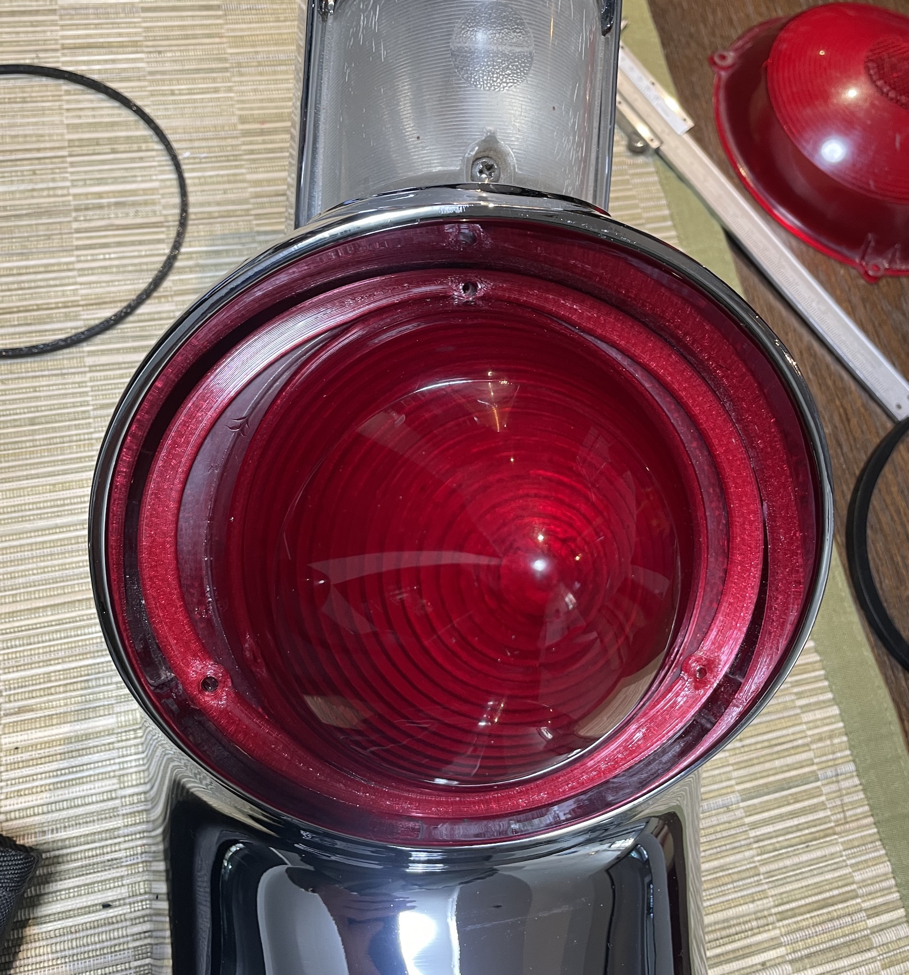

Size was slightly off so made some new moulds and guides to cut and decided that the range hood stainless was good enough.
Some time later, with lots of filing and test fitting.....
With a bit of tweaking, I could make dress rings to tart up regular lenses using the same method, but it is a bit of effort. Really like the look of the bullets now with the extra trim. Feels almost factory.
