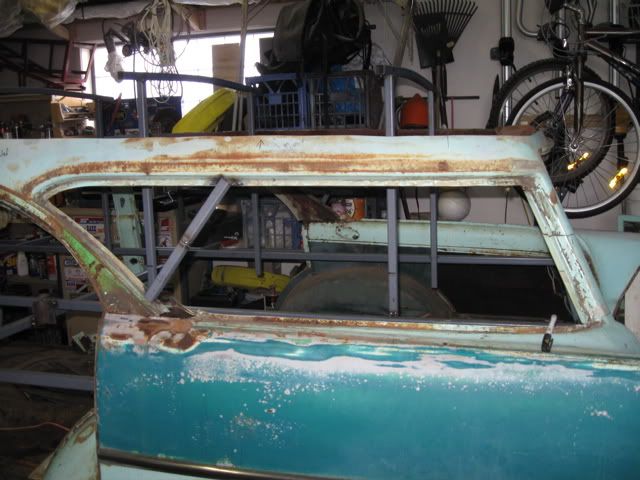

THOSE PROPORTIONS ARE SHIT!....
....there's at least another 3 inches in that chop :lol:

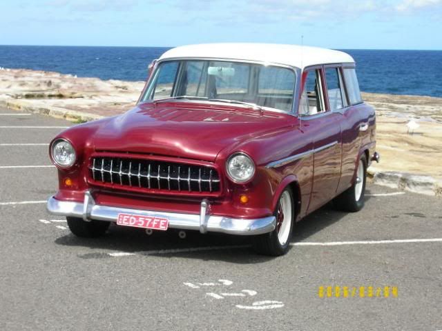

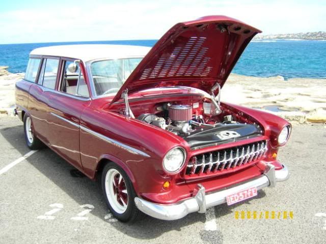

Hi Scotty, I cant take the credit for this.. A Guy called Ed Ho is doing it. He built one of the best fe wagons that ive ever seen... This is it for those who dont know ed..
Cheers Mark

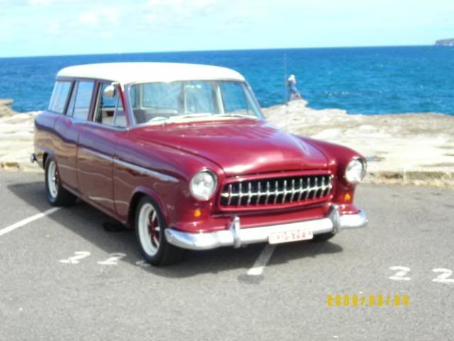

That is a nice FE!! 8) 8) Louvered bonnet, frenched headlights & front indicators, Corvette grill, V8 & so much more!! Do you have a rear shot of this wagon, Mini??

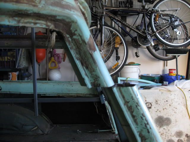

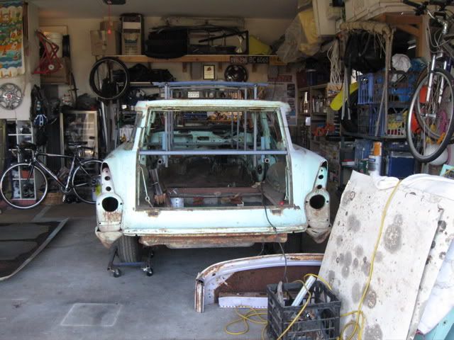

More progress has been made. IM happy with how it's all panning out at this early stage.

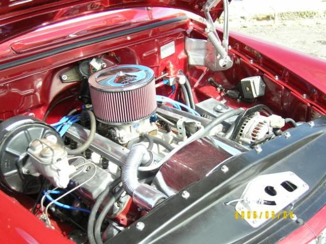

couple of pics of FE.. sorry couldnt resist.
Emailed you more pics Mark,
will start adjusting the roof rail today.
Ed

Awesome work Ed, that would give a Jellyfish a Hard on!!! Love the dash, very well done. 8) 8)

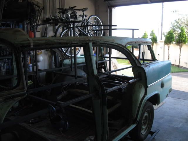

Hi All, Here are some more Pictures..
Cheers Mark

yeah big step up, this is my garage, and I have walls to keep the weather out now! Before the FE I had an EK... I think some of the guards made it on ratbox's delivery?? after I decided the EK was too rusty.. If I knew then what I know now, I could have saved it.. :roll:
Thanks to Mark for giving me this opp to work on his wagon, I've spent years thinking about chopping a wagon.. I had braced my FE wagon to do it before deciding not to due to prolonging the build time.

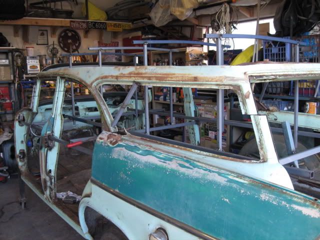

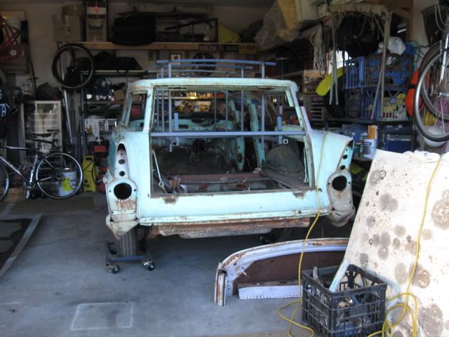

I'm chopping Marks wagon based on the method described by LArry O'Toole, in the book Practical Guide to chopping tops... while there appears to be many different ways to chop a top, Im using the same method used on the 55 wagon.
Just finished the upper seat belt mounts / strengthening plates, and will be adjusting the roof rails this week to the new lengths required.

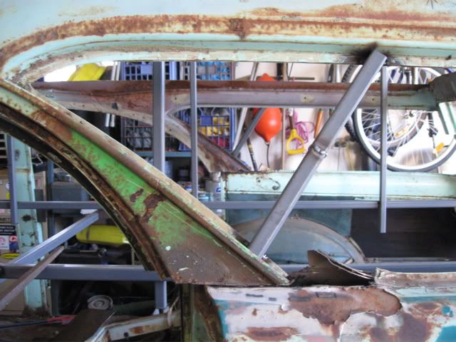

Spent some time making upper seat belt mounts / pillar strengthening plates.
B pillar plate is 10mm thick, and it is captured in slots cut into the pillar.
tapped a 7/16" UNF thread for the belt mount. this helps align the pillar too when working on the rail.
the A and B pillars on one side will be tacked in and then the roof rail split longitudinally and the other side done before stretching rear ward to align the rear pillars.
