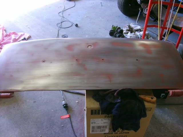

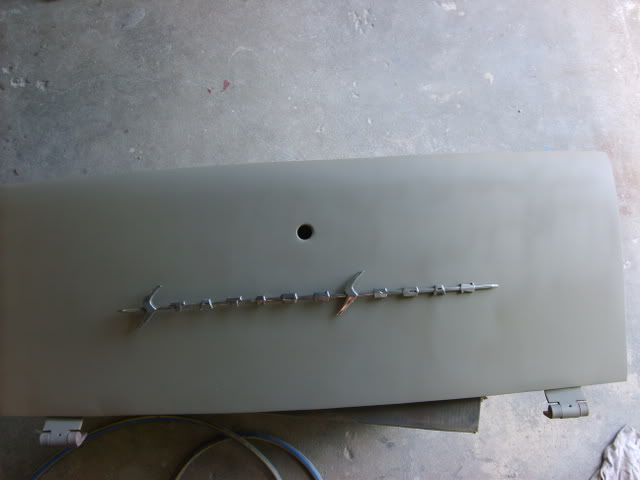

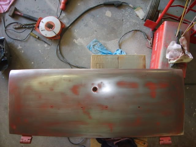

bit more progress with the panel work
stripped the botom and top tailgate and repaired the dents
as you can see the red patches are dents these were repaired
by nocking them out filed off and body filler for cosmetic purpose
sanded and etch primed then primer filler sprayed on it will be blocked
off in a week and then a light coat of under coat ready for paint
also pics of one of the doors i spent a week on getting straight
it was full of dents to the point of i nearly chucked them out but
persistance looks like it will pay off :D :D
