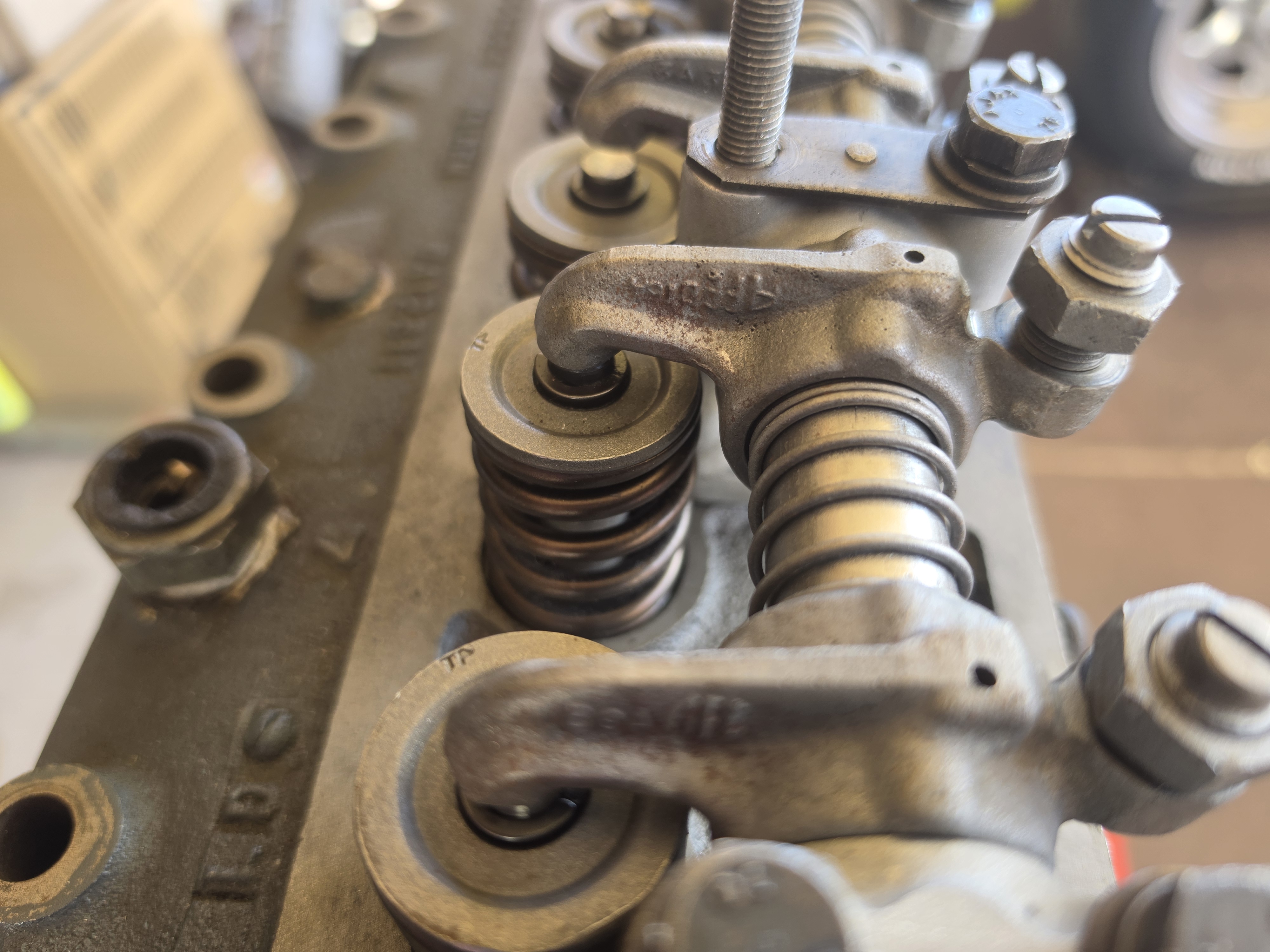

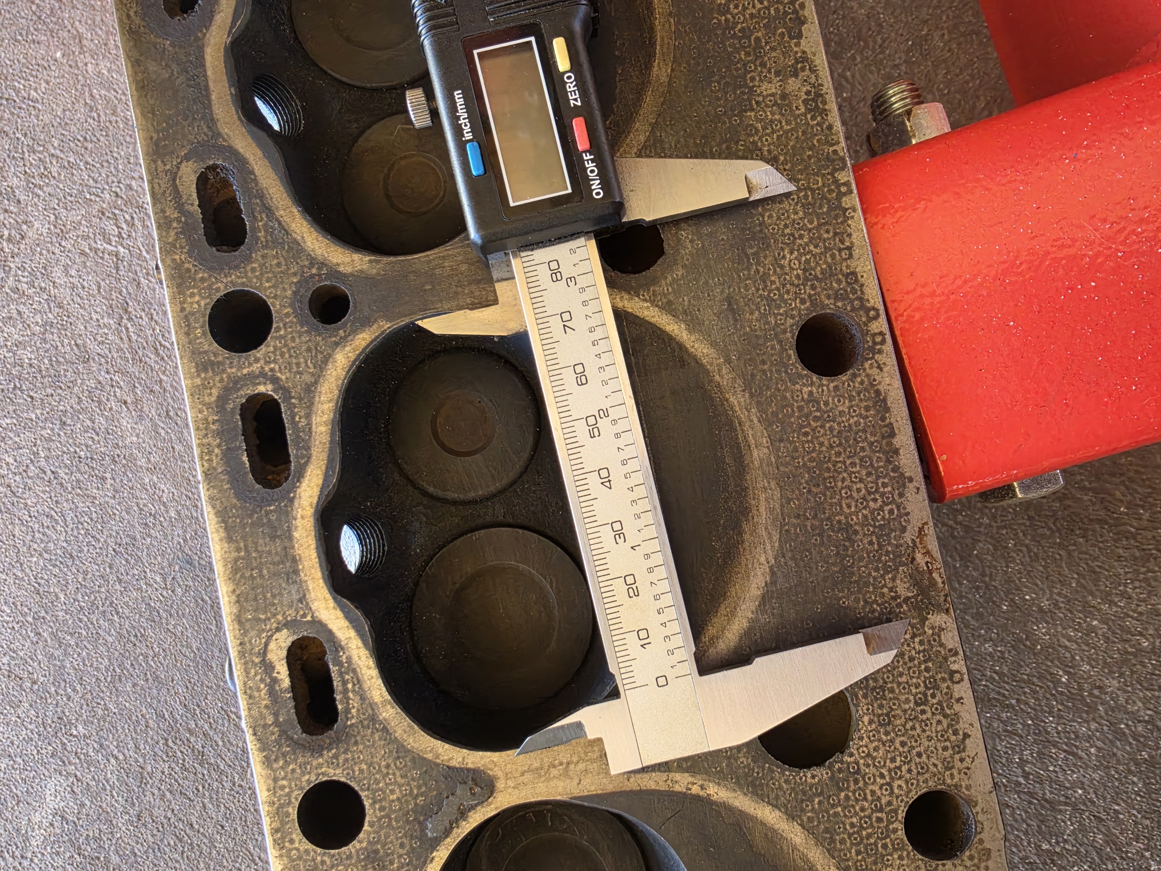

Round 2
- 20260829_102642.jpg (3.07 MiB) Viewed 185 times
- 20260829_102620.jpg (3.66 MiB) Viewed 185 times
- 20260829_102544.jpg (2.56 MiB) Viewed 185 times

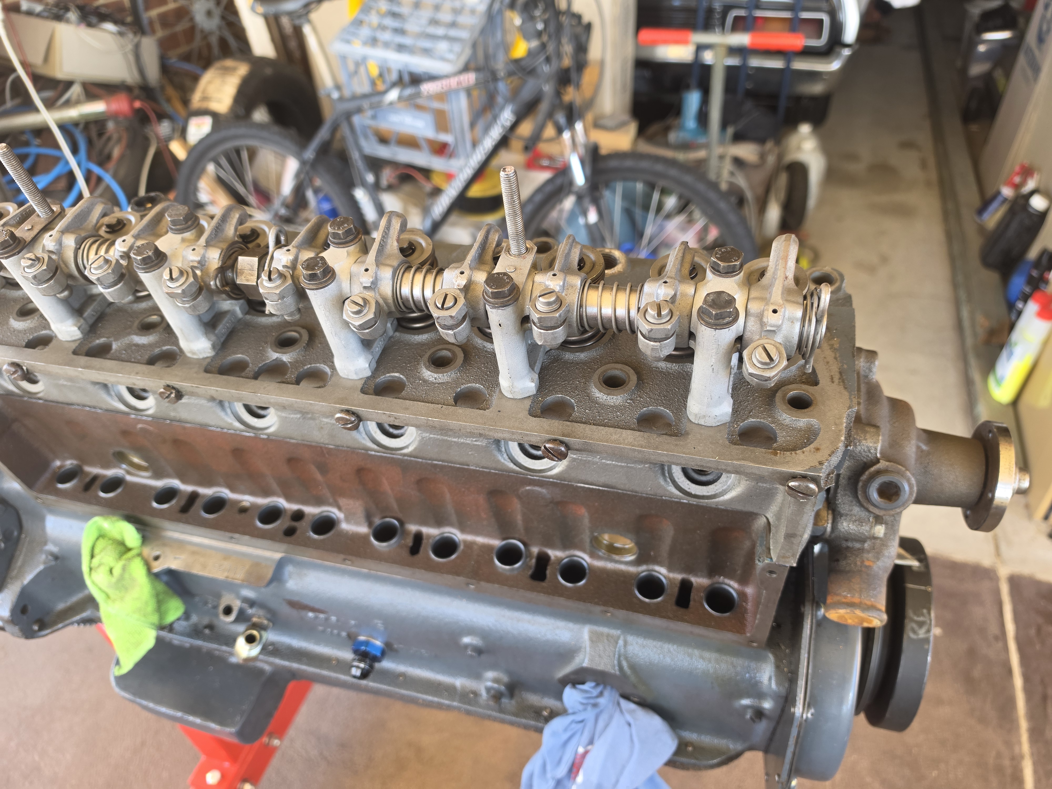

Re: Are you Bored? Bang for Buck Engine recipe required.
Round 3
- 20260829_103119.jpg (2.44 MiB) Viewed 185 times
- 20260829_103041.jpg (3.12 MiB) Viewed 185 times
- 20260829_102944.jpg (3.15 MiB) Viewed 185 times

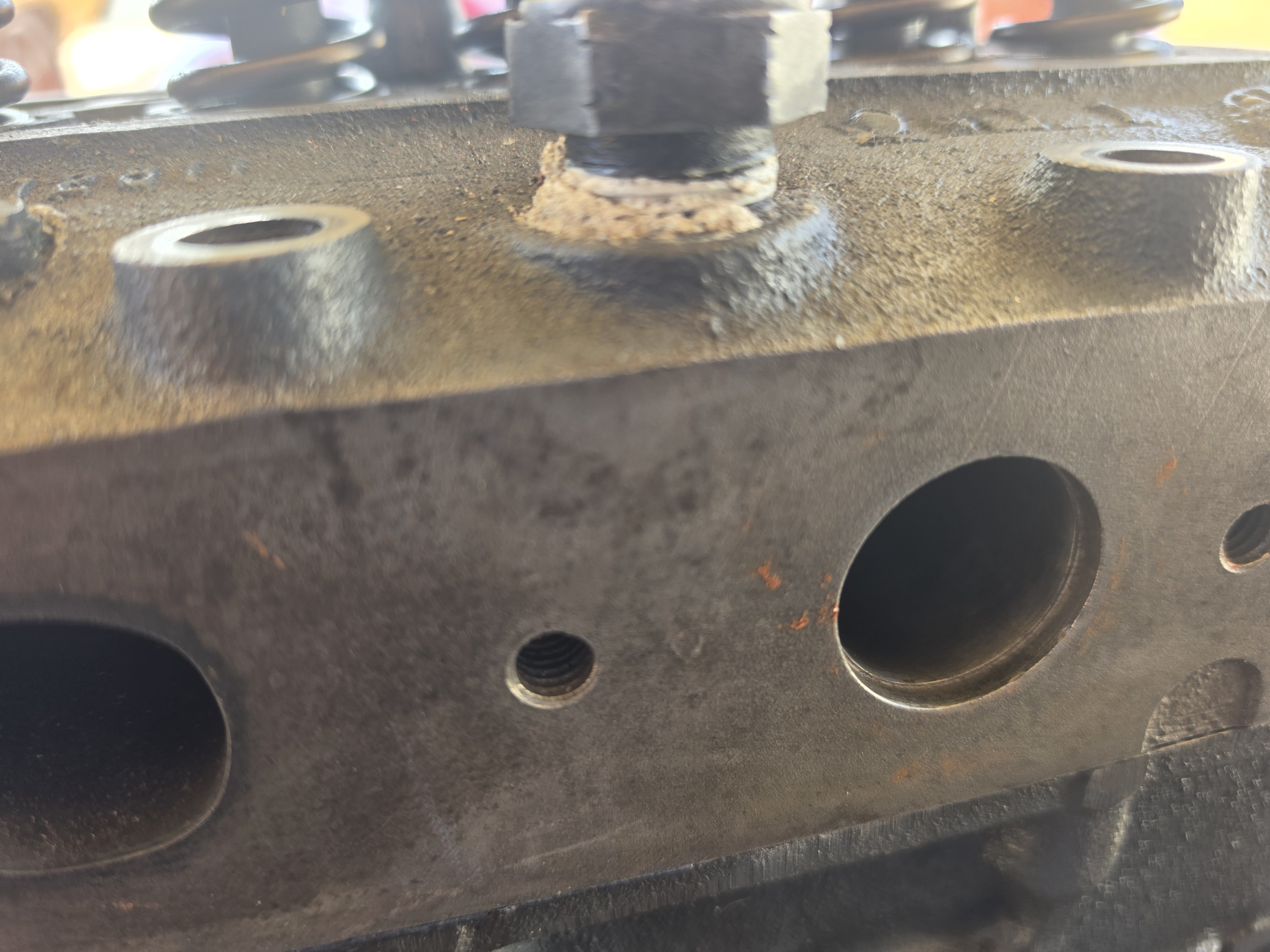

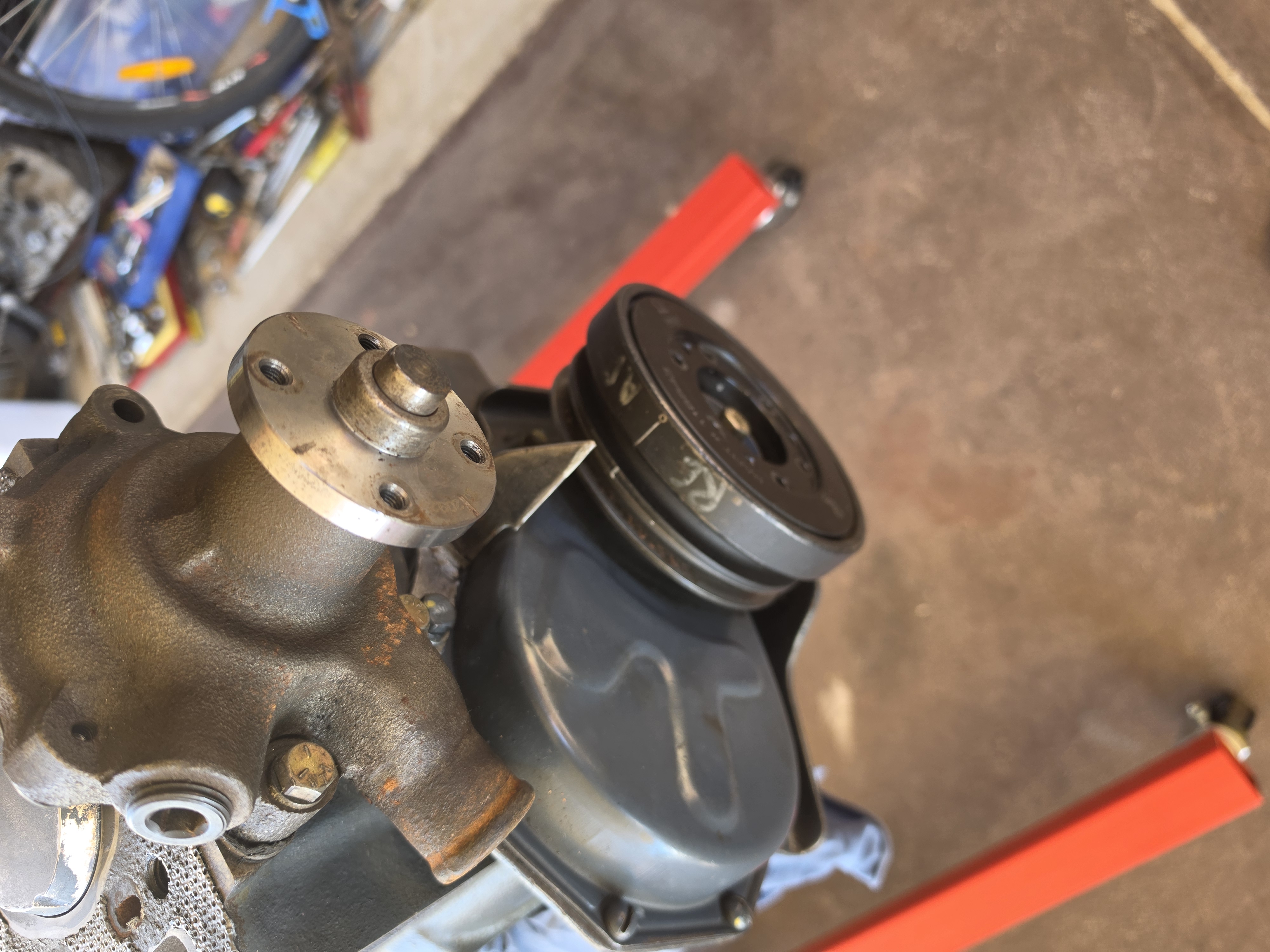

Last ones.
- 20260829_103301.jpg (2.12 MiB) Viewed 185 times
- 20260829_103131.jpg (2.75 MiB) Viewed 185 times
- 20260829_103127.jpg (3.34 MiB) Viewed 185 times

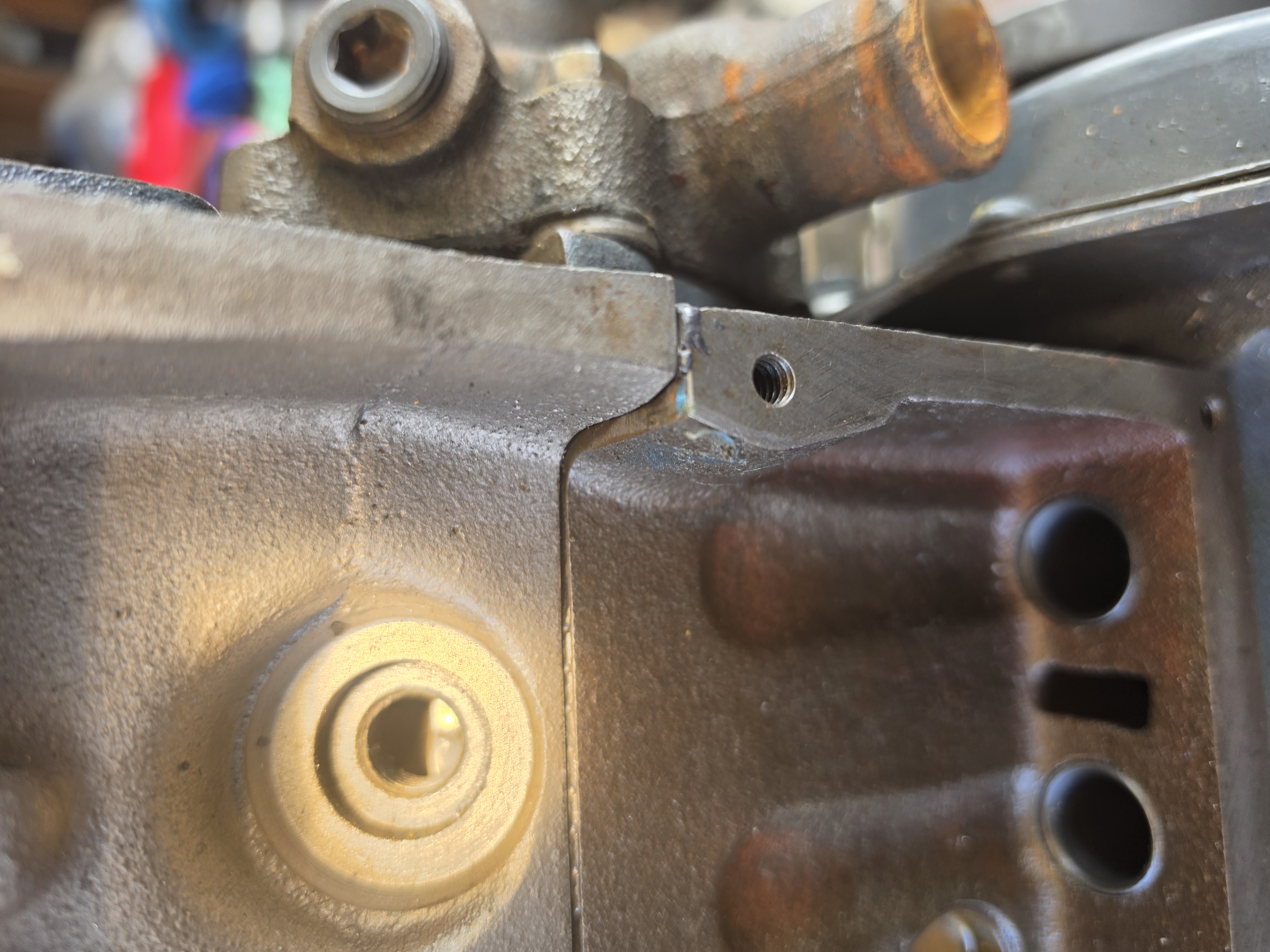

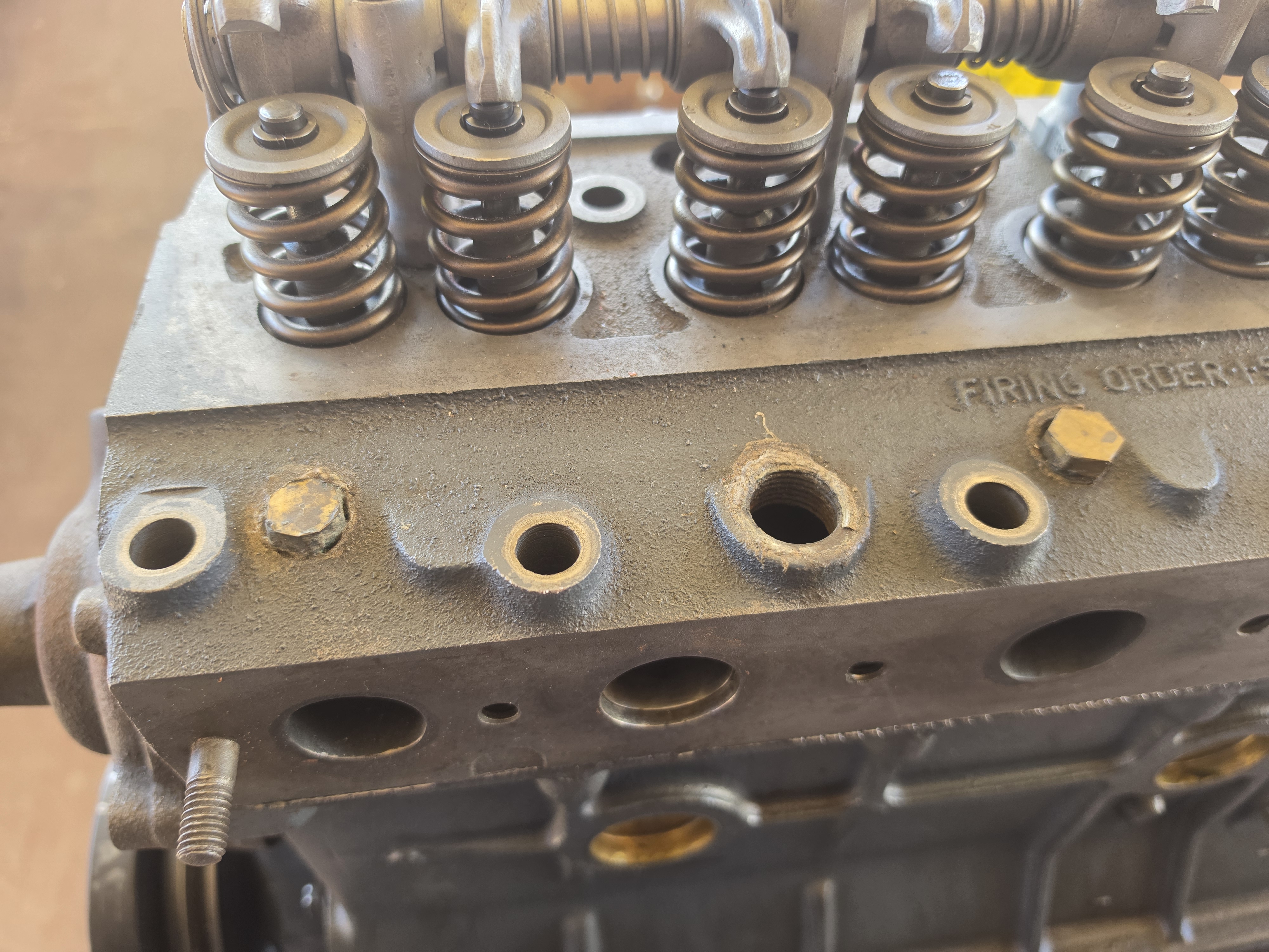

Oh, the head has been machined past the Thumbprint.
Sorry for the inverted images, senior moment...
The block has a B prefix and I believe the head is also around that era with a heater plug and a temp sensor.

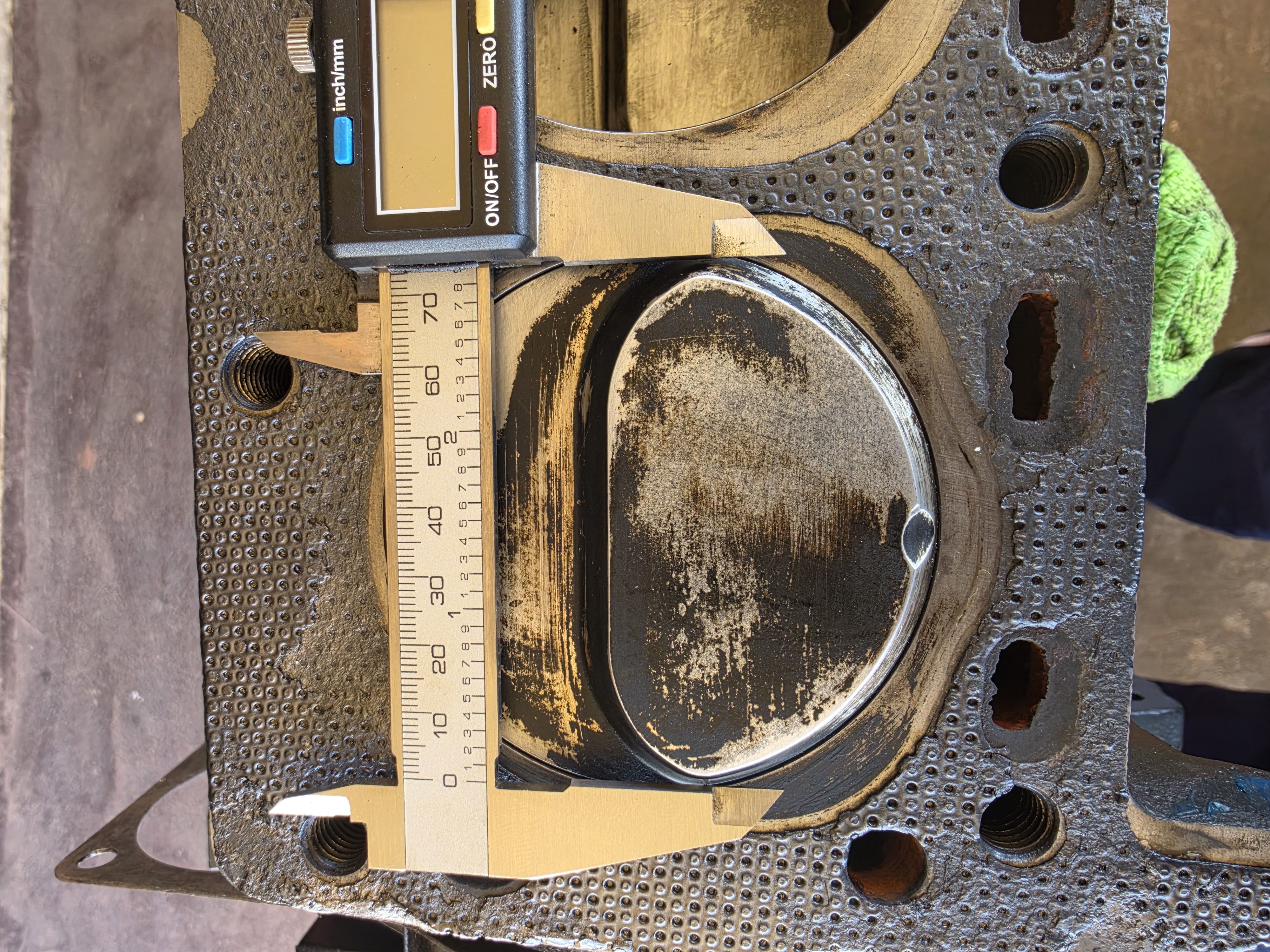

Another omitted fact, the piston dome height is 8mm.
Cheers Ed.
Cheers Ed.
Bore.3.125 inch from memory.

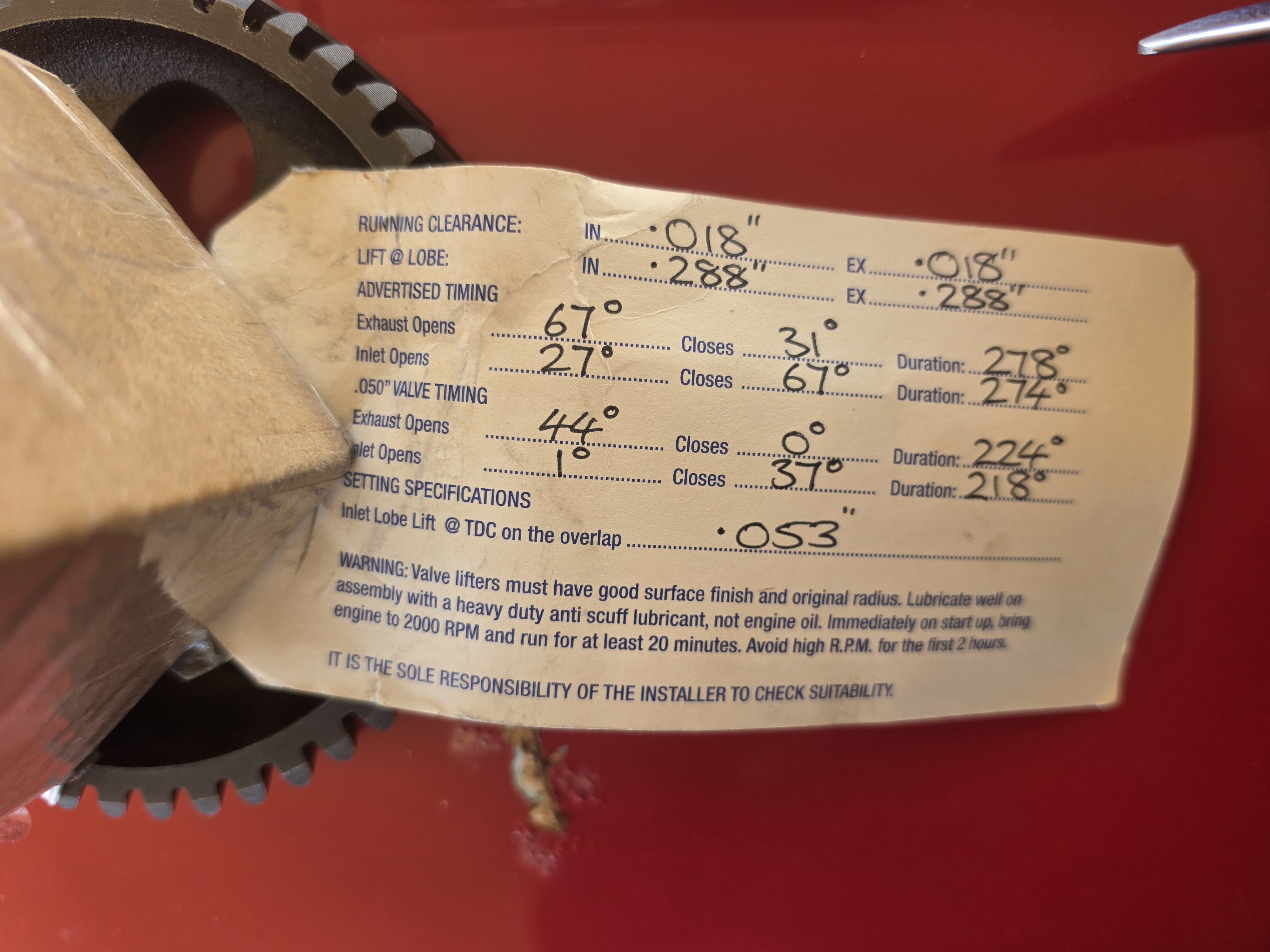

You have made me think about using the existing unknown Cam.
The previous owner said power didn't come on until about 3000 rpm but I did not know what is was like before that.
If I stick to the existing Cam the opel 4 speed lower gear and 4 gears instead of 3 also helps with drivability.
I was also thinking of at least measuring lobe lift of the Cam in the Engine and comparing the lift with the 1433 clives grind.

Another option is to get another compromise Cam.

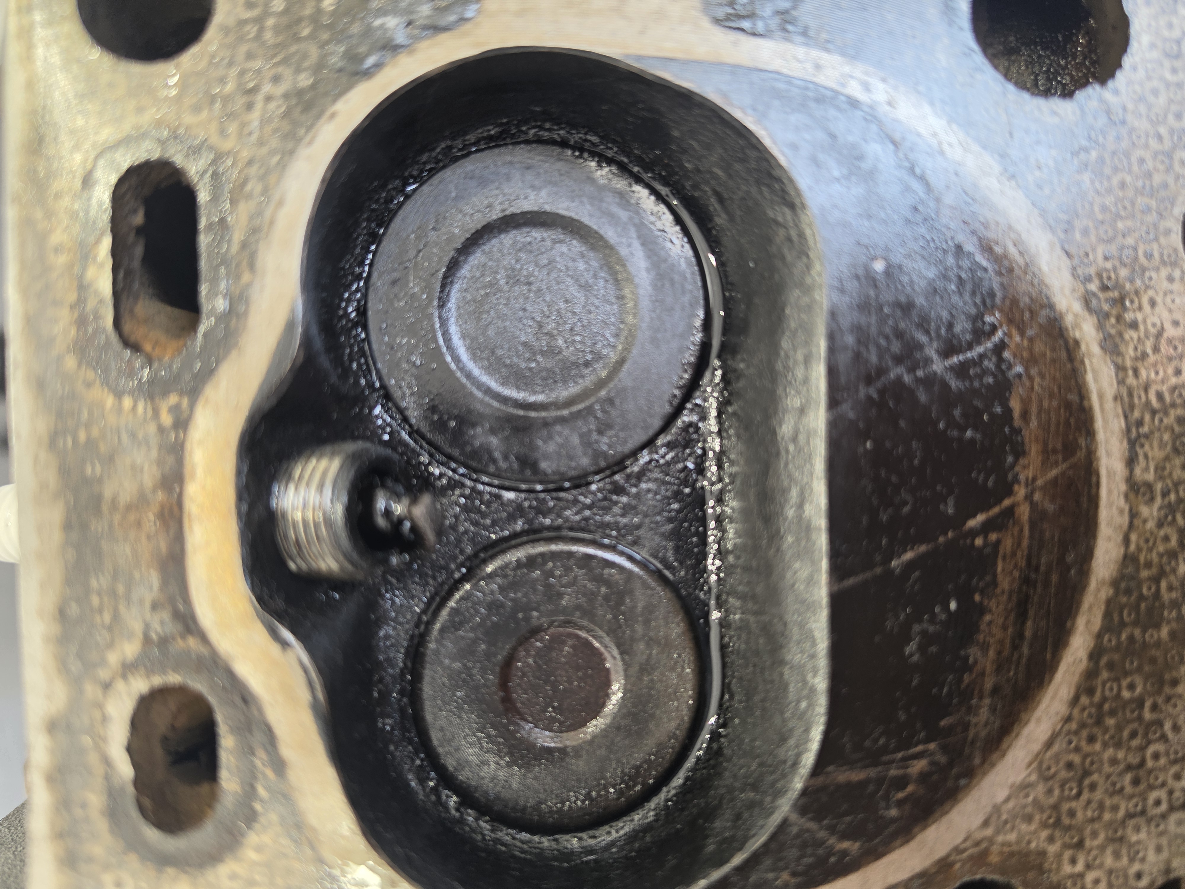

Anyway, I did some ccing today and have some values for people to check my calculations.
I also noticed a couple of interesting things.
Firstly I used an old spark plug from my J motor (Champion RC9YC), it seems not correct and screws too far in, takes up volume and hits the pistons when I drop the head on the block without a gasket, the head sat up about 8mm.
What plugs do people use?
Also, I can see the angle part of the piston through the plug hole.
This has me thinking it would be best to clock the plug so the earth strap going to the electrode is down.
I I was thinking that if the strap is up, the strap would should the Spark from the combustion chamber reducing efficiency.
Anyway, the values.
Combustion chamber volume 50 cc.
Domestic volume 22 cc.
Head gasket volume around domestic. 4 cc
Bore 79.5 mm
Stroke 79.4 mm
Assuming compressed head Gasket thickness 1.5mm, what Compression ratio does everyone get, just to check.
Fitting correct spark plug will increase combustion chamber volume slightly.
Does anyone else want to do the calculation to check my calculations?

That is definitely the wrong spark plug. Waaay too much reach. You want something like the Champion J12Y (13/16" hex, 14 mm thread, 3/8" reach). Grey motors take the same plugs as small-block Chev V8s, but with a different heat range.
ETA: 3-1/8" bore, 3-1/8" stroke equals 143.8 cubic inches.
