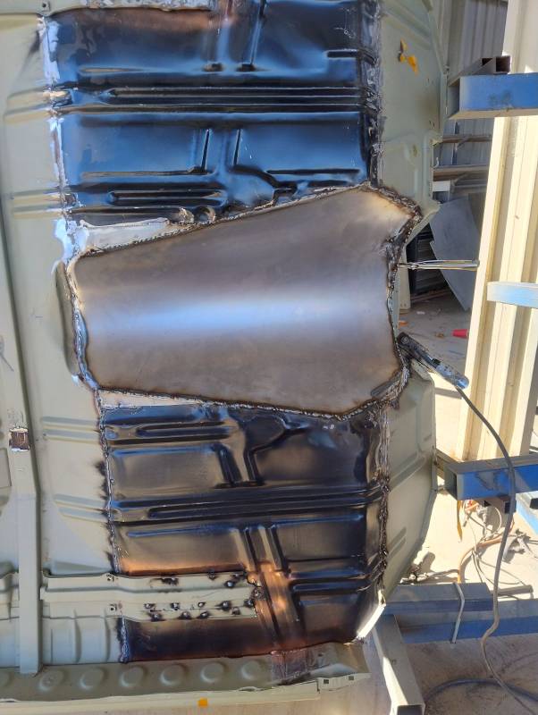

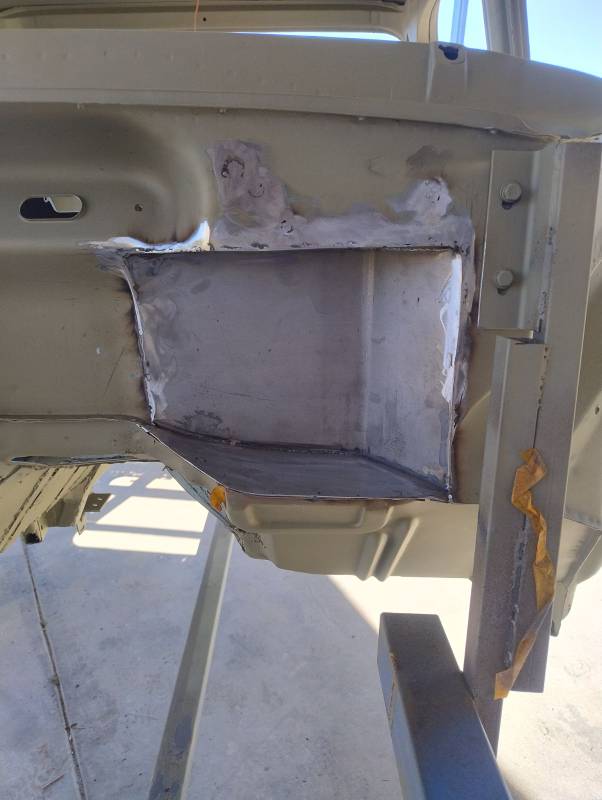

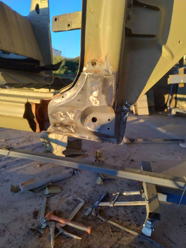

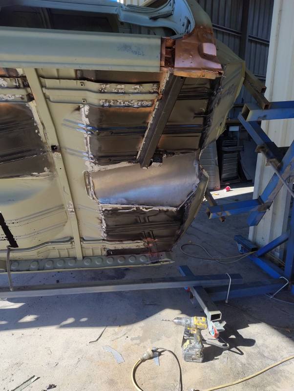

Things are moving along , stopped in at the little brothers tonight (it's his ute now ) and gave his card a hiding on rare spares and a few other places ..
The panel beater is kicking along and making big progress . Fire wall is done for the tripple webbers, inner and outer sills are done , floor pans done , tunnel done it's all happening...

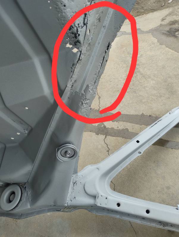

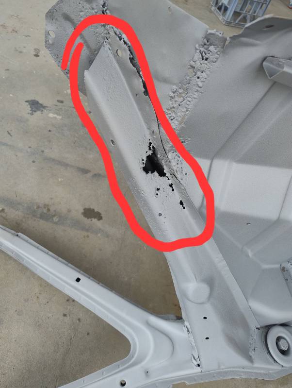

Does anyone make these replacement parts for the subframe where it mounts to the firewall ? Seems to be a regular rust spot hoping someone does them.. this is a second subframe we picked up last weekend and is much better then our original.
Thanks for all you're input so far
Sent from my SM-A546E using Tapatalk
Posts: 2536
Re: Family Affair Ek Ute
I dont think anyone is making them.. Easy to fab up those sections though and I think where yours are rusted is hidden in the firewall. The bottom half shapes are more complex so hopefully yours are ok.
