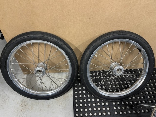

Posted: Mon Jul 18, 2022 8:04 am
Lined up some front wheels for the FED. These were originally owned by Brendon Murry in the US. Brendon is one serious competitor in top fuel (AA/FD) FED racing... 6 times world champion. The wheels then spent some time locally on a Mopar-powered FED running 155mph.
There are a bunch of IHRA requirements for wheels that I have to meet - approved racing tires only, no retreads, minimum 12ā€ diameter, 0.1ā€inch minimum diameter steel spokes, all spoke holes laced, maximum of 1ā€ offset front axle.
First-class pram wheels for a grey-powered FED :mrgreen: .

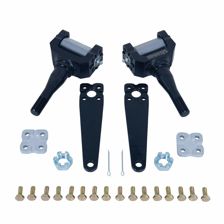

Some more goodies on order for the FED.
Front spindles are from Strange (S3453). These are different to a normal FB/EK in that they do not use a hub to mount the wheel... the fancy bicycle wheels just slide straight onto the spindle, like a billycart. These ones have dimensions similar to old &*#@ Anglias, and are referred to as Anglia spindles. Pretty common in dragsters and altereds, and assume they were used back in the day as they were a small, light spindle. There are alternative spindle mounts (e.g. some referred to as "Strange spindles" that are based on Camaro dimensions). I guess I could have hunted around for a set of original Anglia spindles to make this thing more authentic, but finding and then reco'ing a pair would not have been an easy task. The kids would give me that dissapointed look if I bought &*#@ parts home.

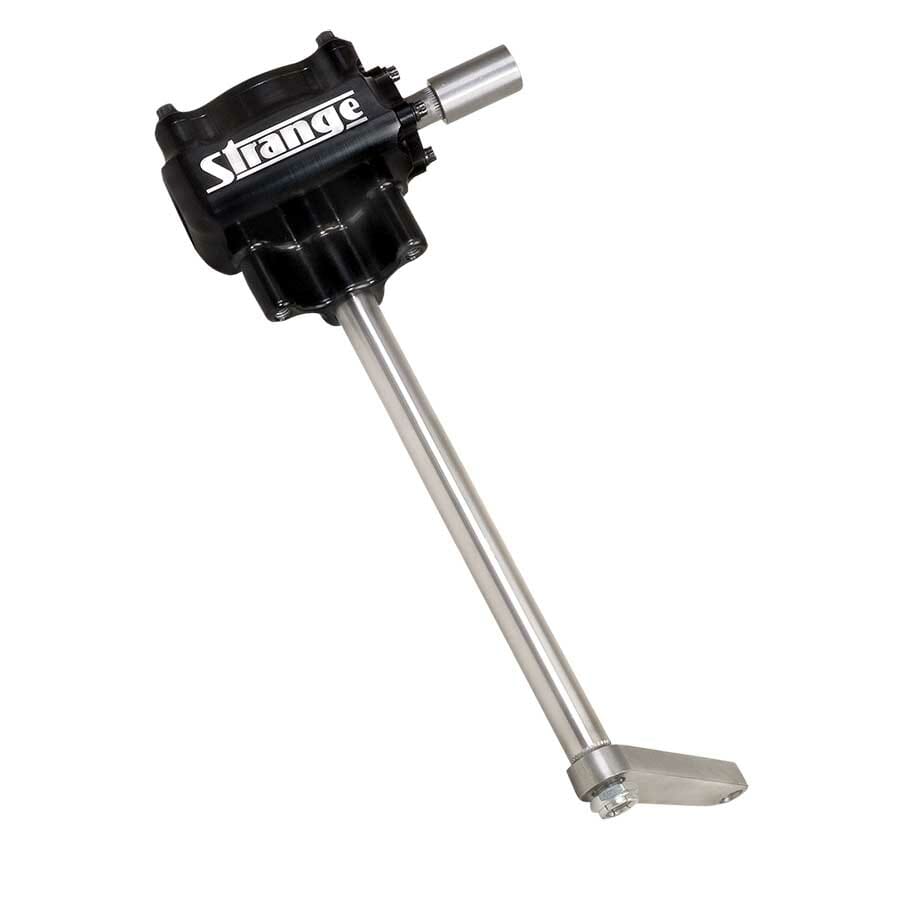

For the steering box, I'm using a Strange S3441S unit. These were designed off a Standard 10. Again, could have tried finding a Standard steering box, but they are like rockinghorse poo (try finding someone who even knows what a Standard was).

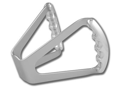

For the steering wheel, I am using a ProWerks C42-482-D. The handgrips on these are beautifully shaped, almost art-deco. It will use a Strange quick disconnect to allow the wheel to be removed (which will help get my broad backside into and out of this thing).

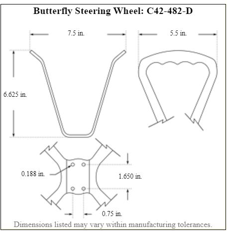

Cool Harv. What’s the steering wheel diameter please? Looks smallish.
Re: Harv's FED thread
Posted: Sat Jul 23, 2022 1:26 pm
Prowerks wheel dimensions.JPG (31.03 KiB) Viewed 3088 times

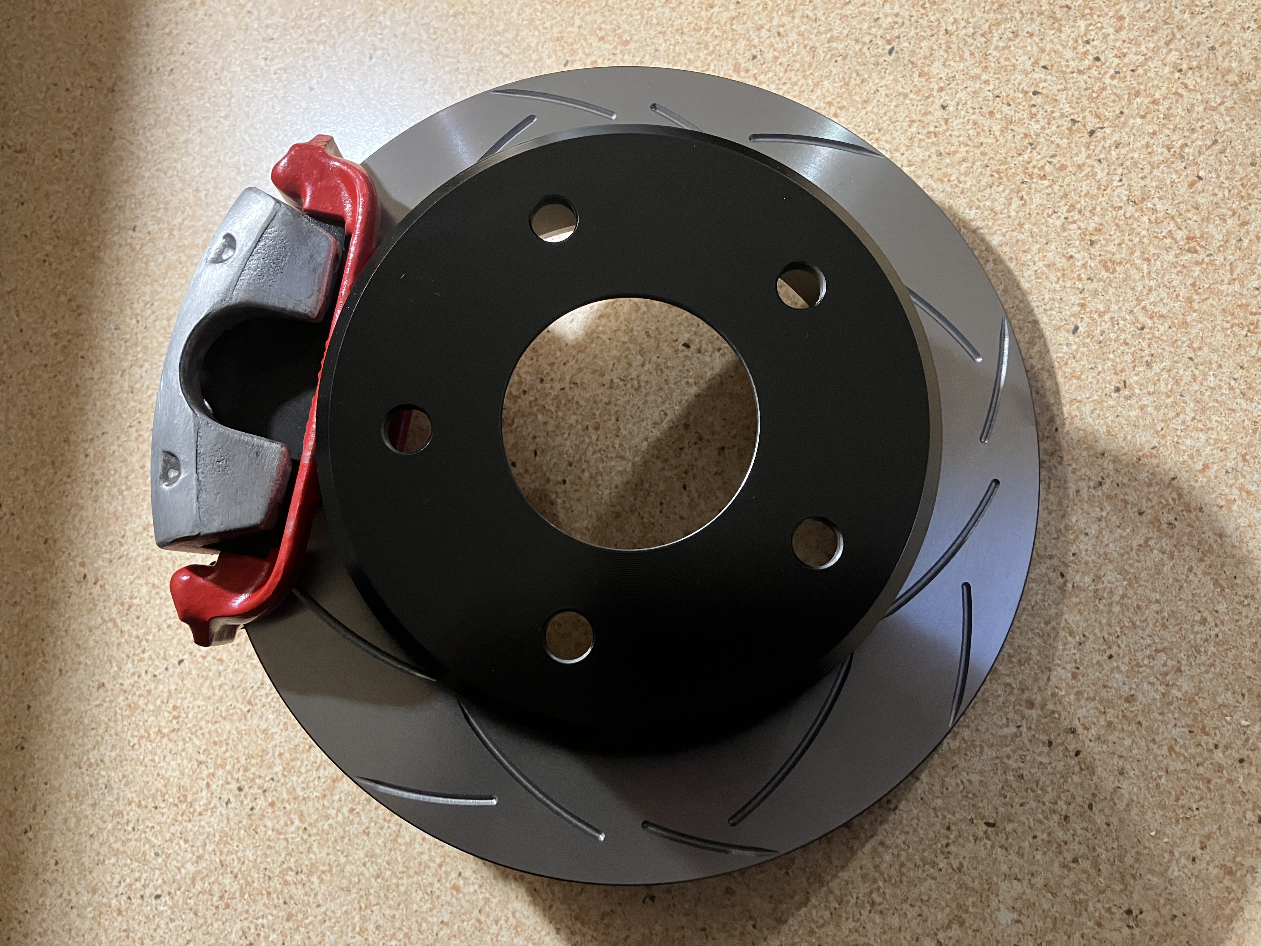

Rear brakes: VN-VS live axle disks, reco’d calipers. Can probably find something lighter (read pricier), but this will do for now. The red calipers should be good for 10mph :lol:
Seat has been made, front axle done and front wheels in place. Fireproof suit, boots, undies and balaclava arrived, kids had a field day playing dress-up.
