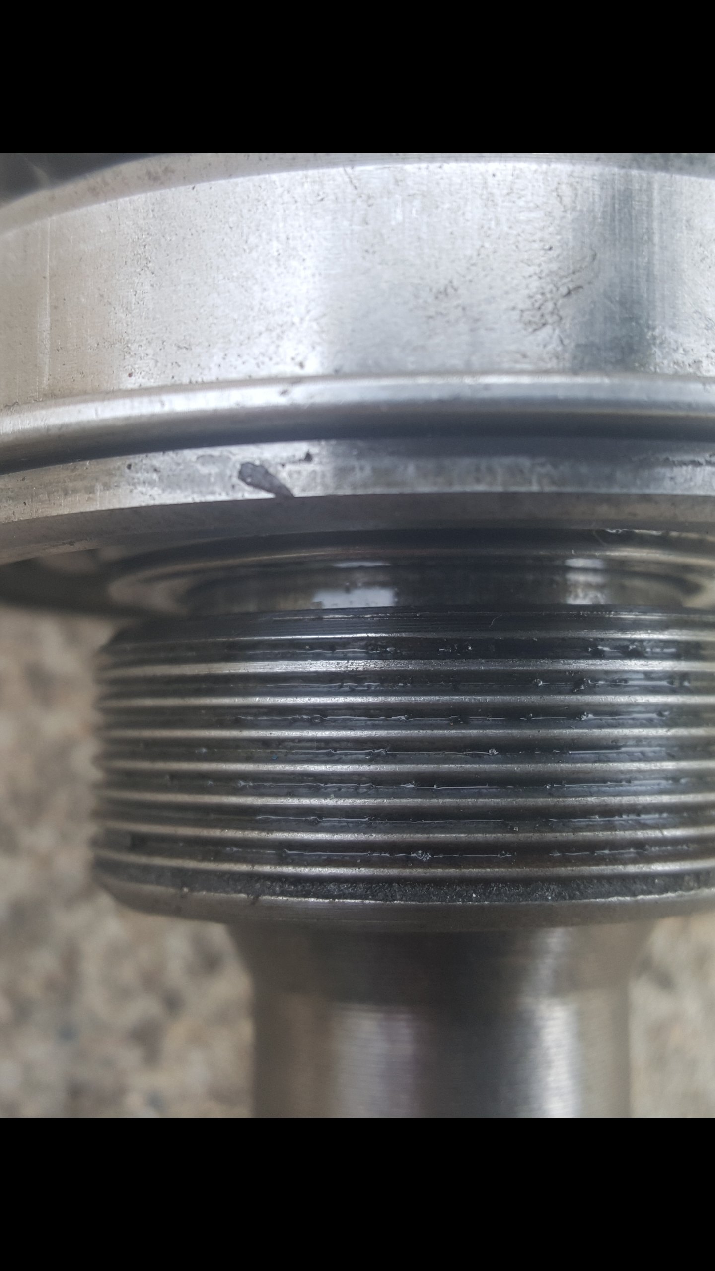

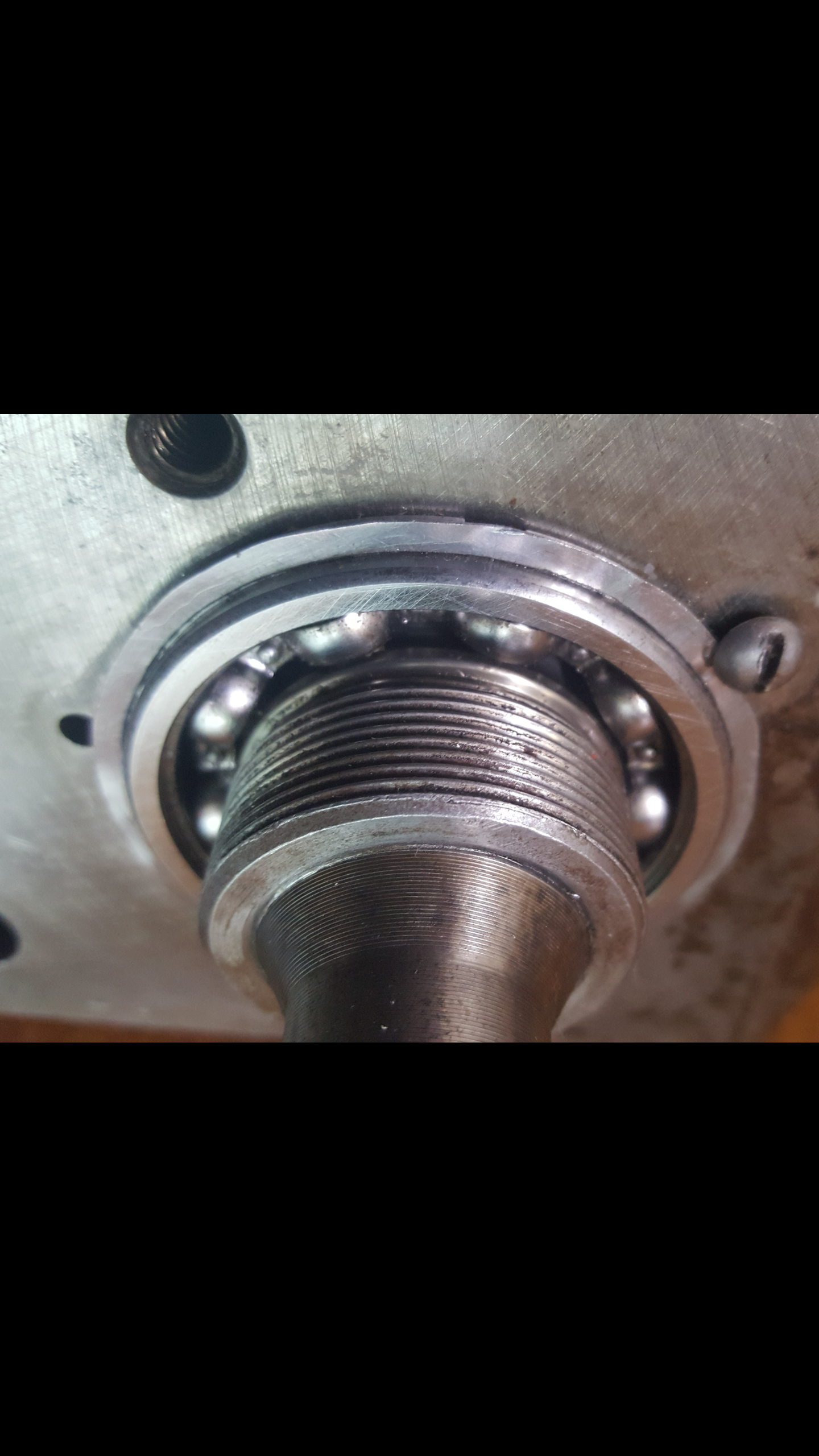

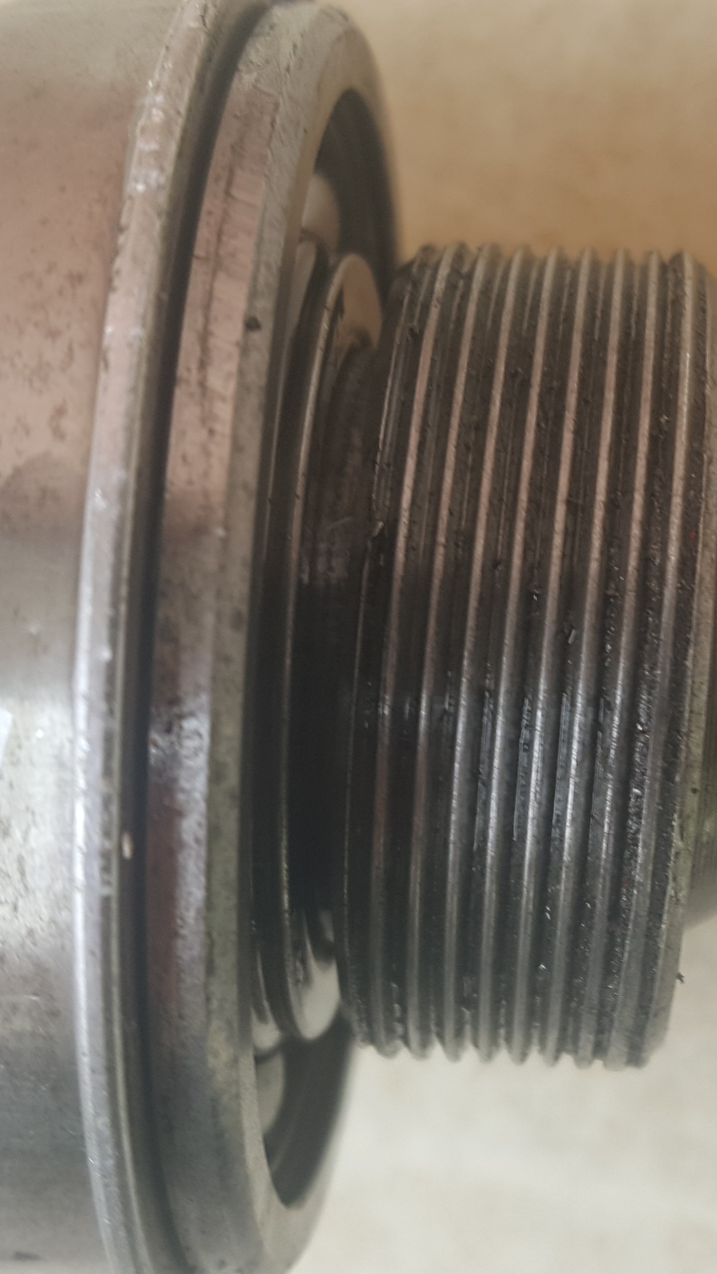

A couple of updates, as been a little while, will do in 2 posts, so last weekend I had already replaced bellhousing, and I put a new clutch kit in, interestingly the one the mechanic put in 4 years ago was the 220mm one and possibly that wasn't an issue I would say, but anyway my new one is the standard 200mm. Made up my home made shim painstakingly at 0.010 for the countershaft bore after a couple of attempts using tin snips, second time did a bit oversize and spent ages with a metal file and was happy with end product, used the little screw to hold it to bearing circlip.
Used the ej input shaft rather than the eh one that was in box, as the gear teeth are longer on eh third speed gear, although was a little concerned the bearing retainer I got a local mechanic to press on looked slightly cocked.
Put everything together, and took for test drive, seemed to be staying in gear then horrendous noise.

So this weekend after taking off gearbox, figured out pretty quickly what went wrong, even on bench gearbox wouldn't change gears, noticed when tried to push into 3rd with cover off bearing came out of gearbox a bit. Then noticed bearing retainer had pushed further back along shaft allowing movement of bearing, should have trusted gut feel was bad job the guy who pressed retainer on, trouble is with EJ you need an industrial press to get this retainer on I would say, not something I can do at home.
So I put back together today witj EH input shaft, surprisingly drove much better and didn't have to hold gearstick to keep in 3rd like before, so changing bellhousing and taking my time with aligning certainly made a huge difference, but still gently falls out of 3rd after a while, you can't feel it pulling on gearstick in 3rd like before so that's good, it had got to the stage of jumping out within 500m without holding gearstick and now it will go quite a while.
So will monitor next couple of weeks, and see how it goes driving to work, and will think about what I will do from here.
Someone has offered me another EJ box, so I might get thst couriered here in a couple of weeks and use bits from that particularly the input shaft.

Vince,
One step forward, two steps back. When you drove the car, the input shaft bearing retainer settled into position. The wrong one, though.
You need to use the EJ input shaft. So find a shop that can press the retainer all the way on. Or - an anvil, a block of soft metal: copper, brass, aluminium, the input shaft, pointing upwards, a length of steel water pipe of the right diameter, and a b.f.h. This is the way the engine shop I use drives Holden crank timing gears onto crankshafts.
When you said "horrendous noise", I was fearing the dreaded chewing-up-of-the-top-gear-synchro-in-second-gear problem. Has the displaced input shaft bearing retaining ring chewed out the counterbore in the throwout bearing slide? Workshop manual's sectional view suggests that there's bugger-all clearance between the bearing retainer and the bottom of the throwout bearing slide's counterbore.
