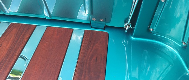

Re: Ammo's Ute
Posted: Mon May 11, 2020 4:59 pm
by Wrongway Roger
Hi,
I have been researching hidden hinges on the net, spend a couple of hours at the wreckers today, looking at door, hatch and tail gate hinges.
With what little information I could pulled together, I headed into the shed to have another attempt at making the hinges.
Bend wire again, formed some 2.5 mm sheet metal, welded to but hinges and attached to the ute and tail gate.
Pulled it off heated and reshaped the curve several times and still can’t get them to work.
Closest I got was the tailgate at about 30 degree angle from parallel before the bottom edge touches the roll pan.
I need to extent the curve outwards but not increase the length as this would place the top of the tailgate too high.
To say I’m pissed off is to understate how I feel. I know it has been done a couple of times before so I should be able to step up and make some.
The only advice I have received is “used 2” pipe and based on the front door hinges”.
Unless I have an epiphany ( look it up), the hidden hinges are toast on the ute.
As I have changed the mounting points for the original hinges, my only option may the weld up the tail gate.

Re: Ammo's Ute
Posted: Mon May 11, 2020 6:33 pm
by ardiesse
Roger,
(this is a train-of-consciousness post, so may be lacking in coherence . . .)
There's a reason the GM-H engineers put the tailgate hinges where they did: the tailgate's lower lip will actually pivot slightly upward as the tailgate is opened, because the hinge pin is rearward of the tailgate skin.
You've moved the hinge pin inwards a fair bit with your current arrangement, so it's no surprise (sorry!) that the lower lip of the tailgate fouls on the roll pan as the tailgate opens: imagine the circle described by the tailgate lower lip, whose centre is the hinge pin. Where the tailgate normally sits shut, the tangent to the circle will be sloping down at the rear . . . pick a number . . . anywhere between 30 and 45 degrees.
Wild conjecture here - maybe, just maybe, you could make hidden hinges work if the hinge pin were inside the roll pan, as close as possible to the rear, and quite a way down. This way, the radius of the circle defined by the lower lip of the tailgate will be large, and the tangent to the circle will slop downwards only slightly. The hinge tongues will then have to look like exaggerated versions of the front door hinge tongues in order to get the full 90+ degrees of opening (front doors would only open maybe 50 deg.).
You could do way worse than spend a morning at a wreckers' yard looking at how hatchback tailgates and Commodore bootlids are hinged. And that's not even going to a trapezium arrangement.

Re: Ammo's Ute
Posted: Mon May 11, 2020 8:42 pm
by ekv8ute
Roger have you thought about something like these https://encrypted-tbn0.gstatic.com/imag ... Y5F3fTIA&s . Or using the same idea which should distance the tailgate further from the body the more you open it (I think!)
Re: Ammo's Ute
Posted: Mon May 11, 2020 9:51 pm
by Wrongway Roger
Hi,
Thanks for the reply. I looked numerous website and found a number with fairly large hinges systems.
This is from a ute that appears in Street Machine mag and that I saw at the Nationals in Perth a couple of year back.
Due the raining day I did not see the tail gate down and did not see the owner.
Based to comparing known measurements and that a small section of the rear panel has been removed, I thought I would be able to reproduce a set.
The hinges look fairly short as the distance across the rear is around 50 mm. This sets the amount of raise the hinge must go through to clear the rear panel.
I know they guys who have done the hidden hinges, another in FC ute I think in NSW, may not want to share and thus keep their mods unique but it is only engineering on what out there.
