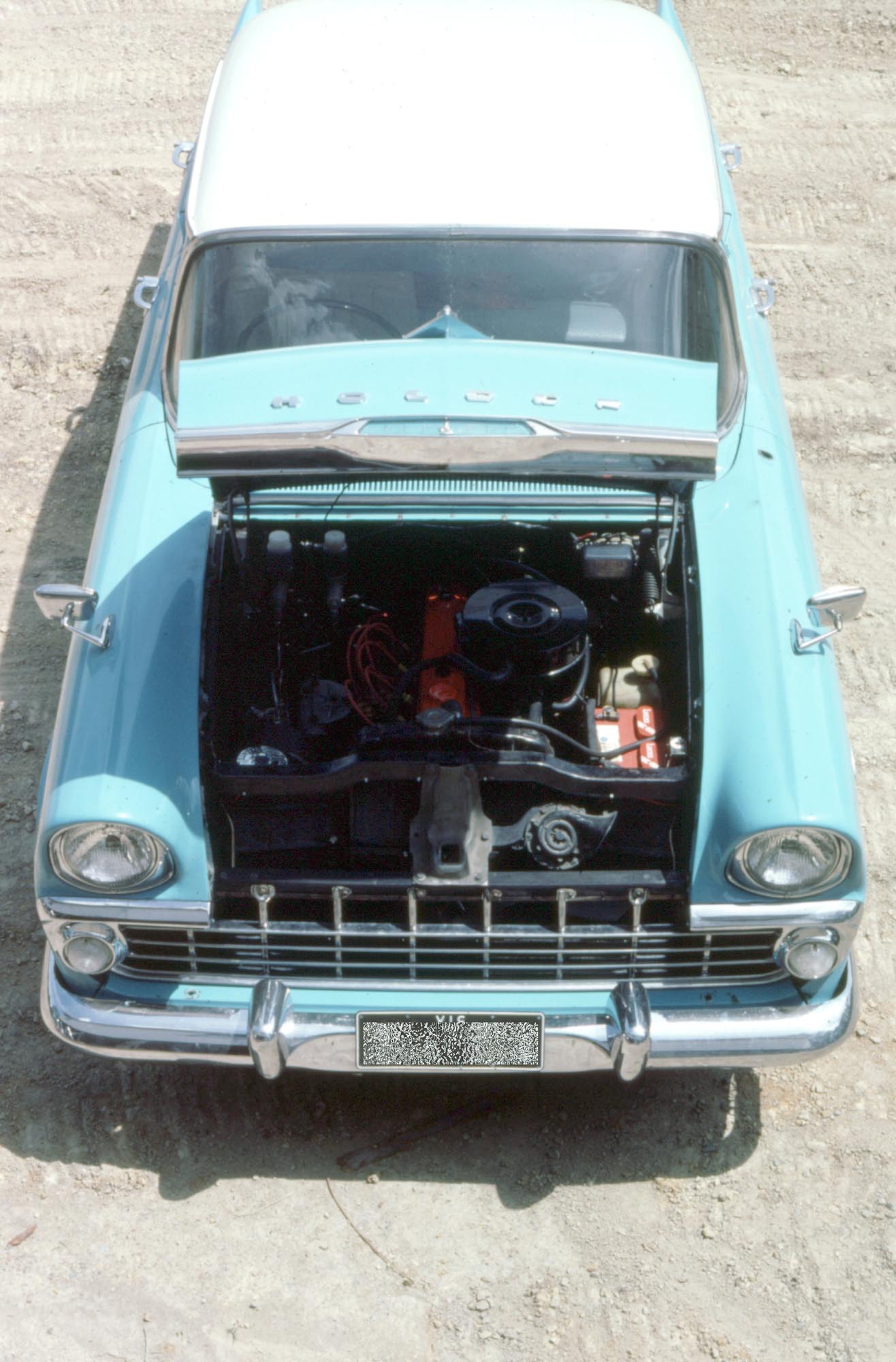

Just to add a couple of final pix to the build.... we arrive at 13 Nov, '82... the day the car was fully re-assembled and ready for the road.
Here is the last pic taken of the assembly in the garage where this dastardly deed was done....
83feb09 mail.jpg (202.36 KiB) Viewed 1032 times
And finally, here is a pic taken from the same kitchen window of our little cottage - in comparison to the one taken with the grey motor in it earlier in this thread..
83feb10 mail.jpg (242.93 KiB) Viewed 1032 times
There is about 10 years of frustration issues to come yet.... I did not have any access to anyone who had a vehicle where I could compare.
The entire build was completed by advice and workshop manuals.. plus the supply of parts by serial number from varying GM dealer spare parts counters.. and a number of wrecking yards, where there were still many early Holdens in supply... we can't go back, if any of us could now - we'd fill our garages with so many spare parts you'd struggle to access them... hindsight, eh? - marvelous...
