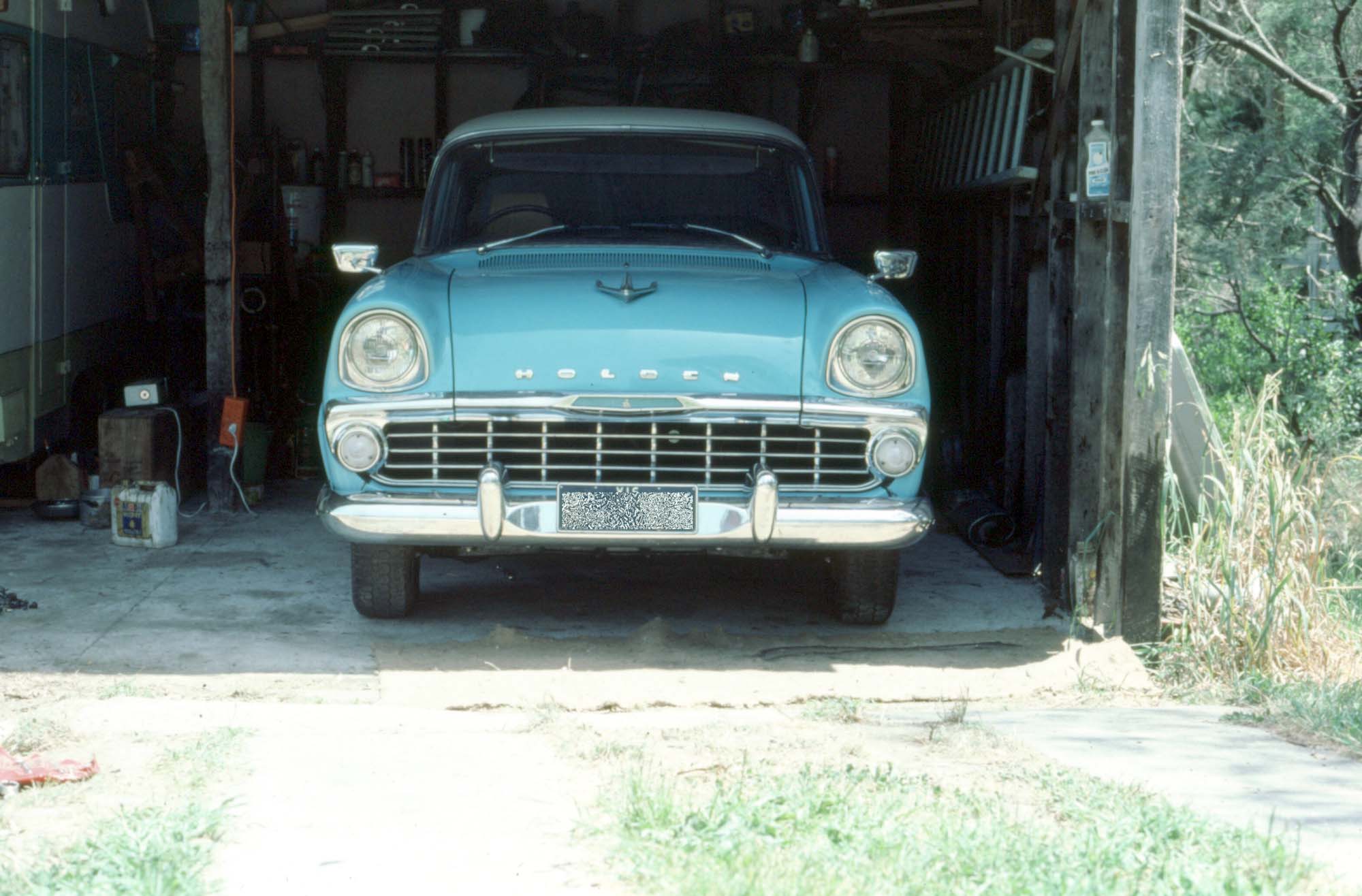

Just to add a couple of final pix to the build.... we arrive at 13 Nov, '82... the day the car was fully re-assembled and ready for the road.
Here is the last pic taken of the assembly in the garage where this dastardly deed was done....

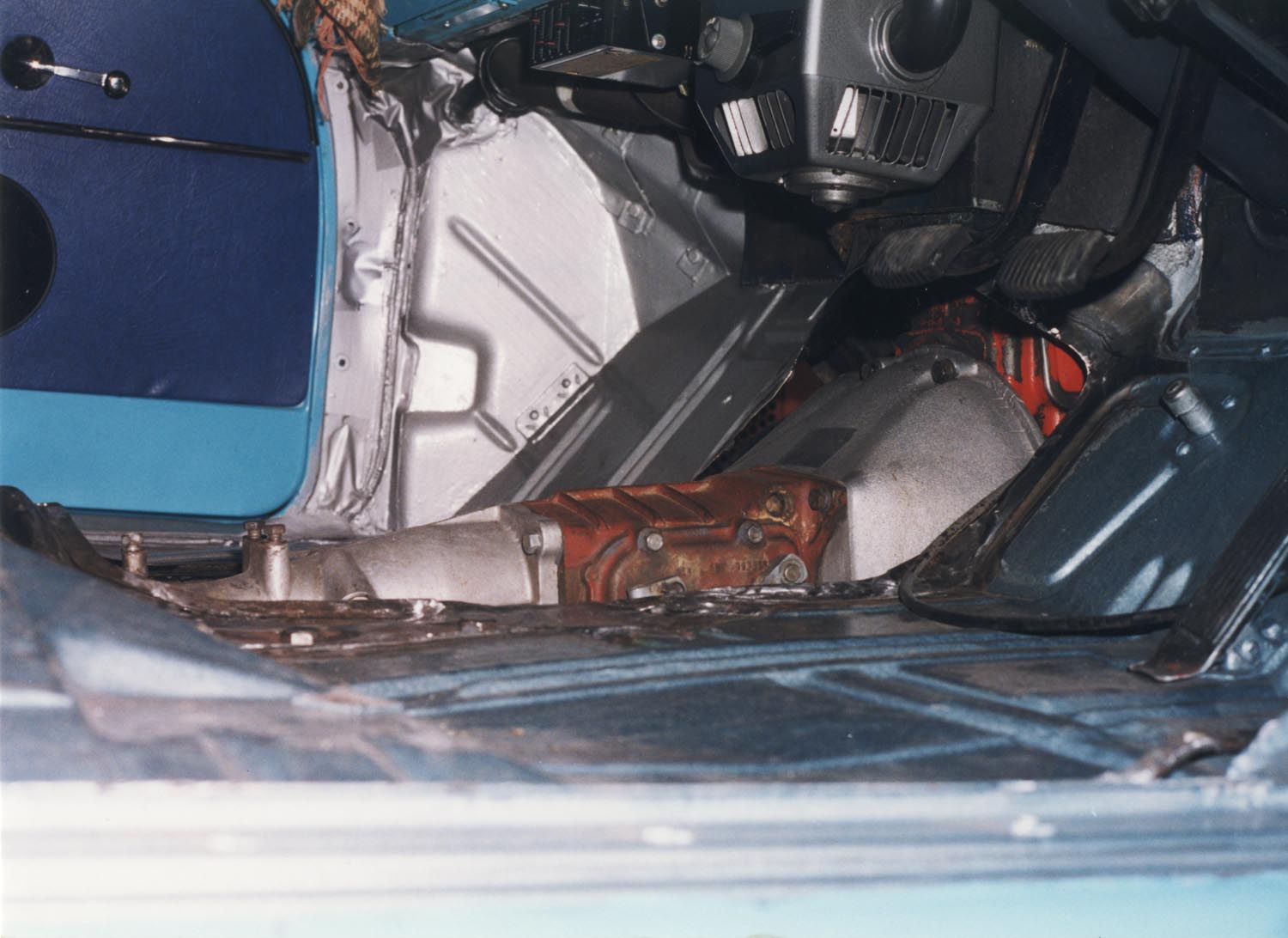

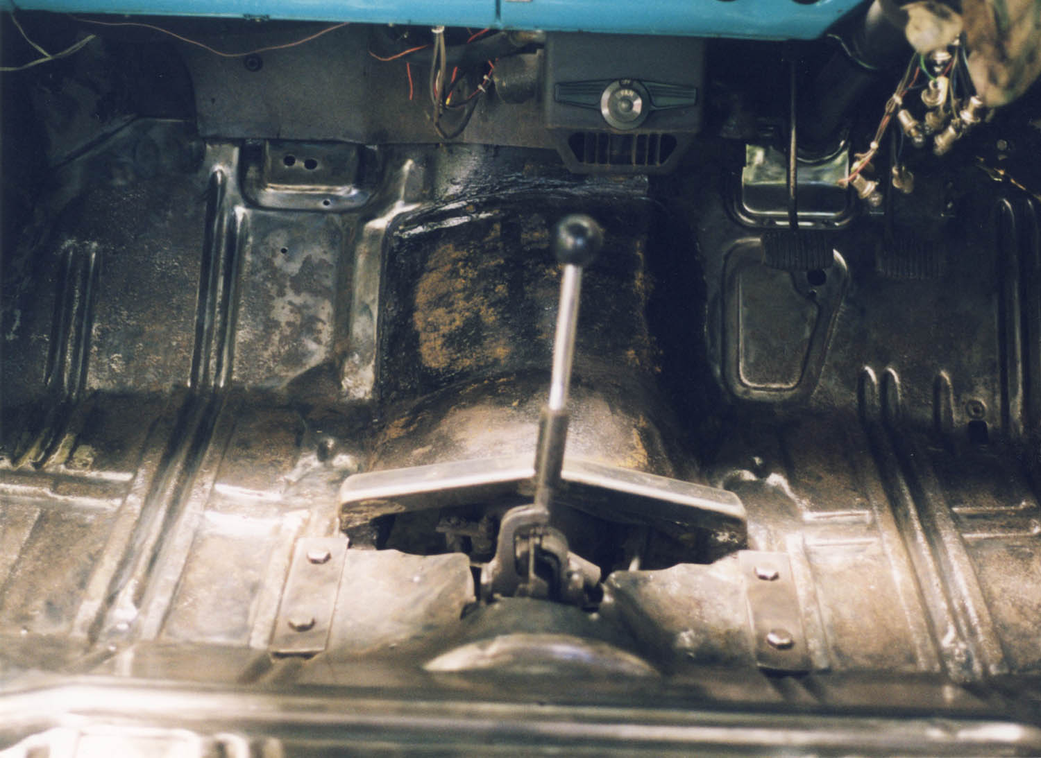

I didn't take any pix of the "hump" at the time, but did so when I pulled it all apart to weld in a replacement "arch" and transmission cover many, many years later.
In the pix below, you can see what eventuated - it was "rough" - but rock solid. It served the vehicle well for some 15 years, including a lot of heavy lifting towing the boat, and at one stage - a 2 tonne digger on a trailer. None of the gaps in the doors widened and when I did finally get to remove this ugly eyesore - it took a bit of cutting out.
I made the angled "brace" up from 3 mm steel.... cut it to shape and welded it together - then welded it into the vertical braces which I had previously welded to the open floor frame.
The transmission mount was even heavier - from Rare's.... obviously, they engineered this heavy unit to add strength to the floor when the centre section was removed. The four large high-tensile bolts brought the lower unit and upper plates together to "sandwich" everything tightly together... it worked... but was damned ugly and my brace was a bug-bear for all the time it was in the vehicle - carpet simply couldn't cover that huge framework... a console from a Volvo did most of that, but I tired of the blasted thing getting nudged by the gearlever when pushing it into the top left corner for reverse... I ended up cutting away the rear section of that console - and then removed almost all of it - only leaving the small front section to house the tacho...
The actual trans cover was made from a 5 gallon "Castrol" oil drum... and some thin metal sheet... all self tapped together and coated with numerous lashings of body deadener... again, this all worked - but it looked a lot better under what remained of the carpet than uncovered...
Pix of floor brace and trans cover....

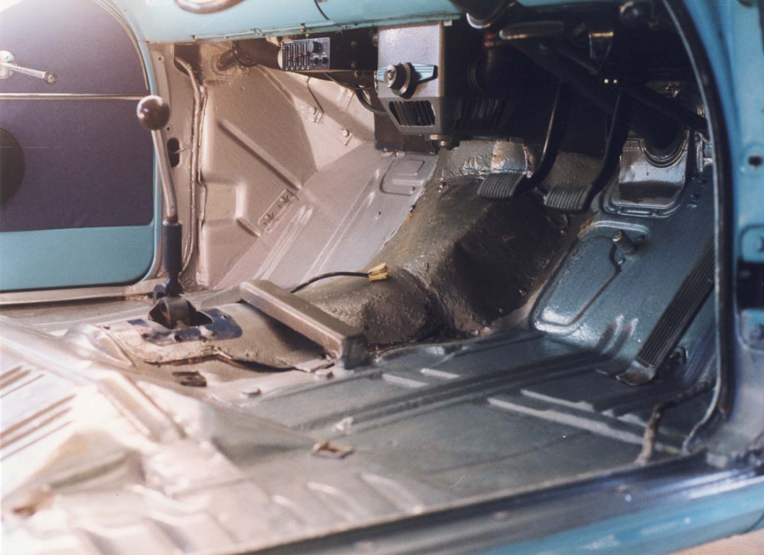

And finally, this is a pic of what it looked like 15 years later when cut all of it away prior to fabricating and welding in "the arch".... which we will get to in about 15 years' time as the thread catches up....
For those who ponder on how much of an Aussie box sticks out up through the floor without any covering - this pic tells it all....
