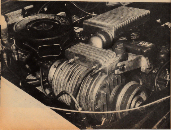

Thanks Dave. I was lucky with the WW Strommie. I bought it a long time ago, and it was destined to run on a red motor Norman, identical to the photo below:
The WW I bought came with the gold air filter, though it had not been desnouted like the one above :lol: . I've got most of the stuff in that photo, all bar the cast ally intercooler.
Looks like the WW will get a run on the Prem instead.

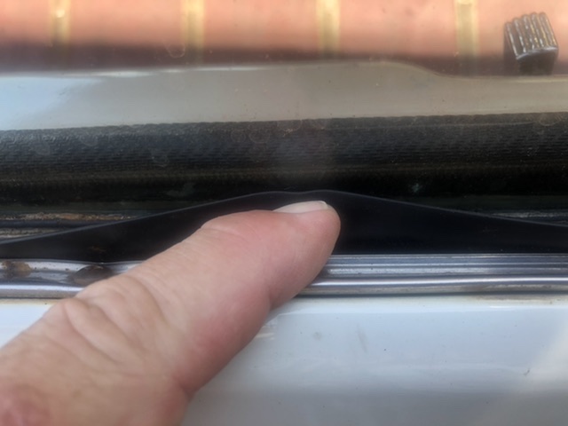

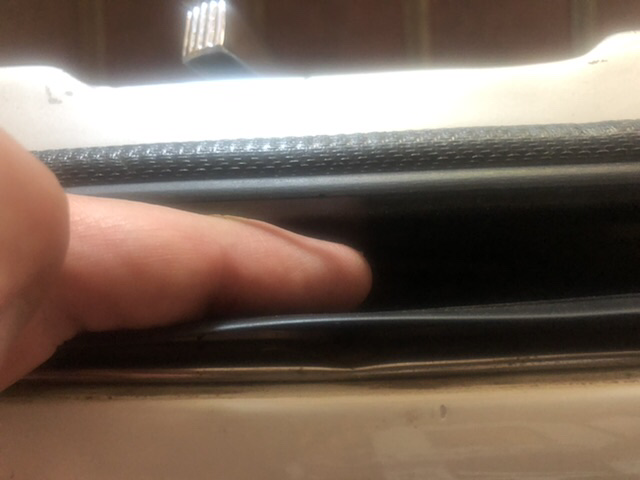

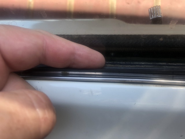

Dumb question for today. The tailgate has a stainless strip at the bottom of the glass, held on with 8 or so self tappers. It has a rubber strip that slides into the stainless and is held be the screws. Mine was all but gone, with only remnants. Replaced it with a Rares rubber, but it seems to do nothing - sits about 10mm off the glass. Glass runs smoothly in the door and upper channel. Where have I gone wrong?

Harv,
The HD service manual has no instructions about replacing the weatherstrip.
It's not something as easy as you've installed the rubber the wrong way, with the wide part held by the retainer? Because I remember that the tailgate belt weatherstrip was quite wide. It didn't touch the glass, but when the tailgate window was wound all the way up, the weatherstrip would seal against the top of the glass lift channel.
