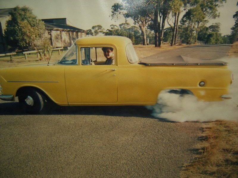

I ran a 186 with a 4 speed in my you beaut ! I cut the bench seat out in the middle for the shifter.
The tunnel needs enlarging as well and I used dellow hydraulic slave bracket at the time.
186 with skinnies used to do great burnouts !!!!

Thanks everyone. I like the idea of modifying the linkage and leaving the bench seat if that's a possibility. So, in essence I will have to enlarge tunnel and do big burnouts with skinny tyres. I think I've got it!πŸ˜€. Thanks everyone.
