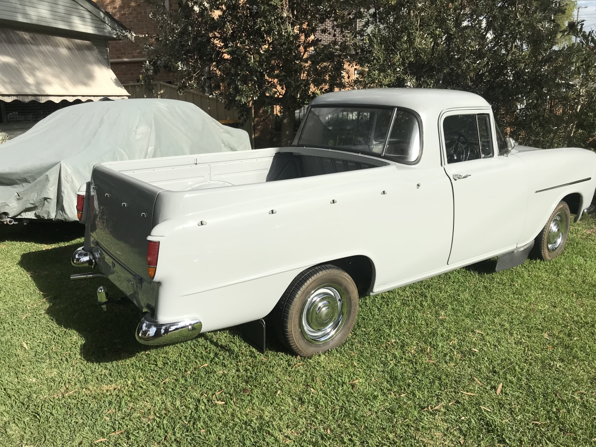

Love the OLD HOON lettering :mrgreen:
Yep, it's two-pack paint.
I wasn't too sure about those tonneau bungee-cord clips. Part of me wanted to remove them, and fit Nasco-type lift-a-dots. The reason I kept the bungee-cord clips is that it lets you pile stuff up quite high in the tub, put the tonneau (or a tarp) over it, then tie back to the bungee-cord clips... not that I've ever done that :oops: .

Harder to do that with the lift-the-dots.

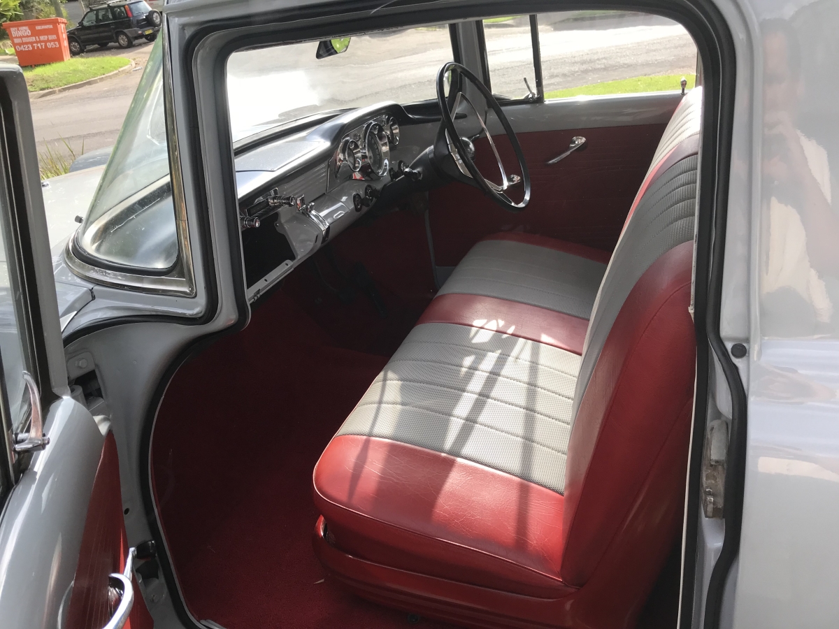

Fitted the bench seat, should have bought longer bolts (the original ¾” length struggled to deal with the extra thickness of the carpet and underlay, so had to use some spare parts department bolts). The only drama is that the vinyl flap that covers the parcel shelf is shagged (sun bleached and ripped). Was going to put a piece of carpet on the parcel shelf, but seeing the seat in-situ I am no longer convinced. Might have to make up a new flap and hand sew it on.
