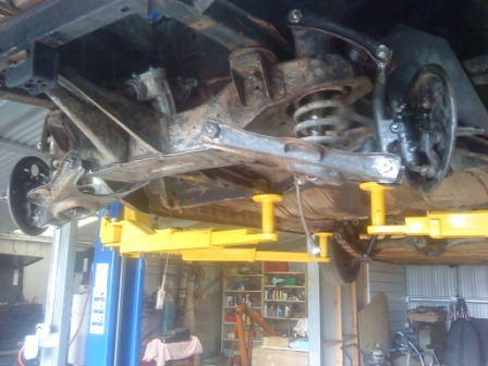

Front end all re-bushed and finished. Still running the original shocks with the spiral casing, cant fault them apart from some staining on the shafts.There's no leakage and they dampen well on the rebound stroke.

More progress today. Finished assembling the steering box and fitted it up after replacing the steering shaft and end bearings.
Front end fitted as well after replacing all knackered bushes and pivot bolts.
Gearbox assembly is stalled as I'm still trying to source a new rear bearing (double row). As I'll be towing I'd rather fit a double row and not the early single row from previous models.
Hoping to make a start on banging the engine together tomorrow. Getting closer now... :D

Ok, todays work: Finished off front end in place and overhauled drag link. Clutch and box fitted up. Sump guards on. Front wheel bearings done and now on its wheels.
