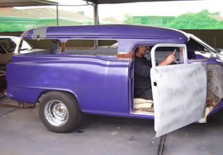

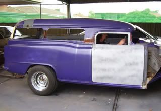

ratbox wrote:you should sit in it and get someone to take a side photo :lol:
Here you go Ratbox.
The dash & steering wheel feel very high, compared to my other FB,
with this low seating position.
Stock seat would make it feel right, but I wouldn't see out of it.
I was planning to have the whole car riding real low,
but it would make it harder to get in & out.
So what do I do?
Stuff it, I'm going for low buckets & low suspension, I'll live with that.
