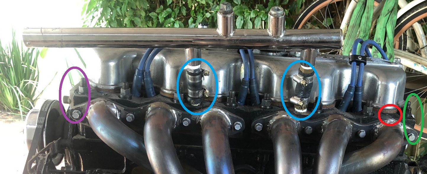

Thinking a little more about the cooling for both the meth monster project and the FED. Real estate is going to be sparse at the front of these engines, so need to use my noggin and plan.
The meth monster will see mostly drag use, but will be street registered (just…). It needs some form of cooling system. It will run on methanol (runs cold), but also petrol (runs hot). Some form of radiator, a fan (somehow… don’t like electric if I can avoid it) and the standard water pump. I’ll run one of the improved-cooling head gaskets. The original Repco guidance notes:
When the engine is installed horizontally in special chassis a small additional water outlet pipe from a hole drilled in the head adjacent to the rear most head-bolt on the exhaust side is essential to prevent the formation of steam or air pockets. The normal water pump is quite satisfactory and should be run at normal speed with no restriction plate as is sometimes thought to be necessary.
It’s likely that I’ll use the original Repco head for this one. It has been drilled for two additional water outlets drilled midships, as per the blue circles in the diagram below:
Repco cooling.jpg (343.97 KiB) Viewed 40044 times
The water outlets at the front and rear of the head (purple and green circles) have been blanked off with ally plates. This setup (two additional holes midships) is not quite what Repco indicates above (one additional hole aft, as per the red circle) but should be OK for this setup. When it’s up and running I’ll run an IR temperature gun over the head, and see if the cooling is relatively even. Can add an additional cooling hole to the rear (red circle) relatively easily.
The FED will have no radiator. Plan is to use the traditional process and fill the block with water (no glycol). The front water outlet (purple circle) gets a radiator neck and cap, with the overflow going to a catch-can. Prior to a run, the motor is warmed up (to 160-180C), then the water around the block used to absorb any heat during the run. After a run the block is allowed to cool, with some people draining the block and flushing with cold water to bring temperatures down (gently, to avoid cracking). This should be fine, as the engine only runs for 12 seconds at a time (scary… the crank only turns 1000 revs per run), give or take a little staging time.
What has got me a little cautious though is that the FED will get the reproduction head, which is ally. I suspect it is going to be more susceptible to temperature changes than the cast iron heads. A little worried about ending up with more cracks than a plumbers convention. Whilst I’m not running a radiator, I’m wondering whether I should retain the water pump and at least circulate the block/head. This will help to keep temperatures even, though comes at the cost of having to run the pump. Perhaps run the thing with the pump belt off as a test, and see if there is much difference.

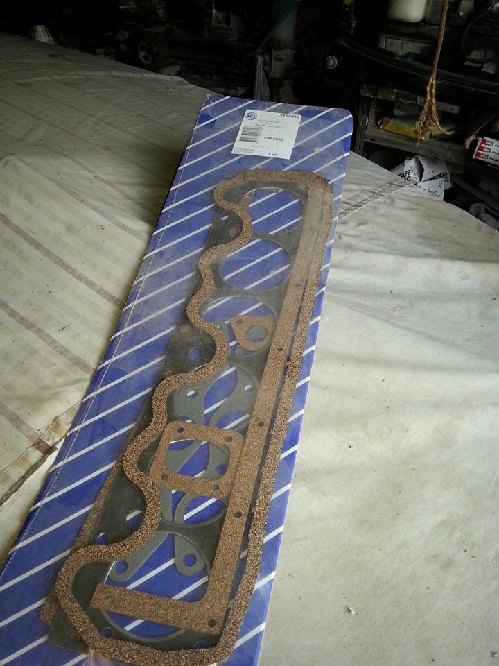

Before I get too serious pulling bits off the Repco head, I figured I should get a set of gaskets. After much ringing around, I have realised that HighPower gaskets are like rocking-horse poo.
Once upon a time, ACL did the gaskets as a valve regrind set (VRS), part number PBB2042:
ACL Gaskets PBB2042 VRS set to suit Repco head 2.jpg (124.16 KiB) Viewed 39958 times
ACL Gaskets PBB2042 VRS set to suit Repco head 1.jpg (119.56 KiB) Viewed 39958 times
ACL are long out of business, and the tooling was scrapped.

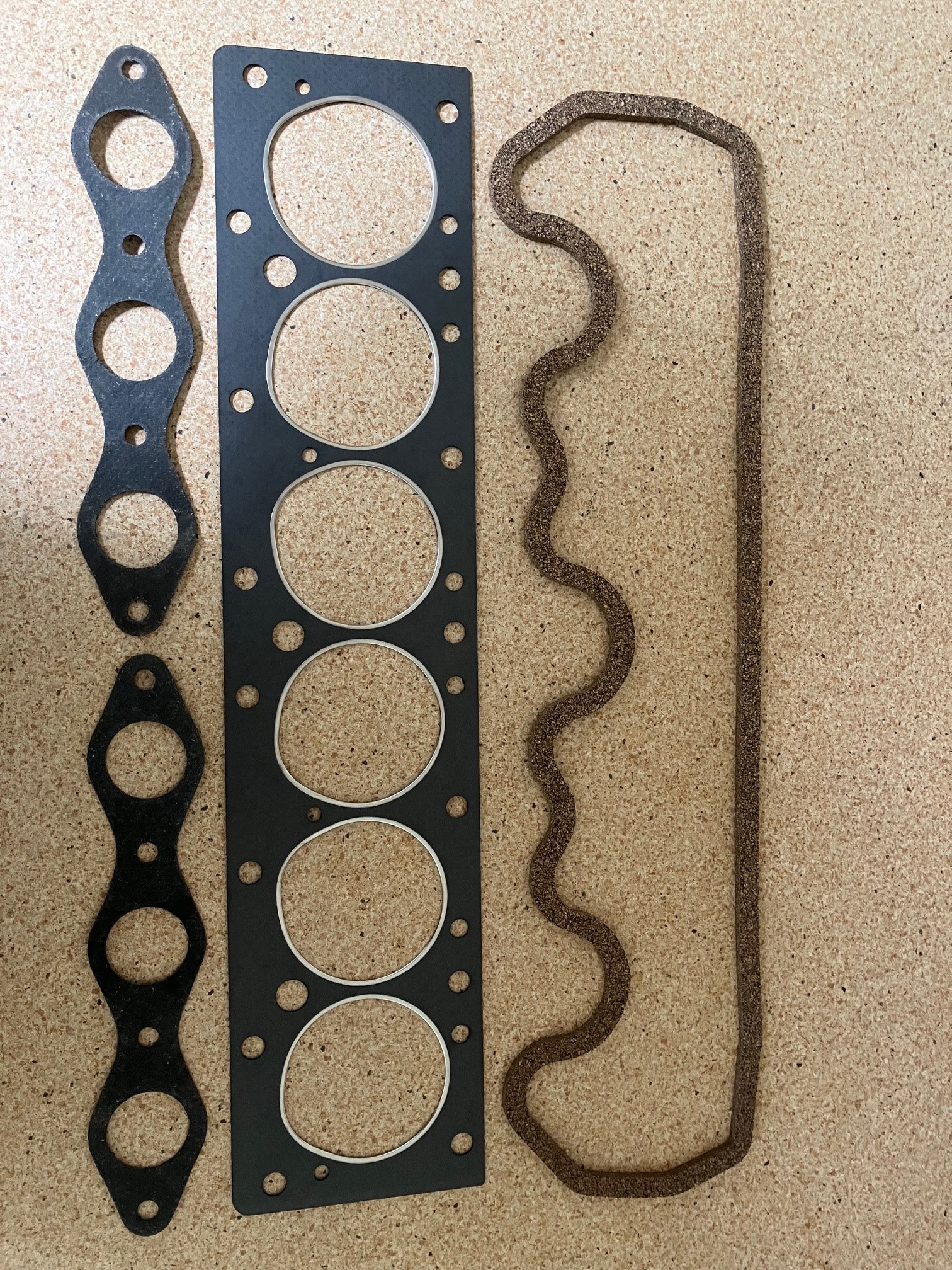

The gaskets are however being reproduced by Terry King:
Dominator Engine Reconditioning and Sales Pty Ltd
1/6 Scallop Street
Huskisson, NSW 2540
0405479906
Repco crossflow head gaskets.jpg (1.23 MiB) Viewed 39958 times
Terry does not make the cork sideplate gasket, but a standard GMH one (with the top cut off and a bead of silicon along the top) will do the trick (Permaseal KV171, Rare Spares H1081).

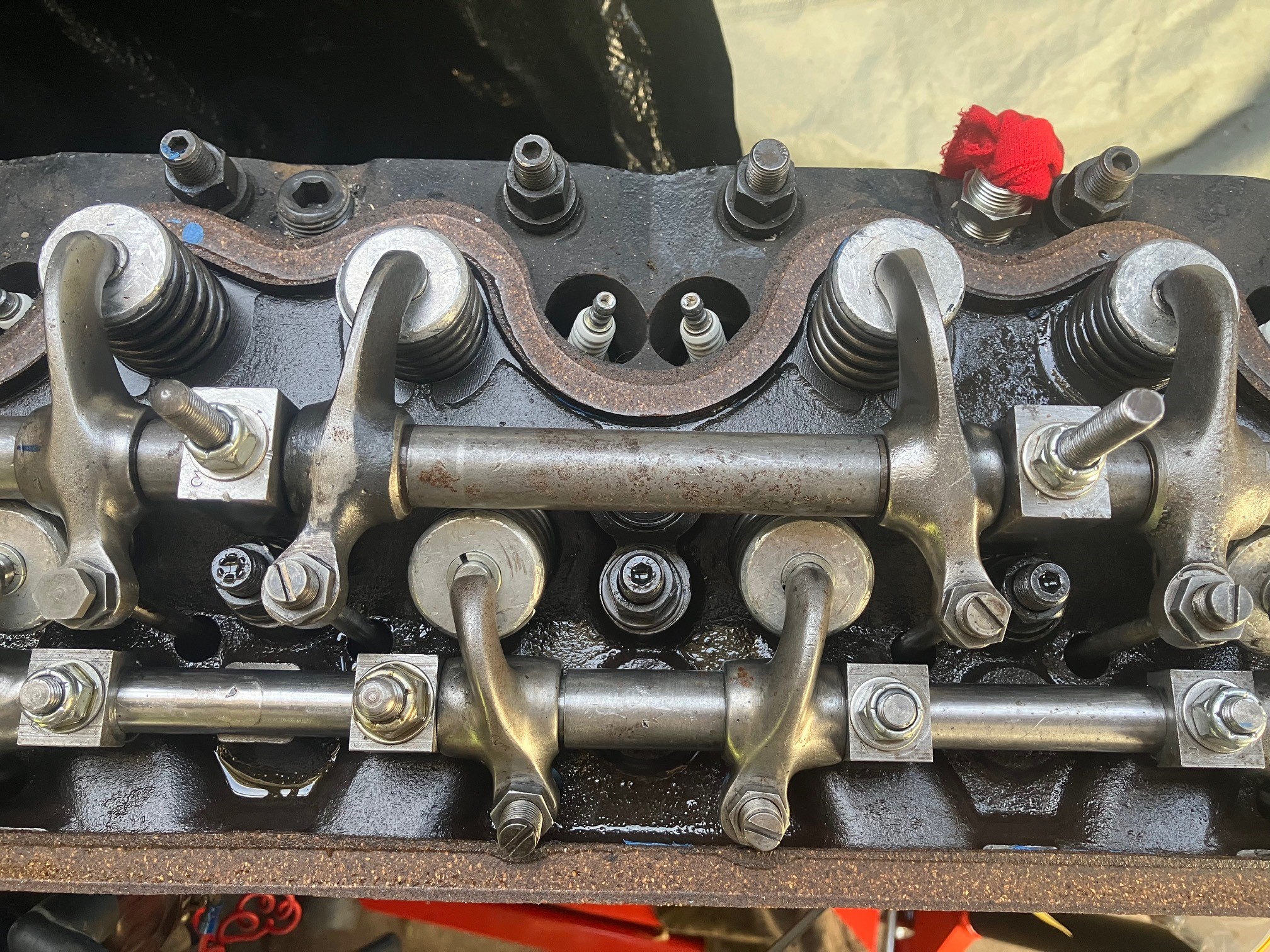

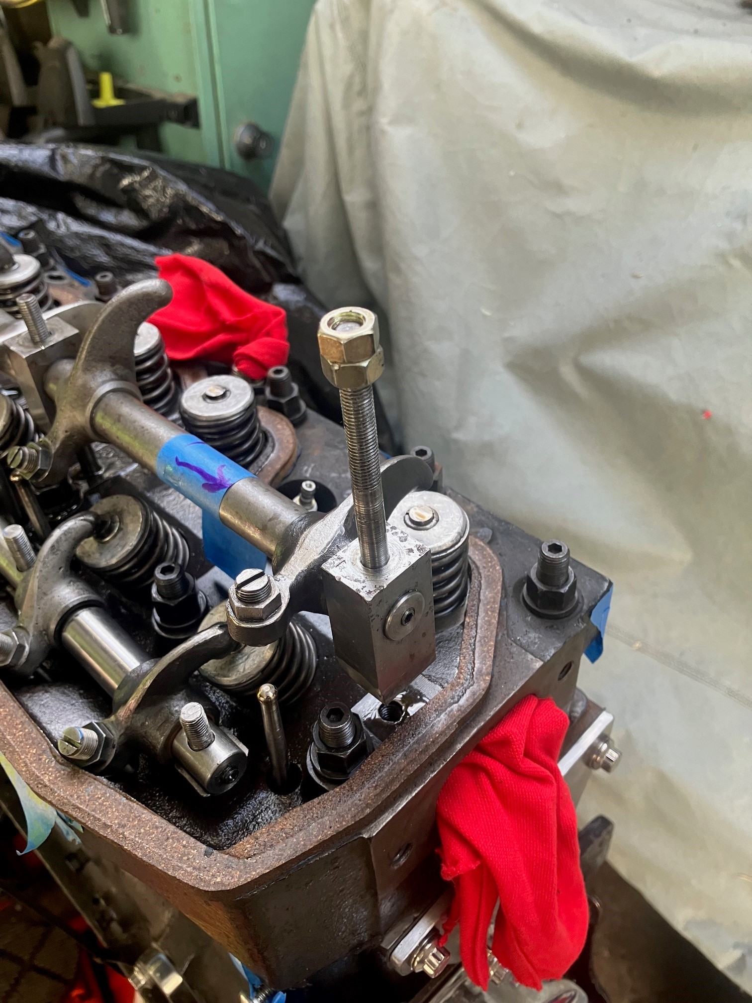

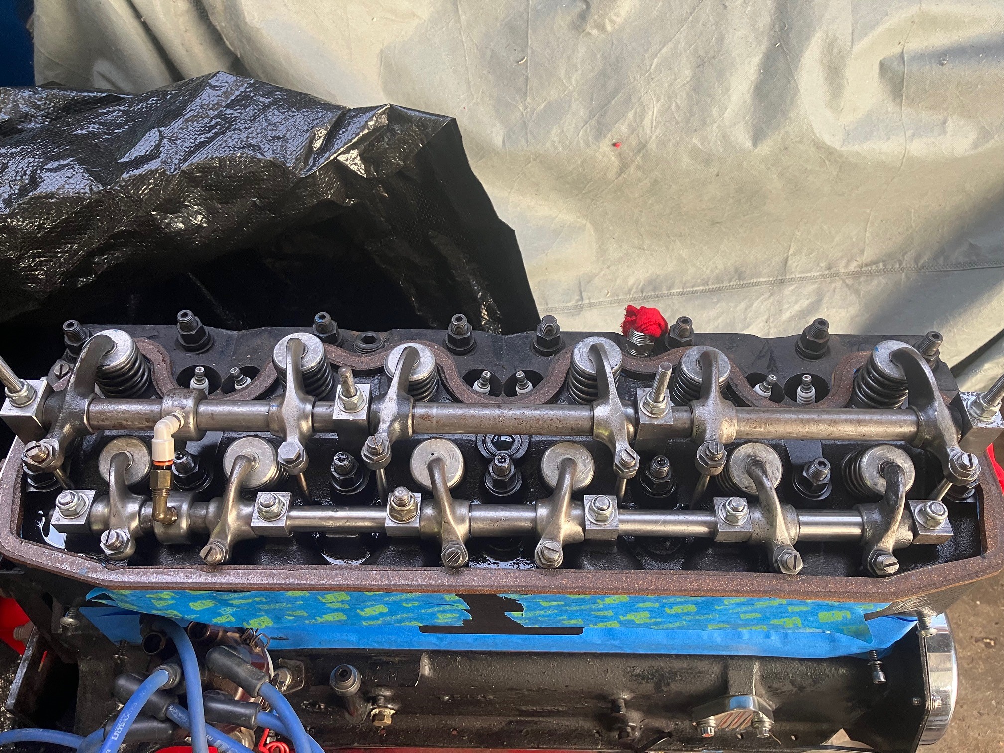

So knowing that the Repco head has to go onto another motor, I figured it was time to bite the bullet and unbolt it from the speedcar block. There is a real sense of unease pulling apart a working motor, and worse when the bits are not exactly common. Was worried a few weeks back about the head gasket. I reckon the head will have to come on and off a few times, so the head gasket will end up shagged. I’ve since managed to source some replacements (see last post), so all good on that front.
Rocker cover off, and evident that some of the rocker post studs have been replaced. No big deal.
Rocker cover off.jpg (1 MiB) Viewed 39854 times

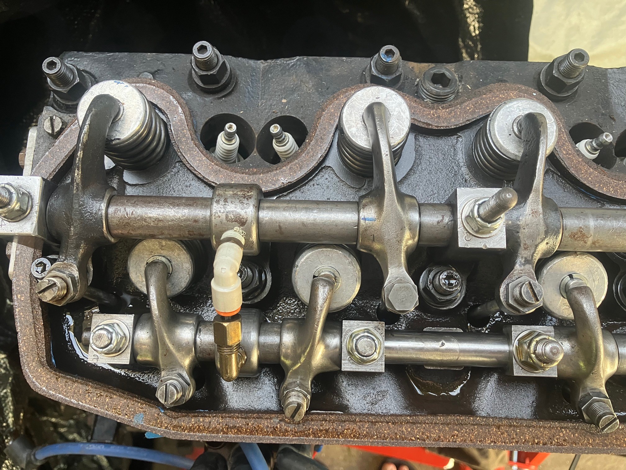

The rocker mounting blocks are nyloc nutted, though for some reason one had a split washer too. Mixed fasteners are becoming a signature on this thing. One rocker post (inlet side centre) is way bigger (3/8-16UNC) than the others (5/16-24UNC). Must remember to ask the Repco gurus if this is normal, or if someone has stripped and oversized the head. Appeared be a lot of sideways travel of the rockers along the shafts… perhaps the shaft spacers have been mismatched. The oil crossover was funky… some brass pipe (normal) and plastic compression fittings (not so normal).
plastic oil fitting.jpg (1.01 MiB) Viewed 39854 times

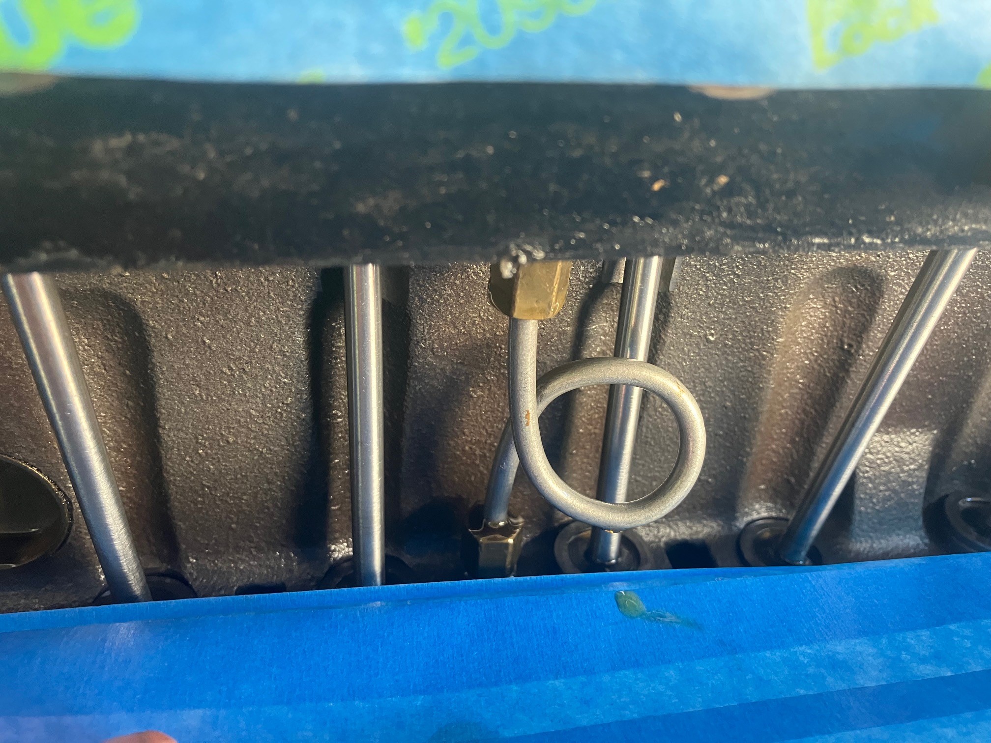

There should be an ally block and bracket behind the sideplate to mount the oil feed line. Mine has been replaced with a pigtail. No drama, just different:
Curly oil pipe.jpg (671.75 KiB) Viewed 39854 times

The inlet rocker shaft came out OK, but the exhaust hung up. The rocker post closest to No. 1 exhaust was tight… because the rocker post stud, which had been replaced, was poorly sized. Fight the stud out, Remove the rockers, then finally get to the head studs.
The stuck rocker mount stud.jpg (664.53 KiB) Viewed 39853 times

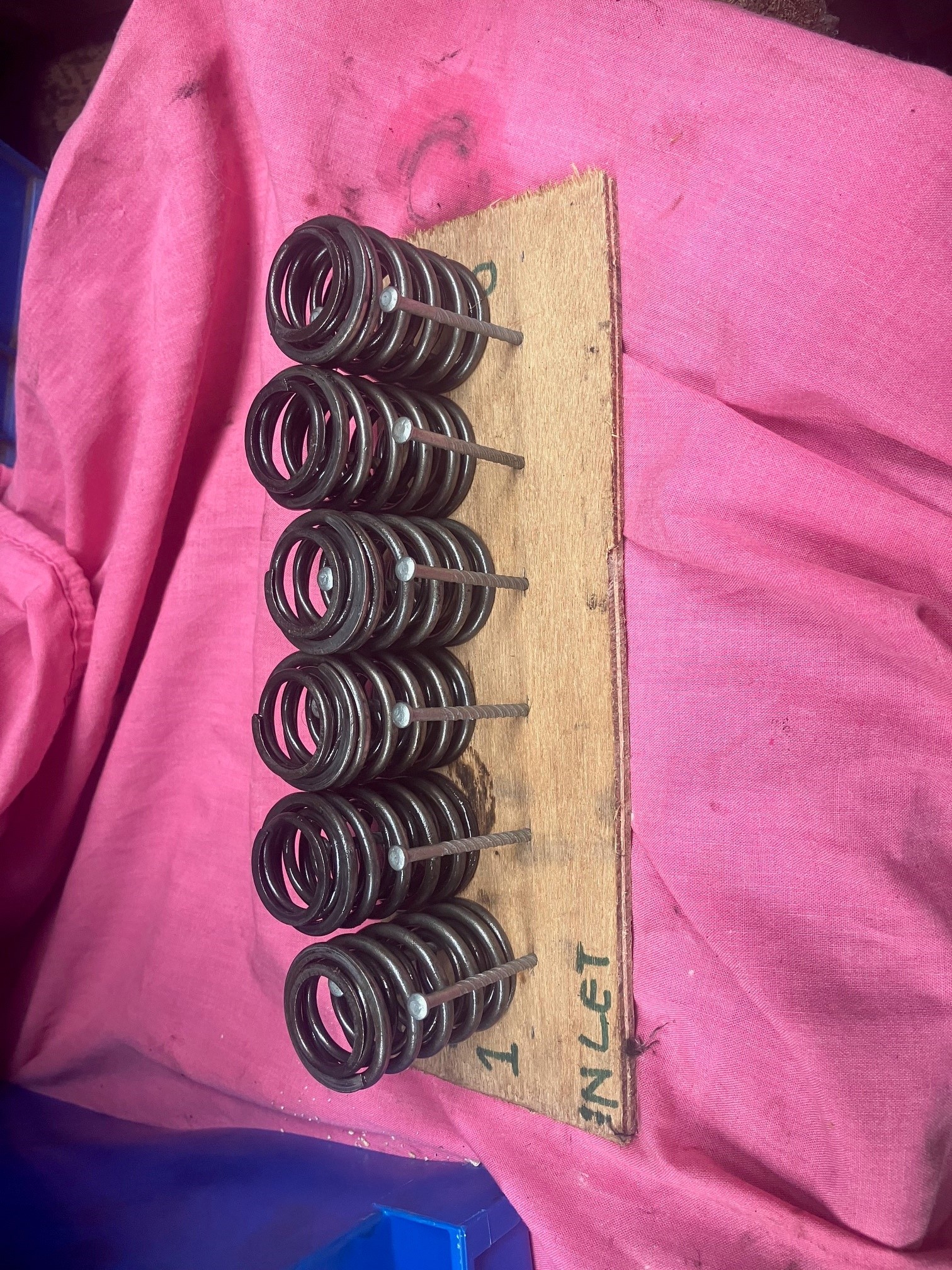

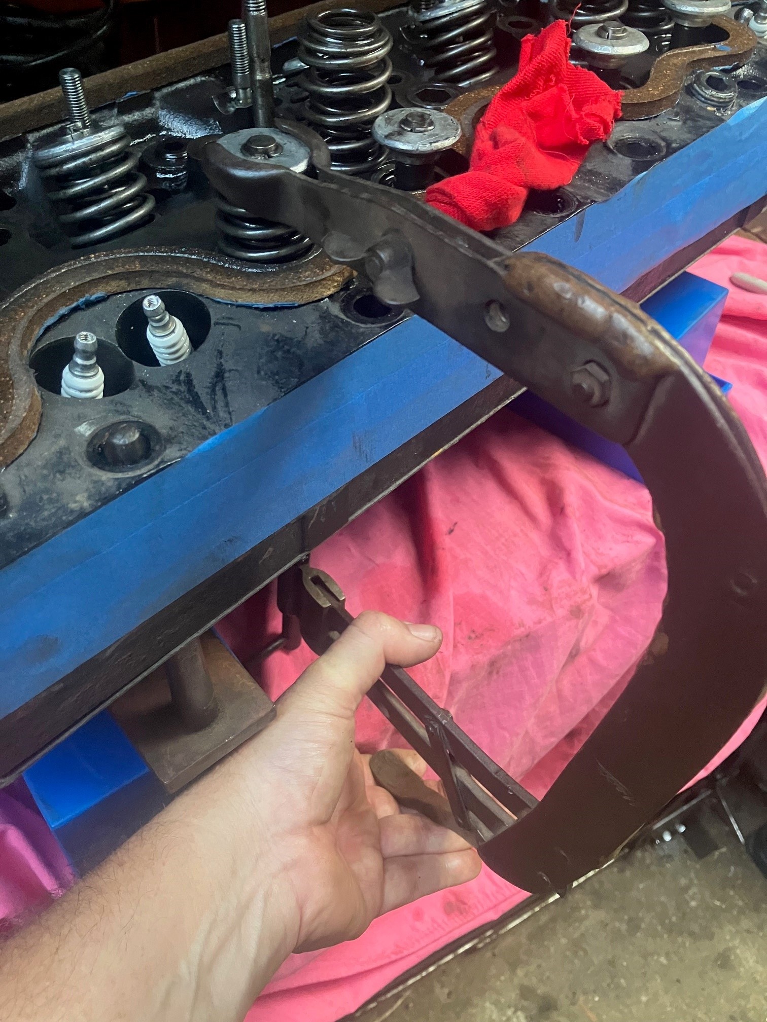

I checked the valve spring pressures over the weekend. My tester is an old one (uses a torque wrench), but is close enough for this rough check. Because my installed heights had so much variance, I used 1.28” as the installed spring height for the inlets, and 1.36” for the exhaust (note that spring heights are smaller than valve stem heights tabled above). Results below in lb:
Valve spring installed pressures.JPG (17.16 KiB) Viewed 39852 times
A fair bit of variance, but more of a worry is that the values are low. I’ll need somewhere around 120 lb of seat pressure.
Methinks new retainers are in order. Measured valve springs, and will order some new steel retainers from Performance Spring (part number RET G1260).
Plan is to get the retainers (and perhaps new collets) in place, recheck valve installed height then recheck valves. New retainers will likely be a different height, so will have a different seat pressure.
Random photos I forgot to post earlier:
Valve springs (or at least half of them)
Valve springs.jpg (1.04 MiB) Viewed 39852 times

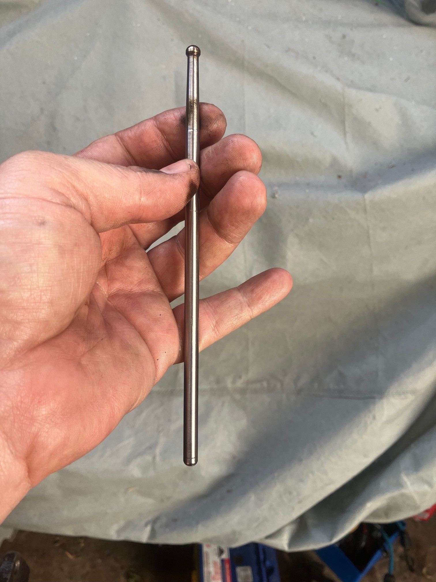

Pushrod:
