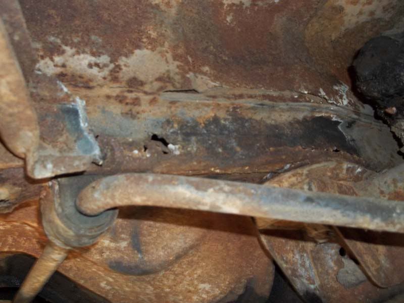

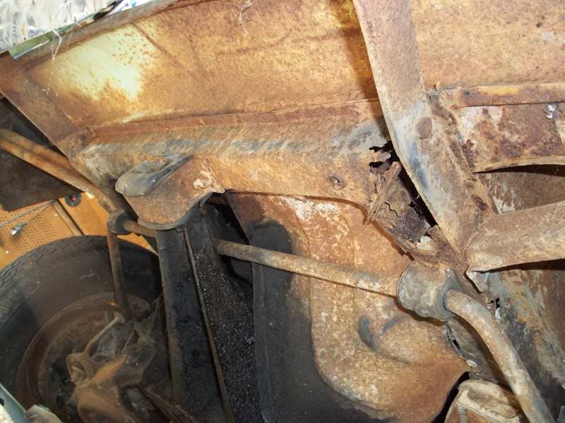

On a different note, I've lost a socket. Drivers side, I was using it to undo the bottom bolt for the drivers side guard, when I pulled the tool out, the socket has fallen down inside the rail, and I cant see it in there. - any ideas on how to get that out? its probably rolled into the bottom of the door frame. - I'm thinking high powered magnet attached to a flexible piece of plastic rod. - any other ideas?
Found rust in the front, here on the map highlighted in red is where the rust is, and there are picts below that show it.
click for larger pic
Also, highlighted here are the WELDS that are holding the passenger front quarterpanel on. - Grrrrrrr.
PhotoSpam!
As always click for larger picts.
Image Image Image Image Image Image Image Image Image Image Image Image Image Image Image Image Image Image Image

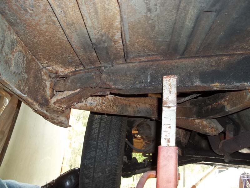

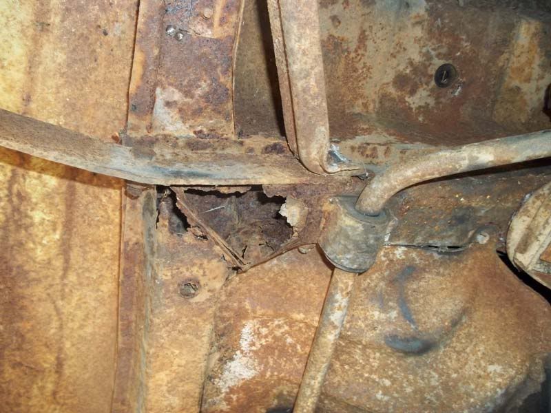

That last pic you have there, that same bar that's rusty on yours is rusted out, Both sides on Allison's. INCLUDING the bar where its the Trans Hump in the middle. (The 4 bolt points have rusted out)
Image Image Image

For the rust in the subframes get some steel (same guage) folded up to match. This was how we patched my subframe, luckily a mate had leftover from doing his. Then start cutting..... its a slow tedious part of the resto. But needs to be done right.
