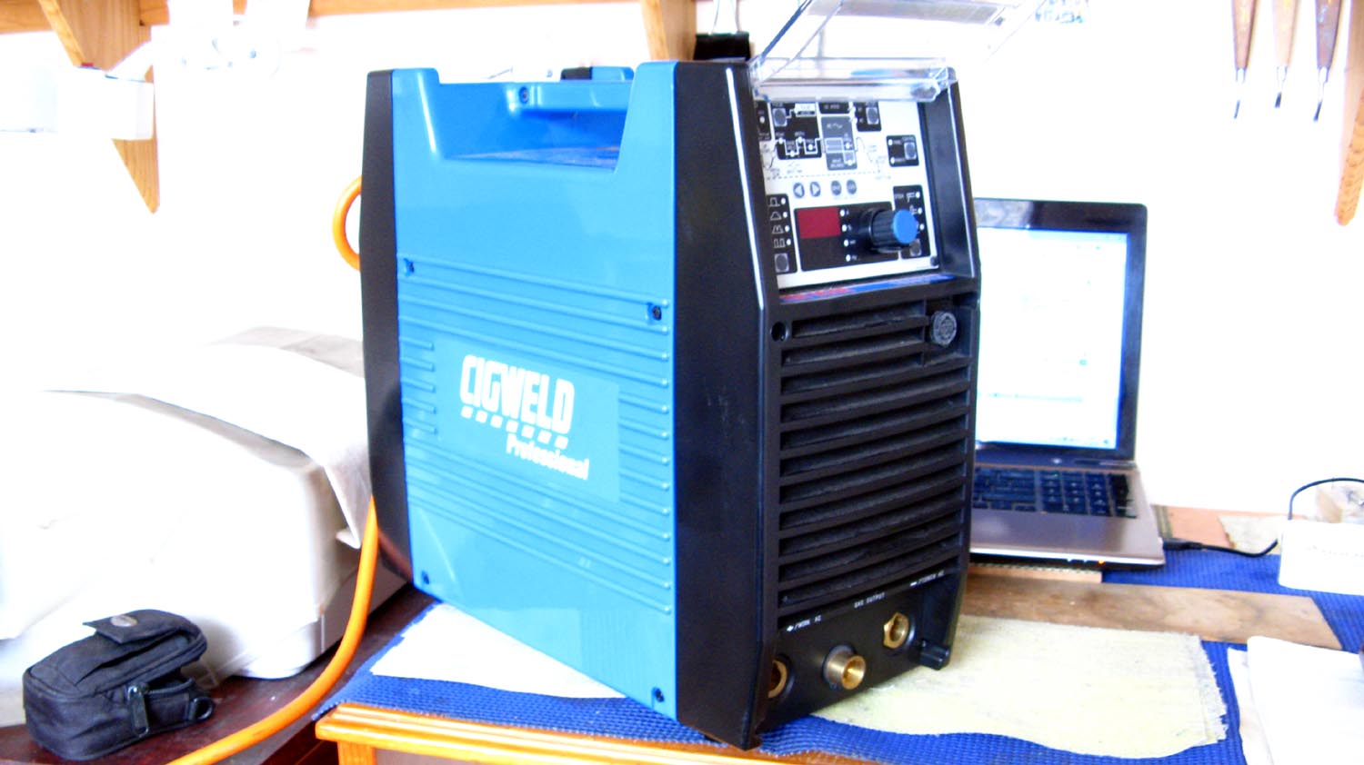

Likewise with the TIG - love to do more with it, but need someone to teach me... so many parameters (10) on this machine.... not like the MIG - which only has the three basic ones, plus a couple of trigger options.
Might take a pic and post here....... with your permission?
001 TIG mail.jpg (125.1 KiB) Viewed 1037 times

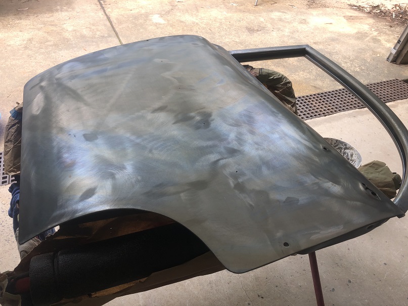

002 Tig panel mail.jpg (127.96 KiB) Viewed 1037 times

Rosco, give me a call 0402 112 770. I have 30 years experience as a boiler maker welder and now teach metal fabrication at TAFE and can talk you through setting up the welder.
Cheers, Simon

I see that a lot of fabricators are heading that way welding everything form pipes to panels.

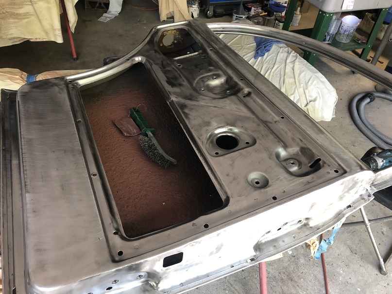

Yes Rosco you can see the drain ports in the upside down door shot (top of picture on the bottom edge of the opening).
Back in the shed today for the last of all my panels to repair.
Deoxidine makes the panels go a bluey, grey, copper colour as the acid burns the metal and removes all microscopic rust and leaves the metal chemically clean.
I still go over it with wax and grease before I paint.
Whoo hoo !! no more metal repairs, just a few hours blocking and priming, really sick of it at this stage, so close yet still so far.
PS door upside down because I wanted to get inside where the repair was.

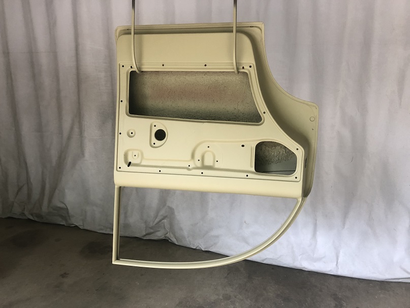

Door looks great... and yes, your process is in parallel with mine... great to get it all under paint... the "rubbing" then begins... but it's more satisfying than working the metal up (well, it is to me anyway).

Should have probably said no more fabrication or rust repairs, just got to finish three panels paint wise and put it all together. Oh and buff and polish it all. Good winter projects !!!!
Getting cold here in Sydney, probably missed the painting window. I could always get the panel done in a booth, see I how I go in the next 2 weeks.
