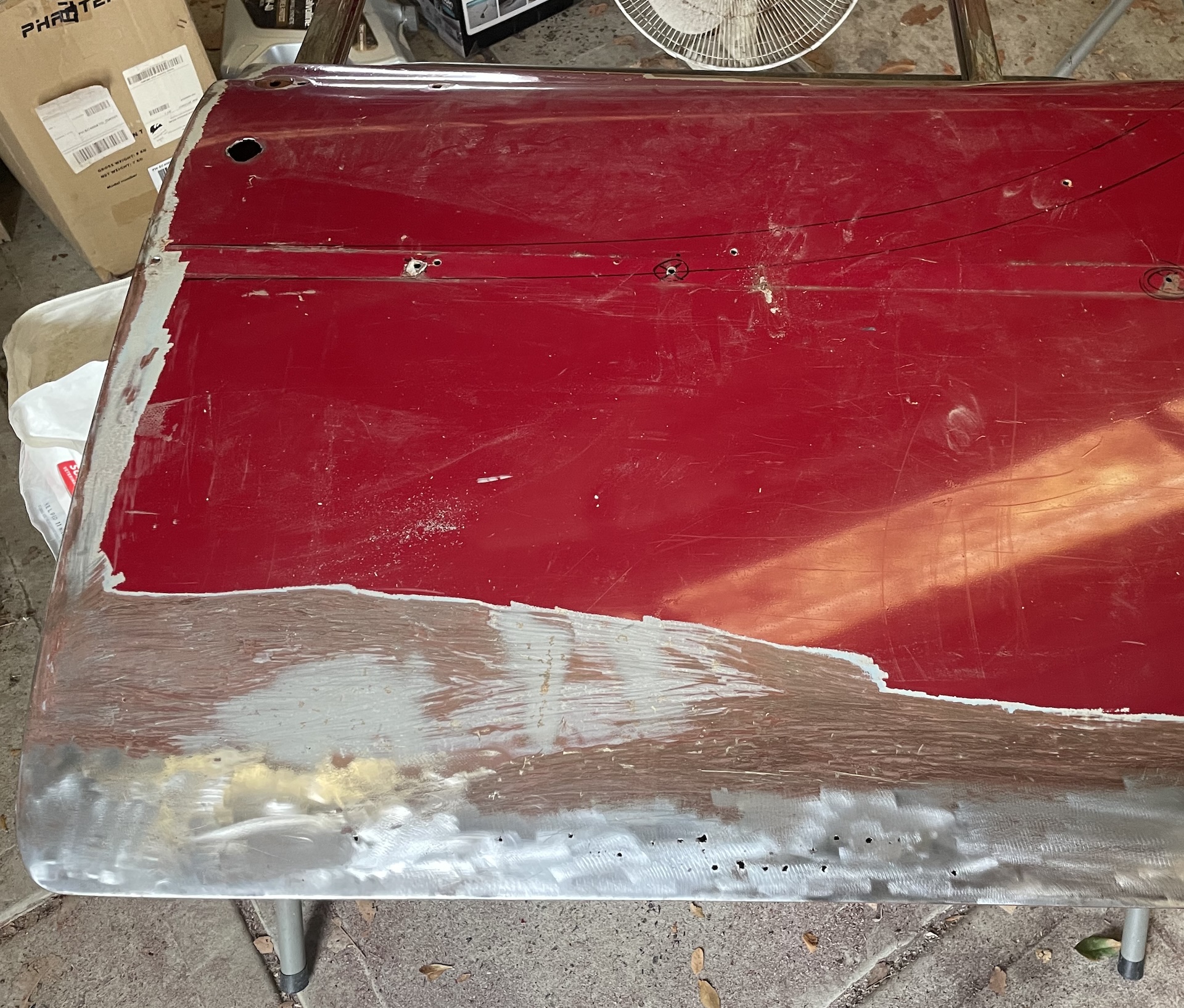

Front drivers door outer skin has a few holes at the bottom. This time I had a look inside and yes it is rotting from the inside out.
So cut around the rot and ground the bottom lip off.
Grind down the spot welds and peel back
Clean up

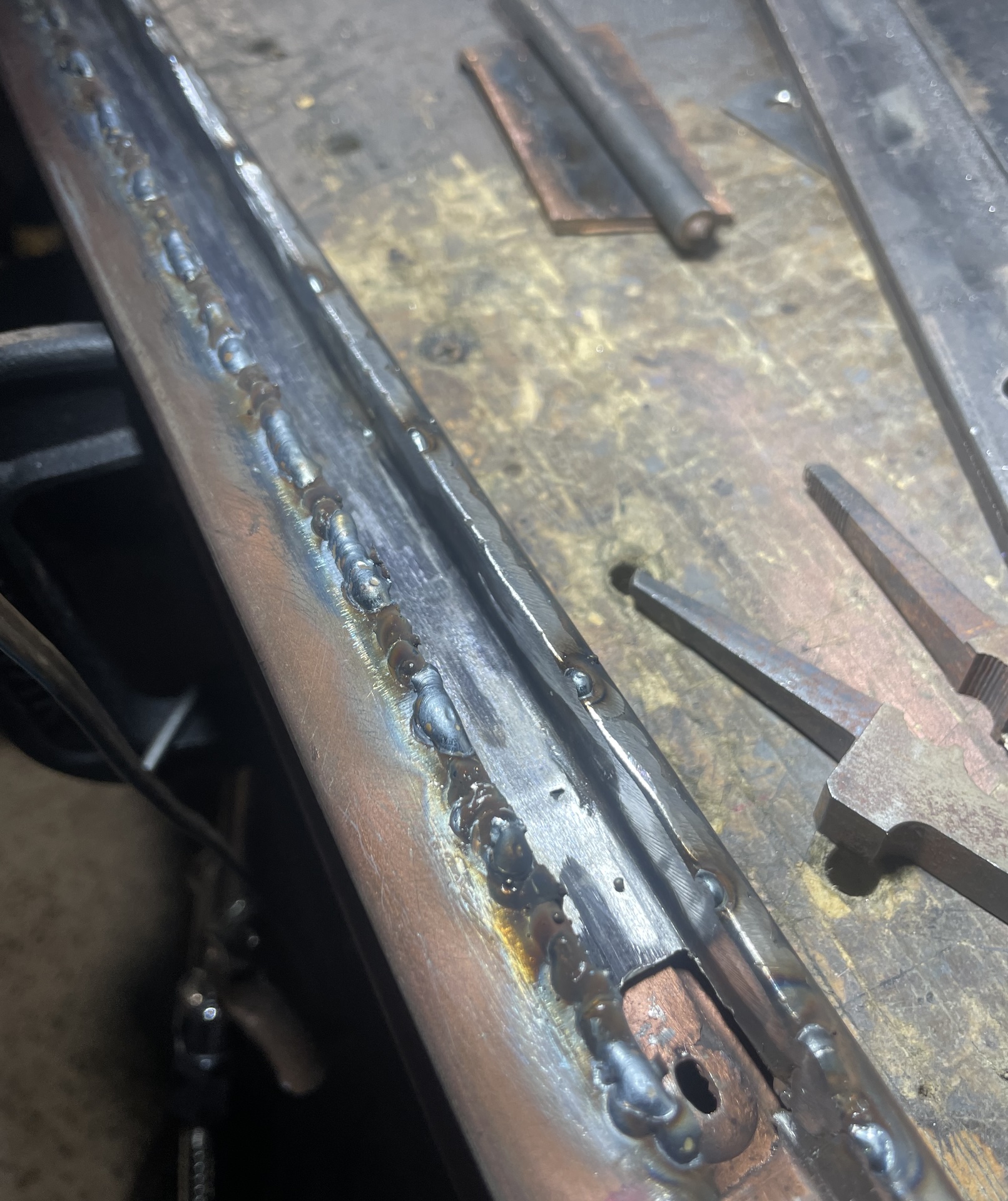

Took a bit of time plotting and planning how I was going to accurately back the weld with copper. Used a square and a ruler to mark the top of frame and top of the door, then used the ruler to help position the copper which was wedged in and held by a dolly welded to a bit of metal bar. Simple.
Ready
Tack, cool, grind, dolly, move copper, repeat.
And repeat
And repeat
More hammer dolly, and then a bit of shrinking disk.
Done

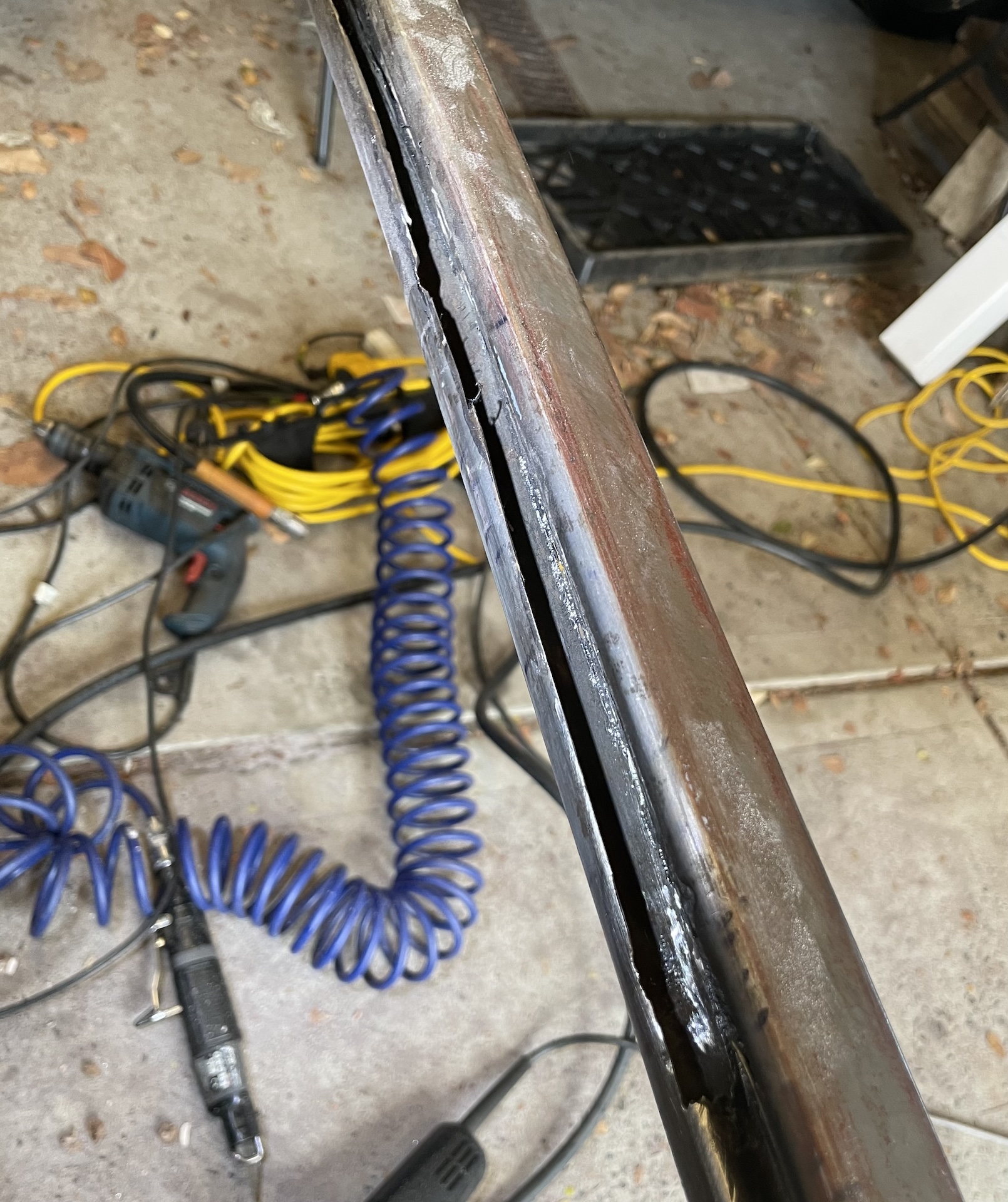

Are we there yet - no! Discovered a world of bog from a previous repair on the top of the door frame. The inner channel is toast on both sides.
If in doubt, cut it out.
Prise the bottom of the channel off its spot welds which let go with a little effort.
Looking in (it's a bit hard to see as the inner curve of the door frame looks the same as the inner) the internal metal is rust free. Must have rotted from the outside in.
Found some steel rod which I matched the radius of the curve of the channel with a bit of sanding. Used this to add a bit of meat around the weld to avoid blow throughs.
Tacked rod in on both sides.
Re: Ol' Rusty - FB/EK Sedan
Posted: Wed Apr 22, 2026 10:30 am
by funkyscooter
Formed up a channel.
Channel ready to plug weld into the frame
Copper primed and channel welded in - plugs dressed.
Building a new edge. Probably should have ground the channel down a bit first but was worried that welding into the edge would blow holes.
One side welded and the other dressed with some pin holes filled
Forgot I have nothing backing the corners and immediately blow a hole in the frame
Grind, fill, grind, sand, done.
