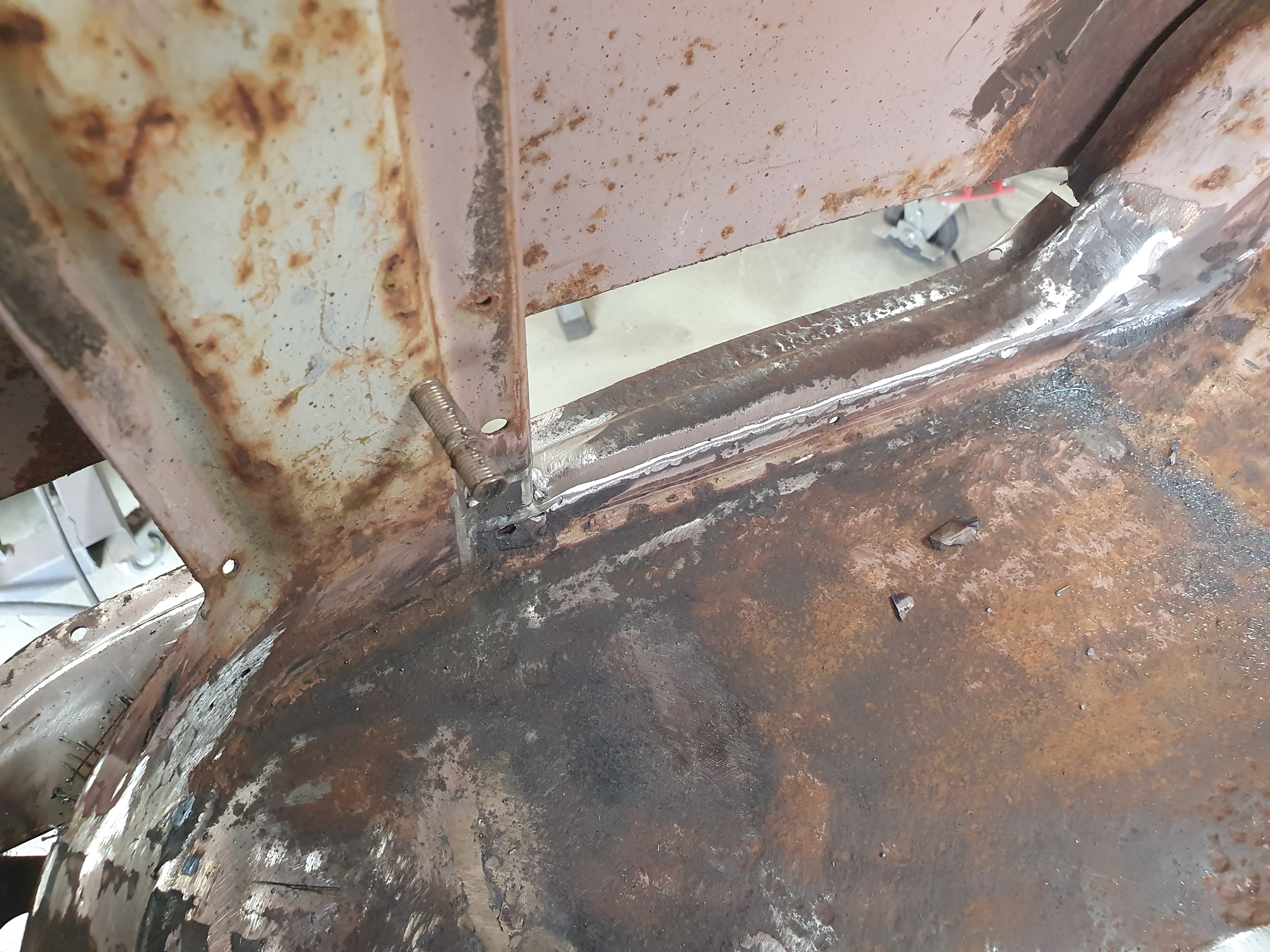

Yes Greg, I will be a very happy chappie. Still a bit to go though. Rust repair behind passenger side tail light then stitch up rear guard section a replacement tray support and an awful mess underneath the front top of the ute tub/ behind back window. Not sure what is going on there, but it will be painful 'cause I have to do it from underneath while lying on the tray...

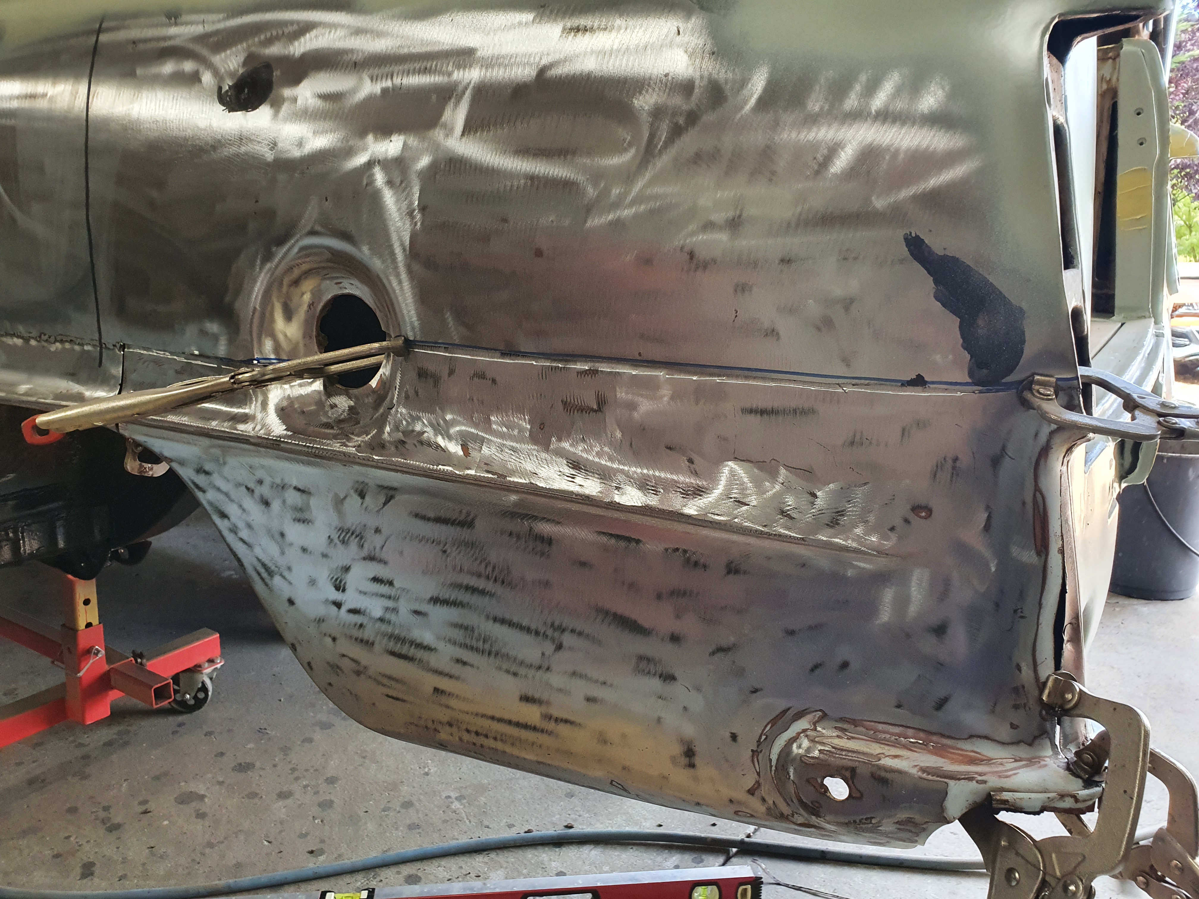

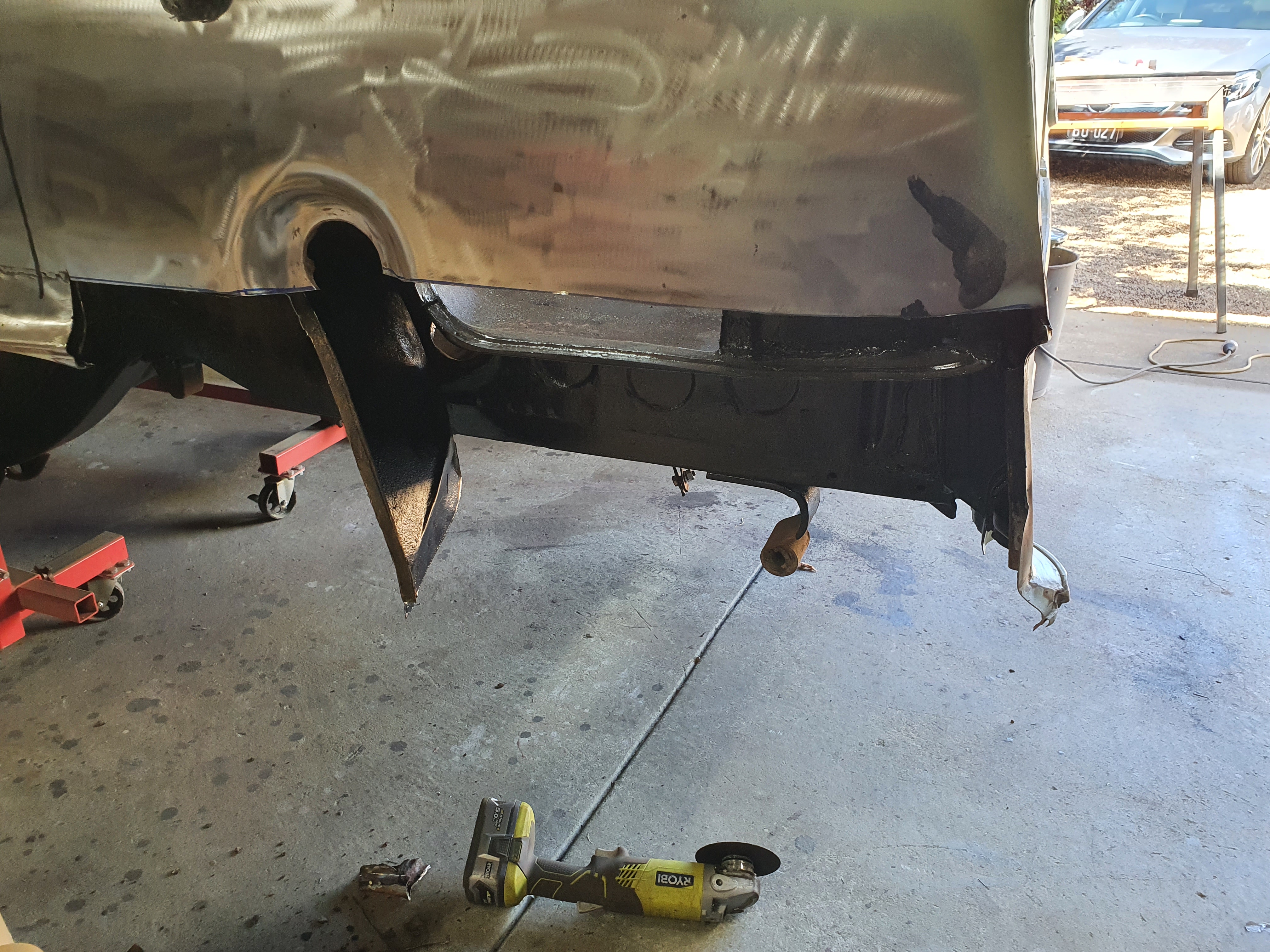

Closing in on passenger side rear quarter rust. Much harder job without donor pieces.

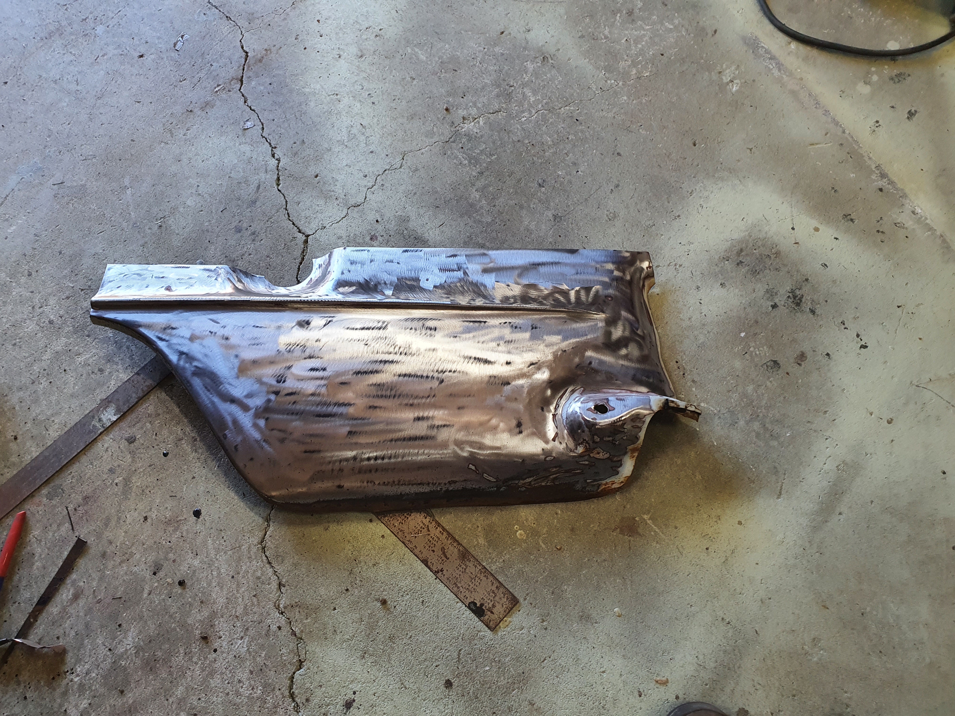

Final patch going on. Used my flanging tool again on this one. Left the inner guard piece on to replace the rusted remnant. Lots to line-up. Pics of progress.

So you do have a donor piece then. Good luck keeping it all straight. Bloody commercial rear quarters.
Posts: 2519
Re: Project 2.

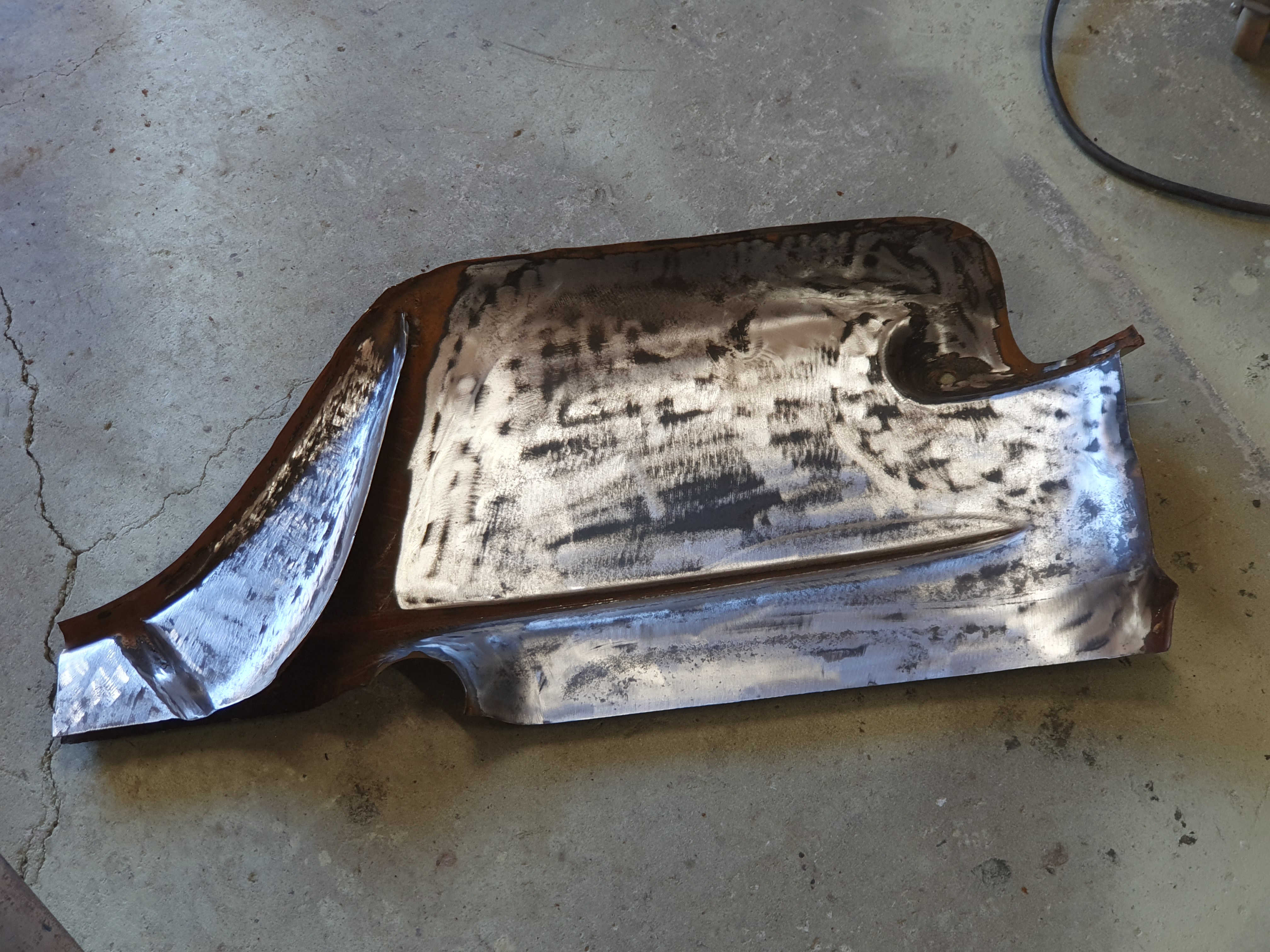

Pretty much only pieces I have not been able to scrounge off the FC and old rusty FB ute were the floor pans.
I agree Clay, straight is always an issue with this work. If panels warp too much, my preferred solution is to cut the weld open and have another go. Much easier than trying to tap things straight without releasIng the tension of the problematic join. You may remember I did that on a rear quarter patch panel on Wilma. Worked out fine.
